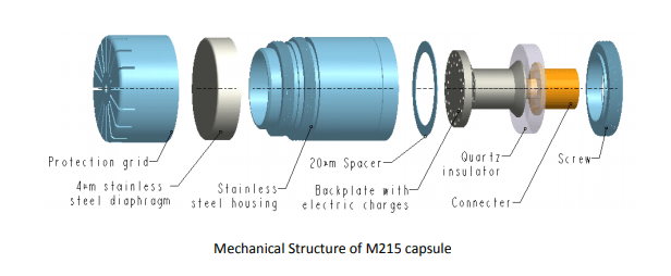

I picked the MicW M215 that is on it's way to me now. This is a metal diaphragm mic in the B+K style. The calibration file lists the equipment used and it is all very good quality stuff, the parent company BWSA is well regarded.
Almost all other mics in this price range and above are plastic. That may or may not be a problem but certain properties can change over time and with heat humidity in plastic diaphragms.

I think that’s actually metalized stainles (sputtered), though I could be wrong.
The more expensive MicW’s are pure metal (Nickel).
I can't be sure either, the manufacturers diagram seems to suggest it is all stainless
This page might be commercially motivated but has some good information
https://www.loudspeakerindustrysour...s-electret-microphones-for-audio-applications
Yeah, I’ve seen that before. When I was researching it more heavily I came across references to proprietary process’s that kept the cost down for the diaphragm that seemed to suggest a sputtered design.
Still, I don’t think it makes a lot of difference unless the Mic is subject to extreme high temp’s, even if sputtered it’s still a metal diaphragm if not quite what you’d get from B&K, Gefell, etc..
sputtered, vapor deposition, sintered powder, all of these manufacturing techniques produce a metal part, with the same stiffness,modulas, electrical conductivity, thermal conductivity, and other physical and chemical properties as metal which was rolled, pressed, extruded, forged, cast, or machined. It is only such properties as ultimate strength, fatigue life, fracture behavior that all these processes differ. For a mic diaphragm, stainless steel of a given thickness and shape is just stainless steel... no matter how it was formed.
