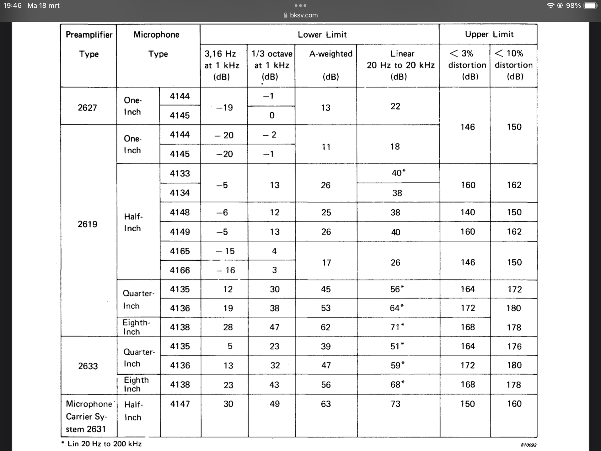

As to measuring below 10dB(A), one needs special microphones with like preamps. Gras offers those, B&K likely too. Normal sound measuring equipment from these brands isn't sufficient. Most pro integrated sound level meters hardly reach 20dB, the top models from B&K start at 16dB. So I wonder, how did those acousticians measure below 10dB(A)?

Honestly, I do not know.
If I were asked to do it, I would ...
  • take a Rode NT1 mic (which is 4dBA)
  • use a good battery-powered audio interface
  • calibrate it to, say, 94dB as full-scale
  • make a long recording without anyone in the room
  • cut out the longest piece without unavoidable accidental noise
  • filter it as A-weighting says
  • take RMS
There are even better -2 dBA mics from B&K, but I would hesitate to take them into the field. You also can play with freezing the mic's PFET , etc...
BTW, there is a problem with the declared -20dBA Microsoft anechoic chamber and alike. There is no microphone capable of measuring such values honestly. So Guinness people take measurements by a low-noise mic in a known noiseless environment (say r1), then measure the chamber (r2), then calculate the noise as sqrt(r2^2-r1^2). The confidence intervals of such estimates would not fly by an experimental physicist but are good enough for mass-media publications.
