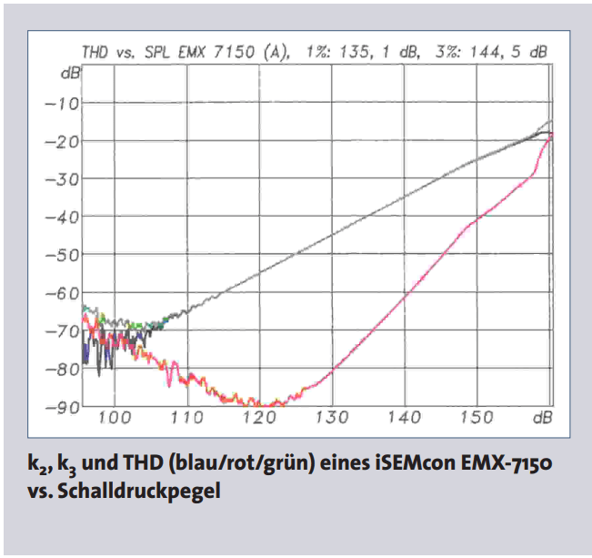

The kind of data I would like to see in a microphone is a minimum of something like this:
Reference:
iSEMcon EMX-7150 review from
Production Partner.de, 06/2012 Issue
Here we can see the 0.01% mark is 20dB down from 1% and 30dB down from 3%

THD of condenser capsules is dominated from H2.
H3 and higher only add at very high levels. This works as long as the impedance converter electronics is linear - very often the limit for the complete microphone in high SPL.
As in the graph above, when H2 reaches 1%/-40dB - H3 only has -70dB. Higher order ones would be even lower.
So when you have a dedicated THD value for the CAPSULE like 0,5% at 140dBSPL or 1% at 135dBSPL like above you can calculate from that. But when you have something like "135dBSPL maximum SPL" its very likely the overload point of the amplifier and doesn't tell you anything about the microphone capsule.
At lower levels like 94dBSpl THD of a useful measurement microphone is burried in the noisefloor, that's for sure.

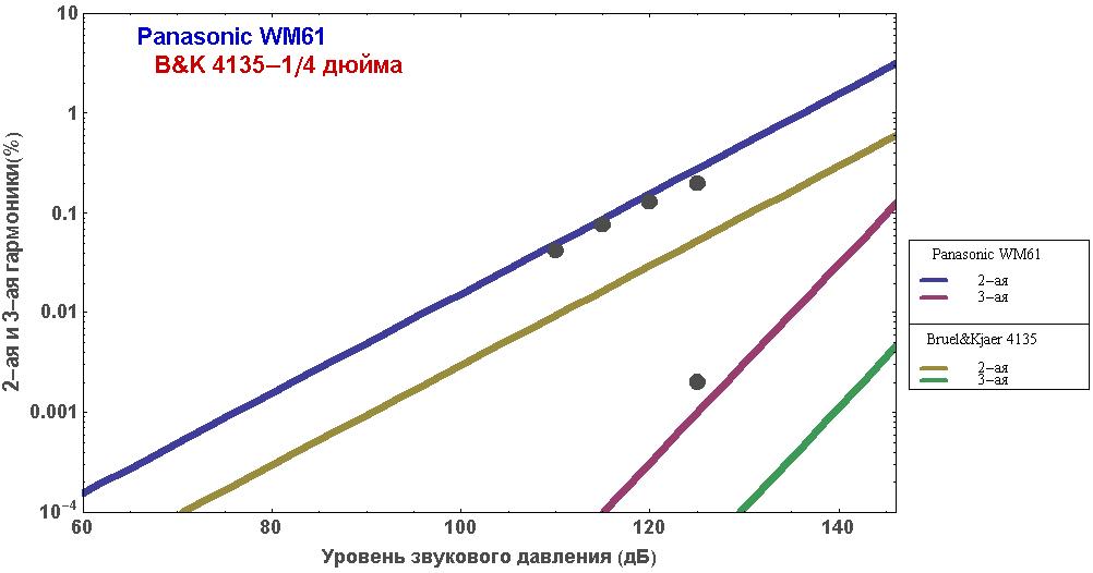

My colleagues and I have been investigating THD in microphones decade ago. I carried out theoretical modelling of THD vs SPL based on the your mentioned B&K document and my colleagues measured mics THD experimentally. The match was surprisingly accurate.
https://forum.vegalab.ru/showthread.php?t=66583&p=1945801&viewfull=1#post1945801
X-axis is SPL in dB; Y-axis is harmonics in "%", dots are experimentally measured values of THD in Panasonic WM-61.
Based on this, to be able to measure down to, say, -80dB H2, the maximum the WM61's can observe is 94dB, and the B&K 4135 is 110dB.

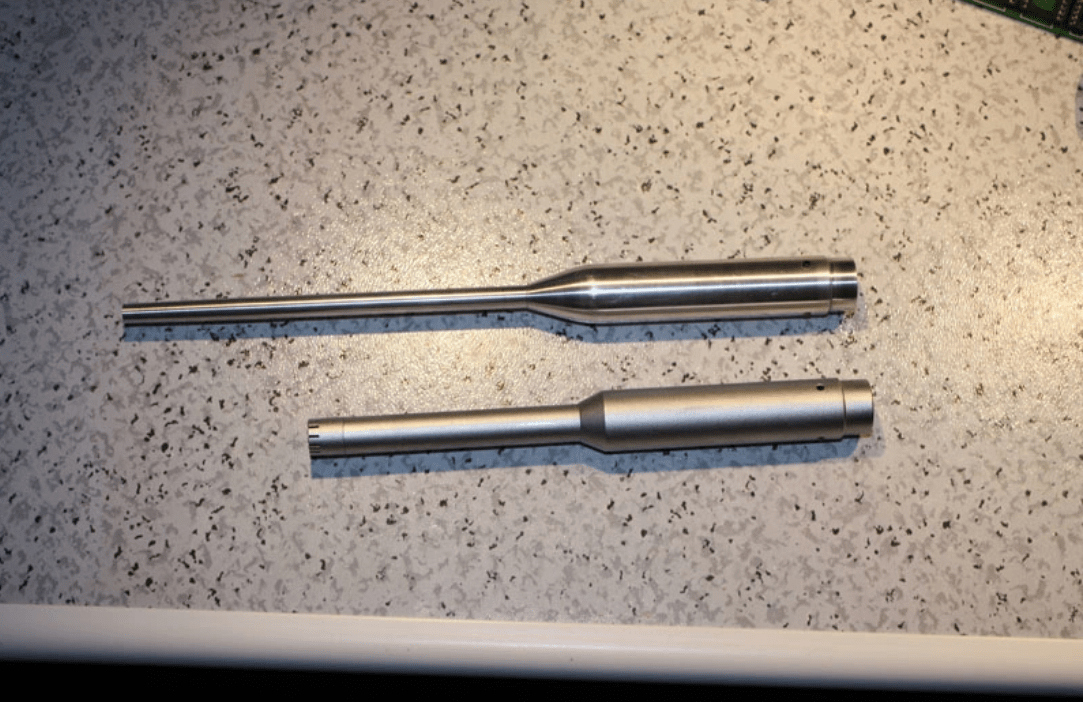

Many years ago, I made my own microphone (the top one)
Also improved the bafflestep a lot. (which seems to be the issue around 10-15kHz with most mics)
Most electret capsule contain a FET as well, putting that one in just a source follower already improved the distortion A LOT.
(this idea came from Linkwitz, that article is somewhere on his website)

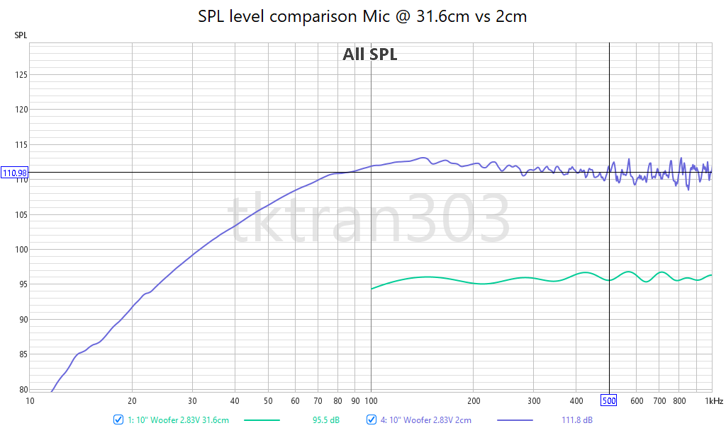

I hear what you're saying about the M30 and M215. And I agree, if you imply that H2 or H3 at low frequencies doesn't need to be 0.001%.About 20dB higher as 1m measurement. That's really no problem for a measurement microphone!
And you don't measure 0,001% at low frequencies - we are very happy to stay <1% at normal listening levels. Will be way higher at high levels.
So nearfield measurements are easy with a mic like M30 or M215.
But my data shows that a 1cm measurements is MUCH more than 20dB than a 1m measurement.
Here is 31.6cm vs 2cm.
I put a marker at 500Hz, and the difference there is some 16dB.
If I pull my mic back to 1m, it will be at least 16+10=26dB between 2cm and 1m (31.6cm to 1m)
I wonder what is causing our discrepancy between 1cm and 1m?
