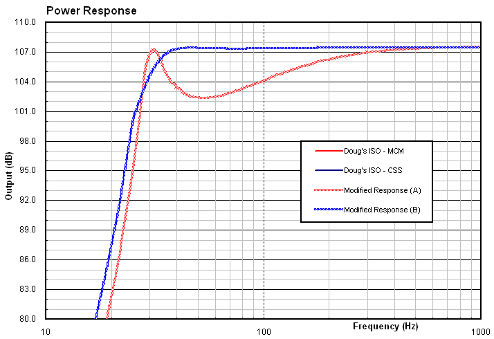

Who said I didn't like isobarics ? They are great for the right drivers,
and the right circumstances, they typically allow drivers to be used
for a case when the box for one driver is too big, you can halve it.
And a poor / pointless choice for the wrong driver, you keep saying
they are great going by ..... whatever. I have said the 30Hz vented
isobaric version has a box that is far too big with a big peak at 30Hz,
that the two drivers used normally in the same box will sound better,
go just as deep but avoid the peak, and go 6dB louder, effectively
quadrupling the apparent amplifier power over the isobaric as they
will also be 6dB more efficient.
Literally twice as good, its like having two of the isobarics.
Your right of not a fan of this "design" because it isn't one IMO,
it models very poorly, suggesting wrong design decisions, a more
thought out proper design has overwhelming advantages, done right.
You seem to be saying you can't see what's wrong with it .....
Do some modelling and you will soon see, isobaric with this driver
costs an extra driver and a beefier amplifier for no real purpose,
and you end up with silly small box sizes for the best performance.
rgds, sreten.

You say the tuning is dead on, but it isn't. It may interact fortuitously
will your room, but then your just lucky, not something to recommend.
Its like the UnABL farce, people insisting stuff that is simply not true.
With the same drivers, the same box volume, same amplifier and same
vent tuning you can build one box that betters two of the isobaric subs,
i,e, one box, two drivers and one amp will outperform two boxes, 4
drivers and two amplifiers, its a utter no-brainer, build it properly,
or a least stop implying its a good way to use this driver, it isn't.
Literally get more than twice as much for your effort, in a package
that may have twice the WAF of the equivalent isobaric approach.
Why are you ignoring the modelling, its accurate and you have
accurate parameters ? You've got NIHS in a very bad way IMHO.
I'm getting very bored, your too lazy to do the modelling yourself,
and all you can come up with is a very poor implication its pointless.
rgds, sreten.

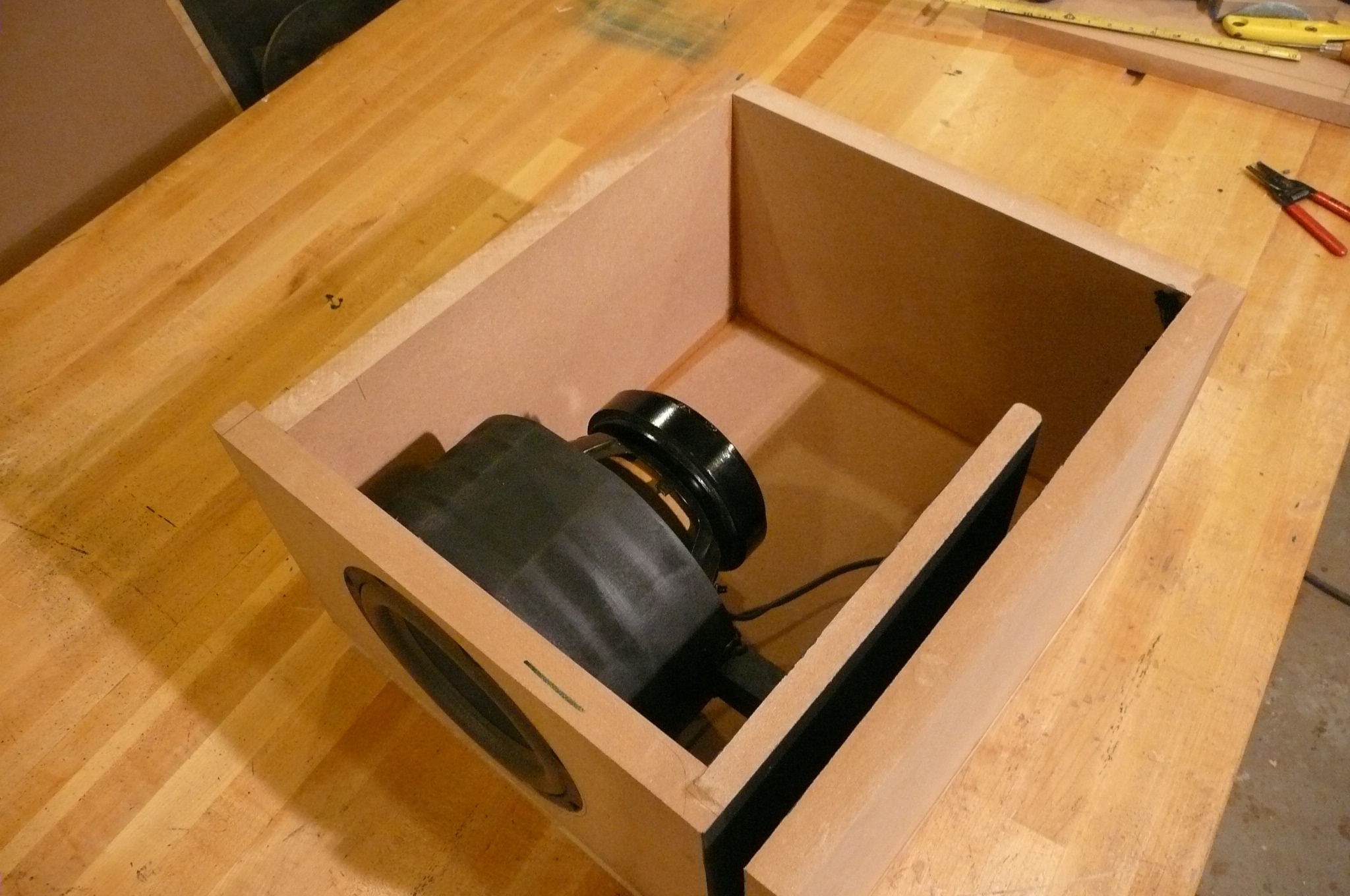

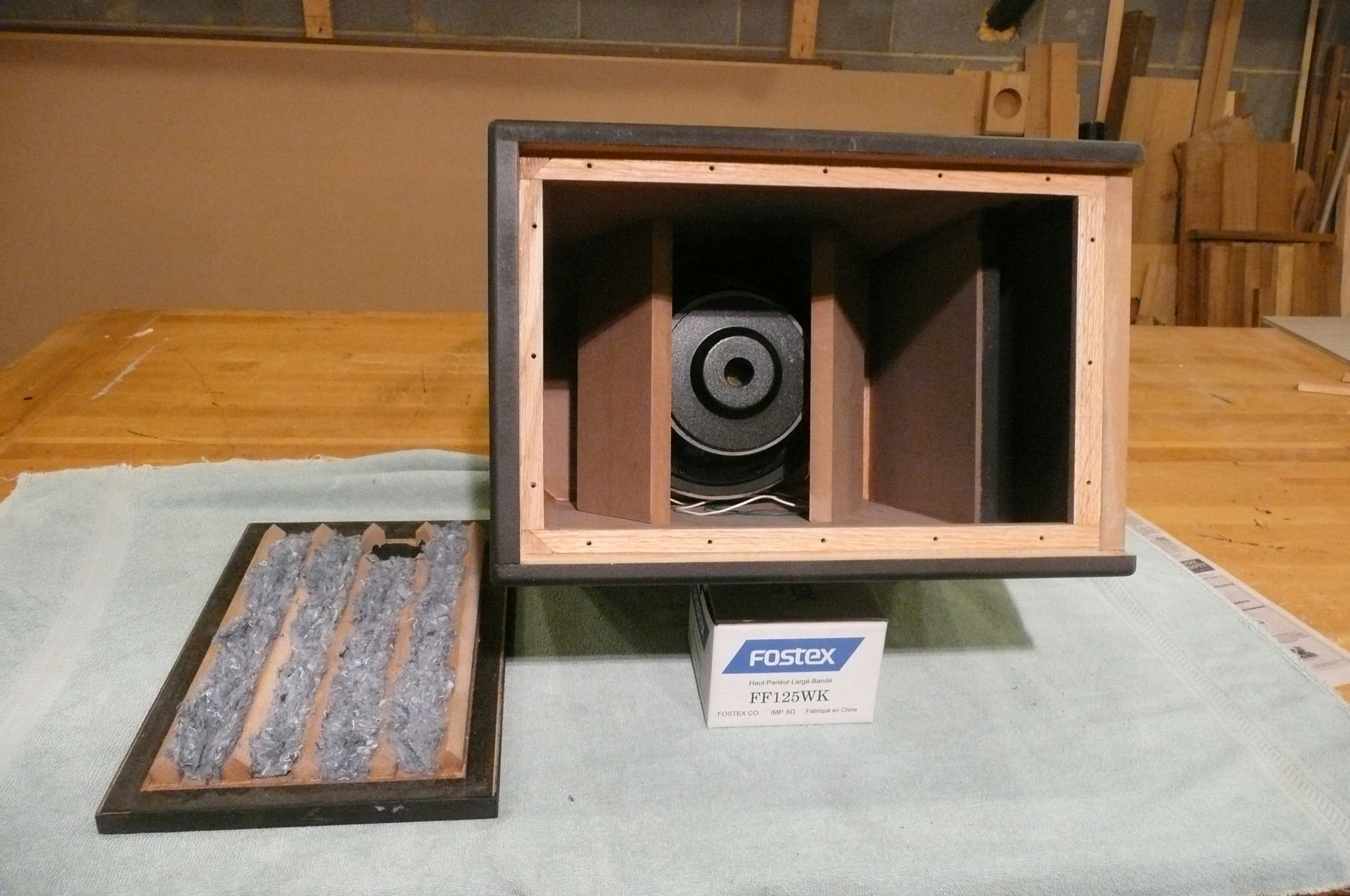

There are two baffle plates ~ to break up standing waves.
What standing waves? That cabinet is far too small to have standing waves at the frequencies it's being used for. The angled partitions may help brace the walls, but that's all.
I stand corrected. They probably do more bracing than anything.
However I have seen small angle "boards" in book shelf speakers. Sometimes I'll clamps a 45 degree board, right next to the woofer (between the W and T) on the front baffle plate. A ploy I copied from a fellow that was heavy into attenuating standing/back waves. He also used foam blocks, cut with sharp pointed pyramids.

Looking at your design, the biggest problem I see, apart from the ones that other people have already pointed out, is that your slot port is too small and has very high losses. You can see that from the relative size of the 20Hz and 40Hz resonant peaks. If your port was more efficient, the speaker would have a lower excursion for the same output at resonance. The port ought to be 2 to 3 times as large (cross section) as it is now, and of course a lot longer if you want to keep the 30 Hz tuning point. It then gets hard to fit a port that long into the enclosure. Do consider it though, because the results are desirable - lower distortion because the drivers don't exceed xmax at high power, and less port noise ("chuffing").
I wouldn't build these enclosures for myself. They are simply too large and tuned too low for the drivers to give of their best. Your description of their performance (in post #73) shows that. The problem is, there doesn't appear to be any way the drivers are suitable for sub-bass use. They would make a good woofer, or maybe in a bandpass enclosure as suggested by Michael.
I note that a single CSS Trio8 would be a better match to your enclosure, and would provide about the same output for the same power and a similar price (1 Trio8 vs 2 55-2421, assuming both at full retail price.)

Nobody is saying they don't work and fair enough you like them.
But on Paper :
The isobaric could be rearranged as a normal sub with +6dB efficiency
and output, which would convert the 30Hz region to extended shelf.
Bass extension is just as good, but will be better due to extra SPL.
Or alternatively put, one driver in a smaller box with a PR and
a less juicy amplifier will work just as well as the isobaric.
The audible result of your build is not the issue, whatever people
think of it, or report, it is the design details they are unaware of.
If you like a bump at 30Hz the more gradual peak of sub with a built
in optional bass boost could work well for movies, turn it off for music.
The fact is on paper in an hour you can go through dozens of arrangements
in WinISD and that exercise will lead you to conclude isobaric for this driver
is near pointless. MCM gave you very bad advice about the driver that you
ran with and then went isobaric. Try running with some good advice.
The fact is with these drivers you can make very good compact subs,
that vented or better still PR'd will go down to around 30Hz will a
room friendly response shape above that.
Bandpass boxes IMO, due the small volumes required, and the criticality
of getting the fine tuning right, and not trusting the sims, IMO would
have to be built and tuned via an empirical measurement process.
rgds, sreten.

Regarding the CSS driver versus 2x MCM, see the attached graph.
It shows isobaric MCM 55-2421 versus single CSS Trio8 in a 30 litre enclosure tuned to 30 Hz. The MCM drivers are fed a total of 240 watts, and the CSS driver is fed 200 watts. (Ignore the "modified response" caption, the spreadsheet I used allows applying filters and adjusting for measured room response etc.)
I'm an isobaric fan myself, which is why I read this thread, but after doing the sums I can see the logic behind Sreten's recommendation of a standard layout 2 driver setup.
Regarding port size, you said your port is 10 inches wide and about 3/4 inch high. No way is that 100 square inches. A square port (10 inches by 10 inches) would be 100 square inches...
