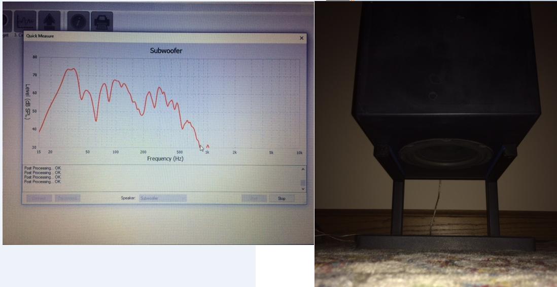

Okay thanks snappyturtle, I didn't go crazy with the fill/lining on the second box.
So some feedback...the the lining/fill sounded a little better and didn't lose db.
Also tried several positions and speaker stands. This old metal stand (8"high) works nicely in a down firing setting, but it's fine woofers forward, up off the floor on the same 8" stand.
*shown is the second box, with the removable back.
not likely. the peak is a function of the design. stuffing it, or even heavily lining it, will only serve to lower upper band response/peaks. could also muffle some nasties that may be making their way out of the port (ie motor noise, etc) heavy lining or stuffing could also reduce system sensitivity across the band.
looking good. appears you calmed that peak down 5ish decibels, which likely makes a significant in room difference. though it looks like you picked up a big 60hz null, did measurement location change? does changing the orientation of the driver remedy that at all?
Hi and thanks,
Tried all the easy fixes, spinning the box in every direction, the best was up on the 8" stand, forward.

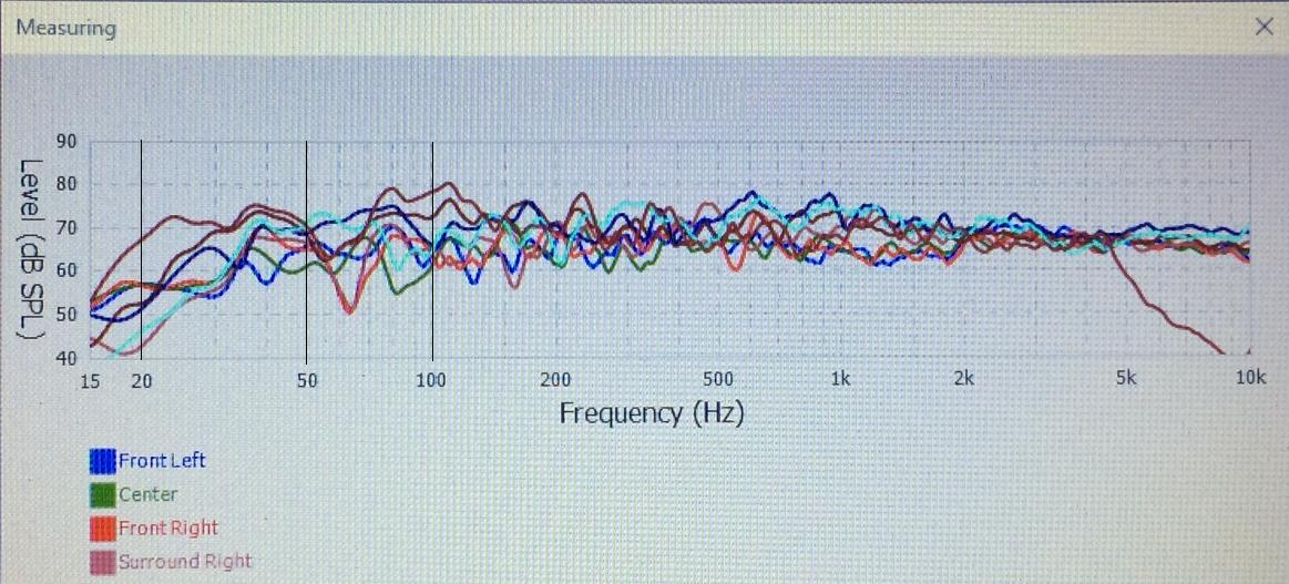

The 60hz null: Moved the mic around the room, the reading were close to the same, best results are back by the big-guy's chair (0; Other than that, the first peak just tilted in both directions, not by much. I've been checking several other subs in the room also, there's always a dip, sometimes lower than 60hz. Which may not bad in my case, the other BR speakers in the HT sail past 60hz.
adding pic, the red line on left is a completely different sub
I can hardly believing the compact box can cranks out sounds like canon/gun fire, explosions, etc., at high the levels, with no problems at all. For a long time we used two of them, only need one now, with the addition of a high pass filter.

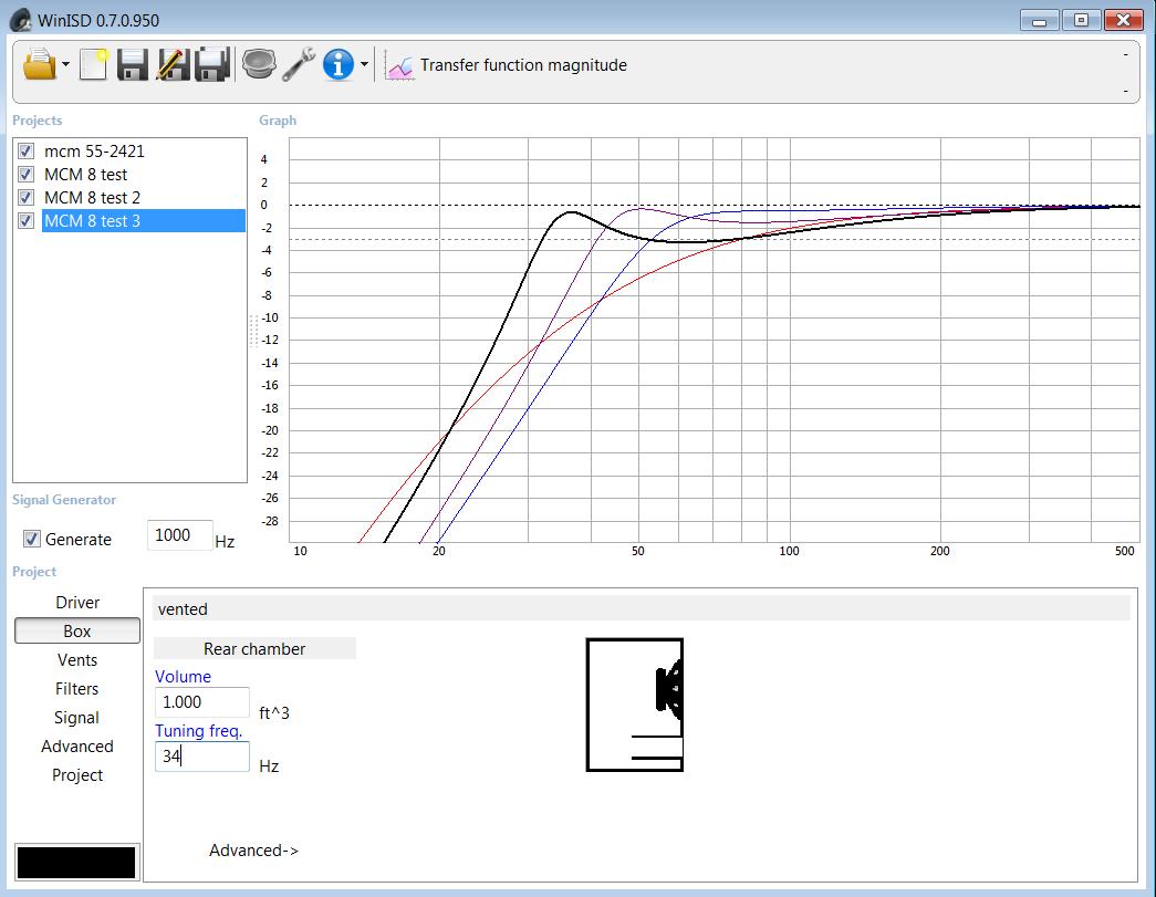

The paper cone is pretty thin for a speaker with a huge magnet. It will start to waffle if it is played to loud (and good reason to go ISO)
The MCM will certainly go low, but at a cost.
Attachment, MCM woffer modeled in a few different boxes.
