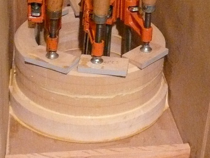

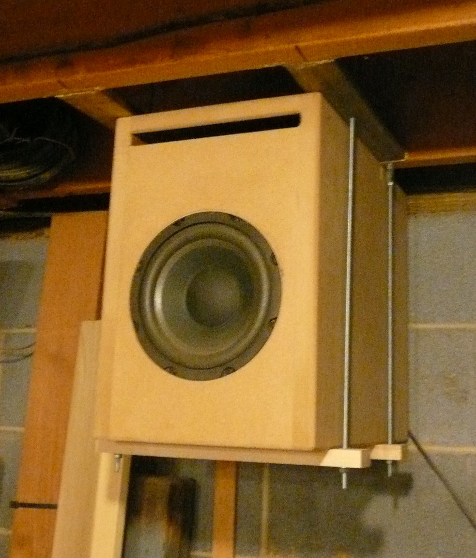

I did mock up a lot of boxes, changed volume; tuned them with temporarily clamped cabinets, shifting the the slot around to fine tune them. The impedance curve looked dead on to me, i.e. even peaks and valley @ 30hz.

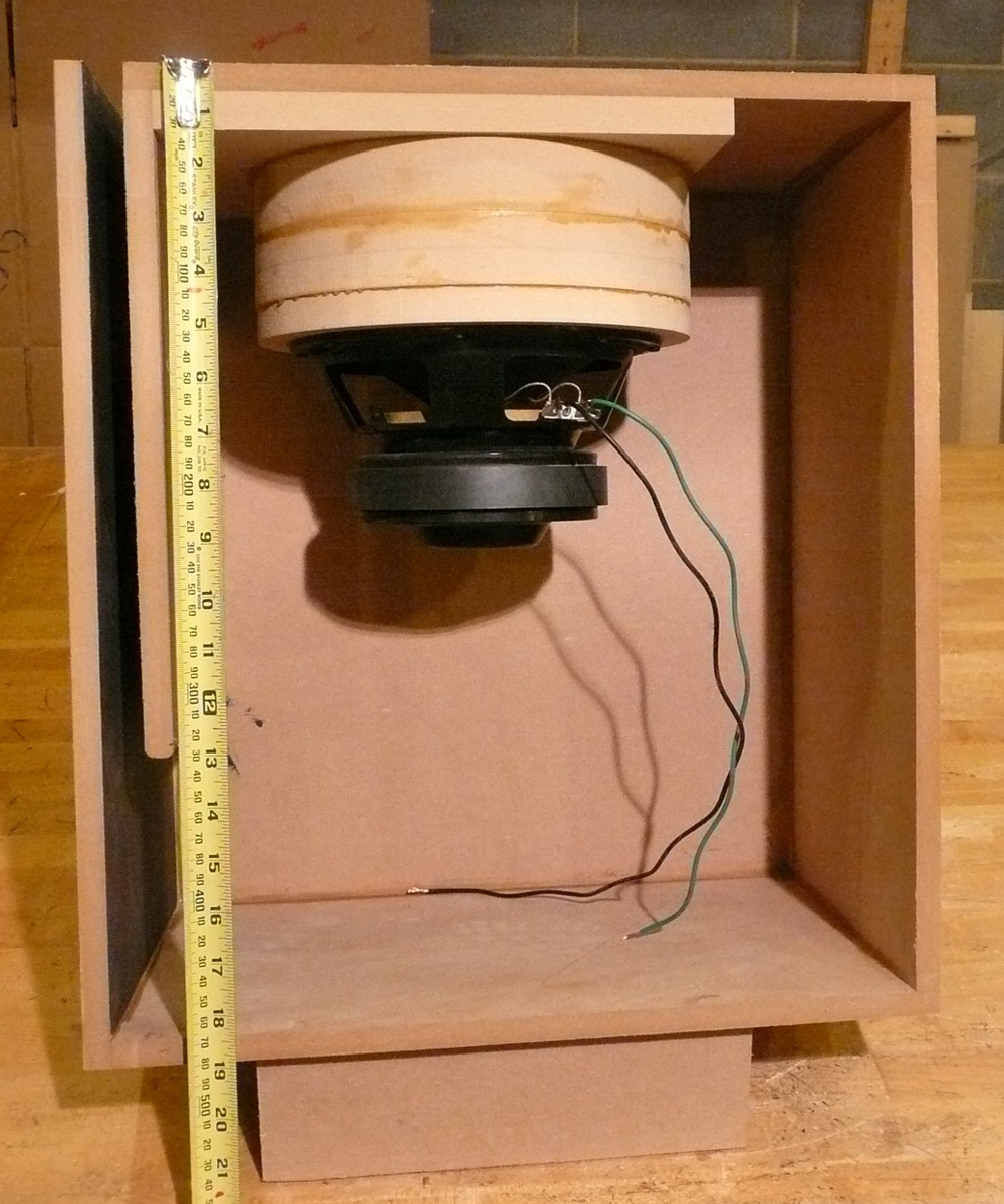

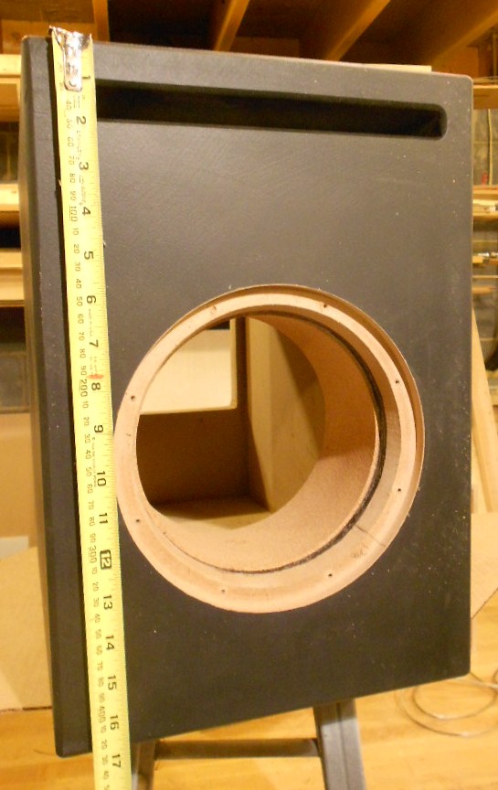

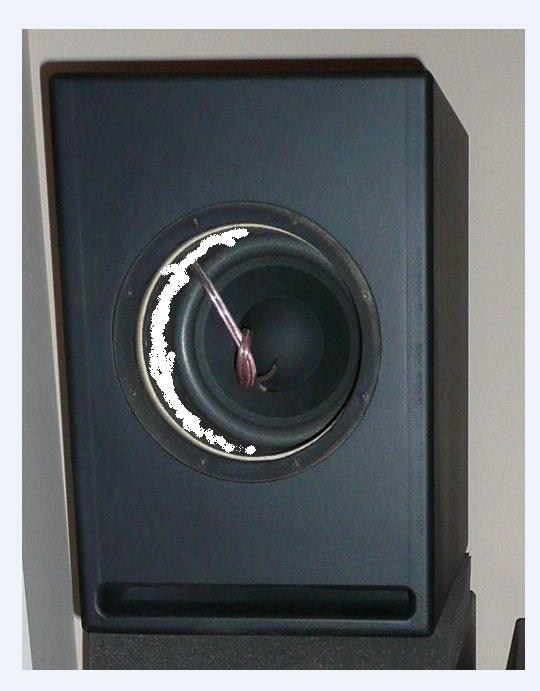

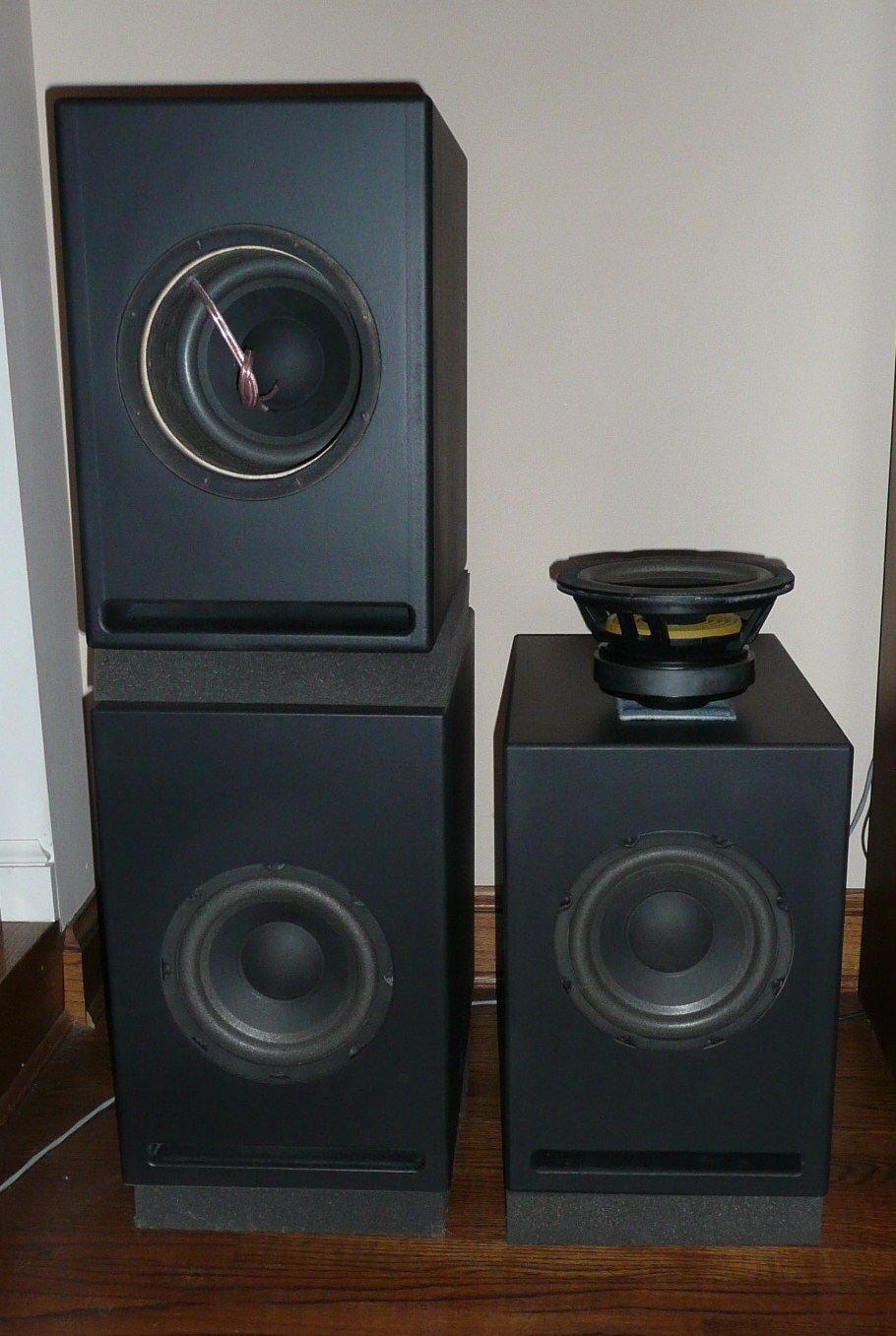

The Iso box shown works very well, it was not a one shot cabinet, I did build over a dozen prototypes. These two woofers in a small tight tunnel will give you nice clean bass; flat to 35hz, and down to 25hz.
This box was measured by one of the advanced member of this forum. (humble woodworker here)
We'll be taking a lot of flack (do you have bulletpoof vest?) on this but let me know if you need anything, could help out with the rings if needed.
The pics are from different builds but the same idea:
pic 3 has the cork liner.
INSIDE DIMENSIONS:
17" deep
15" tall
9 - 3/4" wide (I call them the "rips").
INSIDE DIMENSIONS:
17" deep
15" tall
