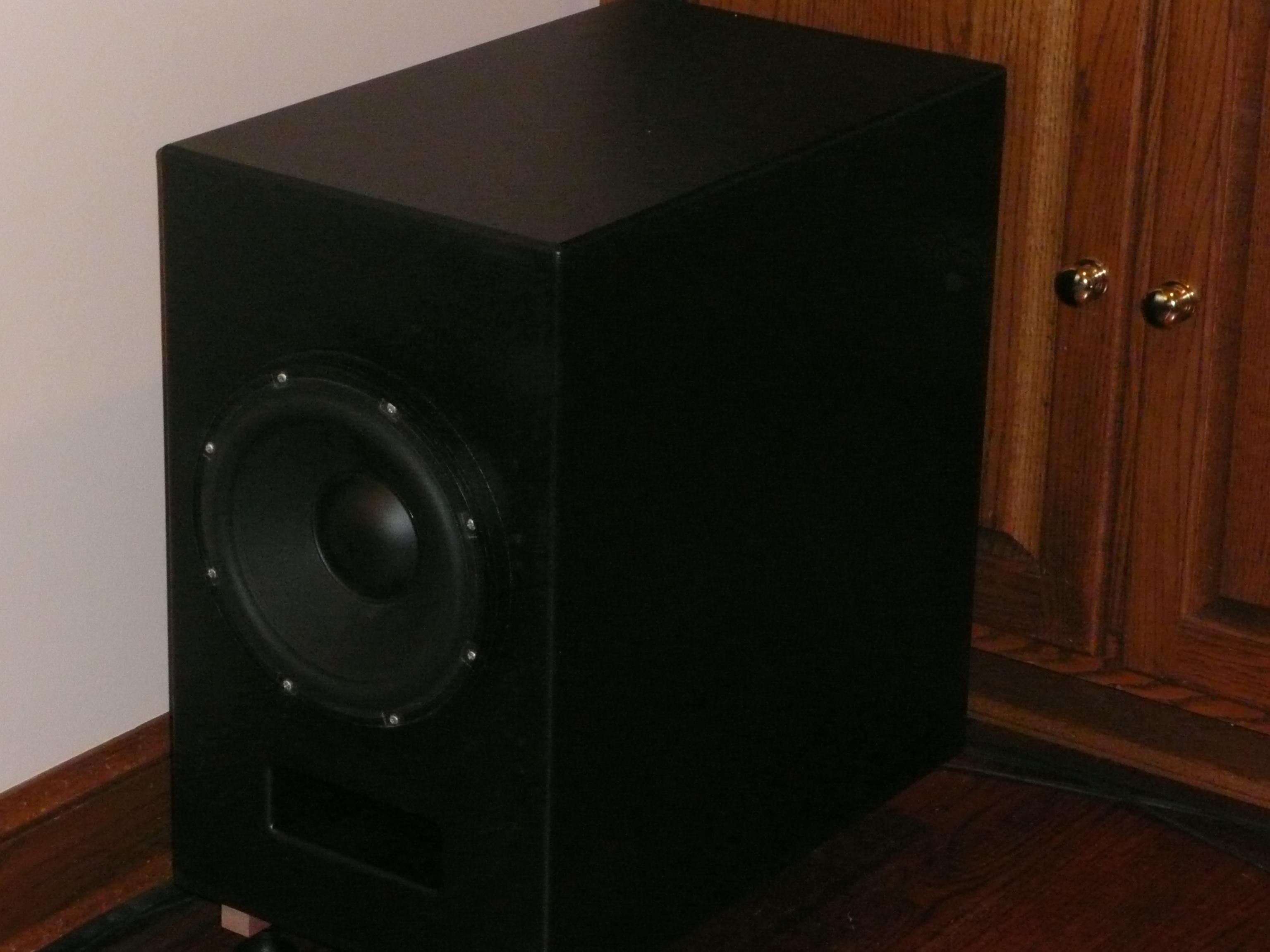

I hooked the signal generator to the processor, did not move the speakers out of the room.
They sound like the modeling on post #97, there is a slight dip before the 30-35hz peak, I don’t think dip is that bad; also there are ways to compensate, yes? I don’t find the need too, I just run them flat – crossed over at 80hz.
I’m pretty sure the 30 – 35hz peak is above the flat line. I am always impressed with the “power” - they just have a powerful feel to them.
Also, unsure why a classic tuning method – is now a false impedance reading.
I may be stirring the pot again, never, never my intention; the target was more of what can be done for less.

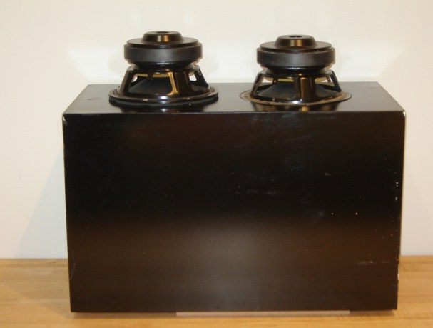

Isobaric Wars
All most forgot about this build; similar to the last. Started off with 2 - 10s, Foster drivers (If I have the name right).
They were both side by side in a 6cf sealed box, used them for years; the box configuration was recommended by the seller. Then about 5 years ago contacted the seller (starts with an M); they said no, no, no, build a 4 cf vented box and run them parallel since they were 12 ohm woofers. They even sent a plan; fine it worked great, much better than the sealed.
From that point, I got the idea to go 2cf isobaric (tunnel), well that was the best sub woofer out of all three. We are still using it in my dad's HT, it is very "powerful". Sure got my $$ out of these woofers!
So that said, I have one more plan/build up my sleeve AND this new Iso box models nicely in WinISD. more to come.
I'll be back……….
I'll be back……….
