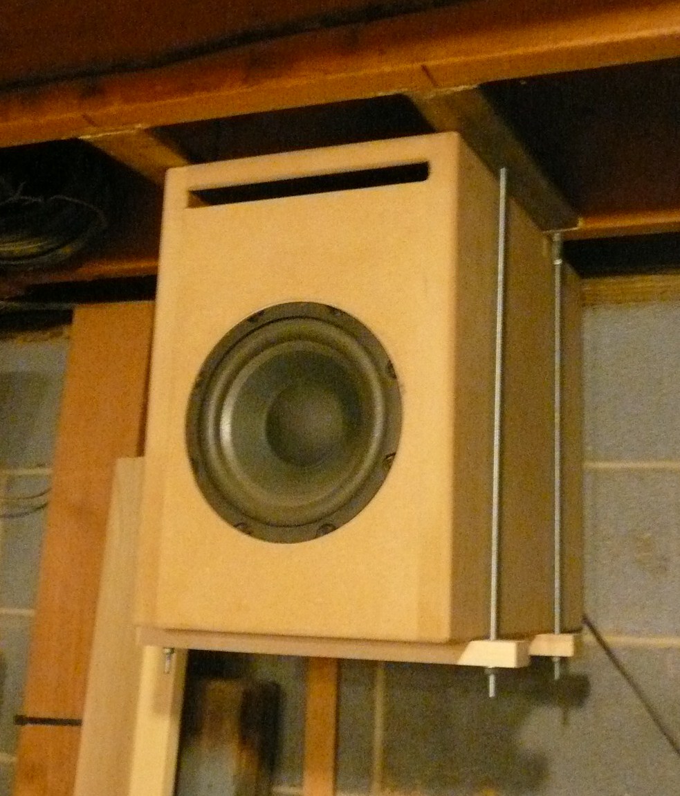

Secondly, I chuckle every time I hear one. I have two in the HT and one bolted to the joist in the shop (to free up floor space).

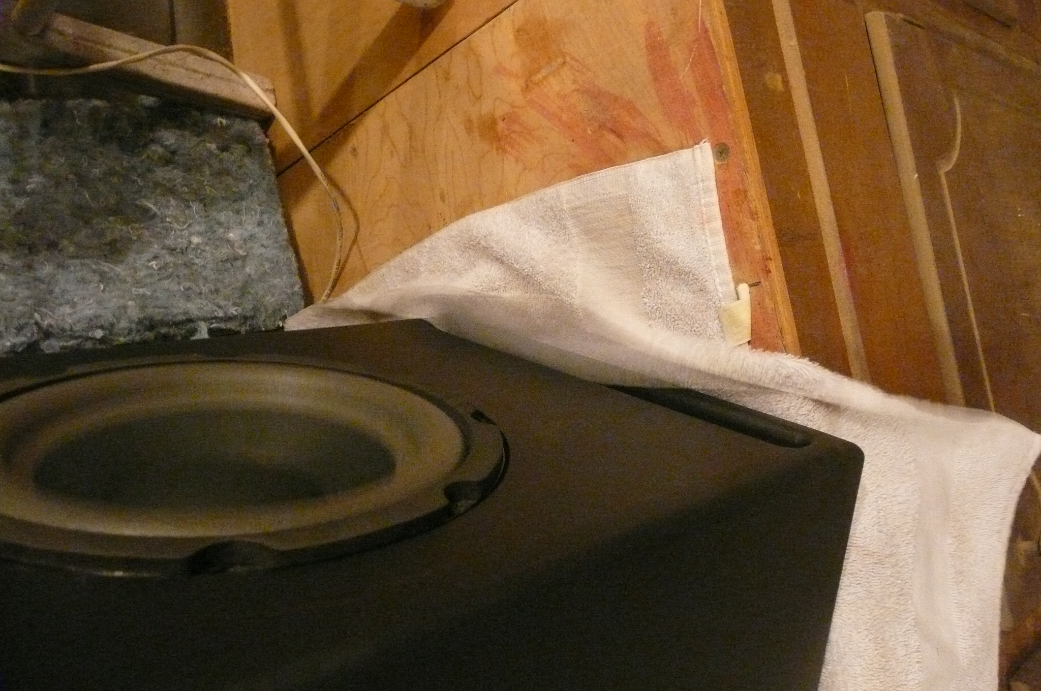

I built one for a buddy, used the 240-b watt plate amp (b is bass boost), and that had an extra reward and can still hear it in the back of my mind. When the towel almost got vacuumed into the slot port, all I could think: “you got to be kidding me”.

... When the towel almost got vacuumed into the slot port ...
That's a sure sign of an undersized port (air velocity too high).
