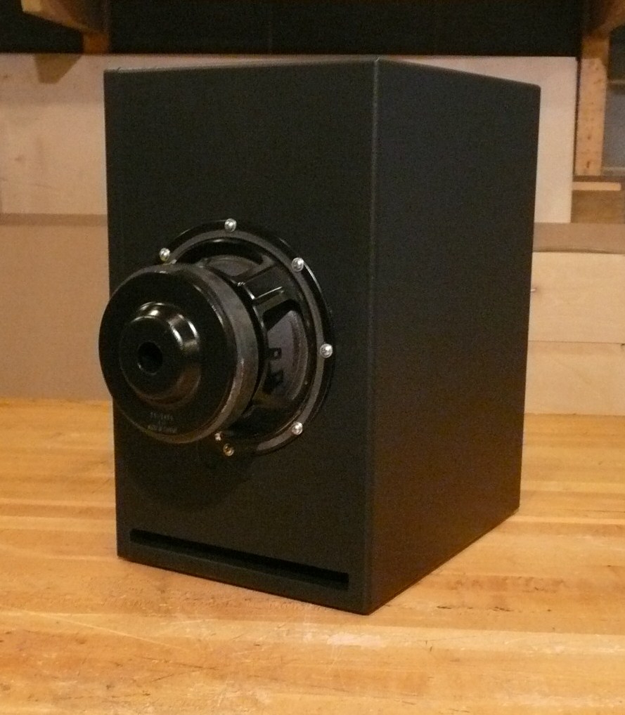

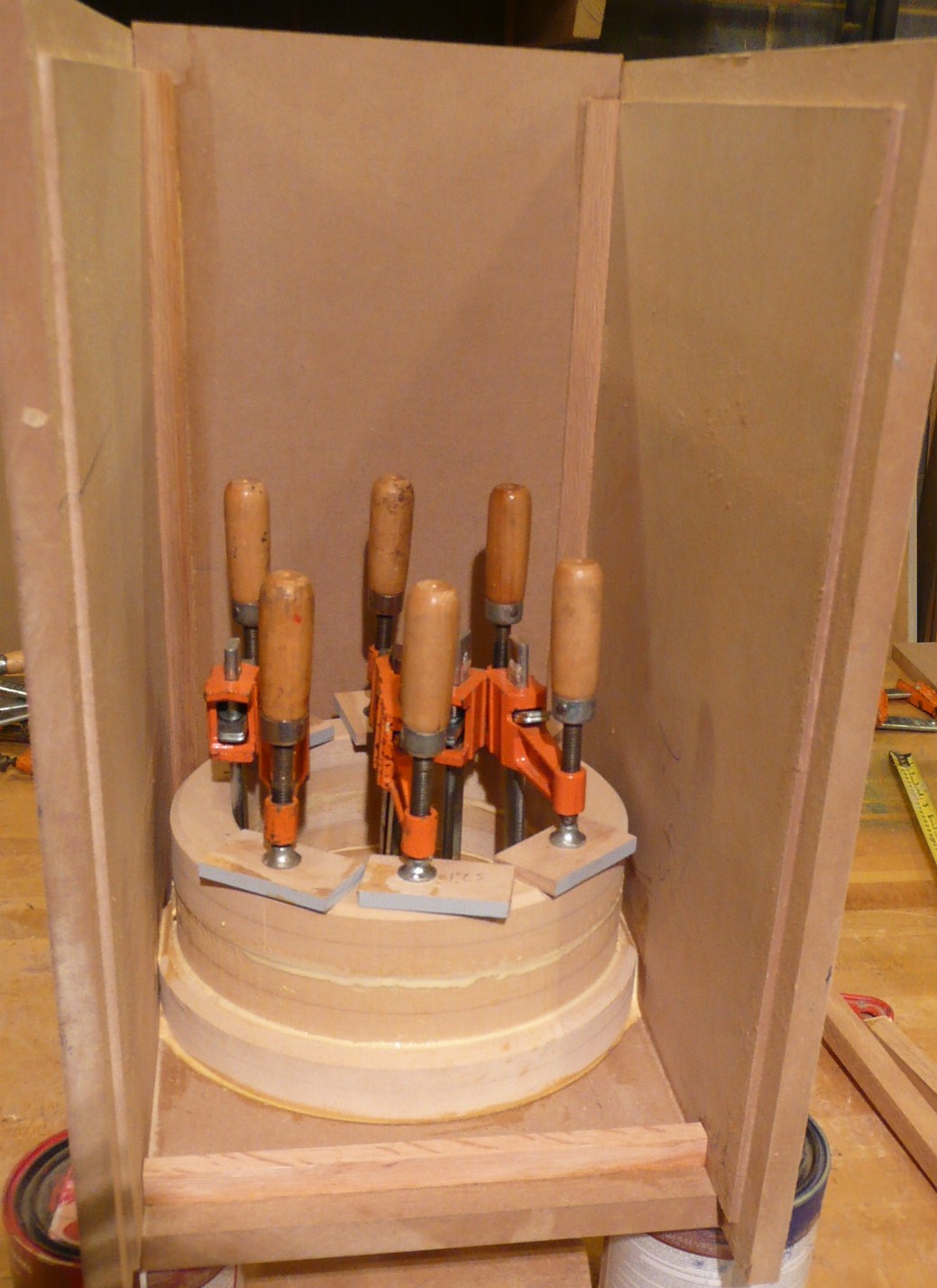

So anyway.....here's a few construction tips for someone interested in a Iso tunnel.
You have to careful to make the tunnel long enough, check that out thoroughly before you get started. I came up with 5" - no less!
I laminated 2 - 3/4" pieces together 3 times + the 3/4" baffle = 5".
Don't forget to add in the front baffle board.
***7 pieces total****
To get started, cut the outer rings first, I went 9.25" OD for an 8" woofer, which needs a 7" ID hole/tunnel. (I hope you get that)
The 1st photo, don't toss the scrap pieces ~ that's the holder for when you cut the inside hole, just clamp it back around the disk, this is much safer also.
The second photo ~ looks good right? Too bad they are not candles. Once you get your pieces cut, start laminating them together. I did use a couple of nails to line them up while the glue was drying.
Oh btw, I doweled a piece of hardwood in, bottom/front, do reduce nicks (-;

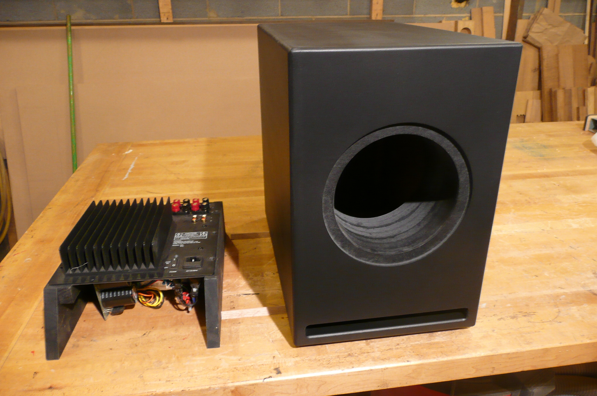

So this is going pretty good; started it yesterday. I did have to run to a hardware store and pic up gallon of white primer for $12 and asked for 1 ounce of black tint, since I'm going black.

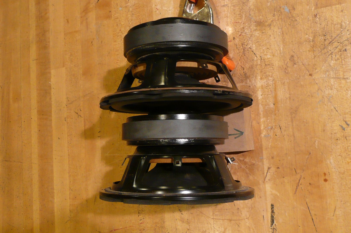

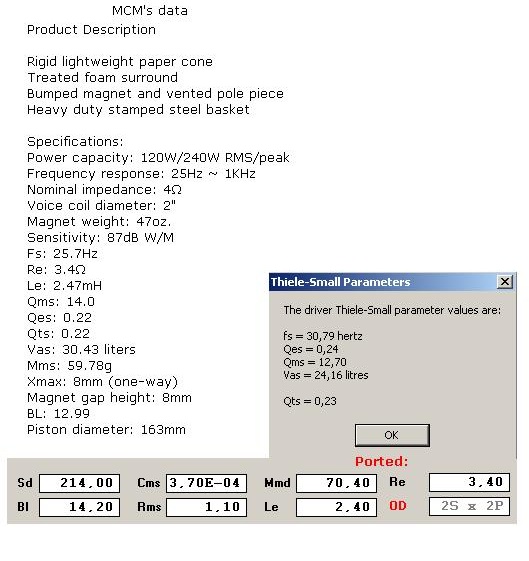

Hi revboden,
The T/S parameters in Post #60 don't look correct.
I got some of them from bjorno crossed from others who have measured the drivers and averaged them.
The crucial points of the Ts parameters are very low Qts, low Fs and
modest Vas - point to a relatively heavy cone driver with a big magnet.
Consequently any isobaric arrangements are near pointless - always.
like I said ages ago, this is simply not a driver where isobaric works.
It works best one its own in 10L to 12L with a PR.
rgds, sreten.

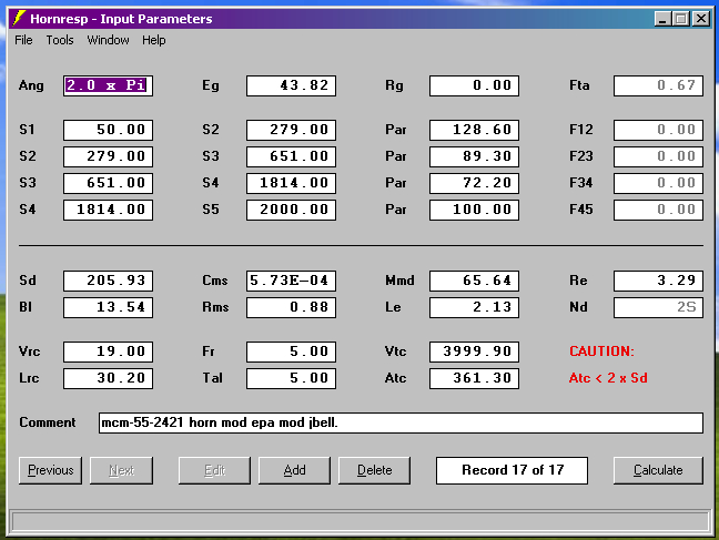

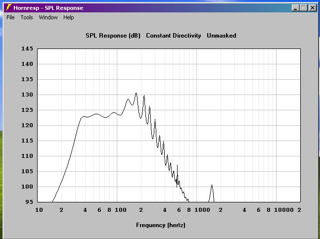

I could build a full length "straight" horn; there's a dead spot here storage, ect. The only restriction is the height, which is 32".

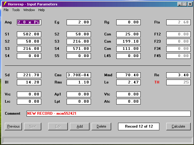

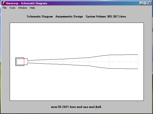

I've been messing with this for days. Then I came across the other "make a horn around the mcm's" thread... My design is so similar to epa's it's silly, just longer with one more segment and a similar choke at the start of the horn just like the TH design above. 🙄 I cannibalized some of epa and jbell's ideas and came up with this.

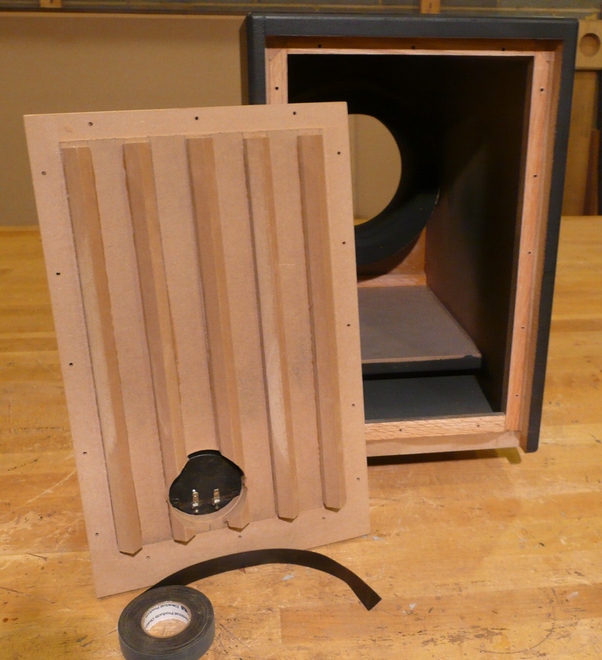

Clamshell Box
I did find old pics of the smaller box ~ but they are all gone.
If I was to build another one, I think I would attach the bottom with screws and make a long slot for the port; also screwed in through the sides so it could be adjusted/tuned.

this sim seems ok to me.Hi Odougbo,
best,
rev.
have you converted it in to a plan?

Sub #4
Sreten, tell us what do you really think, don't have to sugar coat it.
I know you are not a fan of isobaric and this design in general, but folks, it rocks the house and shakes the floor; in a HT and in a 2.1. The bass just pours out of these speakers, and sounds great at low levels.
It's a shame Sreten will never hear them (and I think he has a couple) and only going by....well, I really don't know where he's basing all the criticism.
It doesn't matter to me really, I have tried/build lots of subs, probably keep building them, maybe I'll find something better someday.
I would like folks to know, I didn't just build one, and now I think it's really cool. I have built 6 BR boxes, 2 clamshell and 4 tunnel boxes with this woofer. So I did put a lot of time-energy-thought into these. I did follow a long path, which lead me here.
Again, I don't know what would come close to this "budget project"; $30 per speaker (sale price) and a sheet of MDF.

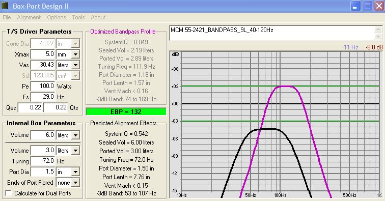

Who said I didn't like isobarics ? They are great for the right drivers,
and the right circumstances, they typically allow drivers to be used
for a case when the box for one driver is too big, you can halve it.
And a poor / pointless choice for the wrong driver, you keep saying
they are great going by ..... whatever. I have said the 30Hz vented
isobaric version has a box that is far too big with a big peak at 30Hz,
that the two drivers used normally in the same box will sound better,
go just as deep but avoid the peak, and go 6dB louder, effectively
quadrupling the apparent amplifier power over the isobaric as they
will also be 6dB more efficient.
Literally twice as good, its like having two of the isobarics.
Your right of not a fan of this "design" because it isn't one IMO,
it models very poorly, suggesting wrong design decisions, a more
thought out proper design has overwhelming advantages, done right.
You seem to be saying you can't see what's wrong with it .....
Do some modelling and you will soon see, isobaric with this driver
costs an extra driver and a beefier amplifier for no real purpose,
and you end up with silly small box sizes for the best performance.
rgds, sreten.
