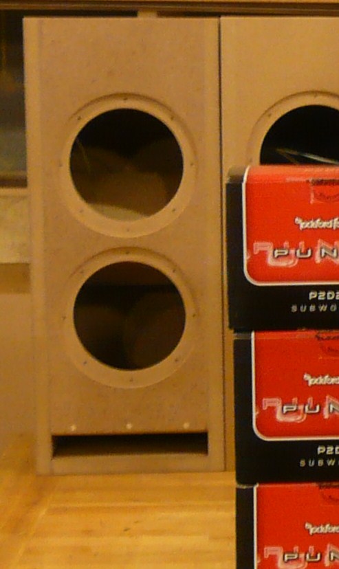

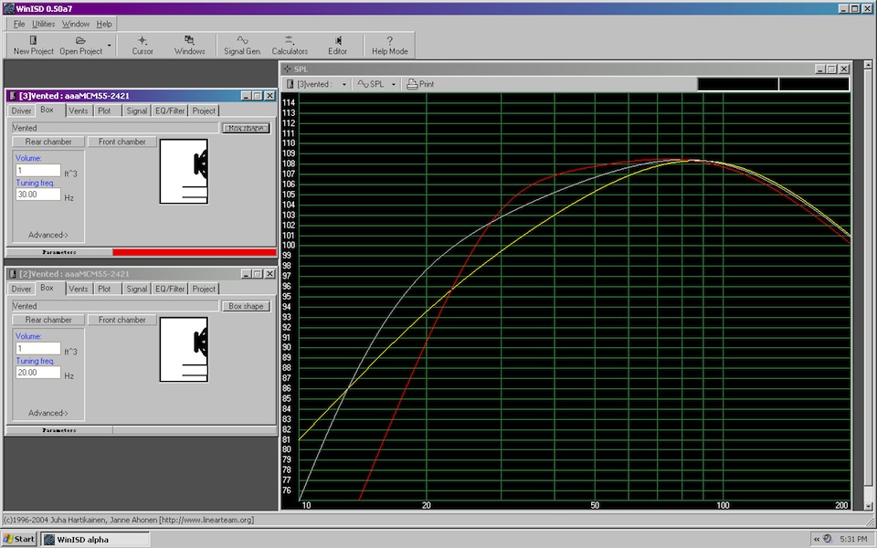

Btw in the pic below the yellow line is sealed .6cf
also: all with two drivers per box

A .6cf cab would need to be 19"T, 9"W, 6.1"D Inside
Considering: the size of the woofers, stacked one on top of the other.

.65cf with two drivers gives a Qtc of .505. That's about as low as I would go.

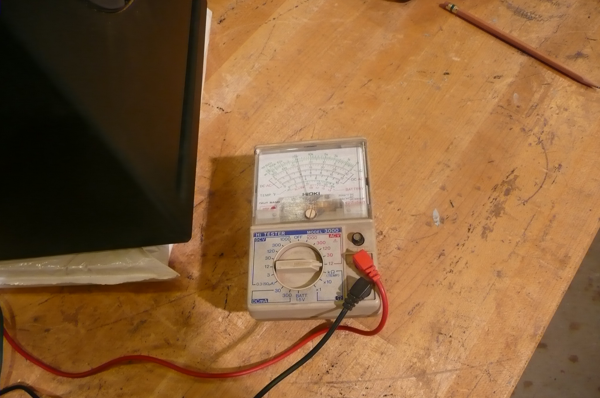

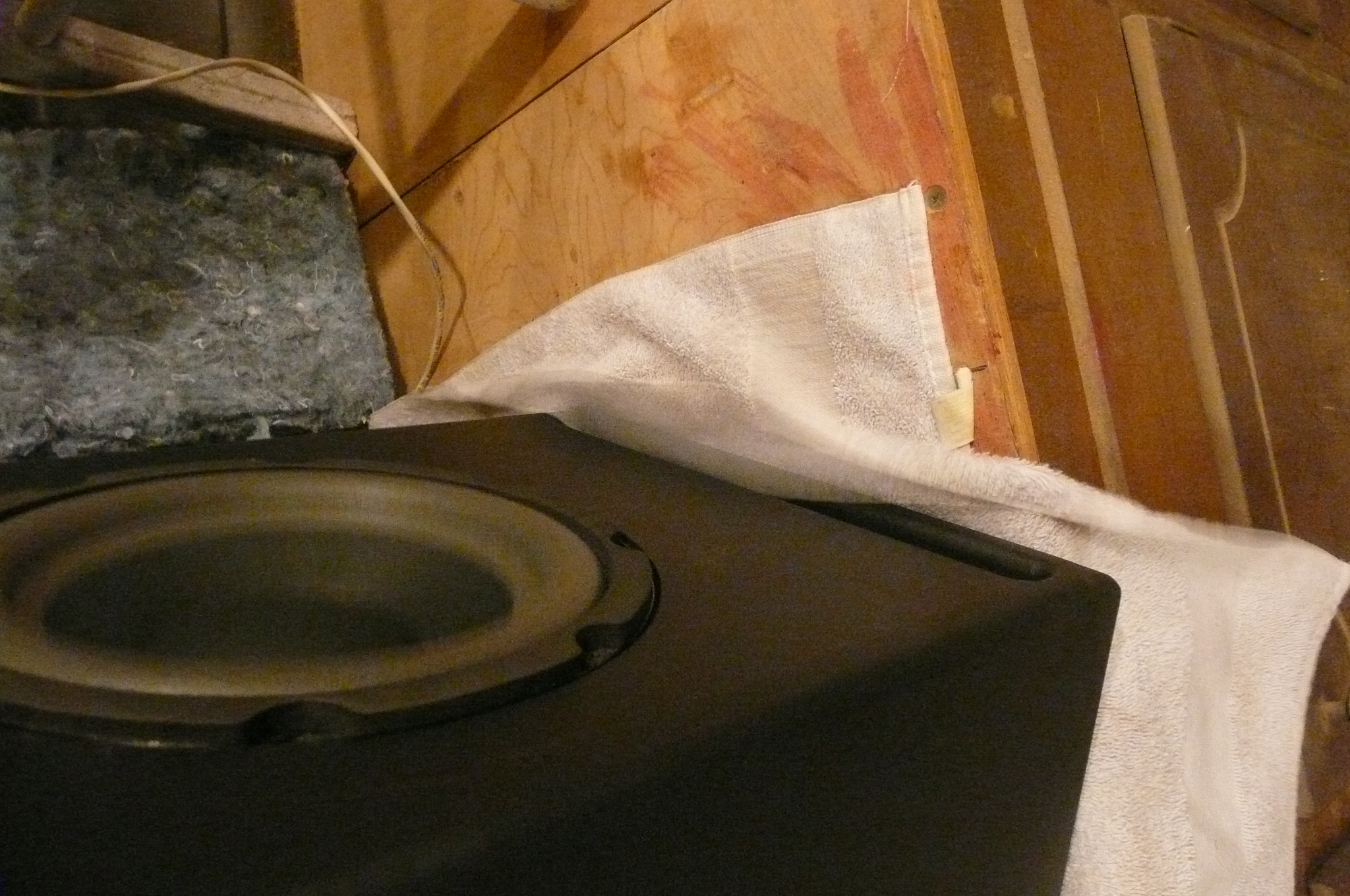

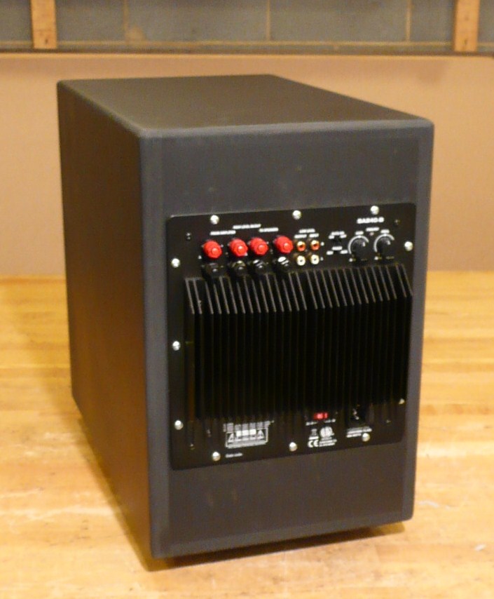

I would like to go back for a minute, back to the original post. I put the SA240-B in one of the boxes (3/4" MDF)...wow! I should have spent the $99 bucks and bought one of them long ago. When I moved the sub to a towel, it almost sucked it in (pic 3).
The source is a Hip Hop HD digtal radio station and I did take a few video clips.

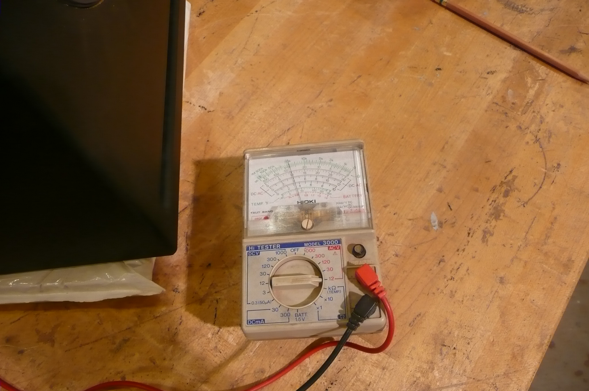

I took the die cast woofer and put that in a un-powered Iso box, and checked the tuning for the heck of it; using a stack of resistors, volt meter, generator.
The 2 peaks are even, at 20hz and 40hz (other pics), the valley is dead on 30hz. I know ~ probably just got lucky, however the bass is near deafening.
The box is just sitting on a bench, middle of the room. Also note, the 4ohm woofers are wired in series 8ohm total.
I did a sweep test, no mic, but what I could tell:
> There's a slight ripple (or peak) around 55hz
> Somewhat smooth overall
> 30hz - 32hz it gets going pretty good, everything starts shaking.
> 25hz, some bass if you walk around the room.
The weight of the speaker with amp is 60lbs.

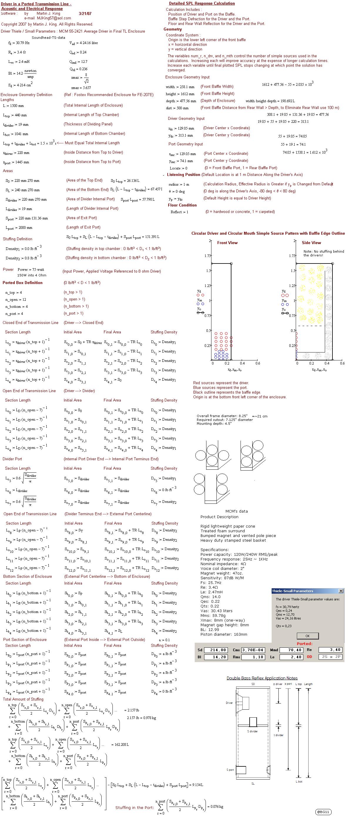

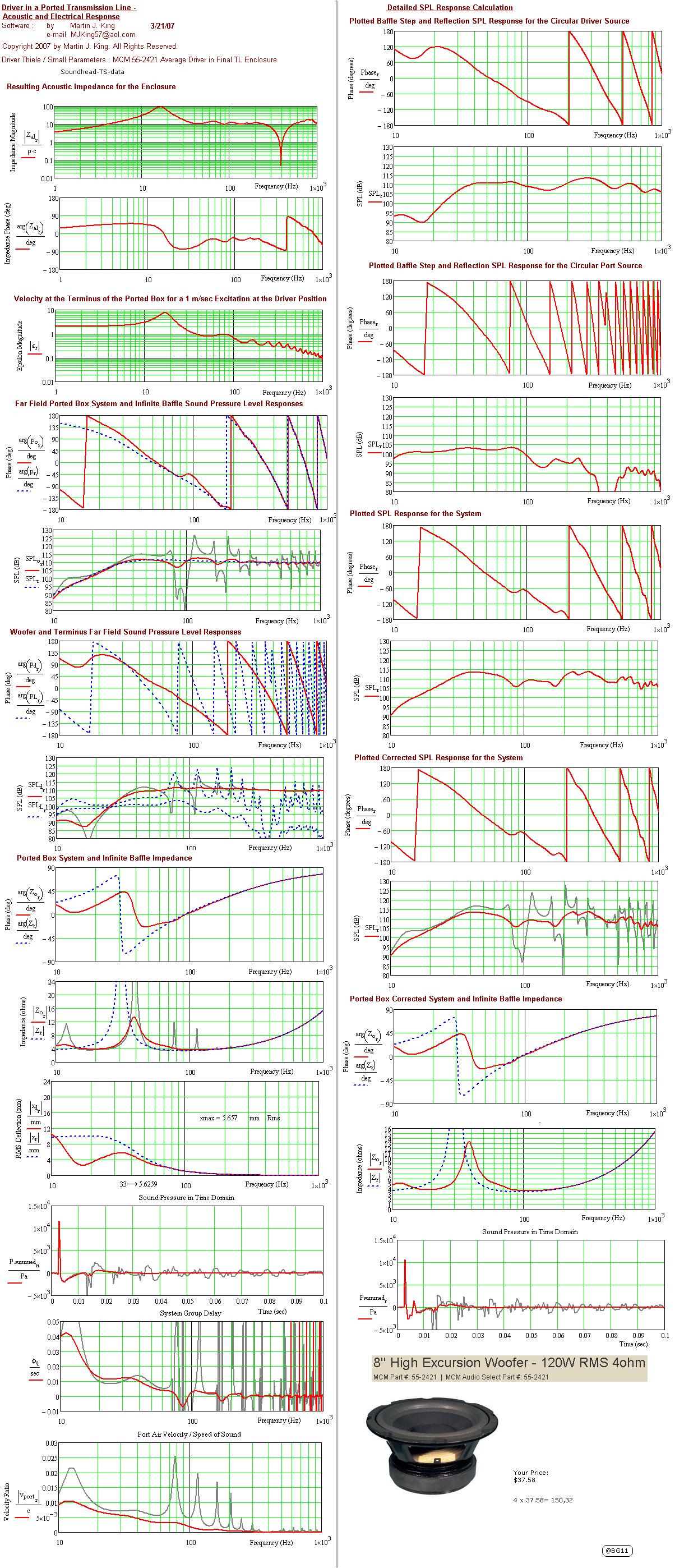

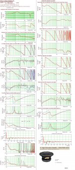

Using Soundhead's measured T/S for the the MCM:s in a MJK DBR simulating program:
PS. Note the odd placement of the damping material needed for best taming a bunch of these drivers in a quarter-wave design (IB).

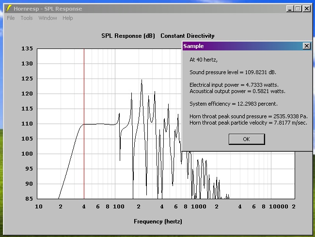

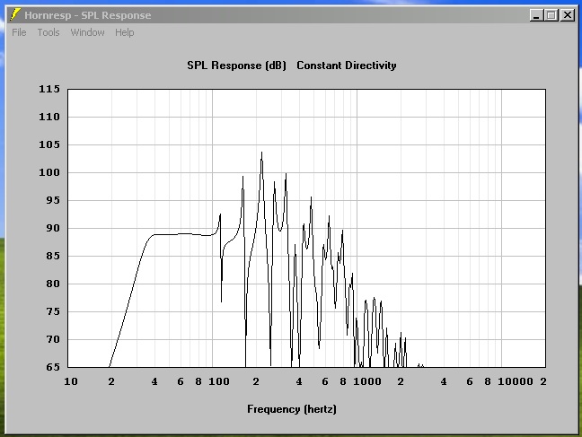

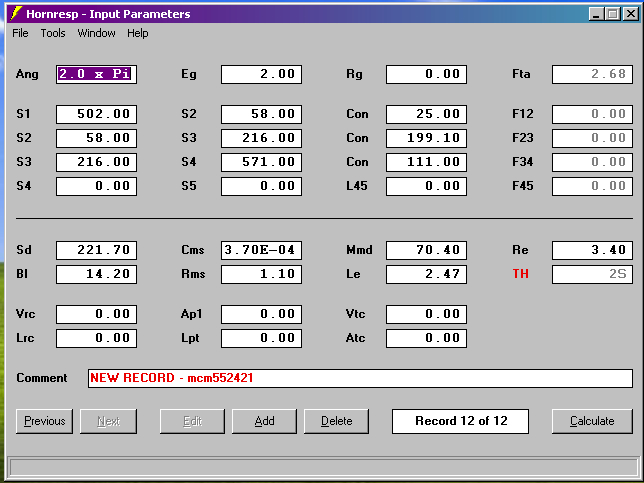

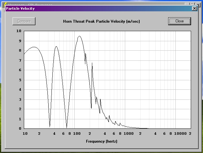

I think I figured this horn thing out
Odougbo,
hope you don't mind me posting these for ... well whoever will look them over.
