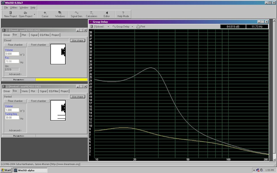

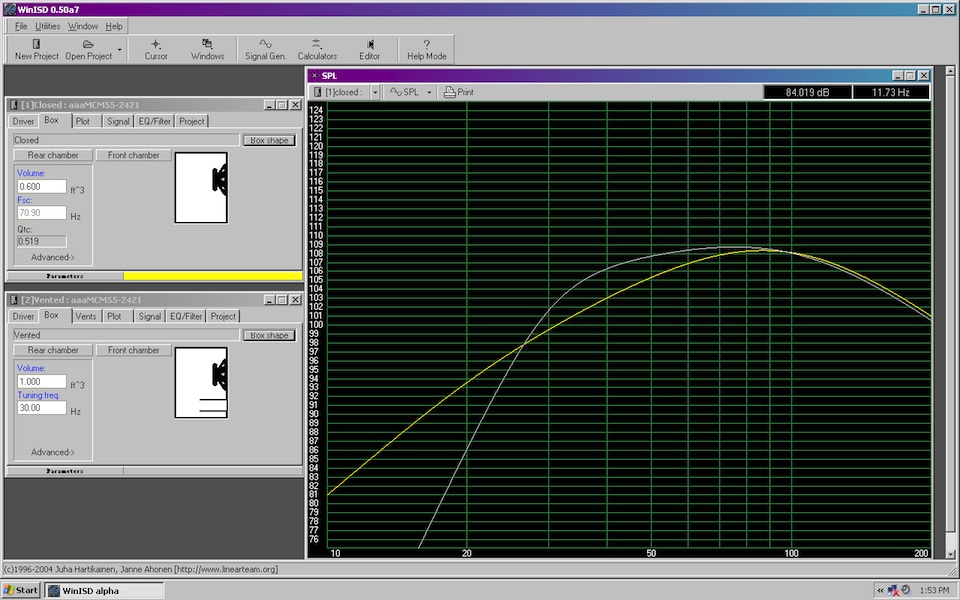

That's exactly what i was thinking, although the problems with tuning that high (yes, i think 30Hz is high) will muck up the low portions of bass guitar /drum. where as with sealed you get better group delay although at the loss of some output of -2db at 30, -3db at 40, -2db at 50hz. (i'm limiting power to 250w based on the rms of the drivers + HP at 30 as any signal below 30Hz will be phase canceled anyway)
Horses for courses, the point of venting or PR's over a simple Eq'd alignment
is maximum SPL at low frequencies which is far better for vented / PR'd.
Yes group delay always looks massively worse, but who understands it ?
They are 8" drivers that will work in 12L per driver vented subs and if
you really want to go tiny 6L per driver sealed, probably with EQ.
As detailed in the Silly thread PR's are almost mandatory with this driver.
With this driver PR's are the way to go and you'll get a far better result
than sealed, you can make an outstanding ~ 12" cubed subwoofer.
rgds, sreten.
... I do...
rgds, sreten.
Of course, you'd have a heck of a time fitting an appropriate port in a box that small.
... I do...
So do I, if you want a set of Q=0.5 sealed subwoofers to spread around the
room its a fairly good to very good driver choice if you have enough of them.
For one driver in one box the compromises are somewhat different.
Nothing wrong with low tuning here, it will simply work better.
It won't muck up low bass, quite the reverse in practice.
rgds, sreten.
