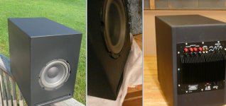

MCM 8" 55-2421 Isobaric
Glad to answer, I'm sure many will find this painful.
When the speaker is out of the box, there is only one peak.
In the box - that same peak gets pushed (like a air balloon) into the M.
It does make sense that the top of the M should be level and the bottom of the M is where the peak was.
ALWASY connect volt meter to speaker leads! Easy to remember.

Thank you Patrick for your input.
I never encounter any lack of bass issues; quite the little monster. I've use 60 watt stereo amps (bridged) and inexpensive plate amps. They all had plenty of output.
The one my buddy has, we used the $119 Dayton with the "B" it sounded great and he's thanking me every time I see him. The B is 40Hz bass boost.
If someone does build one, it will need to be a solid box, with attention to a well cut tunnel,,,,,if if it leaks all over, I don't think it would work.

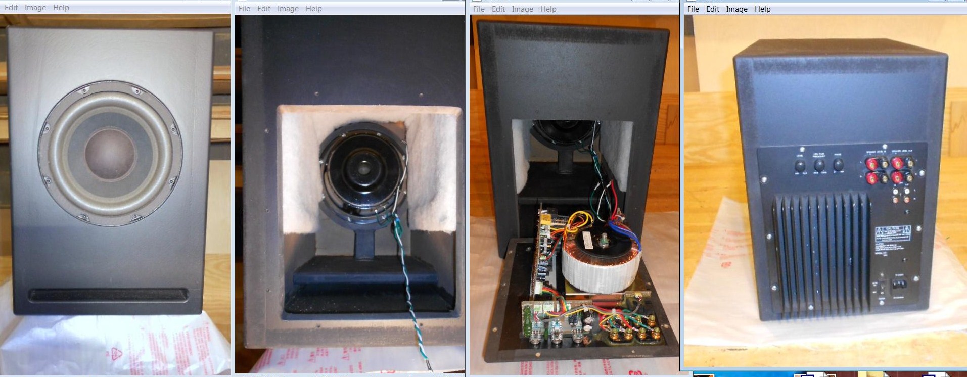

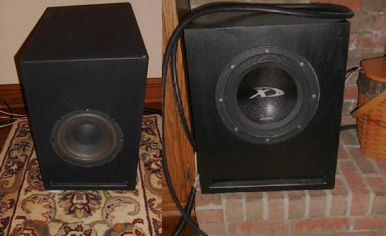

Here is the latest; going to take this to a buddy's house and do some horse trading....to get back a large Alpine woofer that let him borrow.
btw, Lurking on the "Collaborative Tapped Horn Project" - would like to build one soon.
Patrick,
I saw a pic on another thread.... looks like you may have 55-2421's, how many do you have?
The thought here was one sounded great in a simple BR, but would bottom out the 1st "explosion". Yikes!
By adding 2nd in the 5" air tight tunnel, the power handling goes way up, suitable for HT.
I remember a lot of people saying they have these laying around, I suggest they give it a try.
The box here was double layer 1/2" MDF ($25 bucks).

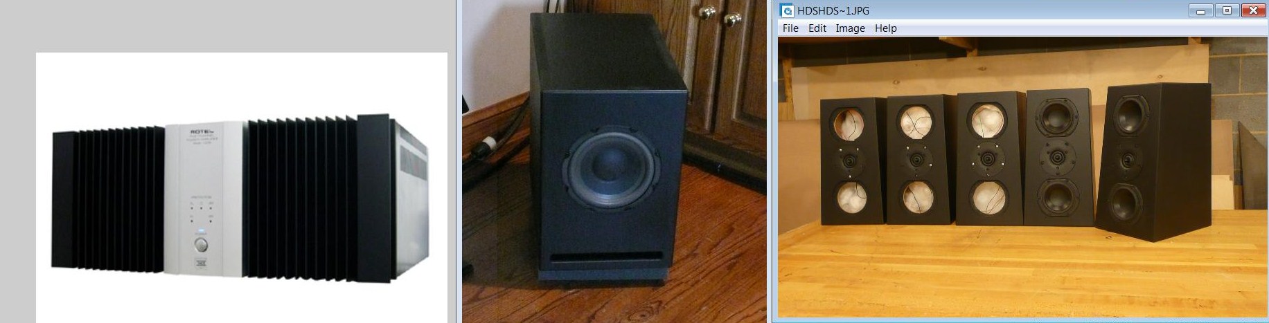

5.1

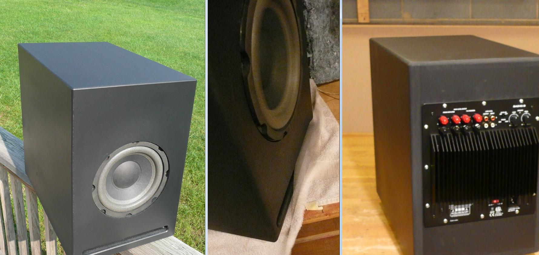

Hooked this up yesterday; very happy, the box sounded great, a very defined, deep base.
[huge, huge, HT/Pool Table room, the HT is on the "wrong" side]
By just popping the outside cone with knuckle, there is a deep bass sound; not a "Boom" a deep "Biff". Easy to hear the bass coming from the port.
I liked the improvements, a small sheet on damping material (which is pretty light/see thru) and the cork liner. btw, this box did not have bracing, but is 1" MDF.
I would say the drawbacks are:
* Not going to handle a Gobs-of-Power, and/or would need to use low pass filter or limiter. I.e. huge motor with a floppy cone suspension.
[although the plate amp is 200 watt]
* The weight, it just looks small, it's heavy - the slot is handy for lifting.
* Would need pretty good carpenter/router skills, the tunnel should be air tight.
The 5 channel amp is a RMB 1085

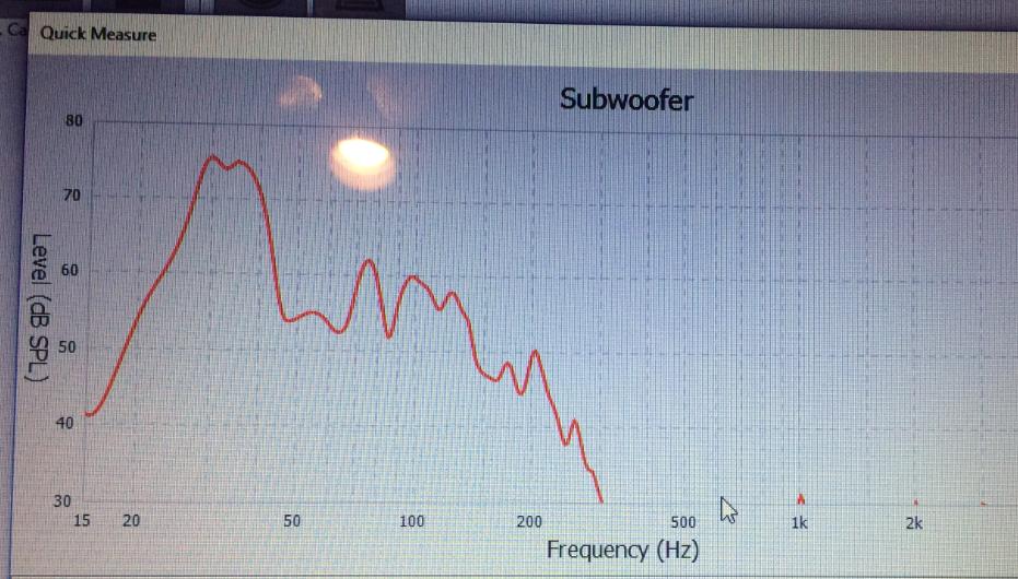

55-2421 - ISO Box with tunnel
Well finally....here's the in-room response: factory rebooted the processor, and there's no boost or equalization. The only filter is @ 100hz, 12 db (or18db) per octave.
As we can see, the usable range is short but sweet!
One major plus is that it does not require a lot of power, but will handle quite a bit with a subsonic filter.
2nd plus - the MCM 55-2421 is $29.
3rd the ISO box is compact.

Hi ODougbo,
Is the frequency response form Post #191 (Dec 04, 2016) form the box(es) in Posts #174, 186-190 (Aug/Sep 2012)? Time flies, doesn't it? That response is a bit on the peaky side, but if it works for you that all that counts. 🙂
Hi Oliver,
Post # 174, that's it, well there's three and I gave one to a buddy, but they are the same. It is hard to believe the 15db roll at 45hz, but removed all the filters and didn't hear any difference to the bass. Which could be perfect for someone starting off and wanted a sub and all they had to work with was RCA, Y connectors and and extra 60watt receiver.
That said I picked up a Dayon SA1000, it has some eq features built in, but as mention above, didn't see/hear much difference when adjusting them.
So yes sending 500 watts to two MCM 55-2421 (switched on the sub-sonic filter), the cone movement is not bad at all, less than 1/2", at a nice HT level.
The setting for the front L-C-R -- 40hz (or pass-thru) and the MCM Iso box fills in the rest of the lower end.
One more thought, there are several boxes here, so far this is working the best, better than the 10" Alpine and an Anarchy tower, they both have similar narrow peaks at 35hz.
I know the answer here, but going to ask anyway, can I check the MCM box, with a db meter and generator, outside away from the house? Simply plot the readings one by one 20hz to 80hz?

Another question, the box does not have any fill, what if it was stuffed it up?
Would it be enough to lower the peak?
Thanks!!

not likely. the peak is a function of the design. stuffing it, or even heavily lining it, will only serve to lower upper band response/peaks. could also muffle some nasties that may be making their way out of the port (ie motor noise, etc) heavy lining or stuffing could also reduce system sensitivity across the band.

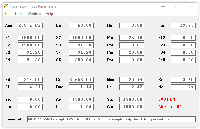

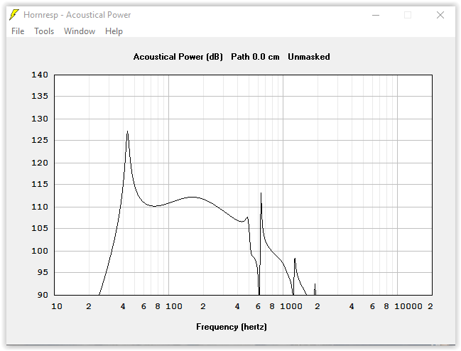

Hi ODougbo,
For measurements: maybe using REW would be easier? But, the method you describe would work, you have to be aware of reflective surfaces, sometimes you can get better measurement using a wall, or even a solid external corner.
Post #195: "...the box does not have any fill, what if it was stuffed it up?"
I made an example simulation in Hornresp, you can import it, and play around w/ the volumes, dimensions and filling. I did not try to calculate your box, or duct, etc. Usually you don't need filling in subwoofers, but in this case: filling will work if done correctly.

Thanks for posting that Oliver, 44liters is a very reasonable size.

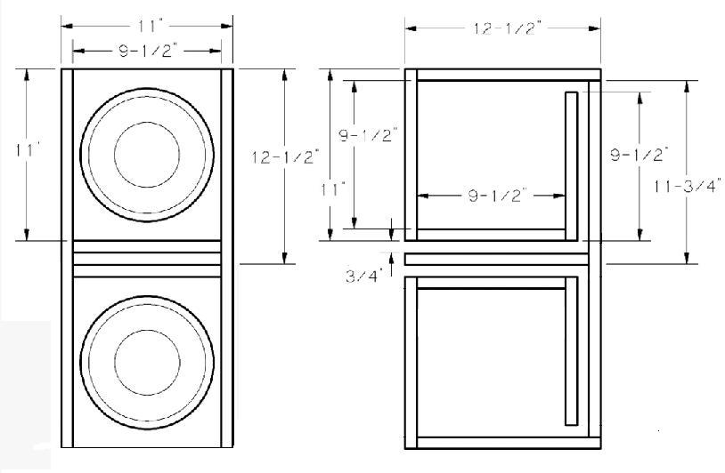

Here's another concept design, I believe this may work better than simply putting two of the woofer in a BR box, but if not, it's still very compact:
Hi ODougbo,
You probably are aware of this, but for a symmetrical layout as in Post #198 you don't need a center divider board in the port.
Cork board works, but it will reduce the internal volume (about by the volume taken up by the cork). Some felt would be better, even thin carpet underlayment felt will work.
