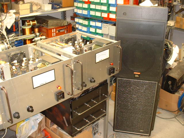

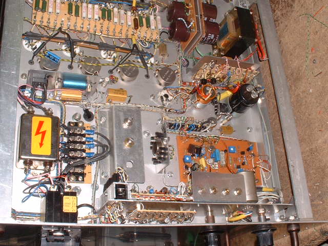

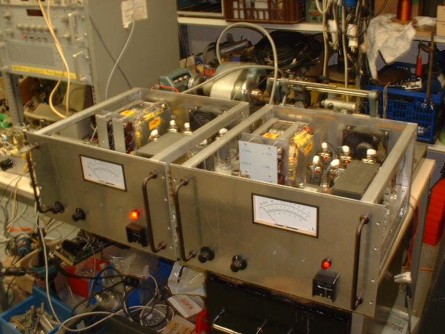

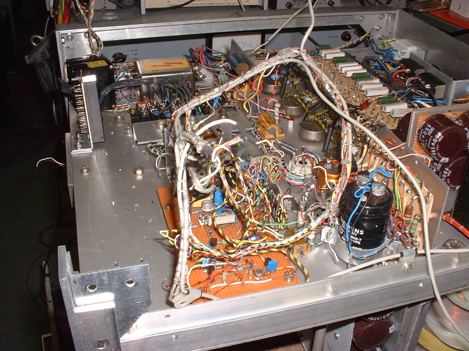

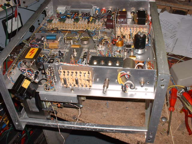

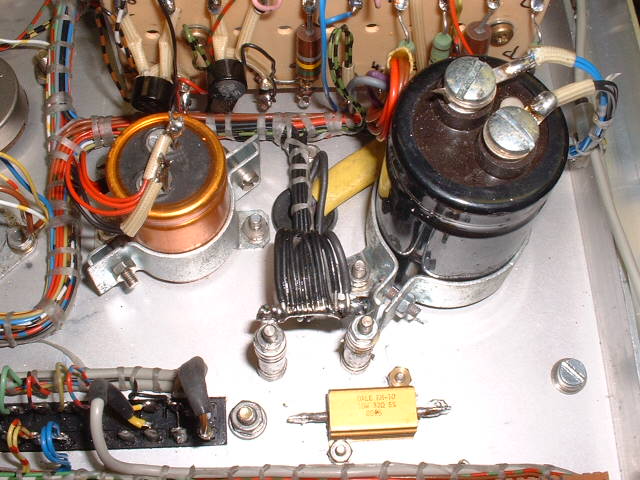

First amp modified
Hi Folks,
today I finished the modification of the first amp. So now both amps look like the same. Tests results with comuter based tests coming up in the next days. I use the "spectralab" software and an external sound interface.
The modifications are :
New front panel with only a single meter.
The potmeter and the switch are now based on a internal subchassis. So if the frontpanel has to be removed for repair work, the switch and the potmeter remain on the chassis. I must only remove the knobs.
The 4 capacitors C18-thru 21 are replaced against electrolytics with 150 mF.
A time delay for the overload protection to avoid the CB trips at high levels , especially at low frequencies. The CB trips at 2.2 Amp cathode , and at 350 mA screen grid current.
Meanwhile I get another 50 pcs 6p45S tubes. Now I have enough tubes for more testings.
Here some pics of the amps. Now its 0400 h , local time. I go to bed now.
Thanks for interesting in my project!
73
Wolfgang

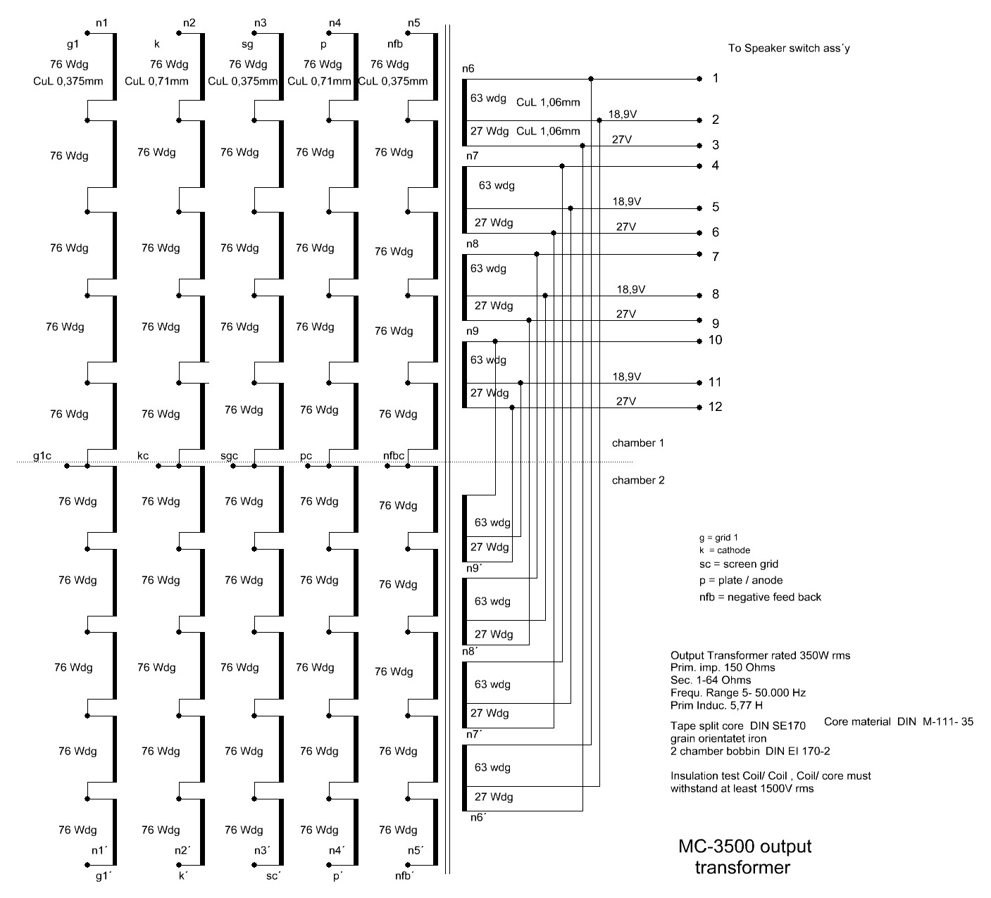

I completely took the transformers apart (also to see how they were wound...). The parts (EI laminates a.s.o.) are in a box. As pointed out these transformers had "bifilar" wound primaries, and secondary sections in between the primary sections. Because there was no interleaving/isolation between layers (also not between primaries and secondaries.....) the coil looked worse with every next layer.
You can start winding bifilar, but to wind a complete coil this way you must apply interleaving not to loose control. At the end the windings completely lost their "bifilarity". Yes as you call, the coil looked scramble wound, and that's why they failed (not impregnated - resonance - insulation break down).

Hello all. I'm not new to this board but it is my first post so please forgive me if I'm clumsy. I've been building tube amps for 50 years and currently building a version of the MC3500 with some twists. My question is for 73 Wolfgang DF6ZC. I see in your pics two diagrams, one of impedance selection via toggle switches and the other looks like a winding chart. I'm wondering where you got these diagrams because they are not McIntosh data. I'm not implying that it wouldn't work but it's not what McIntosh wound. Is this what you made?

Did you miss the first page of the thread? The winding info seems to be all reverse-engineering between several members.

Thank you for your reply. I've read all the pages on this post but I can't tell where these diagrams came from. I have repaired MC3500's and MI350's in a past life and I know this is not how McIntosh wound the secondaries just by looking at the schematic printed on the OPT or the service manual. The secondary windings are what Daniel said 25th Feb, 2009 and Cerrem said 23rd Nov, 2011. I do understand how this winding scheme would satisfy 1,2,4,8 ohm loads but McIntosh didn't offer a 2 ohm output and did offer 50 and 64 ohm outputs which can't be achieved with this winding scheme. Also McIntosh didn't use toggle switches to select output impedance. So where did these two diagrams come from? Hats off to whomever figured them out.
