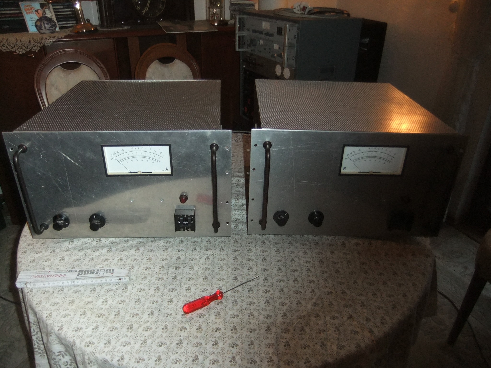

Hi Folks,
wow, another year passed by with huge steps. I can´t believe it. My repair works on my house go on. I got a new kitchen, my office is already paint , got eletricity and is online with a new fibre optic internet with 250Mbit/sec. and the central heating works
My living room need to be paint. A friend promise will help me , paintwork is not my job.
And finallay I got my McIntosh replicas into my living room. And had several soundchecks . I´ve got a pair of JBL JRC225 2x15" PA Speaker, they not ideal for home listen. But at first it is better than nothing. My JBL control 12 cannot handle the amont of power , i´m fear of damage them inadvertently, by cranking up AC/DC tunes.😀
It sound as exspected , my room has a self resonance at 35Hz. So its too much rumble , but me and a mate work on a solution.

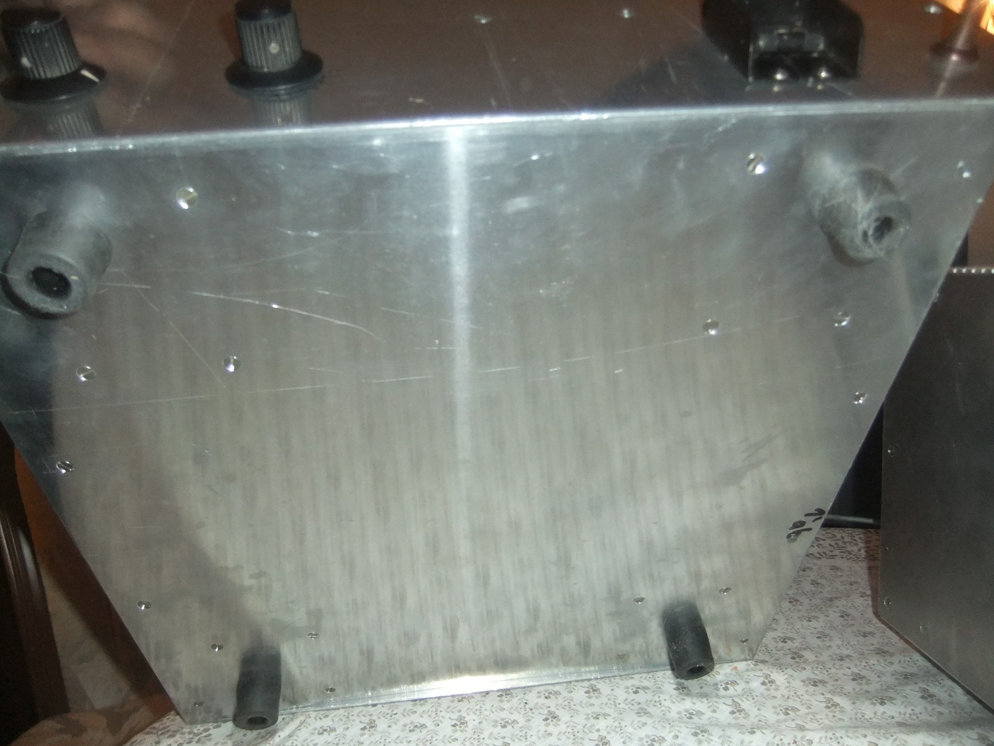

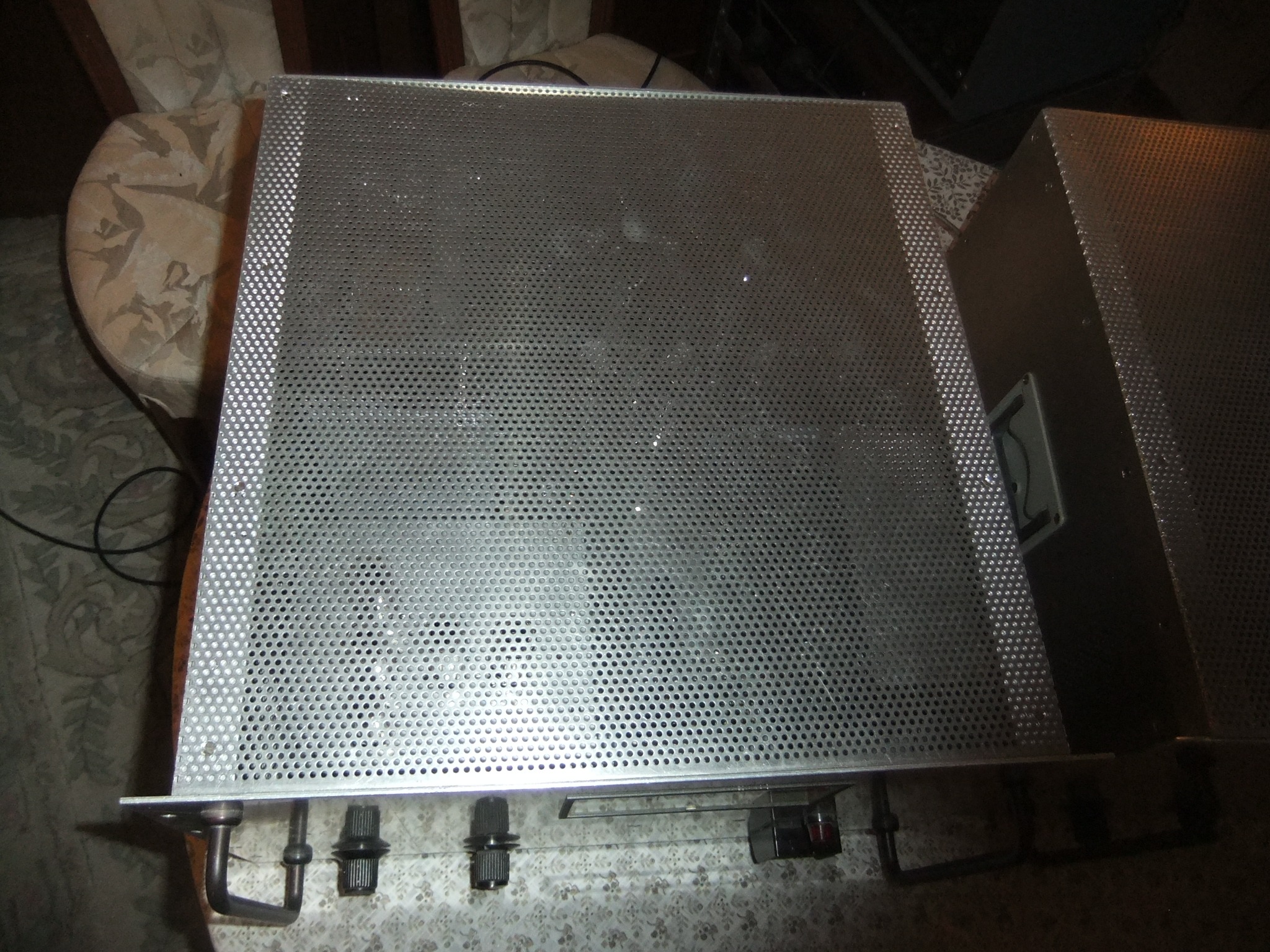

I finished the amps by fitting a cover and a bottom plate with rubber feets.
I recently got a load of unused 6P45s tubes , sold by a widow of a silent key. Now I hold a stock of abt 160 tubes. enough for a long, long amp life. 😀
I will make a suitable pair of speaker by my own with the help of my nighbor. I´m not good in woodwork . But it will go on when all the renovation is finished. Until then the JBLs are there to blow the windows out . I use the JBLs normally for outdoor activities in my nighborhood
My 1500W GU-81 project ist also on suspension. The second amp is nearly finished.
Here a the pics with cover and bottom
from left to right:
JBL PA bins, both amps side by side, bottom with feets, cover from perforated aluminium sheet.
73
Wolfgang
