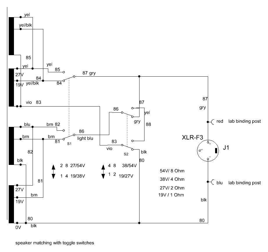

I made the secondairies to my own speaker impedance seletor. Since the original speaker switch is hard to get I considered a design which employ only 2 standard toggle switches . I made the secondairies in this way . I hope the drawings are readable. The toggle switches selcet between 1 / 4 Ohms and 2/8 Ohms
here are the drawing:

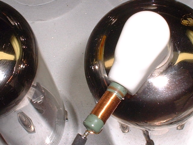

I inserted also some little chokes into the plate leads. I helps but not in the way as I respected. So I put another little ferrite bead on every plate lead, that make the amp much more stable. After spending many more hours in my workshop, I try several ways to fight the parasitic oscillation. The capacitor C / , 39 pF is one of the phase correction device .I disconnected this to see what happened without it, and bingo the oscillation stops. McIntosh wouldn't fit a capacitor like C7 without any reason. What is the real reason for C7? Another improvement was to get the wires from the test meter switch out of the harness and put them through another route to the cathode resistors and point A and B.
see the beads on the thick black plate leads:
and here are my homemade plate chokes:

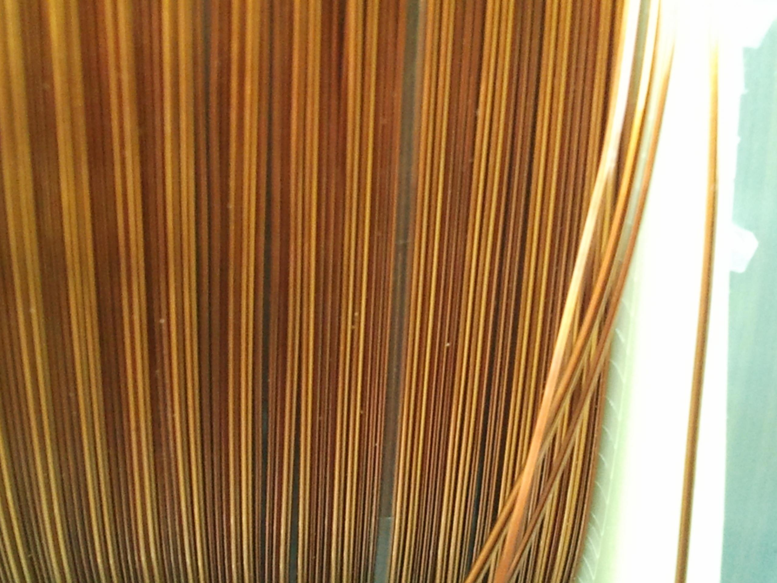

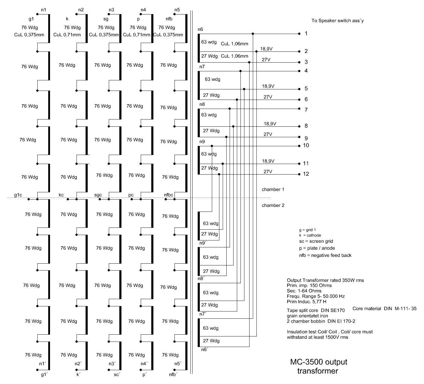

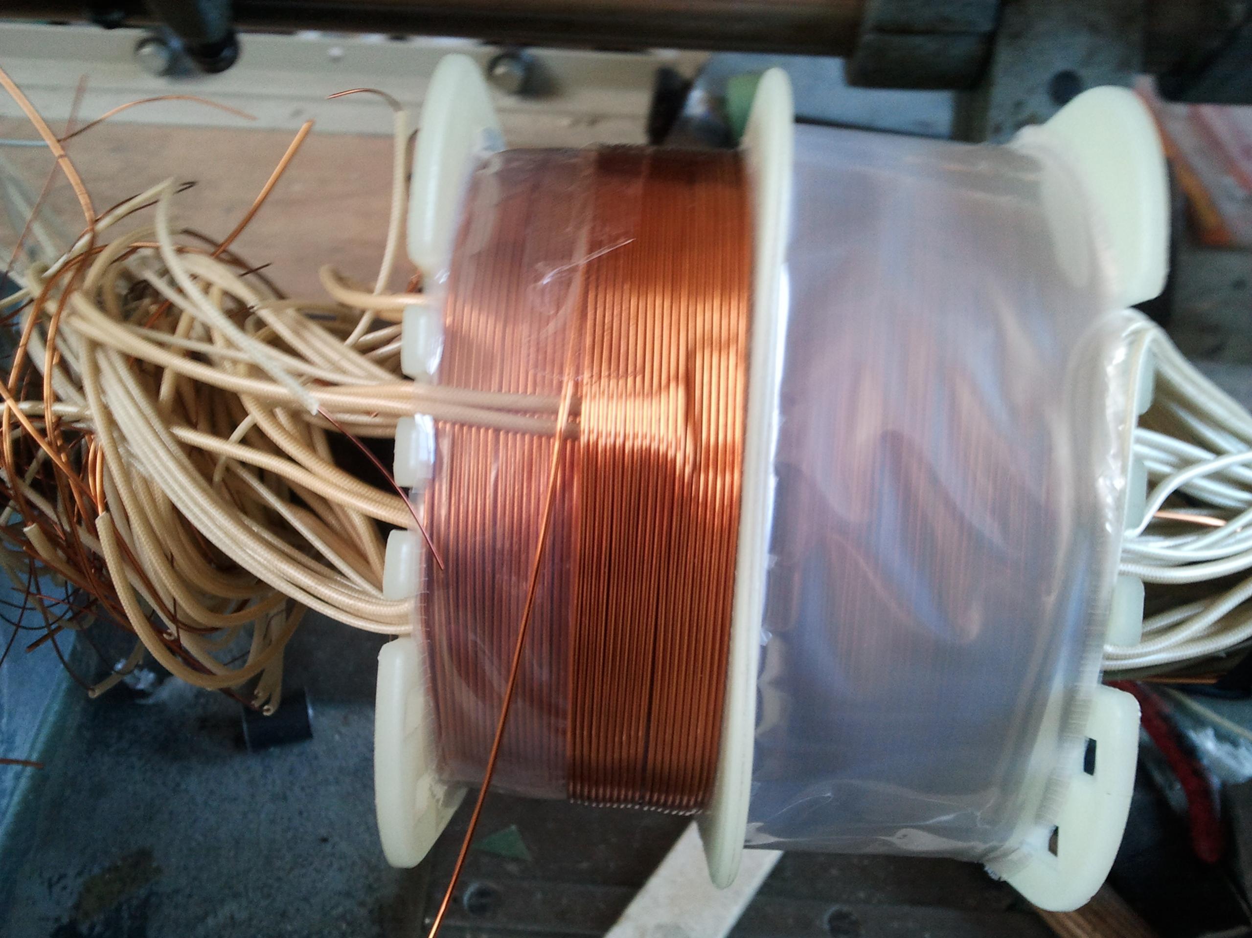

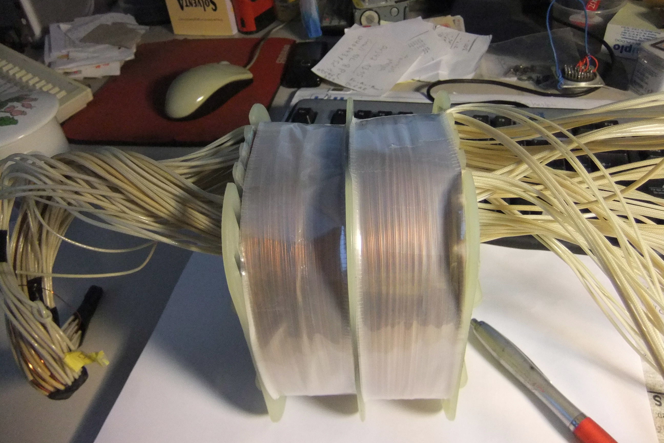

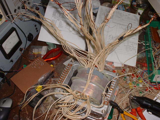

The wire I used to wind the primaries are 0.375 mm for feedback, bootstrap and screens and 0.75mm for plate and kathode. The wire is a special one which is used to wind high voltage Motors with for the 700 and 1500 Volt industrial mains. The secondaries are wound with 1.06 mm wire. Sorry I can´t find a AWG conversations table.
here a pic winding one of the primary:
Here are some more pics.

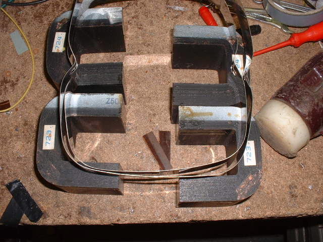

the core:

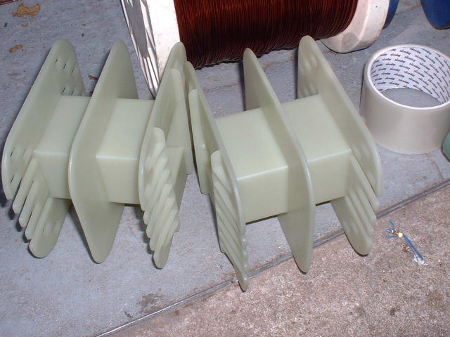

The coil former:
the coil:
the transformer schematic:

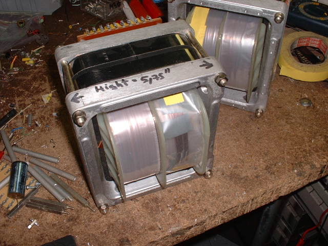

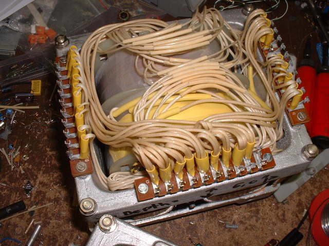

Could you repost some pictures of the completed output transformers you had in post 14?
Also, where do you get or what is the type/manufacturer of the wire you used for the multifilar windings? I ask because I have a whole bunch of Wassner C-cores and have thought of winding a unity coupled type transformer. I have thought of using Kynar wire but because of the insulation thickness it makes it almost impossible to design a sensible transformer.

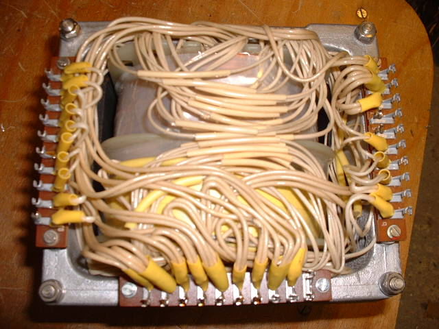

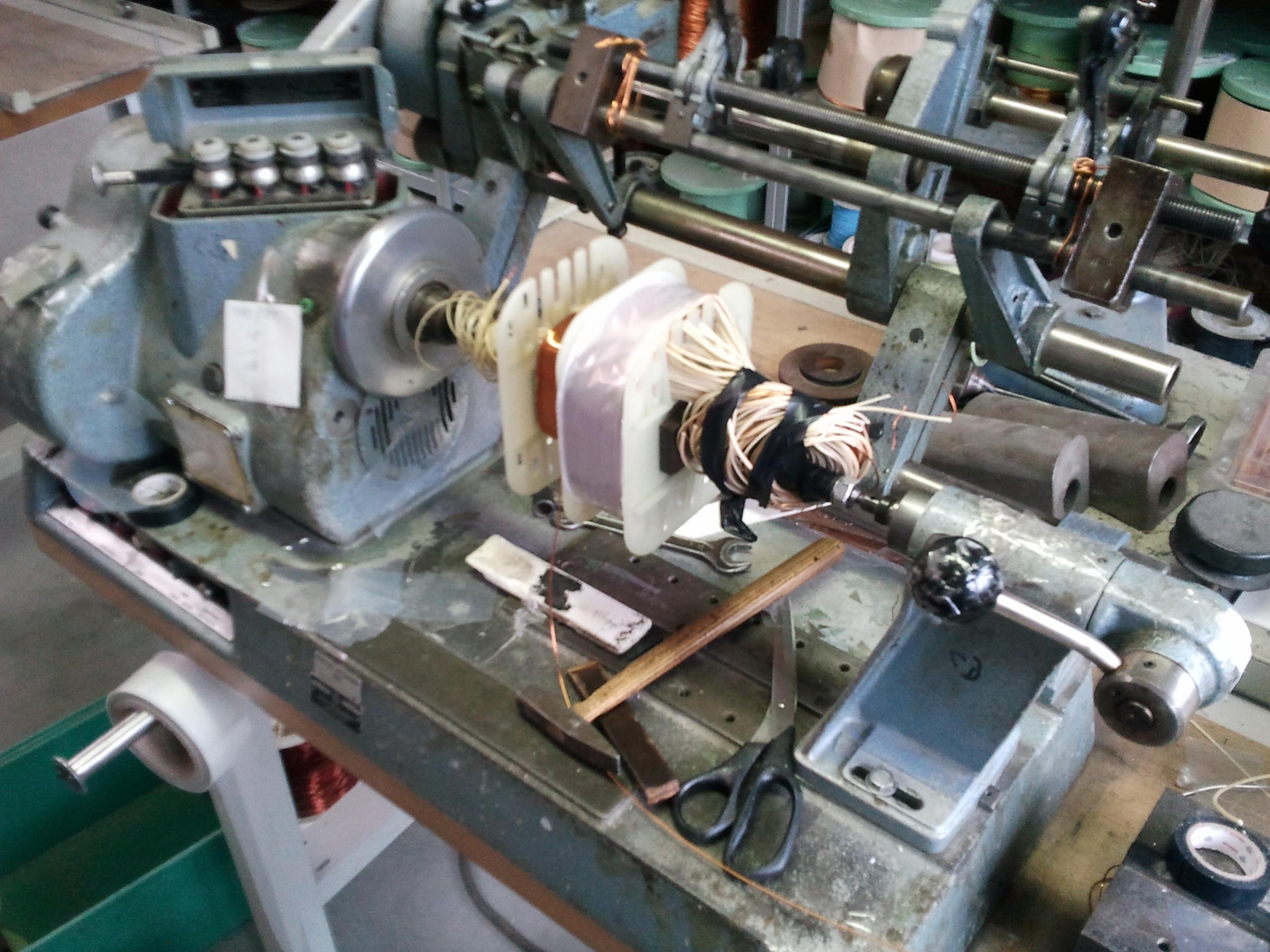

Hi Matt,
here are some pics from the transformer.
I really have no idea what the type of the wire it is. Our local transformer company sold me that wire after I explained them exactly what kind of properties it must have . So they told me about the havy duty wire for industrial motors which are have all the needs for the task. What shall I say. my transformer works. But I´m going to ask about the wire and let you know.

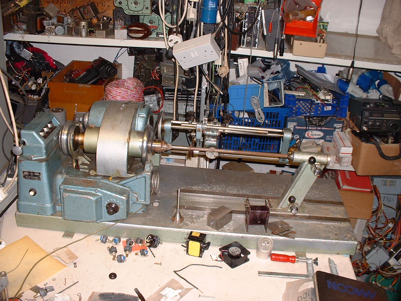

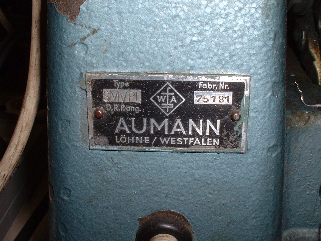

yes it is a dedicated winding machine. It belongs to the transformer company as I wrote in an earlier posting.

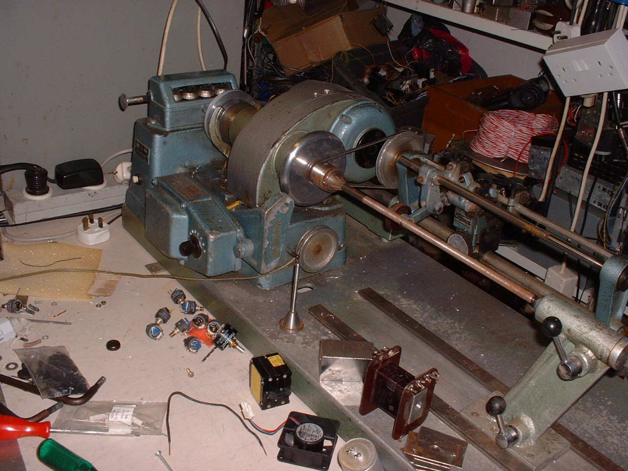

Thanks Wolfgang, that would be great if you could find out.
That winding machine looks identical to the one John Chambers and John Wood use, about two thirds of the way down the page: Champ Electronics - Vintage Amp Repairs

Hi Matt,
I´d a look at champs side with the winding machine. It is a similar machine, from the same manufacturer "Aumann" . It is a very old german company who made only motor & trafo winding gear.
As I told I used the winding machine by our local trafo company. But since a couple of weeks I came across with an old winding machine.I found it in the farthest corner in a second hand plant & machinery shop. The Manager told me they got this item for several month in stock but no one interested in this piece of iron. Furthermore he sad he will scrap it if there is no customer for it in adequate time. So than I bought it for few Euros. The machine works basically but there are a lot of things to . The machine were stored in a humid warehouse for long time and have now a rust film on many parts.
So I will wound the next transformers on my own winding machine. here pics of my "new" winding machine.

Keep in mind that the 8 ohm tap on this Output Transformer is actually a 9 Ohm tap<snip>
Once again great job Wolfgang. Quick correction since I had misunderstood my own notes and data. The Plate and cathode loads are at 150 Ohms for all 4 pairs of Push-Pull tubes. The B+ is roughly 470V at idle. However, the 8 ohm tap is really at 9 ohms, so when you apply the 8 ohms load to the 9 Ohm tap you get an effective Plate and cathode load of 133.33 Ohms.
This now extends the plate load high enough to achieve the 500 Watts like the original amps maxed output, the B+ will droop to about 400V at this point.
Wolfgang... if you truly made 8 ohm taps on your secondaries...this would explain why you only reach 450W.

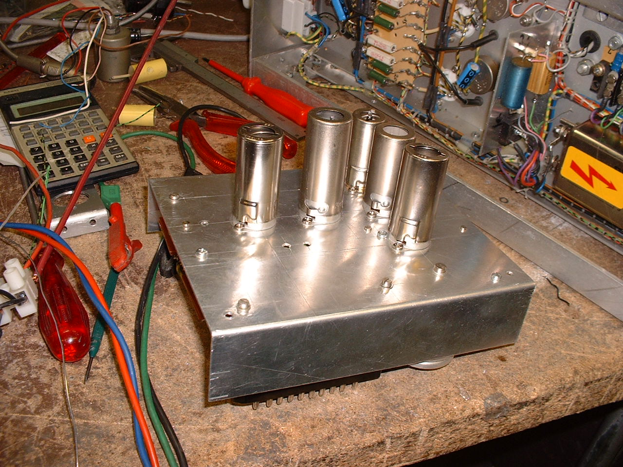

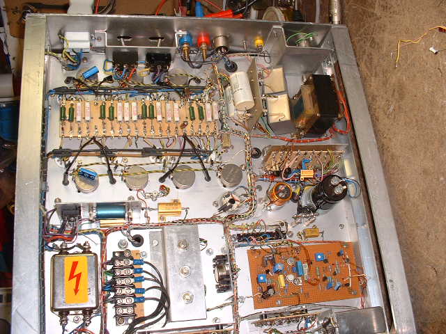

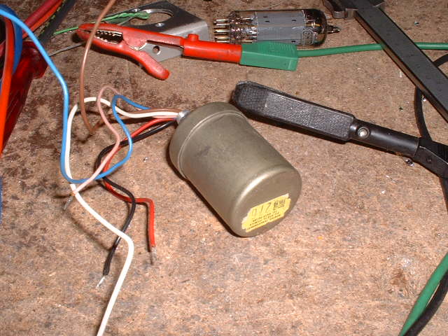

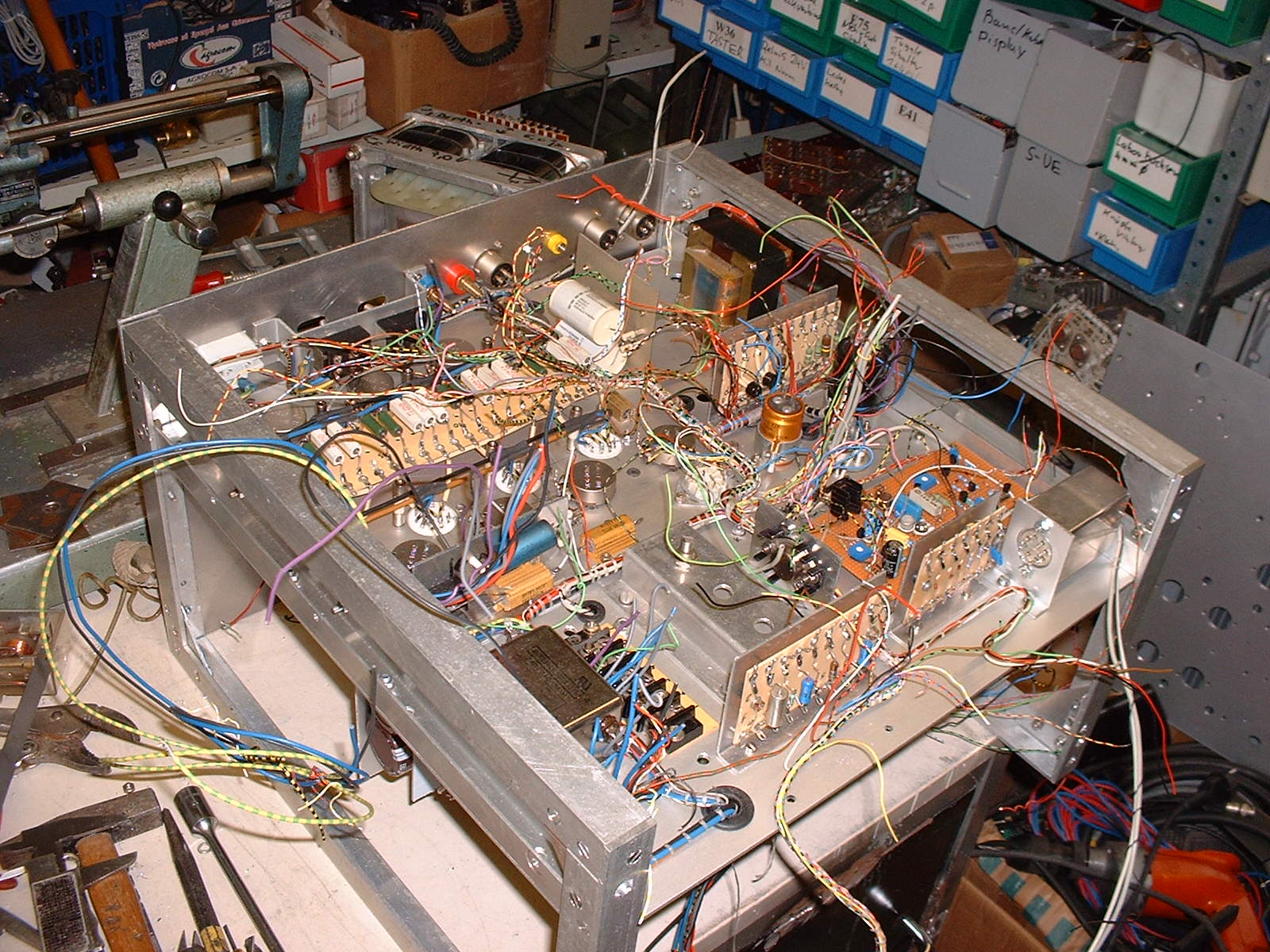

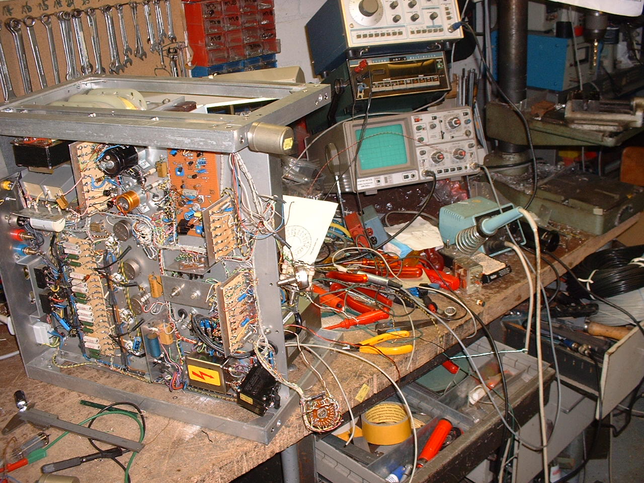

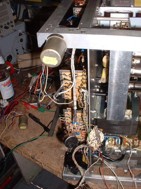

I did some work this weekend on my amp . I made some improvements especially with the wiring. I rerouted the meter wiring from the cathode R´s and the point A&B away from the main harness. Additionally I done the same with the signal input wire. I replaced the wires from the opt to the meter circuit and the meter wires against screened pairs. Away from this I changed the balanced input transformer. I found in my near unlimited bits and bobs two old Sowter audio transformers. I fiddled them in a rough and ready way into the signal path. The did their job excellent.

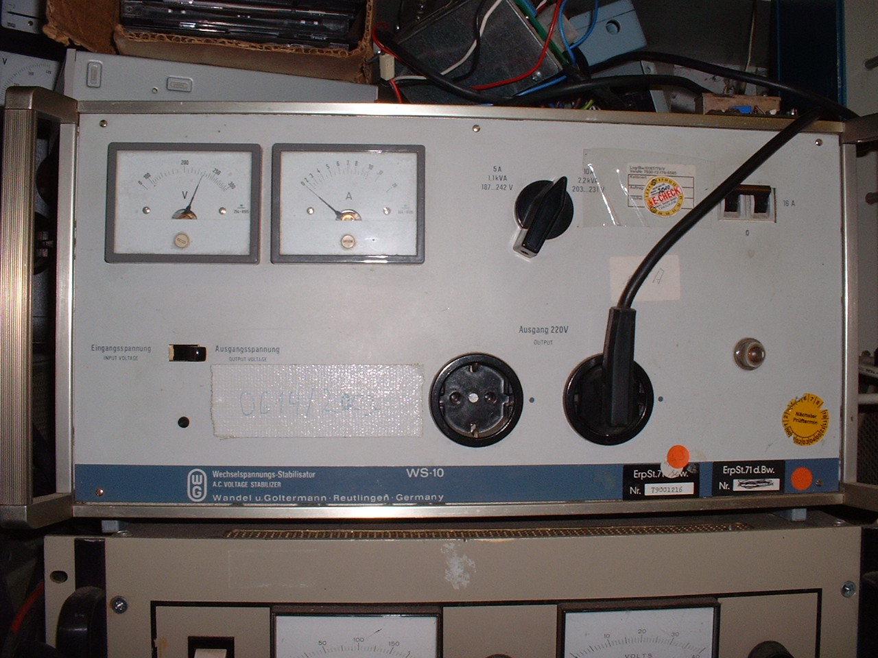

I did some measurements on a stabilized mains at exactly 230V. The idle input power is 350 Watts, at full blast 950 Watts. The idle current of each output valve is 50mA. The G1 voltage is on all valves between -48 and -53 Volts. The +B is 473 Volts at idle and 440 Volts on full power. The rms output are 450W before clipping. The required input voltage is 0.8V rms.
The amp works stable , but one thing is going to examine. If the amp is turned off, there is a short burst of about 1Mhz for a half a second. Any idea?

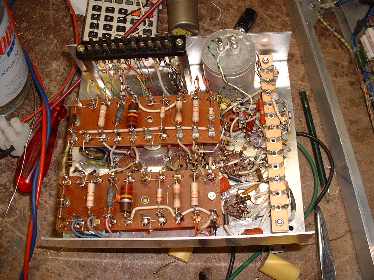

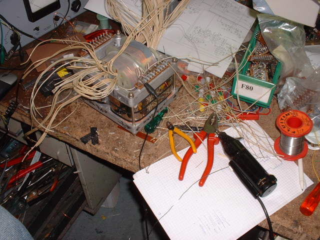

I build the voltage amp section as a plug in module for easier service access. The remained space were McIntosh placed the voltage amp is now for my protection & screen-grid regulator board.
Here are some pics from this weekend:
1. Sowter transformer
2. Makeshift test with the Sowter transformer
3. Mains stabilizer, Wandel & Goltermann
4. Makeshift test setup
5. Underneath the voltage amp module
6. Voltage amp module
73
Wolfgang

The kath. follower is a 6C4 , it has a lower µ. I changed only the kath. R 6 to match this valve to the circuit. The reason to use a 6C4 is, I got them in large quantaties.
The both resistors R31/ 32 in the nfb loop are 5W wirewound Philips/Valvo.
With the regulated -165V I,ll not agree with you. If I use a stabilized Vg1 theres is no compensation angainst mains variation. Unreg. Vg1 means, mains voltage rise, means increasing of +B ; means more idle current. So in this way Vg1 increase also compansate the increasing idle current.
Regulated Vg1 make only sense in a circuit with regulated +B.
By the way the mains voltage here is quite stable , and I got low mains impedance , the power tansformer is in a close range of my home. The Voltage is over the whole day between 230-240V.
The C´s in the power section are all 470µF/450V types. 4 parallel/series on the rectifier, the same as filter C behind the choke and 2 capacitors parallel to +395V and each one for +145 and +120V.
DC heating is a good option to reconsider about it. It is enough space in the amp...
I try with film capacitor across the electrolytics. As you wrote it gives more performance. At the moment they are paralleled makeshift.
once more , thanks for the infos. Its loads of work for the oncoming weeks.
