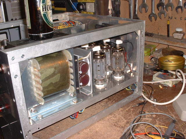

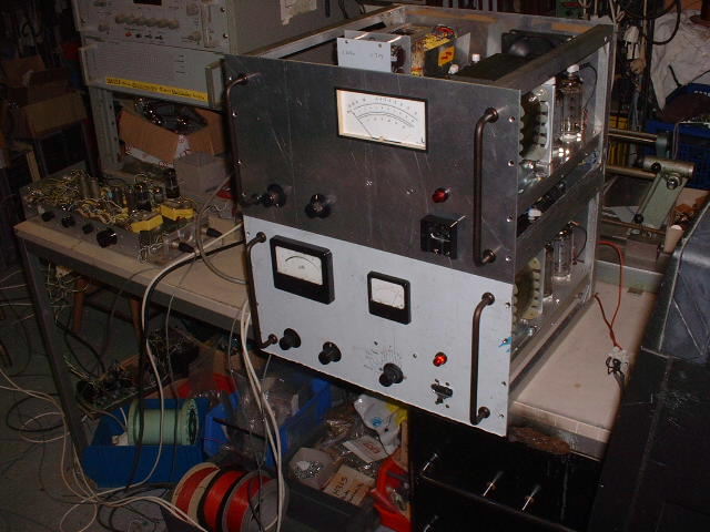

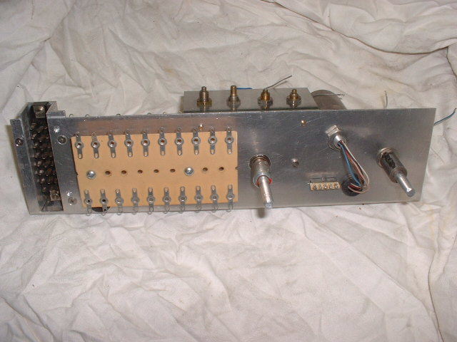

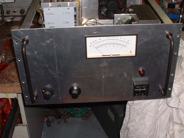

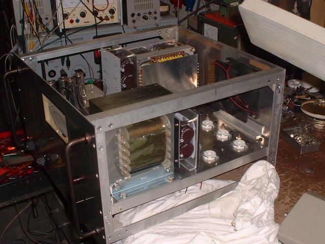

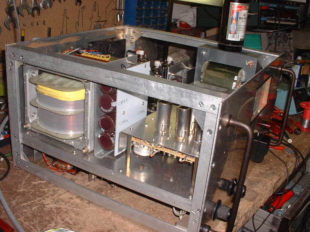

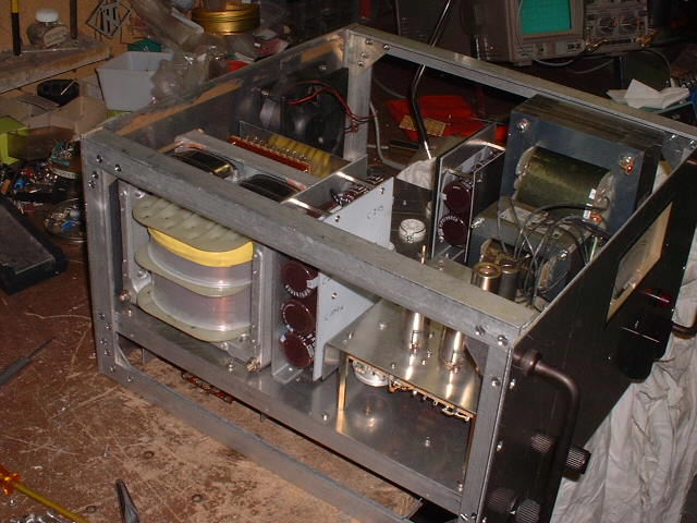

Second Amp Mechanically Finished
Hi All,
today I finished the mechanical work of the second amp. I changed the layout of the meter switch ***´y and the meter itself. If the front panel has to be removed for service, the meter switch and the potmeter remain on the chassis . So not by the first amp. The potmeter and the switch are fixed at the front panel. If the front panel is disassembled the switch and potmeter dangling from the chassis and its easy to manage to be zapped while working on the amp. Furthermore the whole switchass´y is fitted on a removable plug-in unit for easy access. I will rebuilt the first amp like this.
The reason to use different meters is simple as I cannot hold of a set of these old meters. Even I like the old style but no meters.... This meter replace the two others. It indicate the output power level, Vmains, Vg1, Vg2, Vplate and the idle current of all 8 output tubes.
There are also little bits and pieces which are different from the first one, all will be transfered to the first one. The protection board and the voltage amp are already wired and tested.
Now I will start with wire harness . If everything goes well the amp will be finished in a couple of weeks. In the attachment are some pics.
73
Wolfgang

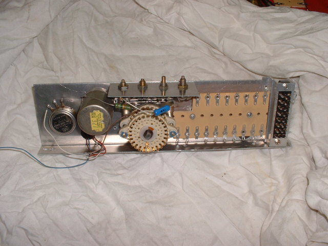

Hey Wolfgang,
I am sorry I have not been in contact before now. I have had a hectic couple of months, spent Christmas in Rome, got engaged to be married etc.
You have been really busy with your builds! Absolutely excellent work!!
Do you think the toggle switches for output impedance selection will be reliable enough? I think that as they will not be switched regularly they may become intermittent. Perhaps a rotary type switch with wiping contacts would be a better selection?
cheers Matt.
cheers Matt.

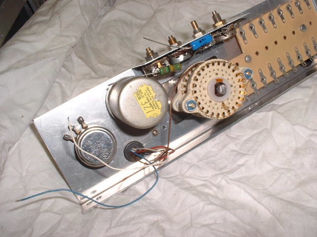

Toggle switches
Hi Matt,
these toggles are military grade, salvaged from a scraped Racal Transmitter. They are specified for 15 Amps and 250 Volts. They working perfect in the first amp.
It is no problem with the short interruption of the current path while flip them over. In a normal situation you operate the switch with the amp off or with no signal driven. And also to avoid inadvertently operating, these switches are flush mount. To operate them it requires a tool, a screwdriver etc.
A rotary switch can shorten all terminals while turn it in the other position. If the amp operate at higher output levels while turning the switch, the short circuit currents can damage the contacts.
Every solution has its own ifs and whens. In my opinion the toggle switches are a good an affordable solution. First I´m considered to use a rotary switch to set all possible output impedances from 1,2,4.8,16 Ohm and 100V line.
Yes believe or not I made such a kind of switch from the part of many other old rotaries. But this take to much space beneath the chassis. So I turn to the toggle version. 1 to 8 ohms are enough variations.
Thanks for the hint.
73
Wolfgang

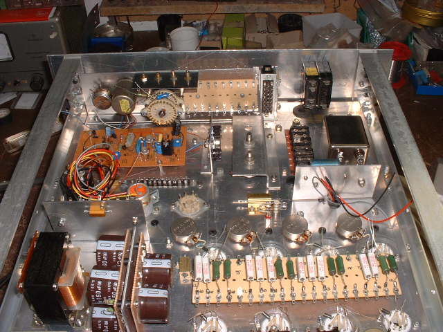

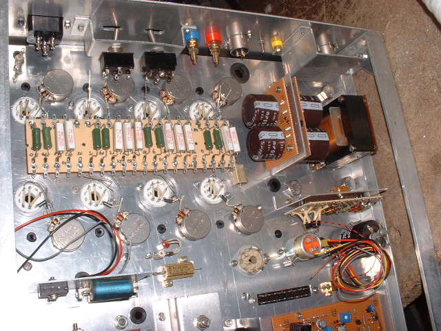

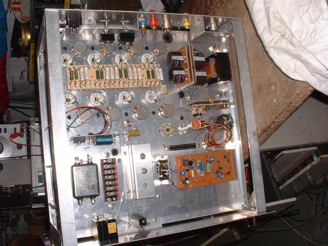

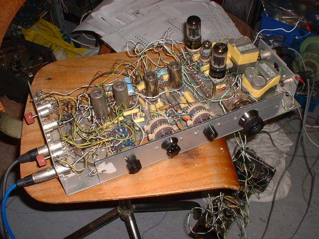

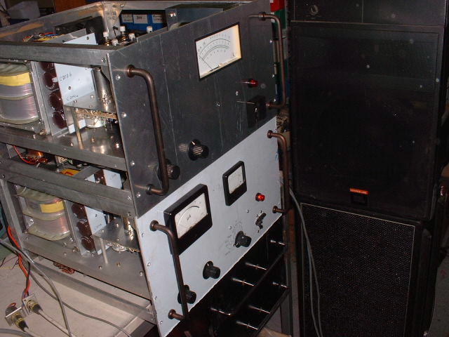

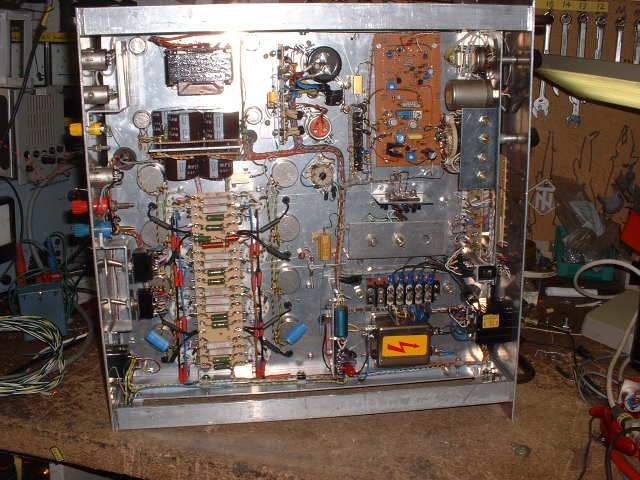

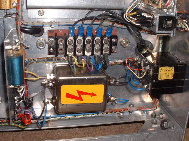

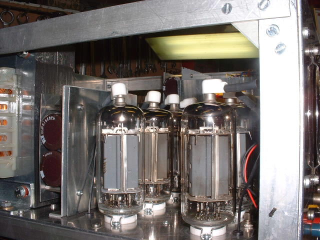

Second Amp Finished
Hi ,
yesterday I finished the second amp with the wiring. Today I made different testings. I´d miswired accidently the socket of V14 , the driving tube. I confused grid and cathode of one system. And another fault was I forgetting 2 wires at the terminal board of the opt.
After this I checked all voltages on the tube bases before I plugged the tubes in. And than the big moment, I had the plate xfmr connected via an varac to the mains terminals. So in this way I can slowly increase the plate volts and the CB is still in the line. I turned up the voltage after the tube were preheated. Bugger 😡! The amp starts oscillate near full plate volts.
The RF-ferrite plate choke of the upper row of the 4 finals heats up and left a smell of burned wire insulation. I changed the 4 tubes of the upper row and Bingo, the oscillation stops. Now I set the plate idle current to 50mA . It looks good , but when I apply a input signal , the amp was unstable and generate rf-bursts. At this time, first a cup of tea and took a look into the wiring. If the there is a 4,7k resistor to fit, I should install a 4,7k and not a 4,7 meg.
After replacing this slightly off rated part.😀, the amp work like he shall work🙂
I will find out later whats the hell are wrong with the tubes of the upper row. The output power is the same like the other amp the amp delivers 450W into 4 Ohms at stabilized 230V AC mains. I listen to it together with the first amp. Absolute bloody marvelous sound. The driving amp was my makeshift preamp (upper row, right pic). It is a breadboard version of next project. Here some pics.
The next step is to rebuild the first amp,that they both looks the same.
73
Wolfgang
73
Wolfgang

Speaker driven with the MC-3500 clone
Hi Tad,
thanks for your comment. It was a long lasting task to build them. But I like to do so and will do it always again...
I using not such a kind spectacular speakers as you may think I would use.
Every amp drive a JBL control 12 and a old PA/ reinforcement Speaker , fitted with 8 ea 5 inch fullrange chassis of total 150 rms / 300W music peak power handling.
It took 3 days to wind the both bobbins and a total of a week for fiddle all the 144 wire ends together and the final completion of core, bobbin and testing. After that I had blisters on my fingers.
73
Wolfgang
