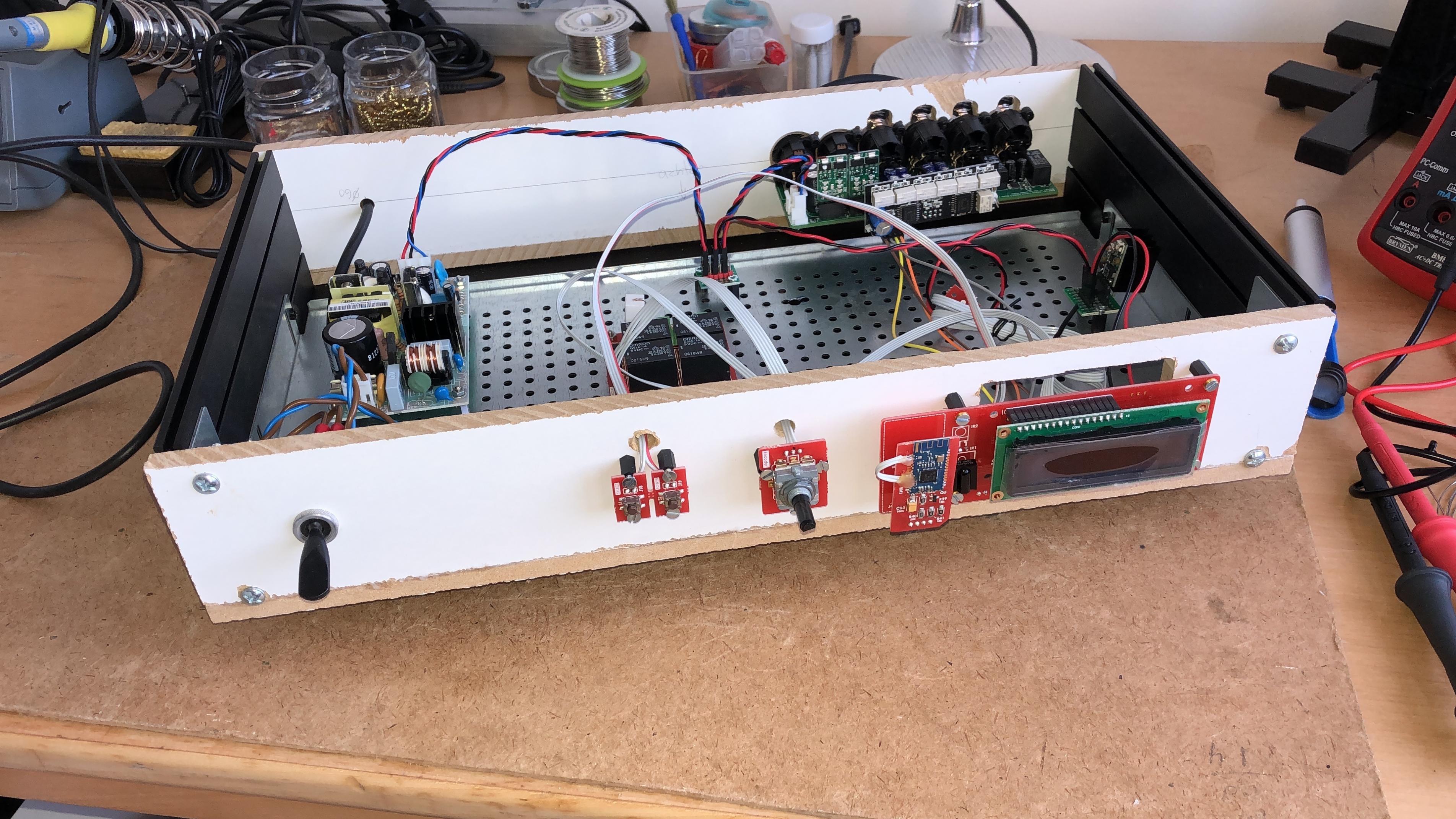

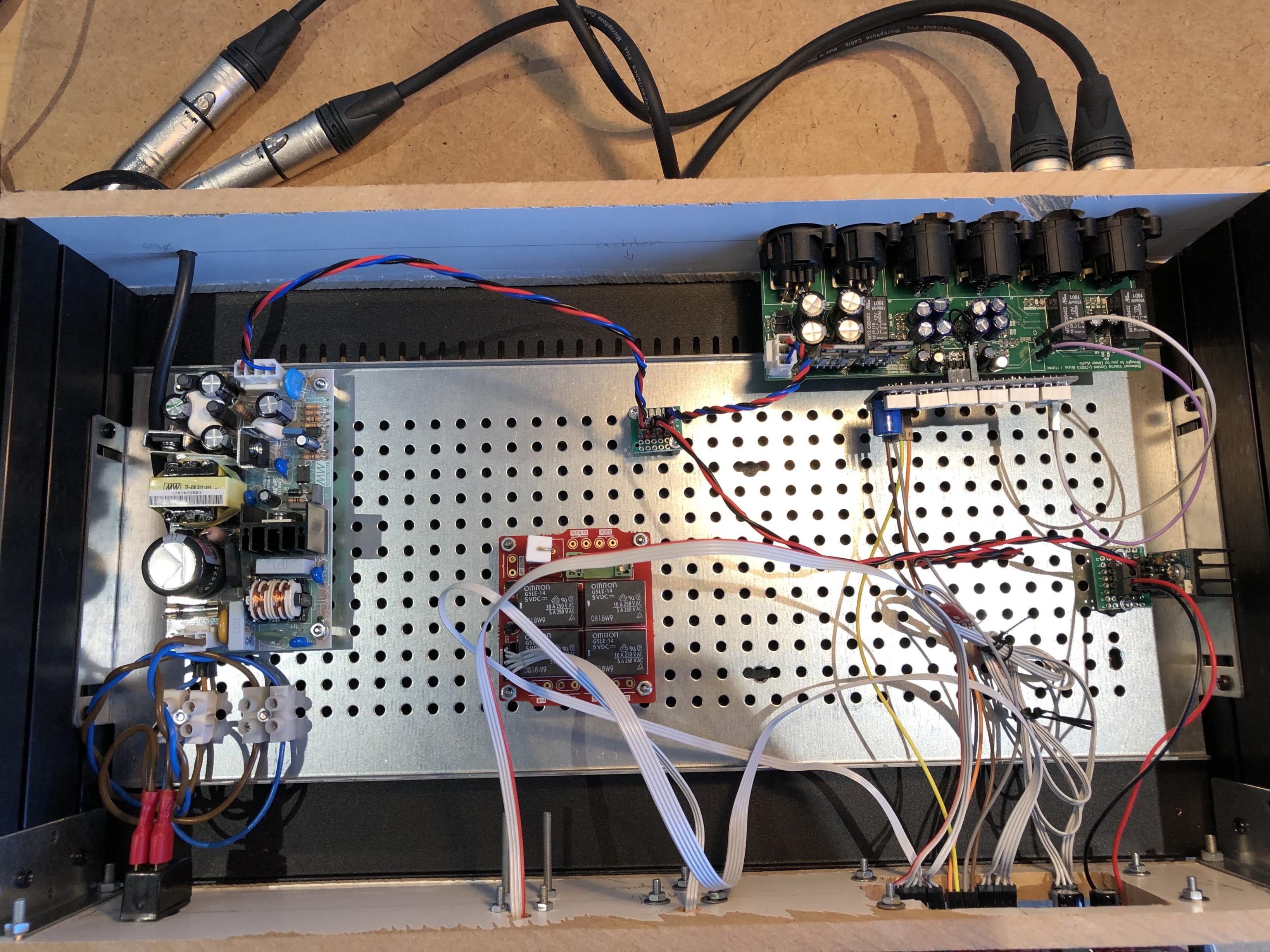

I hooked up the BPBP, VolCB and Maya and it works beautifully! Attached pics, still in temp housing. The sound is very good, the left and right channels are perfectly balanced (which they were not with the original BPBP potmeter) and I like the app for remote control.
One thing I would have done differently on hindsight: use a 4x2 female header on the VolCB (instead of the 3x2 I have now) and plug the wires coming out of the net-ties right in there. Perhaps I will still try to change that...
Two things I noticed on Maya. Perhaps anyone encountered this before:
- it consumes more power when "on" than in "standby". In standby more than 2,5 W, which I do think is quite high for standby. "on" is around 1,8 W. I measured voltage across all resistors on the board in both modes, but no real difference there. I did notice that the temperature sensors are powered also in standby.
- when input 1 is active and I turn the volume down lowest, it switches to input 2 on the last "notch" of the encoder turn. That is kind of useful because it means that the input on 1 gets totally cut off and mute is fully silent. The other way around (turning vol down on input 2) it does not happen. Is this a "feature" or a bug?
