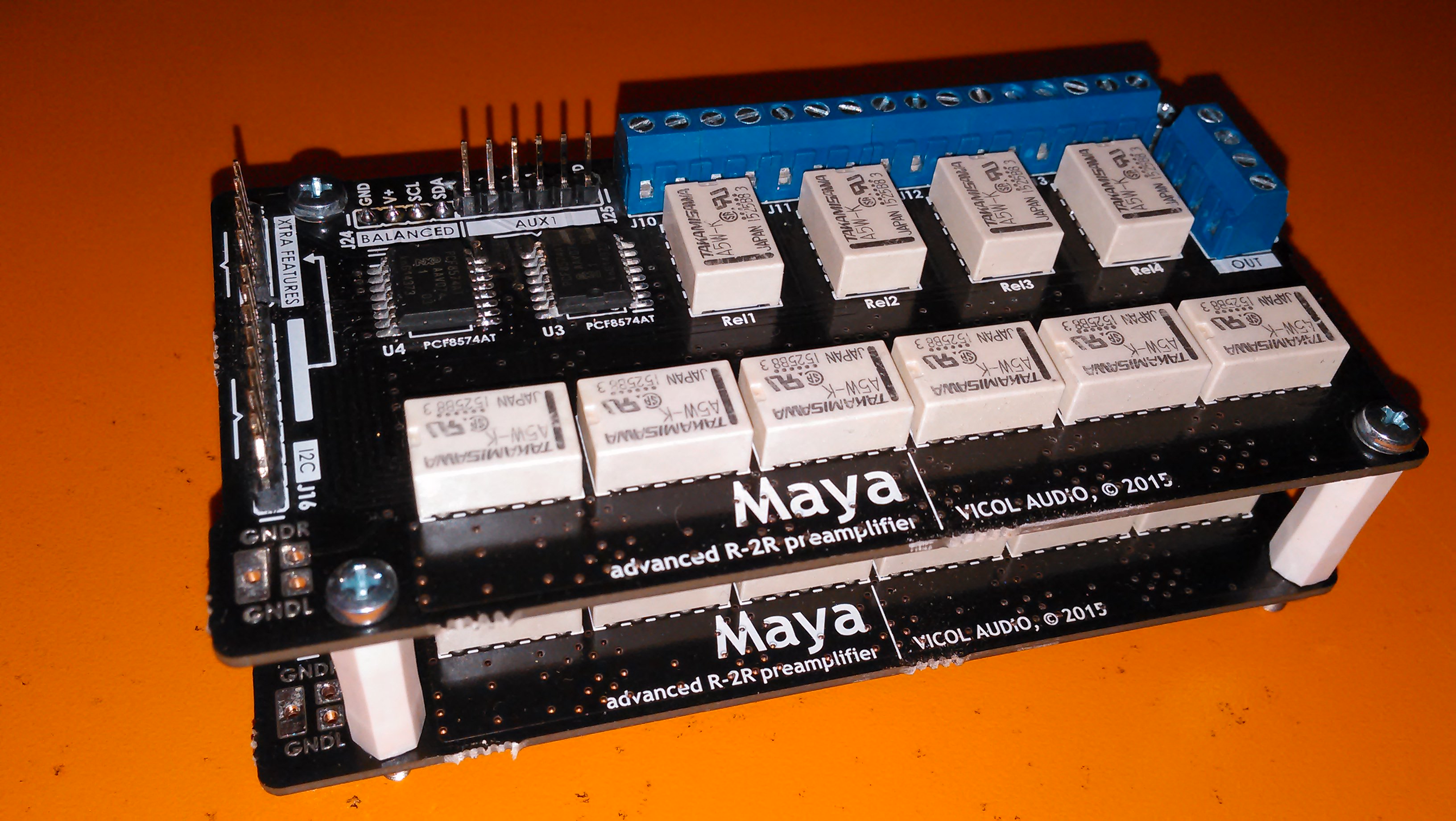

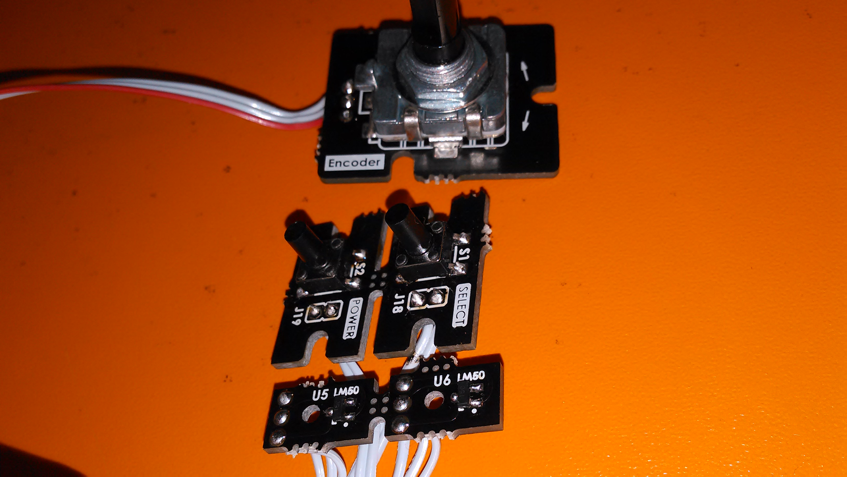

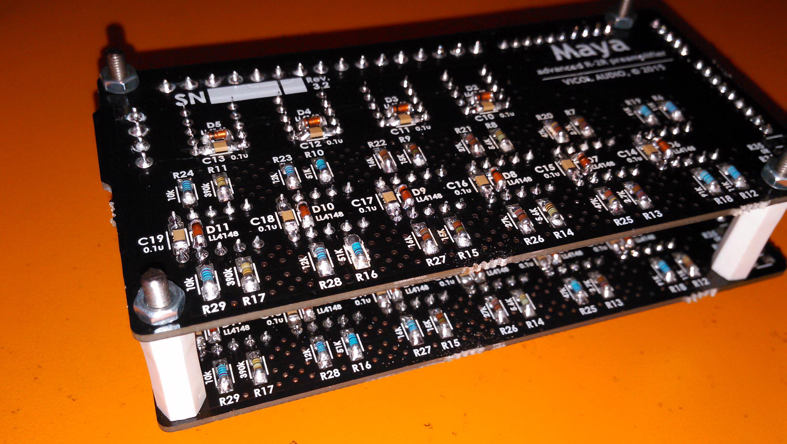

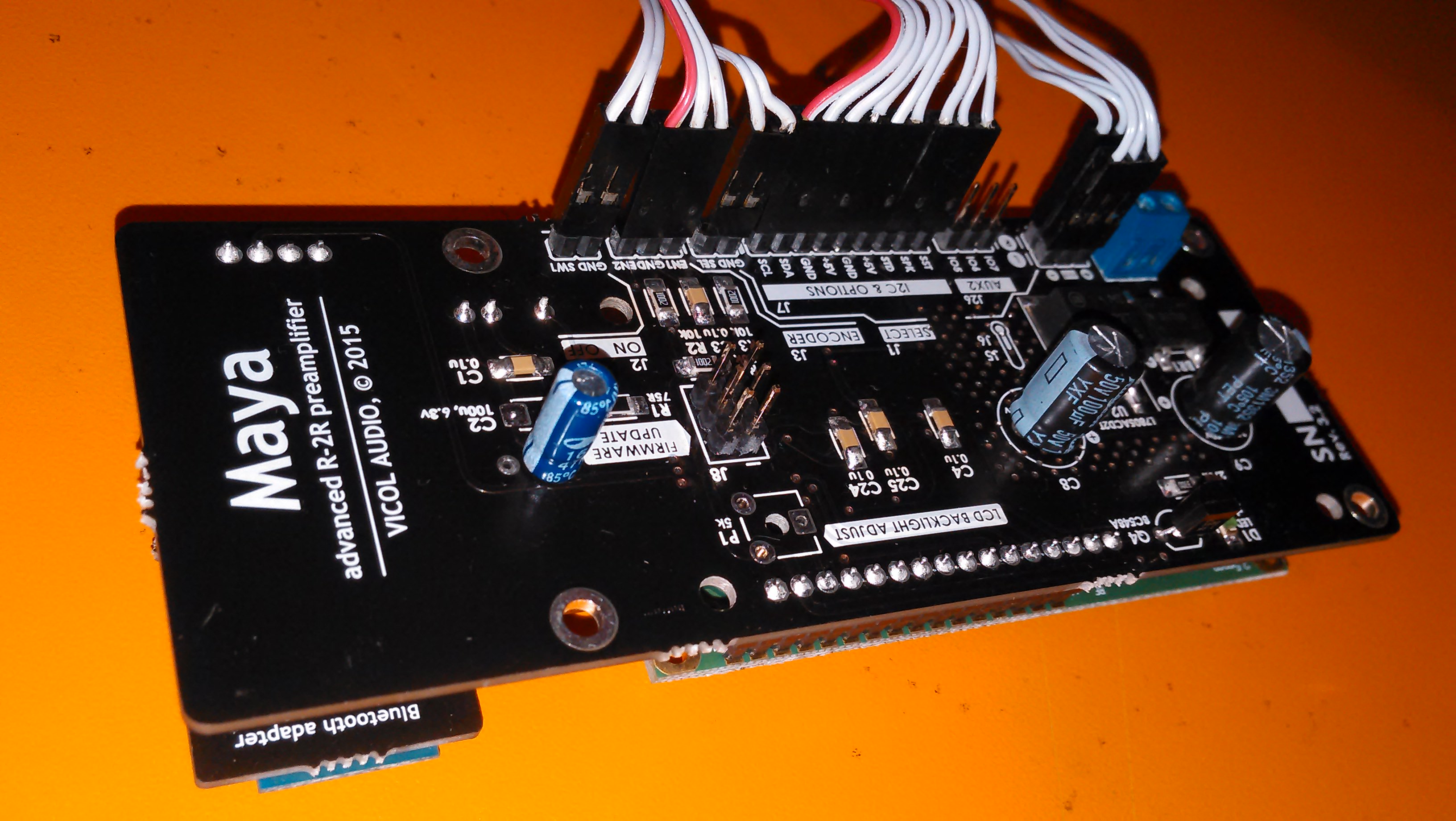

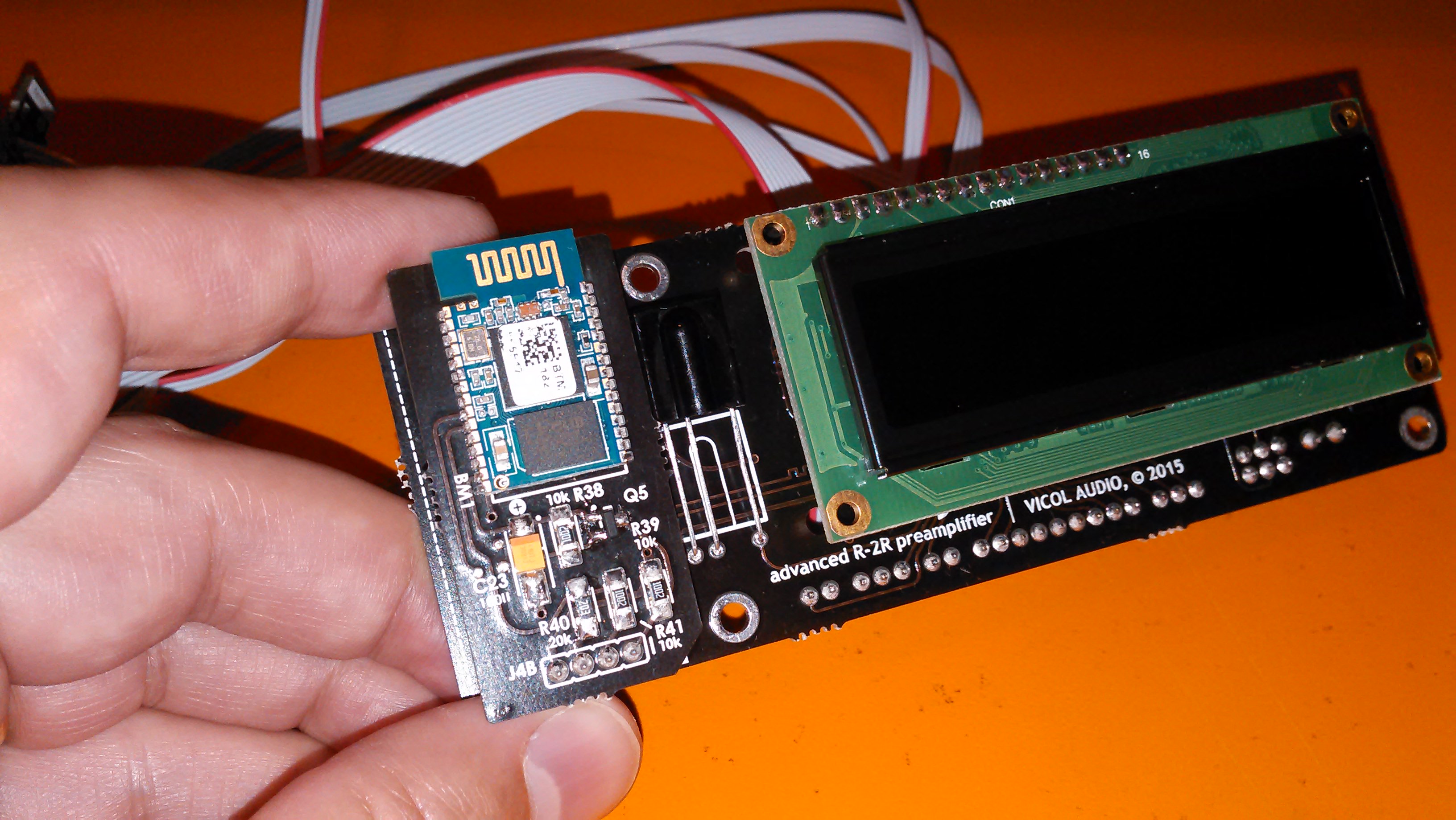

I still get emails from people interested in Maya, so here we go. Same prices as on the first GB.
Features:
- R-2R 64 1dB step attenuation
- Android/IOS client for remote control
- infrared remote RC5 protocol with autolearning
- infrared remote NEC protocol for Apple remote (default)
- OLED display
- 4 selectable inputs
- independent volume control for each input - very good for A-B source comparison
- extra low noise ground separation between digital and analog circuitry
- inrush current protection
- soft start with speaker protection
- soft turn off with speaker protection
- plate voltage delay for tube pre/amplifiers
- temperature display and monitoring
- temperature protection
- serial I2C bus for unlimited channel extension
- easy direct control and setup with precision optical encoder
Current firmware version is 0.9
More detailed information about Maya is available at vicol audio : MAYA - your ultimate volume-controller

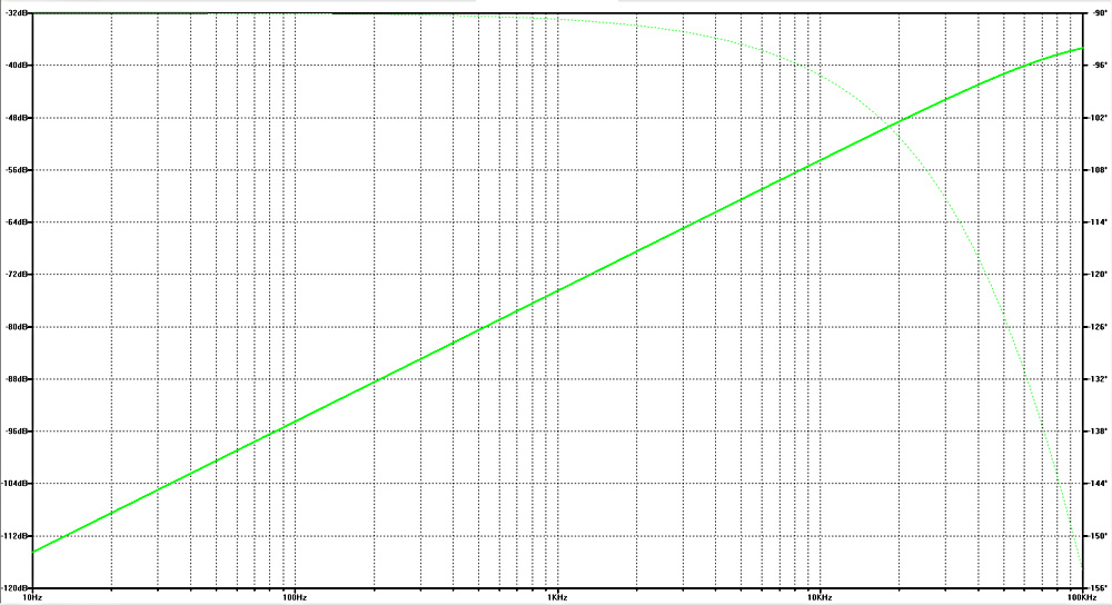

But, it is not doing justice to say that Maya can be integrated with the BPBP, because integration is not possible with the standard MAYA offering.
Maya can only be placed in front of the BPBP, which is absolutely not the same as integrating, thereby making that the pot of the BPBP has to be replaced by two resistors to set the gain in a fixed position, preferably 6dB.
To keep the balanced feature, Maya has to equipped with extra hardware.
The output of Maya will then have to be attached to the input up the BPBP, which output remains the one going to your main-amp.
There are however drawbacks to this setup, degradation of CMRR and the addition of extra noise:
1) With Maya, the input circuitry of the BPBP will be driven from a much higher impedance as was envisioned, 10K for the Maya instead of less than 100 Ohm for a DAC, CD or Phono Amp.
This may seriously affect CMRR.
See the CMRR vs Frequency figure below, for a 1% difference in the full resistor path and 2% for the 100pF input caps of the BPBP.
2) Those dual 10K output Maya resistances will also affect the excellent BPBP noise figure, by adding at least 20nV/rtHz to the input of the pre-amp, in this case the equivalent of 2.8uV over a bandwidth of 20KHz.
Noise of the BPBP alone at the point of entering the volume pot measuring 1.5uV, will be increased to 3.2uV meaning 6.6 dB extra noise.
3) To overcome these drawbacks, a special Volume Control board has been designed to replace the pot in the BPBP, not having any of these drawbacks, fully controlled by the Maya CPU, and still giving 63dB of gain control in 1dB steps.
The so called R-2R board that comes with Maya, will become obsolete when using this latter solution.

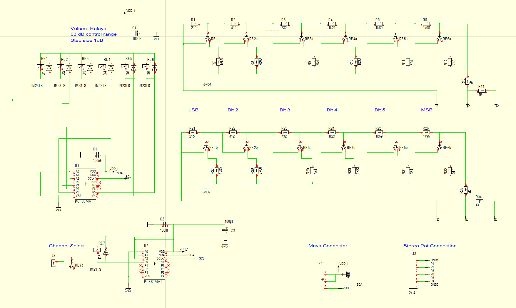

Hi Tibi,
This morning I have posted the Gerbers in this thread, but the posting is no longer there.
Did you receive the Gerbers, or shall I post them again.
Hans
Hi Hans,
Thank you !

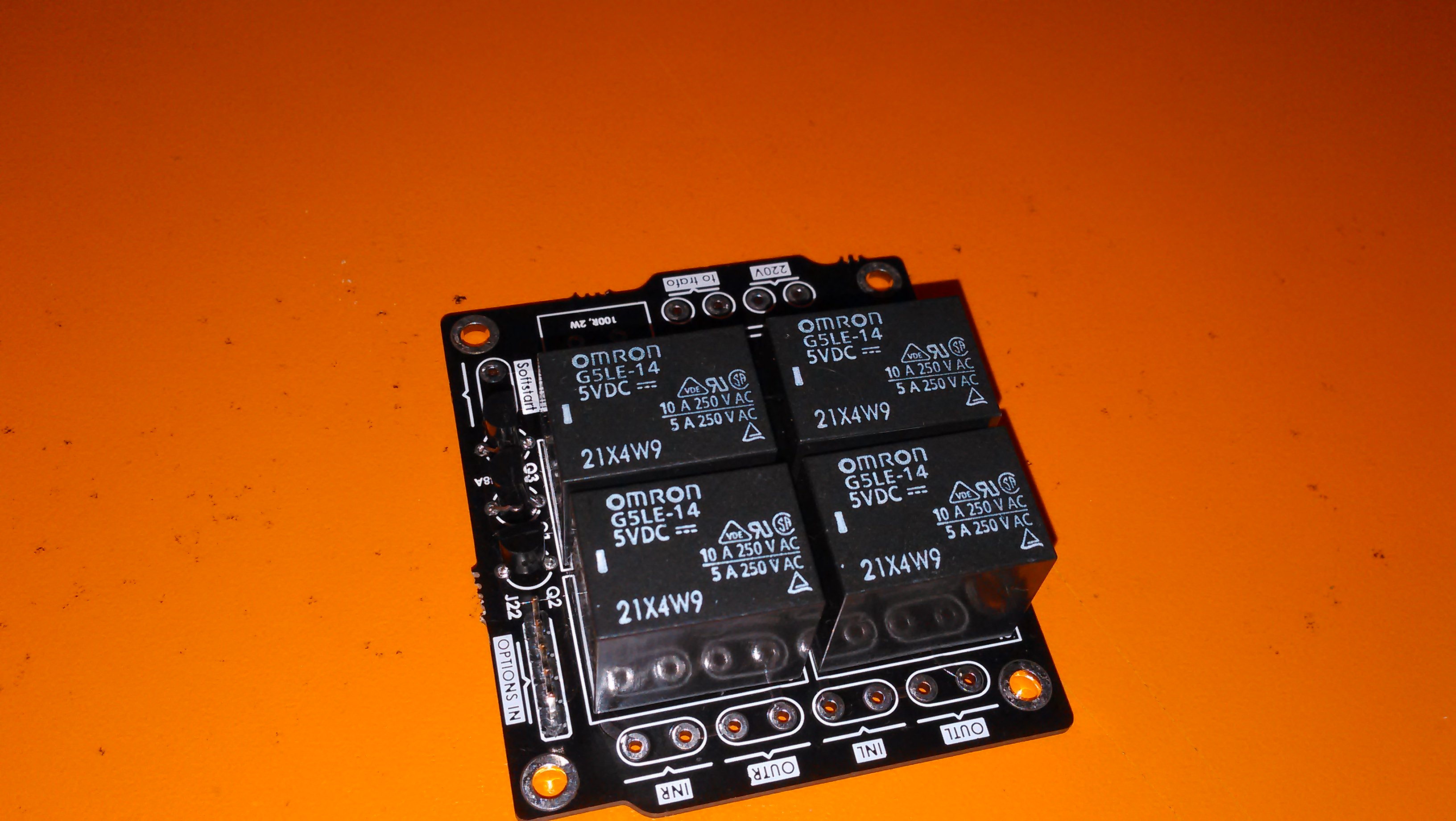

We are going to remake PCB in Altium Designer. Will also add 10uF decoupling caps on PCF, as they may trend to oscillate when more relays are driven. Will move smd resistors on bottom of pcb and add a guard plane under relays to isolate resistor network from any emi generated by relays during operation. Gerber files will be made public, on this forum and on my website, as well.
Tibi
Thank you !
Tibi
Tibi,Hi Hans,
Thank you !
Tibi
What you probably have is the concept design.
Here below is the final version as used for the PCB design.
It is a lot of work that you are planning to do, for a layout that has completely proven itself in practice with 5 instead of 6 relays without even a hint of noise while switching the relays.
And I am a bit concerned on increasing the dimensions of this PCB in case you would place the larger type of relay that you are currently using.
The IM23TS is not only very small, but also draws only 10mA as against 28mA for most other 5V relays, resulting in a much more relaxed operation for the PCF chips and thereby never exceeding the 100mA max that the PCF may sink when all six relays are driven at the same time.
And as a bonus, this relay will also result in much less EMI.
Nevertheless, in the design are included one 100uF cap and three 100nF caps.
This will be more than sufficient to prevent any PCF from starting to oscillate.
So I see no reason whatsoever to make a re-design from a proven design to a design that will still have to prove itself.
Hans
