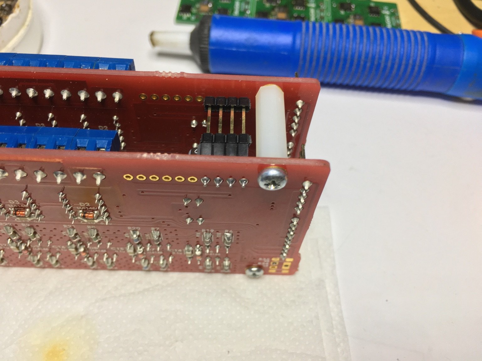

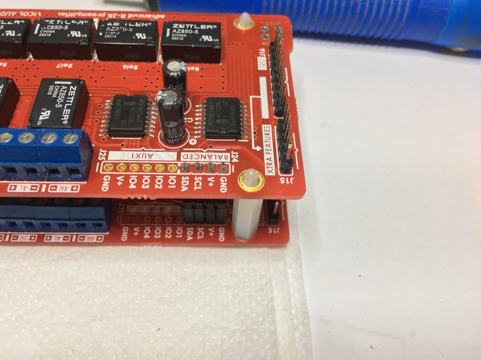

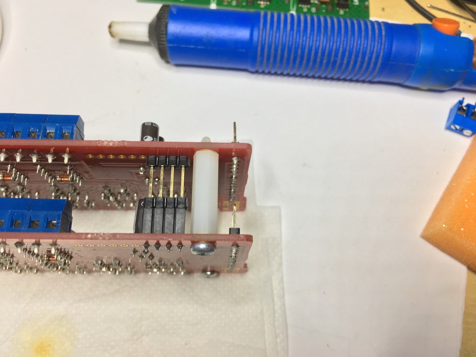

Need some help. I have a second relay board to make the Maya balanced, but I don't understand how to connect it to the original maya that I have. Please help.
Also what size standoffs do I need, and what other stuff will I need to connect this 2nd board?
Hope attached pictures are self explanatory.
Tibi
