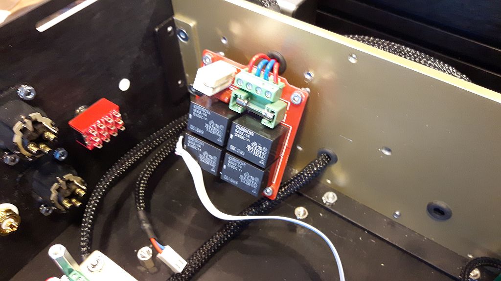

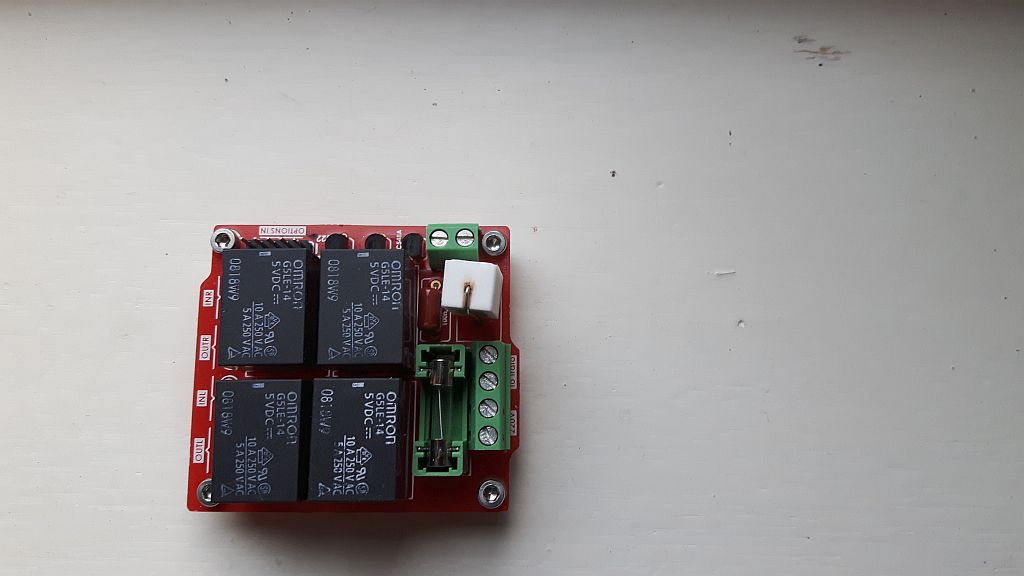

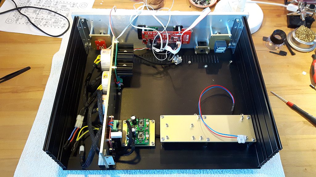

Hi Tibi, I booked progress with my preamp with your Maya controller. However, I ran into a small issue now. It seems that the standby function of the relay board has some issue. When I do not connect anything to the '220V' inputs and to the 'to trafo' outputs, I can measure (with my DMM in ohms mode) that the relay is working well: in standby --> the relay goes open, with power on --> the relays closes. This is how it should be right?
Next, when I connect main power to the 220 inputs of the relay board, the standby relay closes immediately after powering the preamp while the Maya controller still being in standby mode. When I power on the Maya controller, the relays keeps being closed. When turning Maya in standby mode again, the relays keeps being closed. Any clue why this is so?
If I were to use it this way, the two trafo's that I use for my active line amp and headphone amp were always powered. This is not fine.
I tested that I can use the soft start instead to switch on/off the two other trafo's. That is working well.
I used three Talema toroidal transformers: the 62050 (2x7V, 15VA, always on) used to power the Maya R-2R attenuator, the 62062 (2x12V, 25VA) used to power the sigma 11 with the M3 headphone amp, and the 60031 (2x9V, 7VA) to power the Sigma 78/79 with the Alpha 24's.

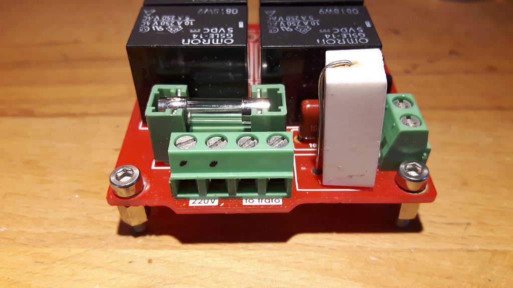

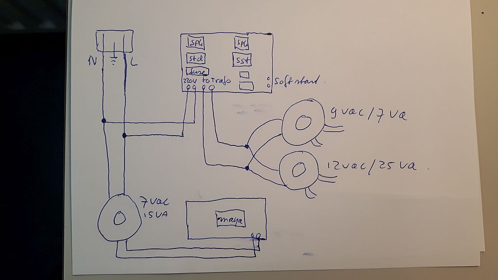

Ok, I have the wiring scheme of Maya. Main power is connected directly to the transformer that powers Maya (always on)(I use 7VAC/15VA) and main power is directly connected to input '220V' on the relay board (photo).
According to the wiring scheme, I have to connect any other transformers (for amps) to the 'to trafo' output (photo). And to my understanding, when Maya is in standby mode, the other transformers should be switched off by the standby relay. Is that right? But this is not happening. When I connect main power to '220V' input, the '220V' input and 'to trafo' output are always connected, it does not matter whether Maya is standby mode or in power on mode. But when I do not connect main power to '220V' input, then the '220V' input and 'to trafo' output are switched off (not connected) in standby mode (and switched on in power on mode). The relay is behaving differently when connecting main power or not.
