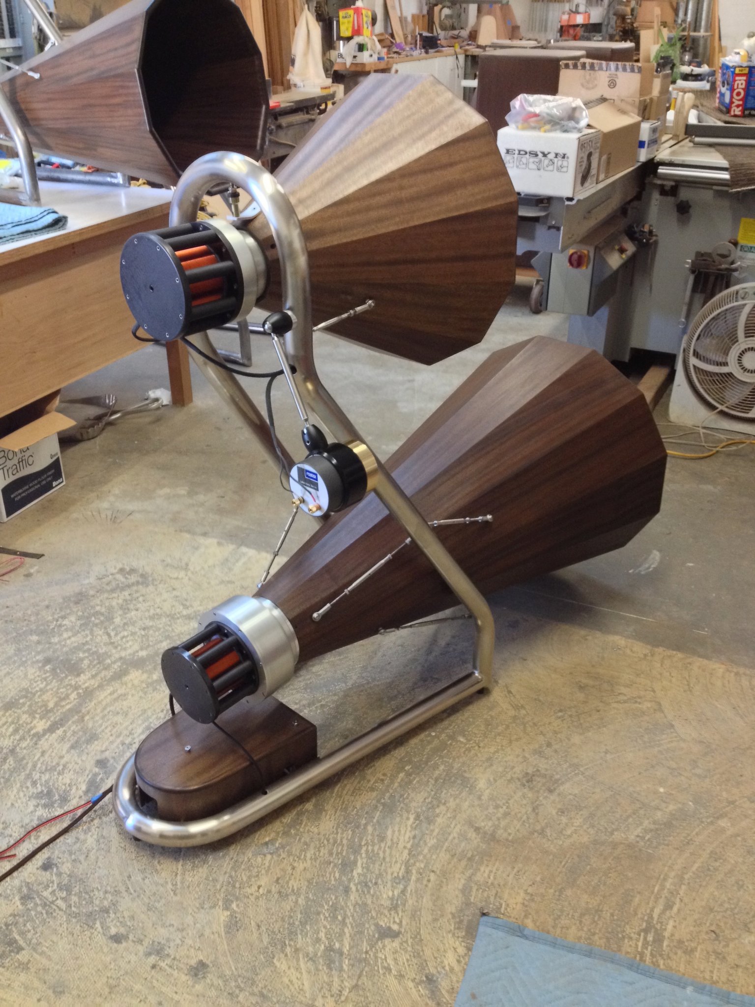

One example of this thinking in practice is the 12-sided conical horns used with Cogent midrange drivers. The conic midrange and mid bass horns used by both OMA (Oswald's Mill) and the Cogent/esodesignstudio were actually designed by former Yorkville Sound designer Bill Woods. OMA uses the driver exactly as designed by Bill including using the cast throat assembly. Rich from Cogent and I opted for a different system for mounting that we felt was cleaner and also allowed us to make the petals of the horns thicker which allowed for a bit of a mount radius to hopefully combat mouth refraction but also for a better visual balance of the horn to the mass of the drivers. But this digresses from the topic here.
Early in the Development of the Cogent drivers, Rich had purchased some Azura Horns from Martin in Australia. The mouth of the Cogent DS-1428 is an odd size–~2.7" if I recall correctly and the internal geometry if the phase plug is a pretty wide angle. The Cogent/Azura combination never worked well. The conflict in the throat created some congestion, and ultimately the long throat section of the horn led to considerable beaming at higher frequencies. But, round tractrix and Le'Cleach flares tend to match exceptionally well with the vintage 375/2440/2441/2482 style drivers as well as TAD 4001 and Gauss 4000 series compression drivers: the ~10˚ conic flare inside those drivers matches quite well with the throat of a typical Tractrix.
Bill woods designed horns in OMA Imperia:
Shorted version used by Cogent/esodesignstudio:
Back to the 12-sided conic horns, after initial prototypes built here, Rich and I noticed that the angle of the conic mid horn was slightly less than the most extreme angle inside the phase plug. We kept the mouth diameter but shortened the length by a couple inches, matching the conic angle to the angle in question in the phase plug. Again, the sound was more open. Now with the 118db sensitivity on the drivers we really do not need any support from horn loading. In the case of our implementation of this horn driver/combination we are only using it for pattern control and so in this case it is really just a wave guide.

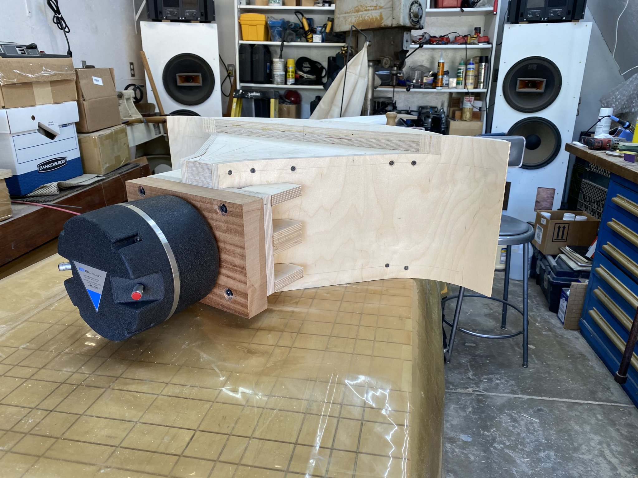

Currently, I'm playing with some TAD drivers that I stumbled onto and looking at building a slight variation on the Exclusive 2401/TAD TSM-1 large monitor. Many years ago I built a pair of Yuichi A290 radial horns to play with. They are an exceptional radial design with performance very similar to the TAD TH-4001. But I don't like horns with vanes in them for hifi; I find they do great at even horzontal coverage, but the soundstage flattens as a result. The TAD TH-4003 horn has 80˚ X 30˚ pattern with no vanes, but that horn is designed for a 40mm throat driver. My TD-4001 has a 50mm throat (actually 49.2mm). So I decided to try to build a horn like the TD-4003 but for a 50mm driver.
Because I Know the Yuichi A290 has good frequency response I started with calculating an exponential expansion with a .7 hyperbolic influence for a 290Hz flare starting with a 49.2mm throat. This scenario does not have an adapter plate. The driver mounting plate is the mouth of the horn and the transition from 49.2mm round to a near rectangle is flowing the calculated expansion. And the horn itself is tedious to shape since it is asymmetrical, but initial tests are promising.
Not a perfect fit, but very close. This mounting plate is 1 3/4" thick, and the angles at the driver match the conic flare inside the driver before beginning the asymmetric expansion of the horn:
The prototype assembly:
Rough plots on and off axis, no smoothing:
Still a lot of work to do on this one. Need to design the Helmholtz resonator that I believe will be adjusting the on-axis level to balance with the off-axis pattern a bit more closely. And I need to set up for taking impedance measurements... any input on that would be appreciated.
A lot of words there and meandering about, but hopefully not fully incoherent.
Cliff's Notes version: Don't adapt a 1" driver to a 2" horn, and don't even think about attaching a 2" driver to a smaller horn. Wherever possible start with a clean sheet of paper so you can work out the variable and possible conflicts ahead of time.

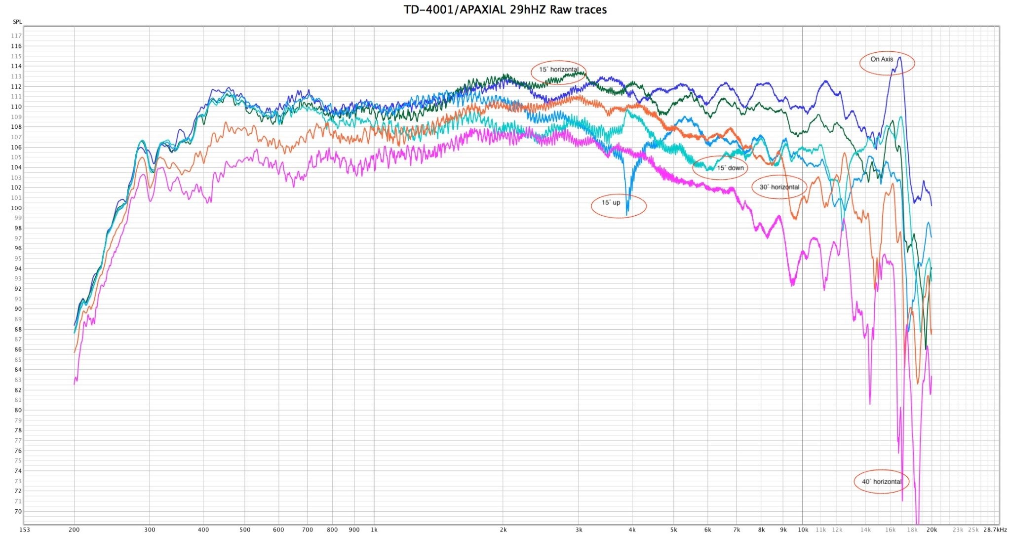

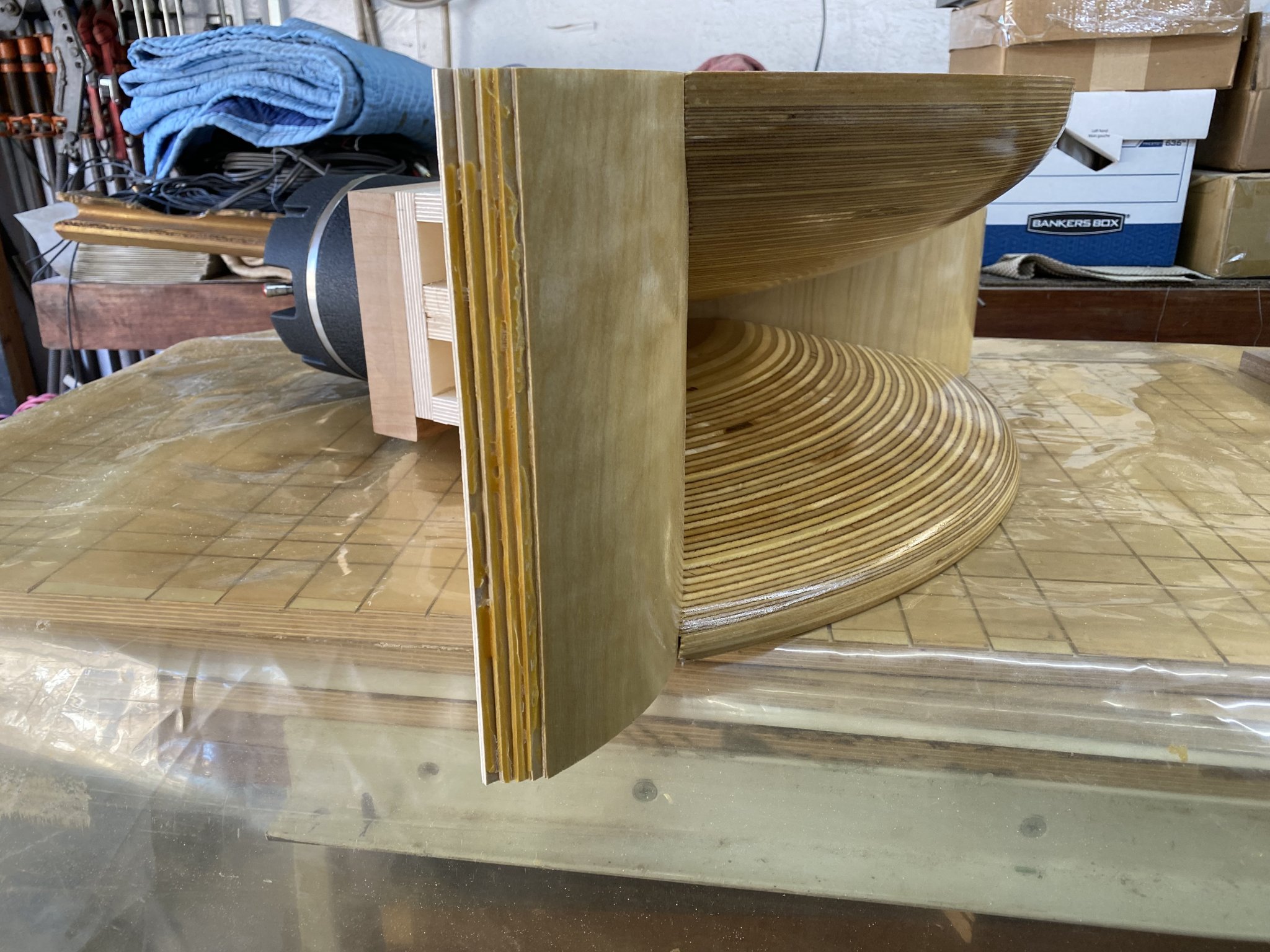

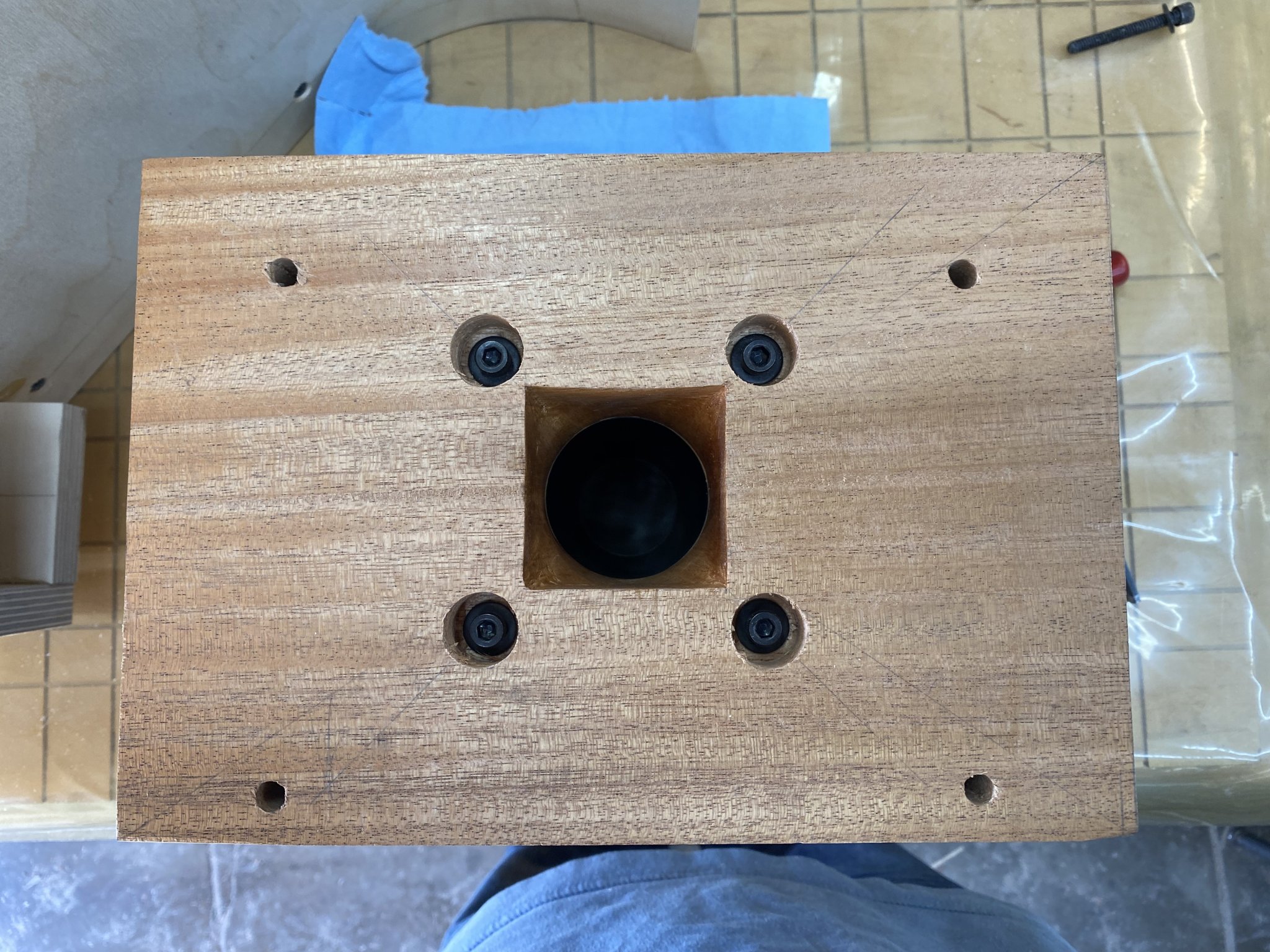

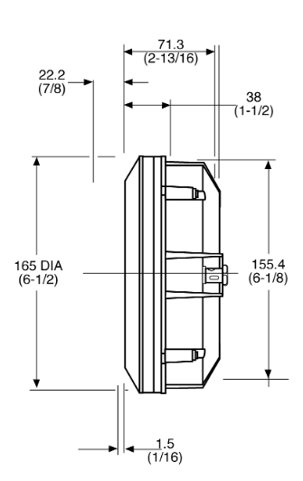

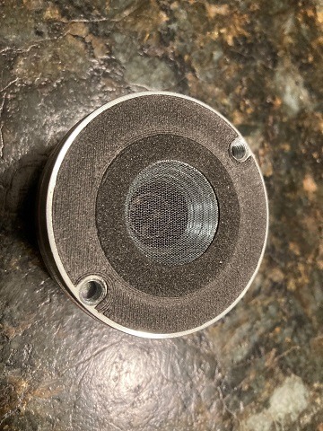

I have a pair of Celestion CDX1-1412 drivers. Let's start with exit angle, which isn't in the specs. Is that the angle of the exit "cone"? It appears to start at 5/8" diameter and expands to 1" diameter after about 1/2". Been a half century since my last Geometry class, but does that mean that the exit angle is around 20.5°? Does this mean that the horn entry should be 1" and initially expand at the same 20.5° before before reaching, say, 90°?
I hope my question makes sense. Here's a picture of the driver exit.
You are on the right track, my understanding is rather unsophisticated. While it is hard to tell it looks like the exit angle is significantly wider than the 20.5° you mention. I suspect and possibly mistakenly that this driver is intended for a very short horn. (They mention compact installations as a primary usage point.)

Anyway, the specs pdf
On the DIY front, the wide angle is a good thing if done properly, as it has the potential to be used in a lower diffraction waveguide design.
Anyway, a 1" exit, so the driver controls the ~ 4 kHz - up BW same as Altec, et al, i.e. 'don't fix what ain't broke' 😉.
Yeah, at 1.5 kHz Fp/2 kHz min. XO, strictly a tweeter horn driver.
