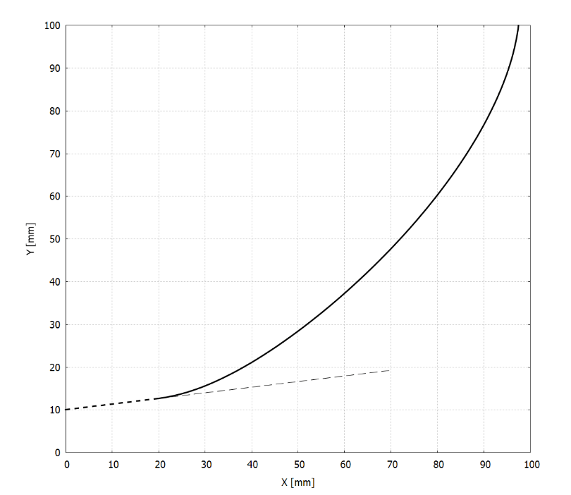

On page 21 of Marcel Batík's paper, he says: "However, many compression drivers contain a segment of a conical duct as their exit section and even if the slopes of the walls match at the driver/waveguide interface, there will be a wave reflection from this curvature discontinuity." He shows this image which is similar to the graphics I posted earlier in the thread.There's a simple solution to the curvature mismatch
To solve this discontinuity he proposes inserting a ring into the driver throat that will effectively extend the horn's profile down to the driver's phase plug. This has occurred to me from time to time, but in somewhat less sophisticated terms. 🙂
Not necessarily. Matching the flare rates (first priority) could still lead to some discontinuity in the wall angles.This is often mentioned and I believe well understood by many builders. And shouldn't this already be taken care of when we find an optimum match to the flare rates?
Only ONE exponential horn (same Fc as driver's internal throat equivalent exponential Fc), but multiple hypex horns if one can change both T and Fc to match the horn's initial flare rate m at its throat to that of the driver's internal throat (eq. exp).You've made it clear in point 2 that there can be only one ideal match between the conical horn throat expansion and an expo or hypex horn

This solution addresses the wall angle discontinuity, but not necessarily the mismatch in flare rates.To solve this discontinuity he proposes...
If there's a discontinuity in wall angles, real wavefront curvatures will be different and so will be the actual flare rates.Matching the flare rates (first priority) could still lead to some discontinuity in the wall angles.
It actually solves both at the same time.This solution addresses the wall angle discontinuity, but not necessarily the mismatch in flare rates.
Absolutely, correct.If there's a discontinuity in wall angles, real wavefront curvatures will be different and so will be the actual flare rates.
What I meant was: "matching wall angles is necessary but not sufficient to ensure a match in flare rates"

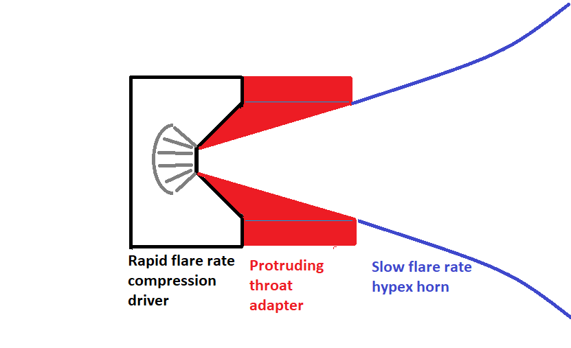

I think it could be solved with the adapter, but doesn't that mean that the driver exit size will need to be smaller than the horn throat opening?
Potentially, yes. I imagine it may be tricky to manufacture such an extended adapter to the required tolerances, though.Could this be solved by the adapter with the correct flare rate extending from the adapter-to-horn interface into the (conical) opening of the driver?
That would depend on the specific geometry of the phase plug itself - which sadly is rarely (if ever) disclosed by the manufacturers.would this disturb the wave shape generated by the phase plug?
Not necessarily - see crude back-of-napkin sketch below:doesn't that mean that the driver exit size will need to be smaller than the horn throat opening?
Thanks Marco, but isn't that showing a horn entrance the same size as the driver exit? The angle is very different, that's true.
Of course you might truncate the horn and build an adapter than fits into the driver throat. If the driver opening is larger than the horn opening, you could also build your adapter to do down into the throat, which might be possible. Or use a ring adapter inside the driver throat.
But if you had to stay external to the driver, the driver exit would need to be smaller than the horn entrance.

I was contemplating the adapter to be inserted into the driver throat, in which case it would actually be better to have as large an included angle as possible. In fact, if one were really lucky, the adapter would end at the same diameter as the phasing plug, thus avoiding the problem of interference that I was alluding to.
Hm, perhaps the driver's exit could be re-machined if such an operation would not affect the magnetic circuit.
