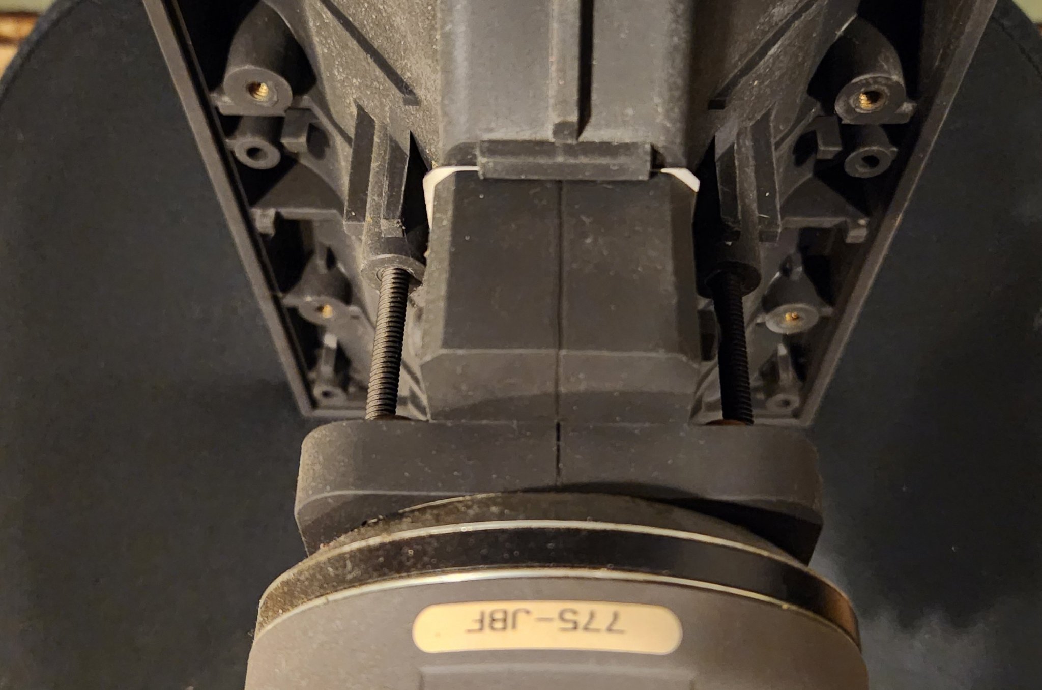

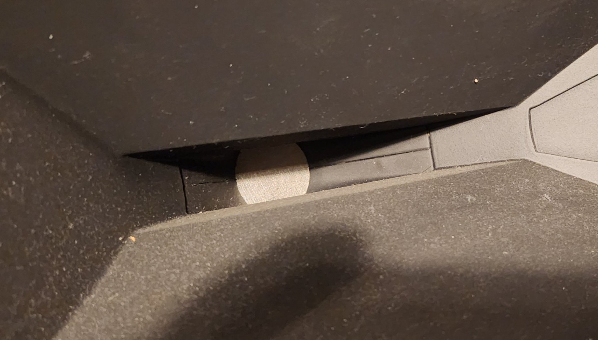

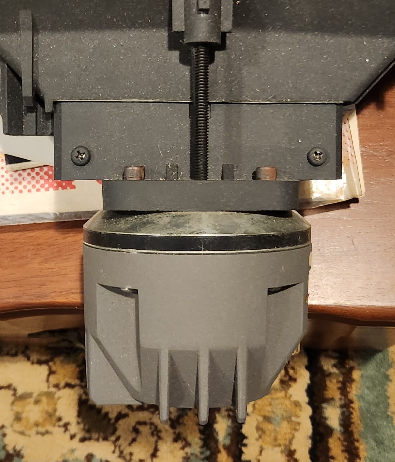

This is well put! How does one select a driver and an adapter to fit a rectangular entrance horn?
Given the knowledge, computers and 3D printers we now have, I think there is an opportunity to design very good adapters. Better ones than could have been designed back then. Hey, our adapters can even be tailored to fit specific driver and horn pairs.
It depends on how the horn is made. With JBL's like the Arrays, 9800, 9900 and the Everest's they are 3 piece casts. The throats and mounting plate are 2 halves and the balance of the horn one piece. The cross-section of the throat where it meets the horn is a rectangle so the transition from a round 1.5 round all takes place there. That's one way in can be done. You could print or machine.
Rob 🙂

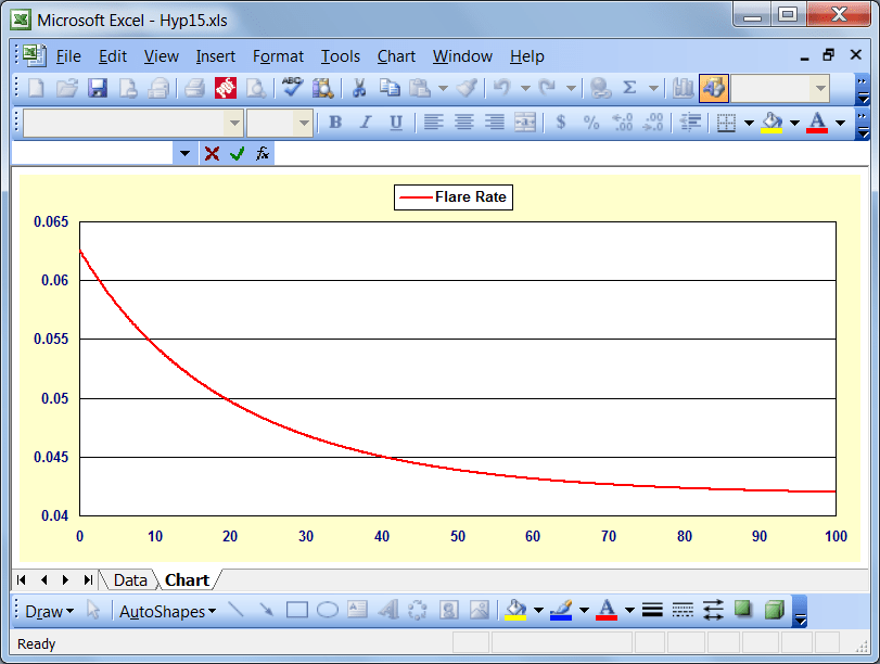

Not sure what you mean by driver expansion rate?
Nor am I quite sure. It's a term I see mentioned here and other places, along with "flare rate." A conical horn or conical driver throat has a linear expansion, although the rate at which the area increases, or expands, will depend on the angle of the cone. But other horns profiles have a changing flare or expansion rate (if those two things are different), they tend to expand more rapidly closer to the horn mouth.

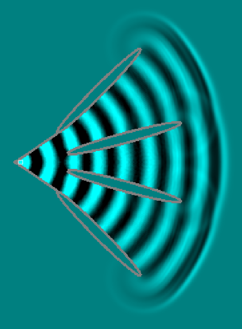

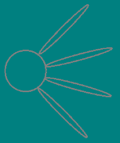

Wouldnt it be cool if there was a visualization - like this one - of what happens when there's an angular mismatch between the horn and adapter?
I did this simplistic horizontal one which demonstrates finding the right curvature. I should also do some verticals showing how curvature there could be a problem.
Here vanes have been set radially as shown (click to enlarge)..

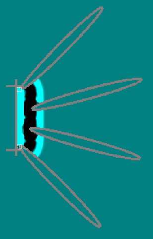

A flat wavefront would not be ideal..
Compare this to a rounded wavefront..
