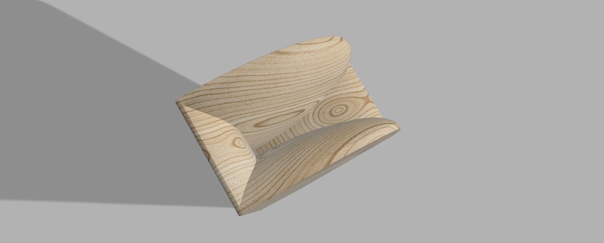

Really interesting points being made here. Just throwing this out ... do all radial horns have square entrances? I know the Yuichi A290 and many multicell horns have square entrances, and some multicells have what amounts to an internal adapter to transition from circular to square in the horn itself.
Most, but not all.
Some (few) have a round entrance, and then the rectangular cross-section has an inner fillet with a radius that is initially = that of the throat.
E.g., see the (very expensive but very well made) Japanese radial horns by GT Sound
No, you can make it very smooth:
But the traditional rectangular throat is easier to design but leaves the adapter as a missing link:

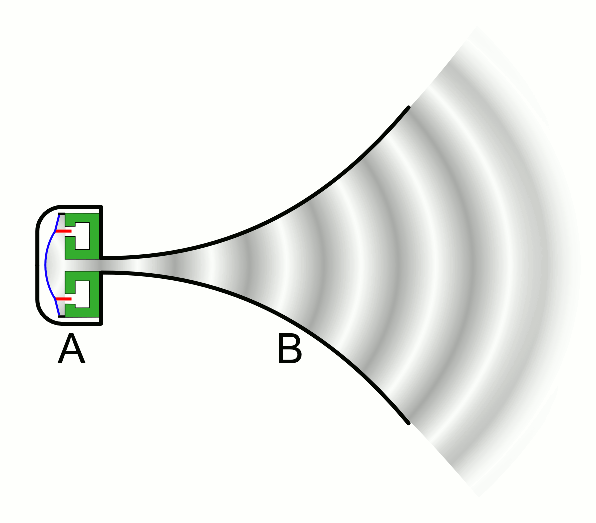

In the case of an exponential or hyperbolic-exponential (hypex) horn, m is normally used as the symbol for the flare constant. T is normally used as the symbol for the hyperbolic-exponential horn flare parameter.
The cross-sectional area at distance x from the throat of a hyperbolic-exponential horn is given by:
Sx = S1 * (-(1 + T) * Exp(m * x) - (1 - T) / Exp(m * x)) ^ 2 / 4
Following up on David who shared equations relevant to the topic, let me introduce a couple more.
There is only one flare parameter value that satisfies a set of Sx, S1, x, and F12, and it is given by
T = ( sqrt(Sx/S1) - cosh(m * x) ) / sinh(m * x)
where:
m = flare constant = 2 * Pi * F12 / c
Alas the hypex equation contains a transcendantal function of F12 meaning that F12 can not be isolated in a closed form expression and must be searched iteratively. F12 and T are tied together. Find or set one and the other is a given.
Following up on Pano's question on angular matching, matching just the flare is choosing a driver that has an exit half angle close to that of the entrance of the adapter (halfAngle(0)), which is given by
halfAngle(x) = atan( [ sqrt(Sx+eps / pi) - sqrt(Sx / pi) ] / eps)
where
x is distance and set to 0 for finding the angle at the entrance of the driver
eps is some arbitrary but very small distance
Sx+eps and Sx are the hypex areas calculated at distance x+eps and x using the equation given by David.
As an example, taking F12 = 320 Hz, T=0.7 and a 1.4" adapter entrance, the half angle there is 4.16 degrees. A driver having a 10 degree exit (5 degrees half angle) would fit well.
Turning to the exit end of the adapter, provided that the horn and adapter are both hypex with the same F12 and T, then their flare angles at the mating point must by definition match perfectly - as must their areas. This is if they are both round, otherwise the angle is not constant around the periphery.

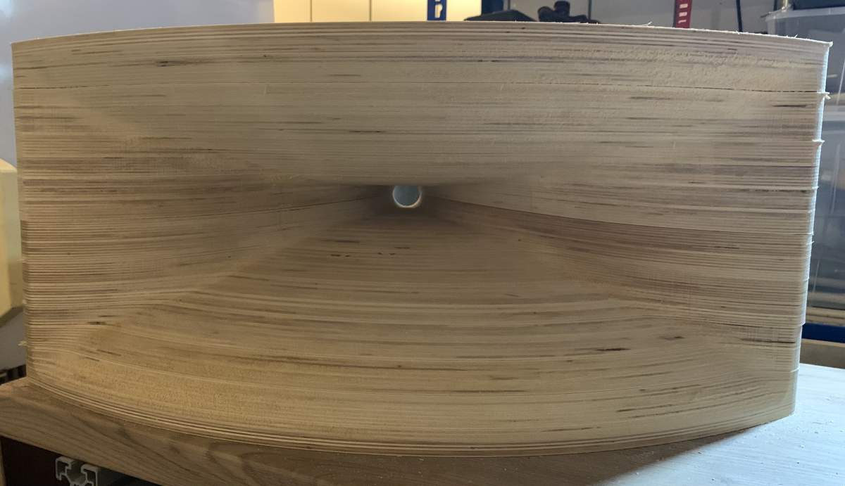

The missing link.
This is well put! How does one select a driver and an adapter to fit a rectangular entrance horn?
Given the knowledge, computers and 3D printers we now have, I think there is an opportunity to design very good adapters. Better ones than could have been designed back then. Hey, our adapters can even be tailored to fit specific driver and horn pairs.
Looking into this, I find that there is a minimum difference in surface area between the adapter entrance and exit that allows designing a throat expansion profile that is close to optimal - especially if one wants to crossover low. Starting with a 1.5 or 1.4 inch exit driver gives plenty of length to meet all the constraints that I cited above (size, angle, flare constant, wavefront shaping). A 2 inch driver does not leave much room to adapt the waveform for a TH4001 or Yuichi A290 horn for instance. In the pro world I guess this is less of an issue as they tend to crossover higher.

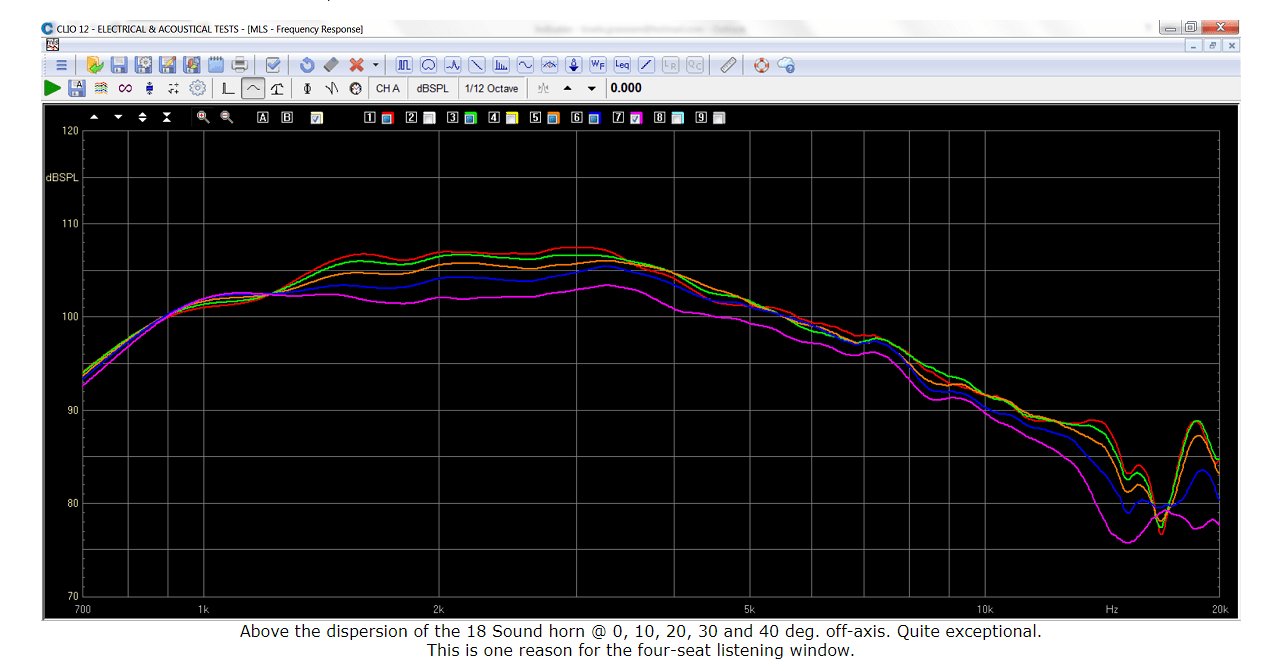

Our Canadian friend, Joseph Crowe, has discovered that 18Sound has been doing some very odd things with their published frequency response and polar graphs:

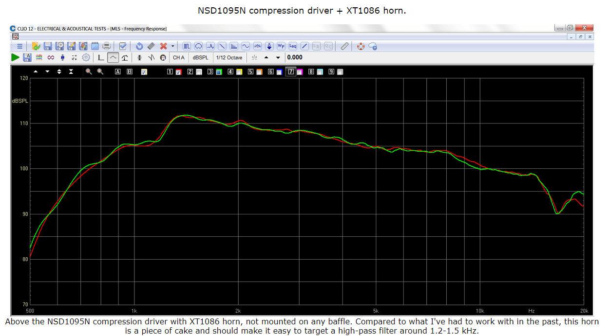

Here are Troels Gravesen's measurements of the 18Sound NSD1095N on the 18 Sound XT1086 waveguide ( it doesn't really get much better than this for a raw response on a smallish horn );
