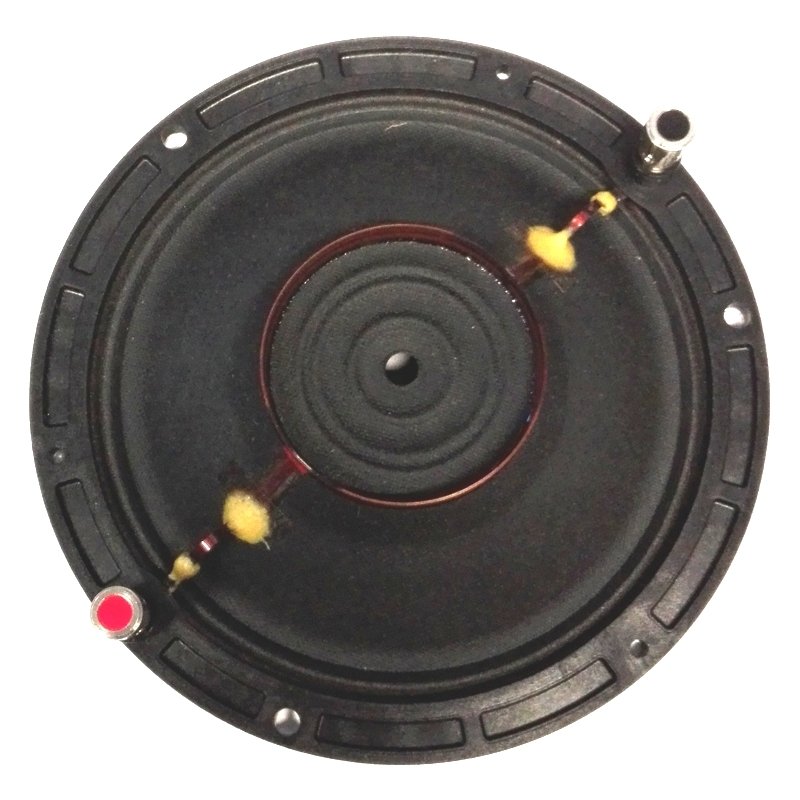

Question: Is the 16 ohm DCM50 really not a 4” diaphragm?
It's a 5" paper diaphragm.2" exit.
WIth a 2" Voice coil.
Unlike traditional compression drivers/ domes.
It is "driven' from the center, Voice coil is in the middle like a normal cone driver. With a half roll surround termination on the circumference like a normal cone driver/woofer.
So it's construction is quite a bit different then a standard 4" /2" compression driver.

It's a 5" paper diaphragm with 2" exit. WIth a 2" Voice coil.
Unlike traditional compression drivers/ domes. It is "driven' from the center, Voice coil is in the middle like a normal cone driver. With a half roll surround termination on the circumference like a normal cone driver/woofer.

It's a midrange driver with a composite 5" diameter annular diaphragm with a 2"diameter voice coil, quite different from a 4" dome diaphragm designed to cover up to 20kHz.
