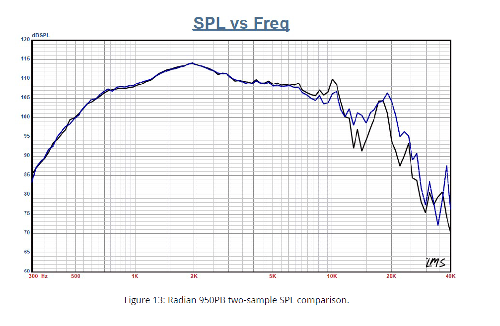

Unfortunately I have lost the response measurements on the 2380A horns I used to own, but I do not remember there being a large 1kHz hole in the response with the NEO950PB-16. I believed that behavior is related to a horn/driver interaction, but cannot swear to it. Sadly the data that would support my original (and perhaps erroneous) findings is lost.
This is from the attached article and is consistent with what I remember on the JBL horn - I used a comparatively low Q filter in DSP at 2kHz to flatten out the response.
Horn used - from attached article. (Both 760 and 950 are tested on this horn in this article.)
I based my purchase decision on this article and was very happy with these drivers until I put them on a pair of Yuichi A-290 clones.

That review of the Radian 950 looks weird to me. Given the Radian 950 is a 2" exit horn and 4" dia. rated for response by the mfg down to 500 hz, I don't understand the decision to review the CD on a 800 hz. cutoff horn. That's a small horn for a big driver. Maybe it doesn't matter on a waveguide? I don't know, I'm the least to know here, but none of this makes any sense to me.
Vance said "First, I decided to test the 760NEOPB (see Photo 1). However, Radian does not manufacture horns so I used 18 Sound’s Model XR2064, which is a 60° × 40° aluminum horn with a 2” throat entry," This is my point about these reviews and mixing and matching measurements with about a dozen variables changed, then making a causation conclusion. Vance is doing this all over the place in his reviews. Like he just picks up whatever horn is on his desk, then writes up a review about a CD. And, Fluid thinks this information is more useful than a Joseph Crowe review? Just because they're done on a JCA horn? I just don't get it.
The XR2064 is a 800 hz. cutoff horn and of thin die cast aluminum construction. Vance's measurements show breakup and a big increase in distortion and also shows up in CSD plot around 10 khz, but Vance says breakup is a 20k. Okay, but this looks pretty terrible at 10k. Arez confirms this with a CSD plot that looks terrible at 1k and 10k. I'm guessing the TAD drivers don't look like this on any test. Not sure there's really anything else that needs to be said. All the data just points to the 950 being less than audiophile quality by anyone's standards of evaluation. Why start speculation about exit angles and fantasies about wave front shapes?
I don't see how any generalized conclusions can be made from any of this. It's a roulette wheel of experimental design where key variables are changed randomly then a bet is made on Red #15 being a winner. Unless, we just say, if the CSD looks like garbage in your pass band, stay away!
