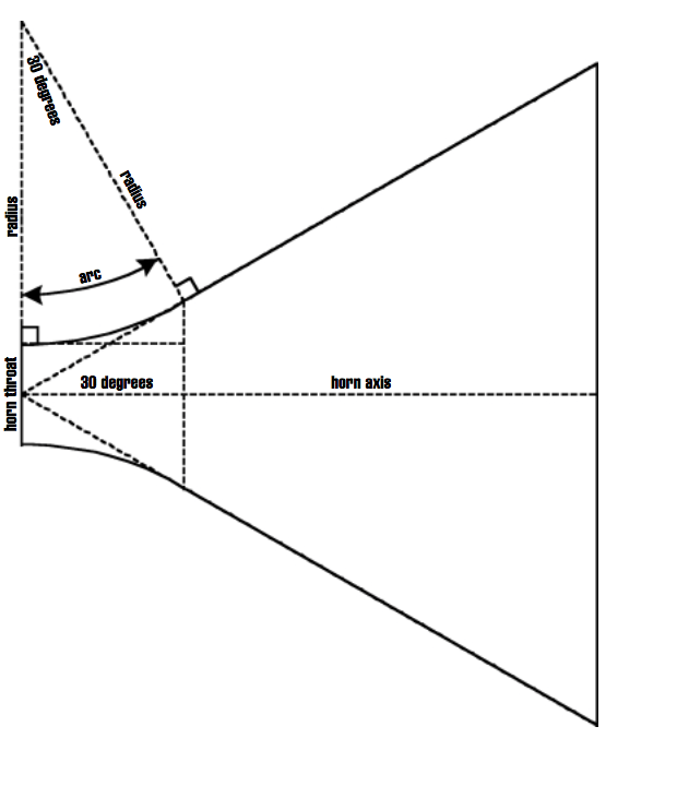

An example: Quite recently, I would tend to think that a one smooth curve (with continuous curvature) as a horn profile is desirable, starting right at the phase plug exit, but now I'm not so sure even about that anymore. The quadratic throat shown above has a large curvature discontinuity at the point where the arc connects to the straight wall, causing a reflection. Is this bad in the end? I don't know anymore. I'm only pretty sure it wasn't meant as an advantage.
mabat, thank you. I have also been struggling with these geometry questions about that short throat section. Even though Geddes states clearly, or emphatically as an editorial comment to his scientific work, that the acoustic impedance is predominantly, or I think he even says solely determined by the mouth and throat diameters by his ray acoustic math, this short straight or exponential expansion section at the throat of the horn appears throughout designs for diffraction optimized horn curves. We see this in Don Keele's designs for EV in his paper "What's So Sacred About Exponential Horns?" where he explicitly addresses the cutoff loading improvement of having a short exponential expansion section prior to the waveguide section and then the mouth termination profile is also explicitly addressed as a separate section of more rapid flare. I think others like Kohlbrek have also shown that this short section improves cutoff loading and Kohlbrek even points to the deep internal throat of CD's like the Altec 288 as having a beneficial influence on use for LF horns. The paper by Hughes about the Peavey horn also has this short section without a solid acoustic justification except something about the acoustic source at the vertex. It appears to be a kind of acoustic loading patch to constant directivity expansions.
It has me coming back around to the Le Cleach approach where a hyper exponential expansion of some value of T = .7 then has the Le Cleach iterative math applied to it to get an expansion that keeps the wave front normal to the sidewalls all the way past the mouth. A designer can then simulate the tradeoffs of loading, directivity and diffraction all in one operation simultaneously in Hornresp. For example, if a hyper exponential expansion uses a value T = infinity, it becomes a conical horn, which looks a lot like a waveguide to me. With the Le Cleach expansion transform math as applied in Hornresp to a hyper exponential expansion model you can essentially dial up or down constant directivity geometry as much or as little as you like and get a comprehensive axisymmetric profile including throat and mouth termination and simulation. True? That's a nice escape hatch from a what's best discussion about pure profile categories.

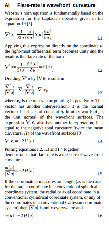

I think this improvement has not much to do with the short section being exponential per se, as it turns out that the exact shape is of little importance. All my experiments indicate that it is the wavefront mismatch, the reflection and resonance that actually helps to increase the throat resistance on the lower end of the passband in this kind of design (although the mechanism itself it still quite obscured to me). What I find important is that this extending section doesn't open too much itself, because then it causes HF beaming. Basically, it can be even cylindrical.We see this in Don Keele's designs for EV in his paper "What's So Sacred About Exponential Horns?" where he explicitly addresses the cutoff loading improvement of having a short exponential expansion section prior to the waveguide section [...]
BTW, when talking about wavefront mismatch, we could as well talk about a flare-rate mismatch, as it seems this is actually one and the same thing:

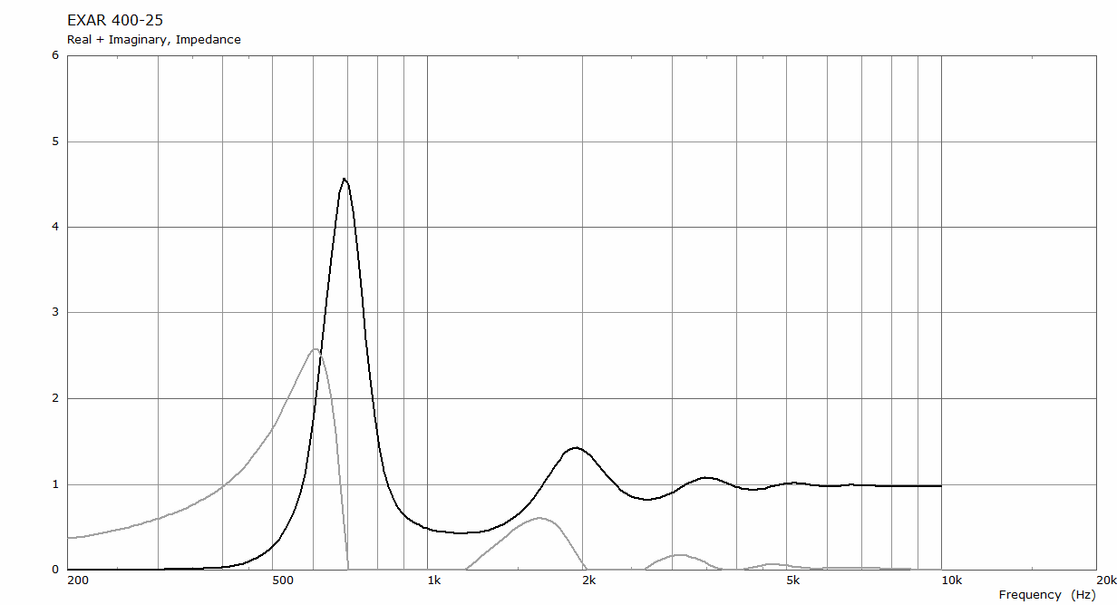

Positive imaginary part corresponds to acoustic mass and negative imaginary part corresponds to acoustic compliance - quite hard to imagine. But it's never without a non-zero real part, i.e. the throat impedance is never purely imaginary.Thanks Mabat, I see the imaginary or reactive component of acoustic impedance is phase. [...]
Both parts (Re and Im) can have high values at the same time. They are in fact tied together somehow, I just don't recall the details now. At a peak of the Re part, the impedance is typically close to being purely real, the same as for Re being constant.
Yeah, this is kind of what I mean by intuitive leaps from the math. Complex numbers which have a real and imaginary part are a mathematical device to allow for SQRT of -1, or for equations that have a vector or magnitude plus direction or angle of rotation of phase component. Our reactive acoustic impedance component may not have a direct translation into a physical or observable acoustic phenomenon. It is a necessary component of complex acoustic impedance computations, but I"m not sure it's useful as a separate value as an intuitive or directly relatable quantity to response or distortion or observable phenomenon.
If I'm looking at an acoustic impedance plot, I'm just thinking I don't want to operate a horn in a range where there are big swings or steep slope changes in Re or where the Im value is large and I am guessing these are tending to be related mathematically just as response, impulse response and phase are related and can be transformed with derivative equation solutions like the La Place or Fourier.

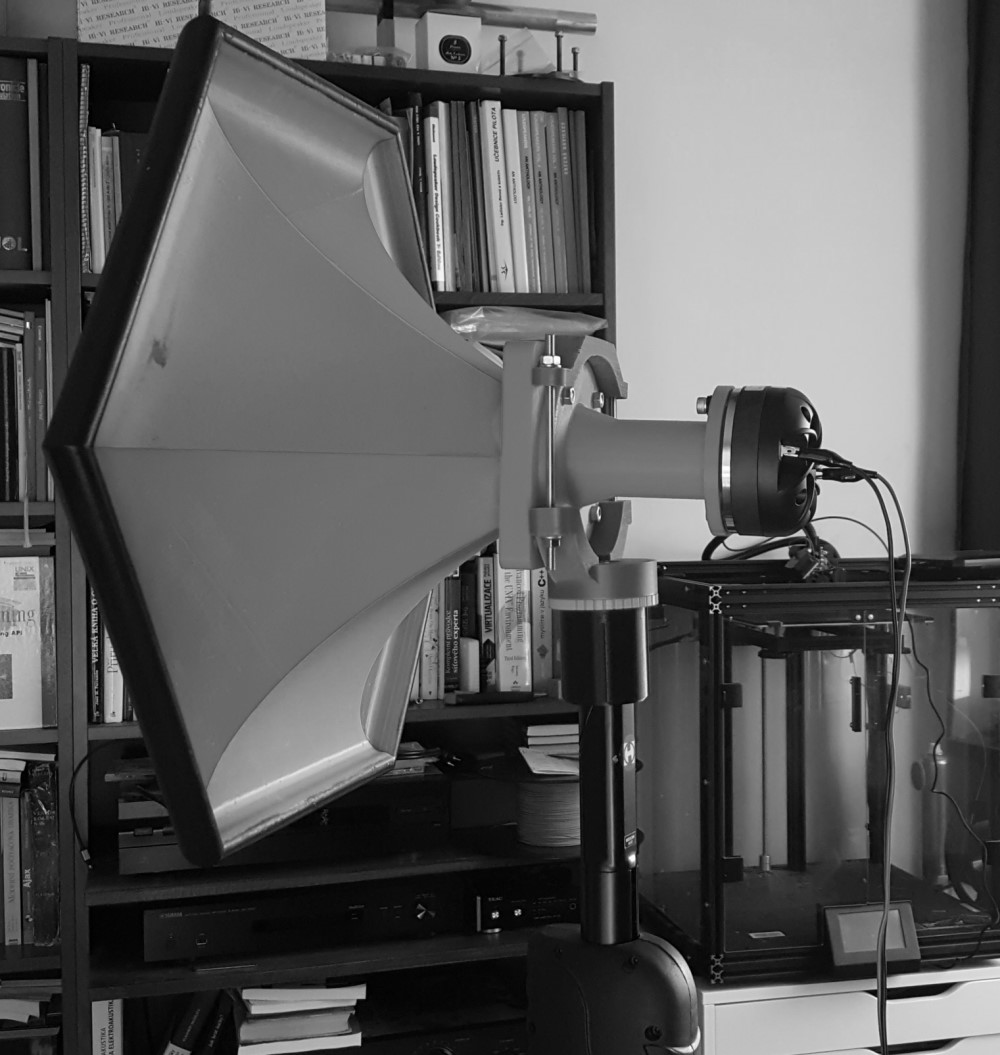

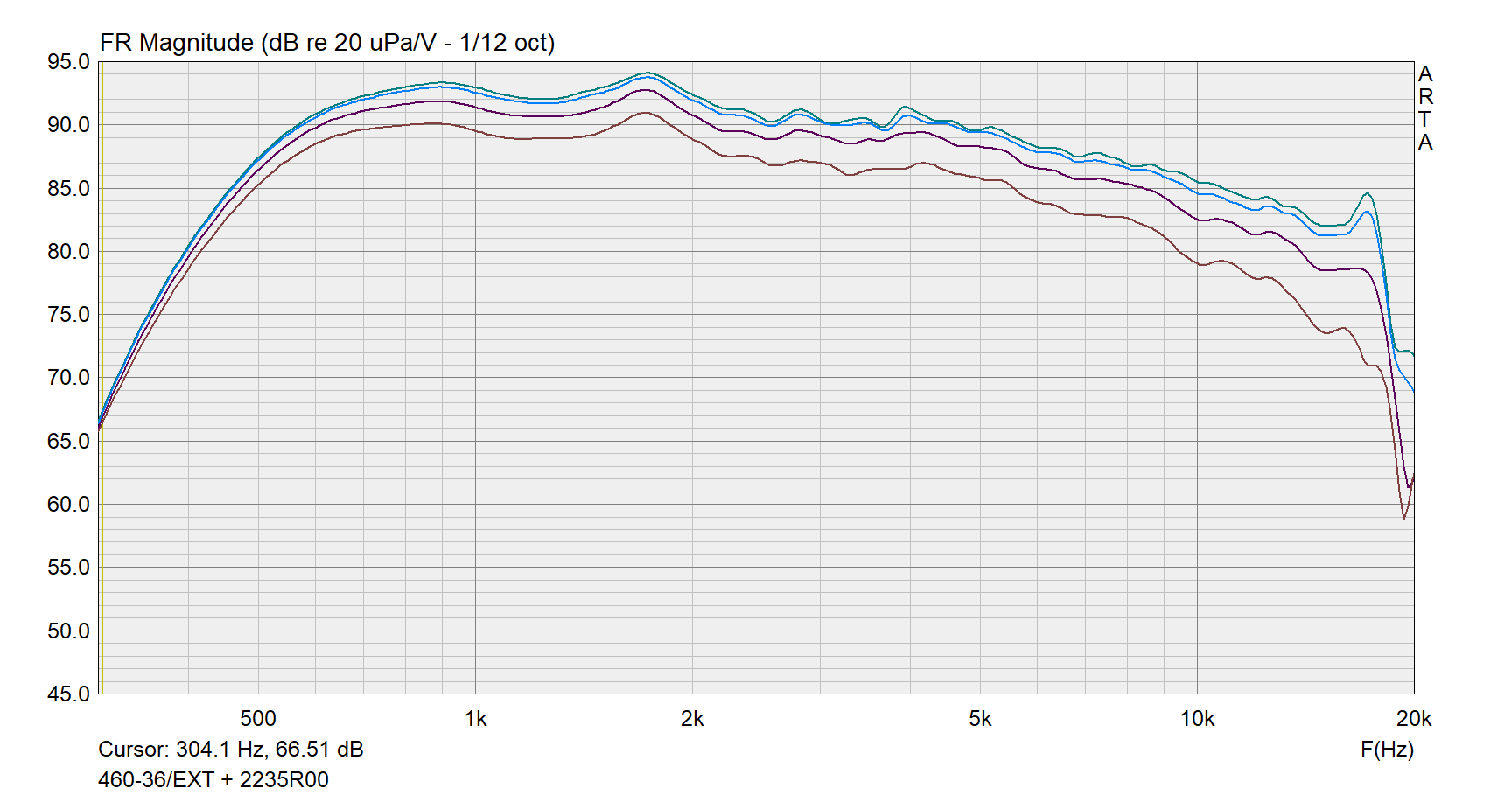

Like this? 🙂 I can assure you it's absolutely fine in every regard.If I'm looking at an acoustic impedance plot, I'm just thinking I don't want to operate a horn in a range where there are big swings or steep slope changes in Re or where the Im value is large
(It's one and the same device - throat impedance and raw acoustic responses at roughly 0/10/20/30 deg.)
