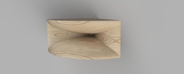

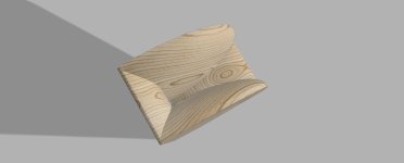

No, you can make it very smooth:Really interesting points being made here. Just throwing this out ... do all radial horns have square entrances? I know the Yuichi A290 and many multicell horns have square entrances, and some multicells have what amounts to an internal adapter to transition from circular to square in the horn itself.
But the traditional rectangular throat is easier to design but leaves the adapter as a missing link:

The missing link.But the traditional rectangular throat is easier to design but leaves the adapter as a missing link:
This is well put! How does one select a driver and an adapter to fit a rectangular entrance horn?
Given the knowledge, computers and 3D printers we now have, I think there is an opportunity to design very good adapters. Better ones than could have been designed back then. Hey, our adapters can even be tailored to fit specific driver and horn pairs.
Looking into this, I find that there is a minimum difference in surface area between the adapter entrance and exit that allows designing a throat expansion profile that is close to optimal - especially if one wants to crossover low. Starting with a 1.5 or 1.4 inch exit driver gives plenty of length to meet all the constraints that I cited above (size, angle, flare constant, wavefront shaping). A 2 inch driver does not leave much room to adapt the waveform for a TH4001 or Yuichi A290 horn for instance. In the pro world I guess this is less of an issue as they tend to crossover higher.
