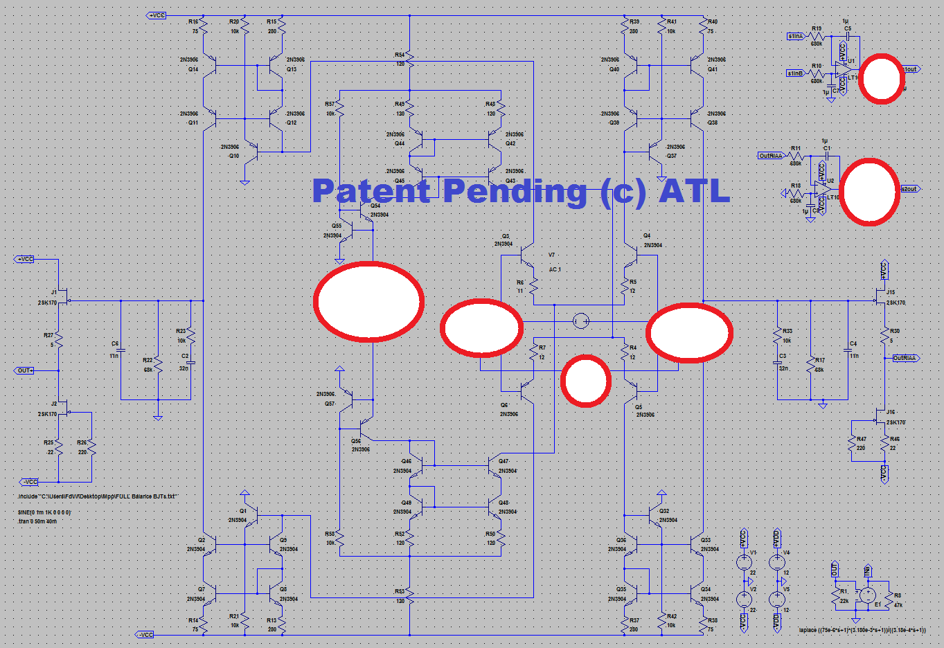

How would you split it? to in series with two servos one at each end?
Could youy show me the priciple?
I am aware that I need two servos in the schematic I have included just one but I was playing with the differential one as well.
Most probably ground the emitters of Q65 and Q67, split the resistor on 2 x 100 Ohm (or there about) and ground them. Use the other end's, of the resistors, to connect the servo's. I think

I had already tried that but unfortunately it seems not to work that way.
If I play around with current source and place one across A- and D- it will correct the differential offset as expected, but I can't come up with something that it would work on that location.

Mail me the model, and the components library, then I will have a go.
The problem you have is where to get the control signal (input) for the servo's. This van not be gotten from the output of the RIAA, there the differential errors are already added together and can not be separated anymore. Now that I have given it a second, better, look I do not see where to get the two control signals needed, and how to guaranty (if the input of the servo's does not come from the RIAA output) that the regulated output adds to zero.
The only way to do this is, make the RIAA differential in and out, adjust both sides with servo's, and then add the servo regulated sides into the one output signal. You need a lot more components to do this
a lot more
Stick those fancy V-teflons at the inputs, skip the servo's for absolute DC, only add a differential servo for relative DC.

And the bonus will be differential output, if you fancy that thing.
The balanced will have an additional problem, once the servo's start to service the servus correction the Dc-out, they will create an input offset and create a current flow in the cartridge. So only a fet version will be possible in a dual symmetric balanced configuration.
An option could be to servo the input and cap the output.

I have the FET version model. However for some reason it seems to be much noisier at low frequency and that is why I was perusing the BJT versions better.
I will post here for the benefit of Frans and the other people here, the model I built with library.
The OPA1632 version is like that. Differential RIAA and differential
servo.
Would you like to carry over in parallel to the topic of the servo, the OPA's approach.
So far I Was unable to get the model up and running.
There's is a way that may work with your interfets, sometime ago I (in this thread) showed an N channel fet RIAA. The top and bottom was mirrored over to a current output node. two such circuits can feed the OPA1632, and you can make 2 servos one from each current output node.
here is the model
Done
Output Offset 1.3uV
Input Differential 118pV
Servo 1 Output 311uV
Servo 2 Output 550uV
