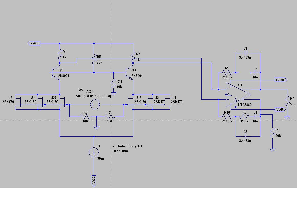

I added your corrections, please tell me if I missed something.
Nevertheless simulated model seems not to work still.
Any thought?
Add a capacitor, say 100u to 1m, in parallel to R11, then add a few base stoppers to the transistors, say 50 to 100 Ohm. Anyway that is what I would do 🙂
yes agree with you, but this won't change the fact that circuit seems to not simulate right or better it doesn't operate properly.
any hint?
Maybe I am using the wrong model for the differential opamp?
