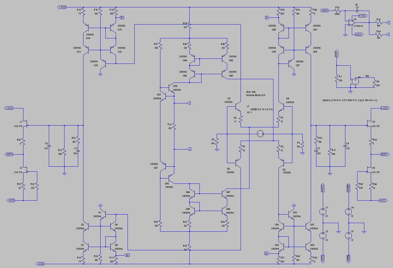

I have creted a schematic with the differential input stage you had proposed on Paradise thread and used folded cascode to have a fully DC coupled differential in/out.
I thought this would have been worth posting it here on the Masterpiece.
It simulates great and everything.
The only problem I was unable to solve so far is the servo for differential.
I have been thinking and playing around but I cannot come out with something that works symmetrically.
I hope someone here will have some idea.

You can not make a single servo for a balanced circuit, you need to use 2 servos. R12 must be split for this.
OK, so this is more or less a Paradise with the new input stage.
Yes, i know. making a servo for this is a major challenge.
I did not find the time to look deeper into it.
it is more less a differential input with mirrrors anyway....yes servo there is a challenge.
Don't you however think that this could reserve some good surprise over the OPA's approach or you still think the other way will yeald to a better result?
If we could design a servo here I could try it and see how it sounds and then report!
How would you split it? to in series with two servos one at each end?
Could youy show me the priciple?
I am aware that I need two servos in the schematic I have included just one but I was playing with the differential one as well.
