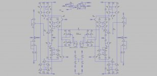

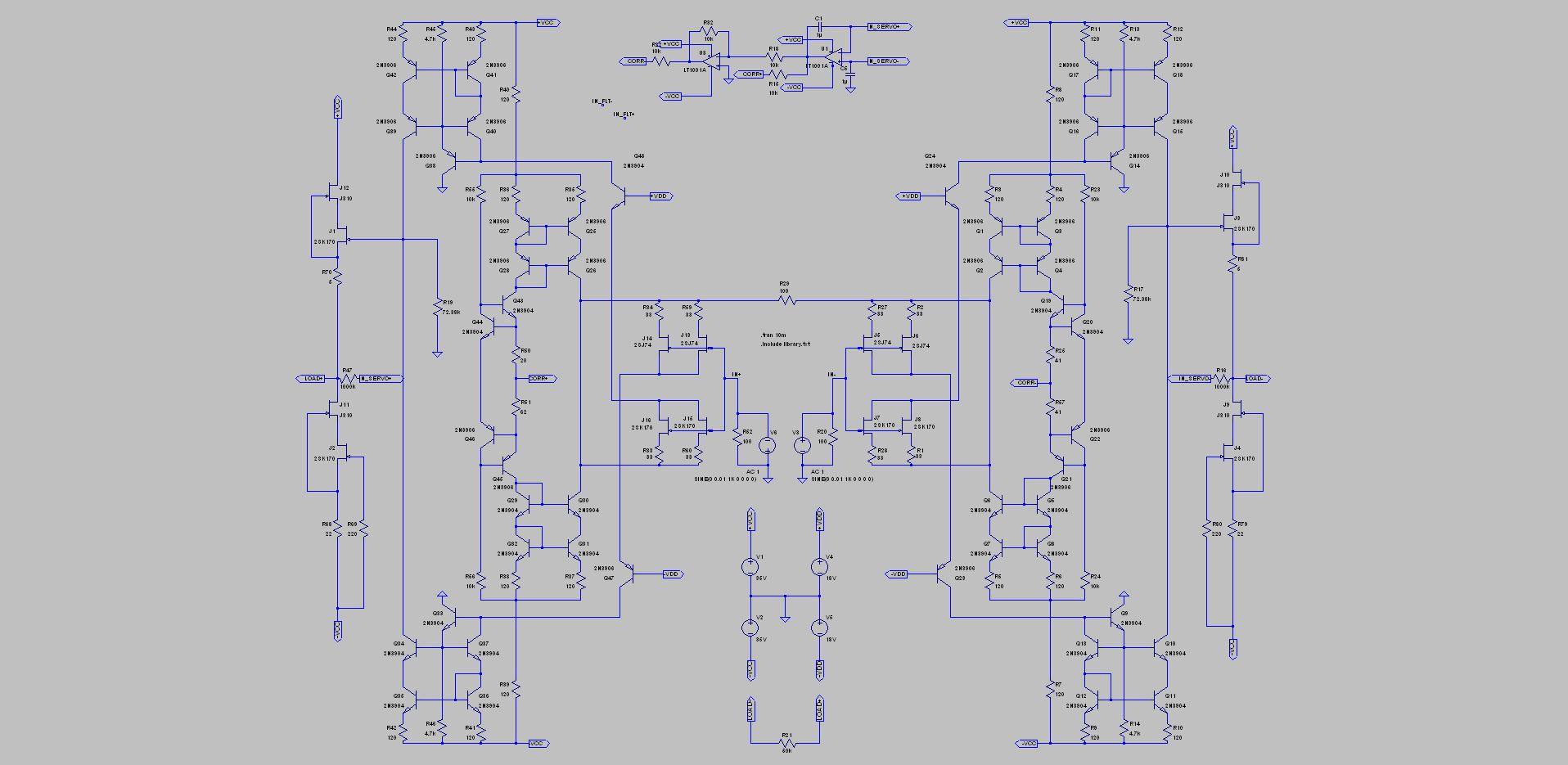

Hi everybody,
I am posting a circuit I have been working for a while, which is based on the mature technology from the well known Paradise.
Name was chosen by Joachim and it is: MasterPiece.
I have simulation models and a working prototype on my desk.
I just need to change the servo from a common mode's to a differential one (schematic has the differential type) and then test it on the circuit.
There are some noise issue still with it that I would like to track down and maybe with the help of all of you guys we can make a beautiful no compromise full balance phonostage.
Intent is to have a 2 gainstage with two passive transimpedance RIAA circuit for max precision and also standard value for the capacitors can be used to allow very high quality standard caps such as V-Caps Cu-TFT and such.
Powered up with a low compensated shunt PSU (which I already have a functional design with layout) and battery operated and premium parts for the circuit.
My intent is to create the best of the best if possible.
Also this is not going to be for sale nor anybody here should consider it as such.
This is DIY ONLY.
Moreover,it is probably NOT going to be a DIY Group by like paradise kind of deal unless something on the way changes.
Last phase of this project will be to design HW and SW for the battery management system for it.
Like I said I have working prototypes and I can implement all the changes required measure and testing.
Also I will be designing the layout work on simuation for who is going to work with me on this so that everybody who is on board can test along if necessary.
Let's the journey begin!

This is interesting.
However for this one, with your approval and if you don't have any major concern with noise, I would like to go for JFETs instead of BJTs.
Also, the other thing I would want to avoid is the use of the "bootrasps" capacitors C5, C6, C12, C13 on your design.
The gain is going to drop down, but the main feature would be to have 2 gainstage with transZ RIAA filter if you don't have any concern here either.
The servo you see on my schematic conceptually works for differential DC, but I am concerned if it is going to take care of Absolute drifting or that will just wonder and that might be a problem if two stage are used and if one wants to use it SE.
If a viable soliution for differential servo wouldn't be found we can always use 2 separate servos for each side.

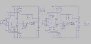

Anyway, cutting to the chase, I am experiencing a pretty noisy output and I can't understand why.
The next post I will postI will include the schematic for the entire phono with the 2 RIAAs split.
I tried to connect it in this fashion without RIAA and I had a huge noise.

This looks like two paradise boards connected at the same time to one cart side output...
Am I too far away ?
There is the caveat where the feedback connected serves to lower distortion of the two halves and also allows you to run it either SE or Bal.
Other than that it is using the basic structure of the Paradise. Servo is different to accomodate Differential outputs.
Also it is going to be 2 stage without the "boosting" capacitors and two TransZ networks for max precision and fitting standard capacitors.

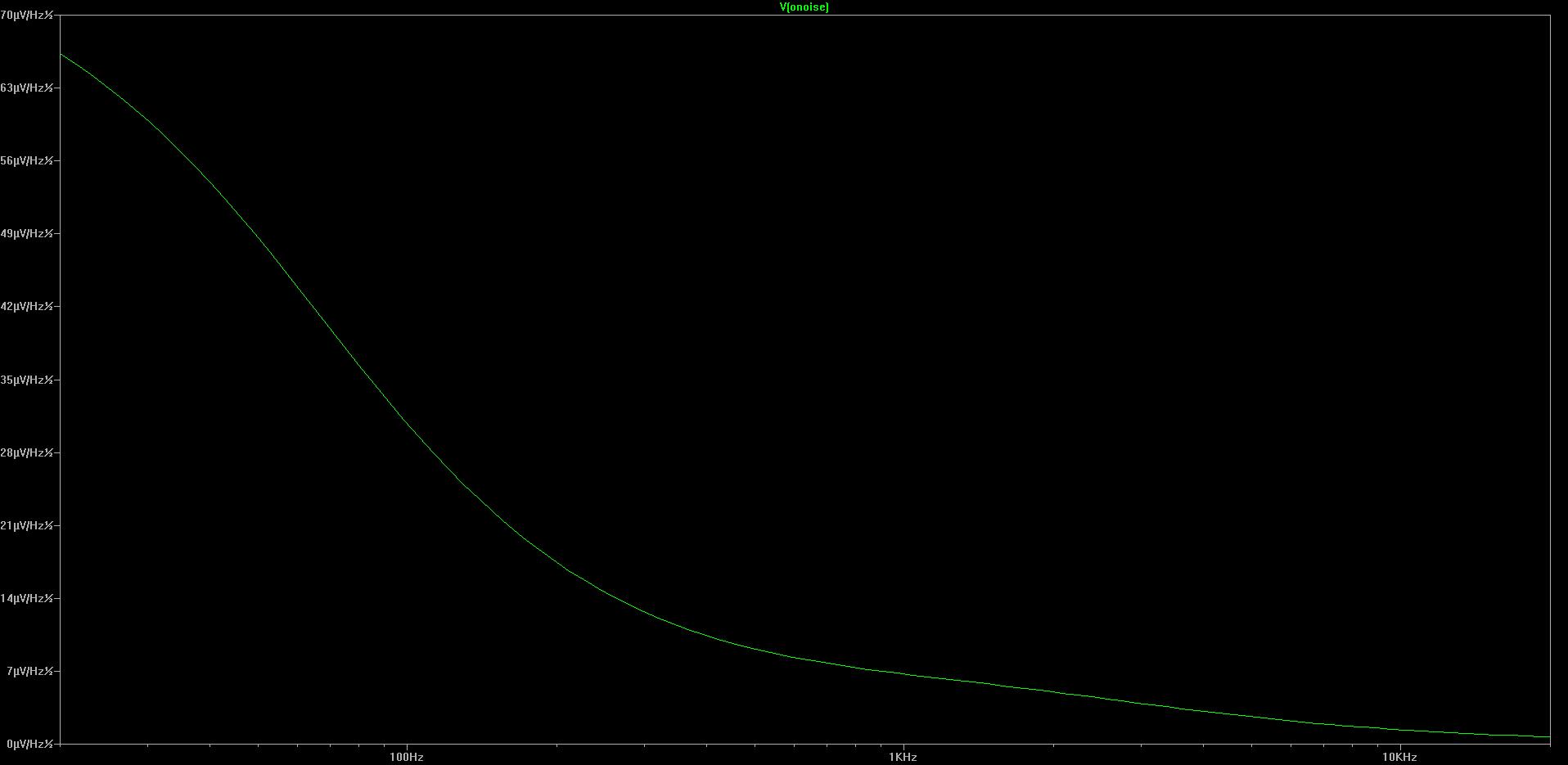

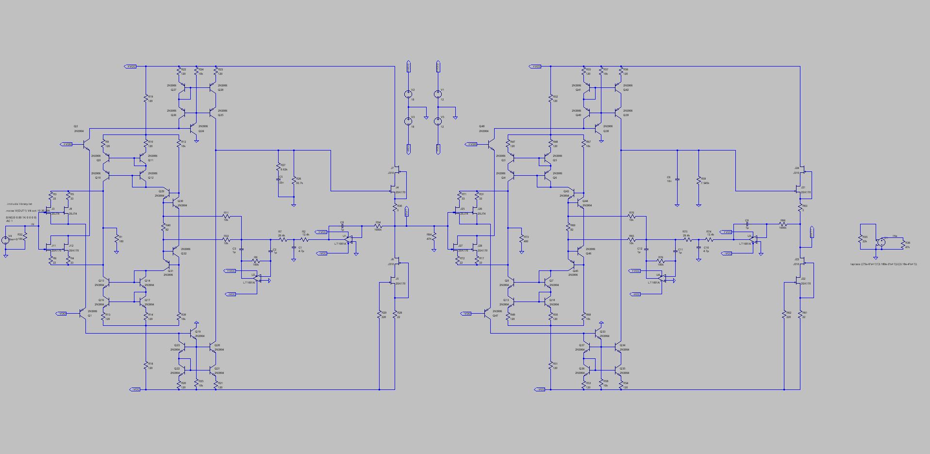

Here is the circuit in a SE faschion just to show how the RIAA is going to look like.

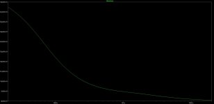

I have run frequency response's simulation and precision with this arrangement and values is over the top and like you can see it uses standard capacitors to achieve that.
Muy concern here is the noise and as the simulation shows, noise is way too high for a low noise MC amplifier.
Any input is welcome.
