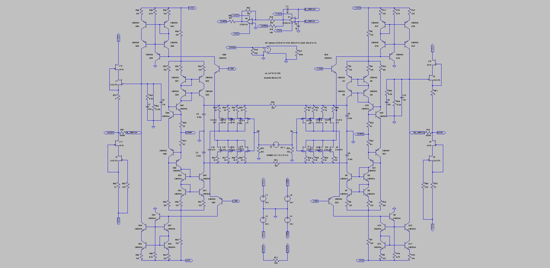

Why are the 2SJ74 connected to the cascodes with the sources ?
ok that is probably a glitch on the schematic. both J74 and K170 are connected to the cascode through their drains.

this is getting very complex... Why did you use two circuits in series ? Is is a split riaa ?
Split indeed. The servo alone is looking bulkier than my entire phono pre 🙂

I used two circuit in series to be able to split RIAA, having more control on the precision and split the "burden" on each stage and I wanted to operate each stage at lower gain

Anyway yeah the servo is a little bulky, but remember you are trying to correct the differential signal so you need the inverting stage to be able to do it.
alternatively you can
1) use coupling caps (which is not the best soluition IMHO)
2) use two single sevos.
What are the benefits of doing the 50hz -500hz shelving in the first stage and than the low pass filter on the second besides beeing more acurate in the shelving itself ?

I can not read the schematic values... would you care to post a PNG pic file with more resolution ?
I would like to play with your values... just for learning purposes 🙂

The reason is:
1) more control and more accuracy on the shape of the RIAA
2) each gainstage operates at a lower gain which gives you benefits in terms of both harmonic distortion and frequency response
3) No use of Big electrolytic capacitor on the signal path (whether in series or parallel)

So to avoid the big EL you want to use lower gain.... That is a very good reason.
I never used a split riaa because using one more amplifying stage I would invert signal (because I use SE single transistor amplifiers).

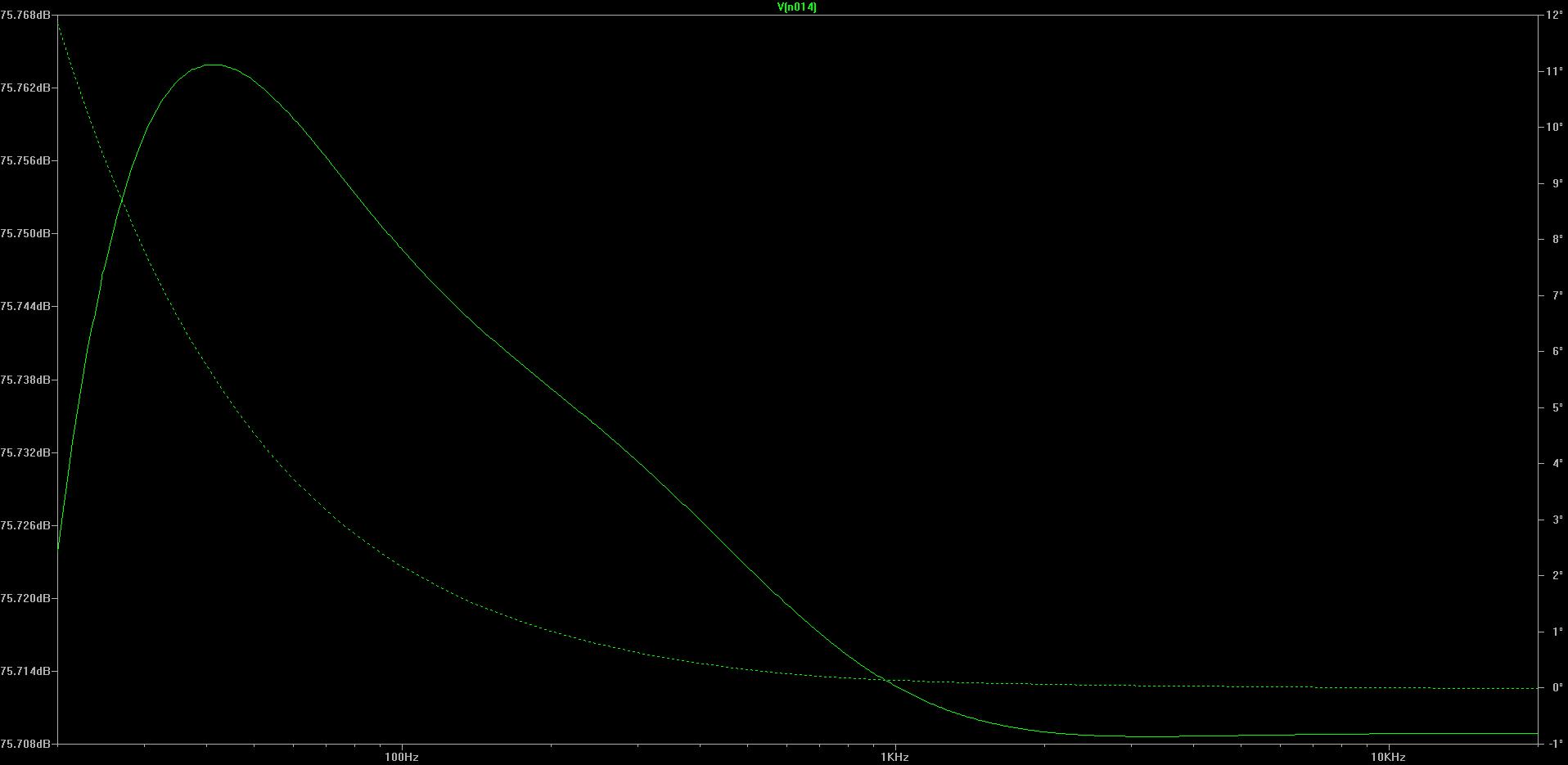

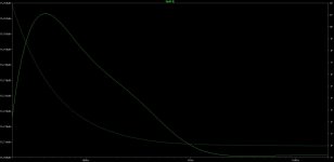

For everybody's enjoyment, here is a balance version of the paradise wrapped up for you with values and everything.
The relative RIAA's accuracy is attached as well.
I lowered the "bootstrap"'s cap values as it still yealds to a very precise shape
As it can be seen it doesn't use Standard values for the RIAA and getting custom made values for this is going to be pretty hard only with a group by they probably can be had at a good price.
Now I or anybody here with some skill can obviously build this.
What I have objected with this, is the use of high value electrolytic capacitors.
In my experience anytime such a part is introduced whether on coupling or on feedback or on shaping pole to compensate thermal they have constituted a deterrant effect on sound quality.
The effect on the sound is something I can clearly remember for as bad as it sounds compared to different approach.
This is the only objection I have with this topology.

In attachement the schematic for the balance MasterPiece and the Balance Paradise.
Using non standard cap values for the riaa is not a problem as we can always (and I always do) build the most acurate possible with parallel combinations.
Removing the bootstrap caps seems a very logical thing to do also (we are using servos to eliminate coupling caps so we should also avoid the EL in the signal path)

yes, on the one gain approach, you need as muich gain as possible to get up to 62dB and mantaining the same network for the RIAA.
Also since all the Trans-RIAA is going to be there, you also need more current capabilities on both FE and VAS stage to drive it at high frequency.

The circuit in post 1 will not work. I assume you have found out yourself because i see changes have being made in post 30.
