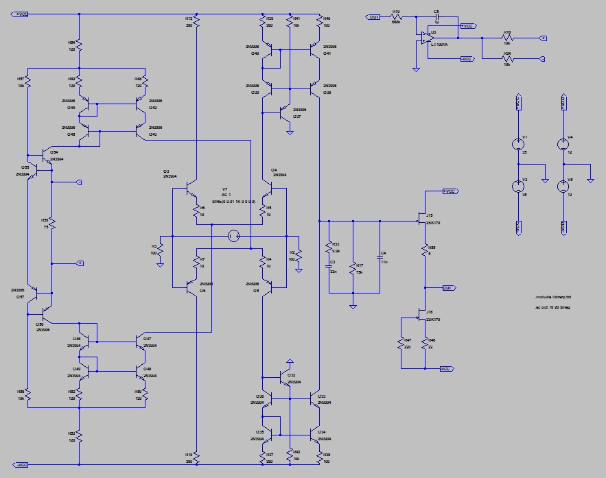

Gonna post it now.
Had to give it more listening
as promised, here it is.
Sound is good. I would be curious to see if a different output stage would perform even better and if the BJT for the peaking of the CM will help linearity.
I don't see any oscillation problem with it though.
I haven't made distortion measurement nor spectrum/ residual noise yet.
At listening the phono sounds with good dark background and nice low level resolution.
This doesn't mean that improvements are not needed, but it starts off pretty good.
I will try to rig up the balance version in the next days.
I have a question:
if in SE mode I load the cartridge with 100ohm when go to balance the two resistor have to be now 200ohm each or still 100ohm as shown on the schematic?

I think this circuit is very good in principle and it has good tuning potential. I tried this input stage in separation and it sounded very good to me. Very musical but also dynamic and open. Why not give up on the balanced in - balanced out version of this ? It would safe us a lot of trouble.
When you use a phono stage like his with two inputs and you want to load the cartridge with 100 Ohm you need 200 Ohm resistors on both inputs.
We have still the OPA1632 variety with the super J-Fets if we want to make bal-in bal-out unproblematic.

I am cool with what you are suggesting.
Ijust thought it would have been fun to carry over both approaches since I see a lot of interest on this circuit.
Anyway I agree with you that this input stage is very dinymic and opened.
I also find it very neutral, not on the warm side but neither smearing or harsh.
The peaking in the mirrors does not show up at the output because the RIAA is rolled of to zero by 10 MHz. It is so high up that i do not think that it is a real problem.
We can of cause try to make a better mirror and a better buffer. The Paradise already has an improved buffer. Even the Pardise buffer can be improved though at the expense of a bit complexity. I do not know if the Paradise buffer can be beaten subjectively but it can be done in such a way that it has a more robust current drive so can drive very low impedances.
I agree, the input stgae has my blessing. I already told you that i prefered it in the end over the current conveaour variety. Yes, this inpüt has a neutral " not there " kind of sound. I think we found the holy grail for a balanced BJT input. I would not look further but optimize what we have. Simply grounding the right side at the bases we can also compare bal in to unbal in so this circuit alows us to find out if balanced brings a benfit.

I personally think balance brings on improvements.
I can hear the darker background, more contrast and more dynamic.
Yes I agree with you with the description of the input stage and I would work things around that as I think it is the holy grail of the BJTs.
I have tried several and this is the first one that convinces me that BJTs have good potential for good and nice tone of colors.
Do we want to improve this one with the super buffer you had posted some time ago?

you meant to say ground the left side, right?
The positive is on the right side, so I am sure you meant to say to ground left side.

No, ground the right side. That is the parallel symmetric version of the Pink Tringle Pip designed by my friend Dr. Paul Mills, now with Tannoy.
It may also work grounding the left side but that variety suffers from Miller multiplication so is slower.

yeah but then it would become an inverting stage, wouldn't it?

It is funny but it works.
In our case the circuit inverts then. the cure is to revers the caertridge wires.
