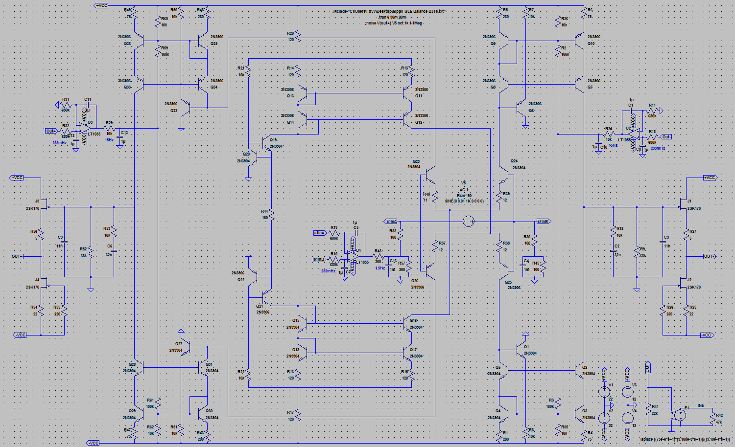

Looking at it, I really think this servo is intrusive.
Basically it corrects right at the input of a 60-65dB normalized gainstage.
Plus the use of the 1m right at the input seems excessive.
Isn't there any different way to correct it?
I am also thinking how much the differential offset will wonder if the stage is built with monolithic BJTs.
Also like I said the differential offset can be corrected between the two legs of the differential input but I was unable to find a suitable circuitry for that.
I am really curious to see what the other alternatives you have in mind are 🙂
Intrusive or not, this is my (most probably the only possible servo-ed solution) for the input differential. The big 1mF elcaps are there to keep the low (100 Ohm) ground reference as is in the original schema for AC. For DC the parallel resistor of 100 Ohm gives the servo some room to do its work.
I would say, take it or leave it, this is what I think is a good solution, if you have a better one, then show it.
P.s. I really fail to see what the significance of the term 'intrusive' is in this context. With regards to the DC offset, the servo is (near) 100% intrusive (as intended). With regards to the AC (audio signal), the servo is totally non intrusive (for frequencies above the FT of the servo).
The mirror just before the output buffer can be influenced to control the output DC offset. This can be done separately for the Out+ en Out- side of the RIAA. Controlling the mirror can best be done by using some form of current injection, that is controlled by a servo.
After giving this a bit more thought, I come with this for input differential nulling. The previous scheme will not work, the input differential was null due to the fact that the cartridge-model had a series resistance of 0 Ohm (a bikini model would have been just as effective). I upped the series resistance of the cartridge to 50 Ohm and added some offset injection (R58) for testing. This version will work.
For output offset nulling I still have no final scheme, those guys from ATL where not as smart as it seems 🙂 I do have some alternative ideas to try, but I also need more time, that I sparsely have.
And here is the completely servo-ed pre-amp. I'm sure the values can/may change, but the principle's are 'sound' 🙂 Note that R34 and R28 are not needed (and should be removed 🙂 Also the opamps need a separate +- 15V supply. Also I like to add some sort of servo output filter to slow it down and do some additional servo noise removal, this is not strictly needed.
P.s. I did forgot to take out the offset generator R58 🙂
Frans ... very very clever with the servo injection after the input stage in the current mirror, this will actually keep the input offset very very low and still correct the output, one may argue that they are in the signal path, but then again what servo is not.... 🙂 This circuit can be very very good, only one thing needs to be done regarding the RIAA section.. two set of components must be reduced to one, which on the other hand should be pretty straightforward.
yeah reducing the RIAA to one would be very desirable, but how?
Well, the servo on the SE version is not on the signal path directly, while the one for the differential is right at the input.
Don't know at the end of the day it is good as long as it sounds good, so it will have to be tried.
