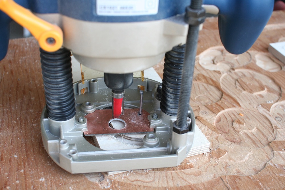

25 - the router plunge depth is set appropriately (around 5mm) and the driver rebate is cut into the front piece

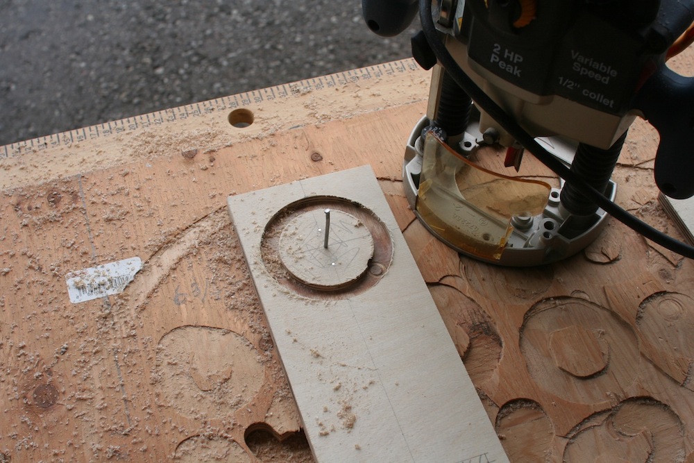

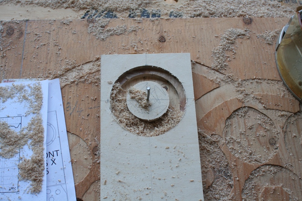

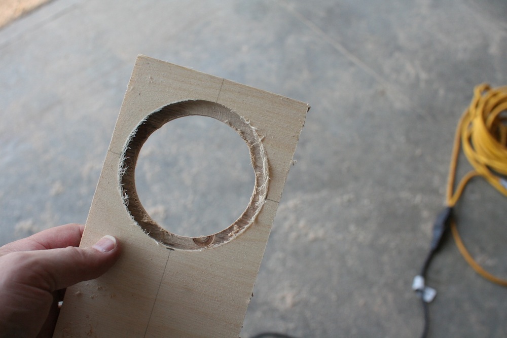

26 - for the driver opening I need a smaller hole so I cut out a jig from a piece of scrap pcb and screwed it onto the base of the router.
27 - The cutting bit clears the large hole in the centre of the pcb jig and a small hole drilled off to one side will fit over the pivot (nail) in the workpiece

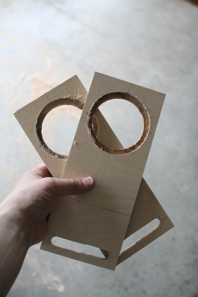

28 - the driver opening is routed out, the depth of the plug router is set to cut through the workpiece into the scrap underneath
29 - driver routing finished, next job is to route the slot ports
30 - finished front pieces, the slot ports turned out slightly ragged due to my poor clamping of the workpiece

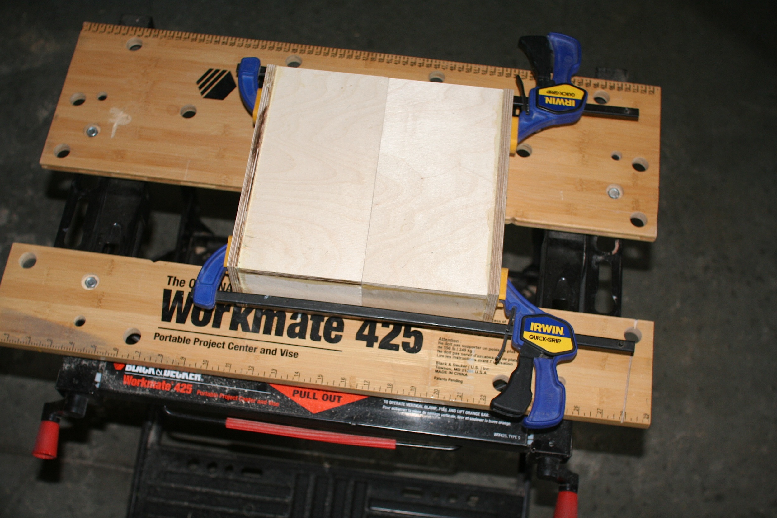

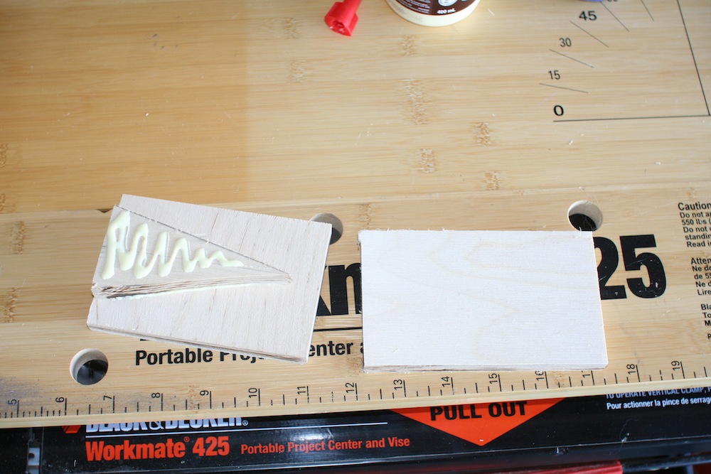

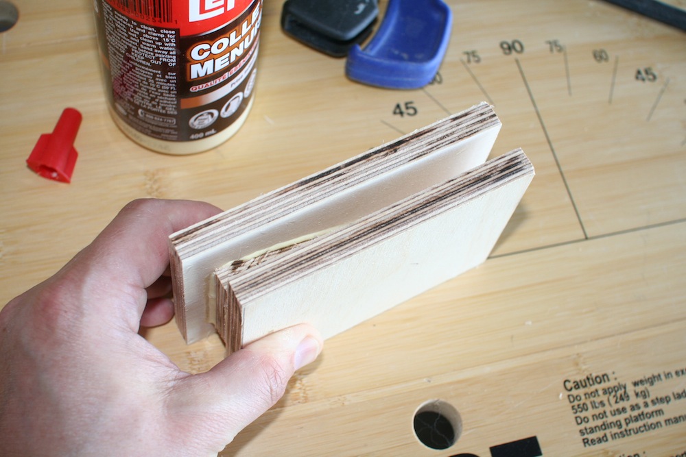

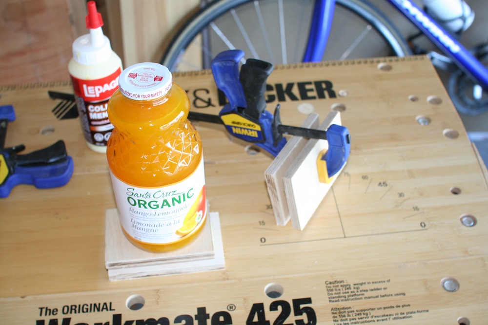

31 - start the build by gluing up the port spacer to the piece that forms the top of the slot port
32 - add the both piece to make a sandwich of the port spacer

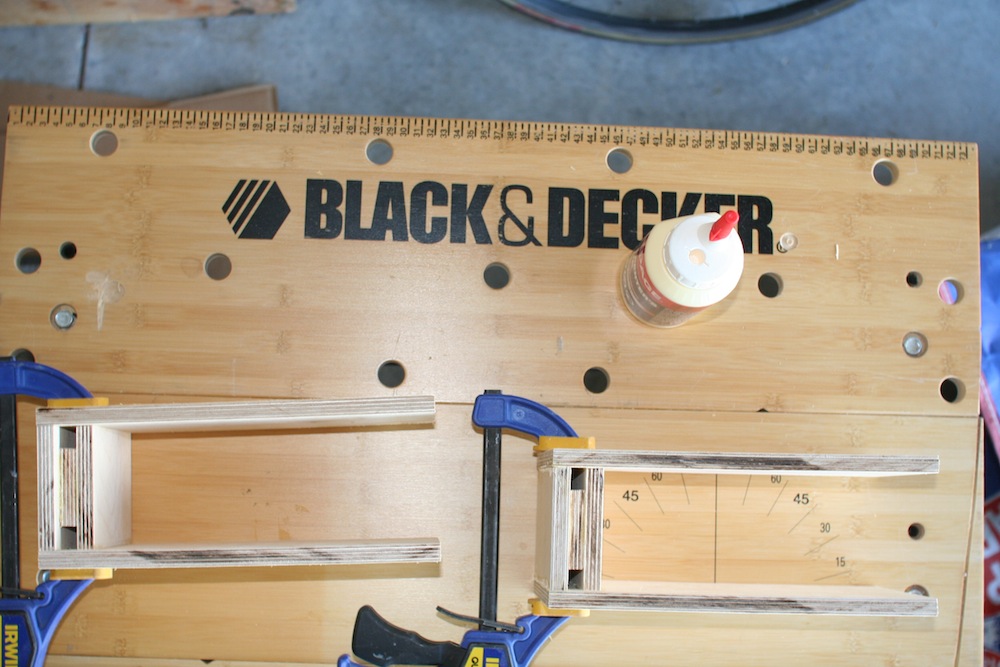

33 - clamp the bottom assembly

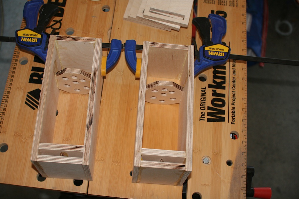

34 - next step is to glue the sides onto the bottom assembly, place the whole thing flat against the bench surface to ensure the edges of the sides are parallel

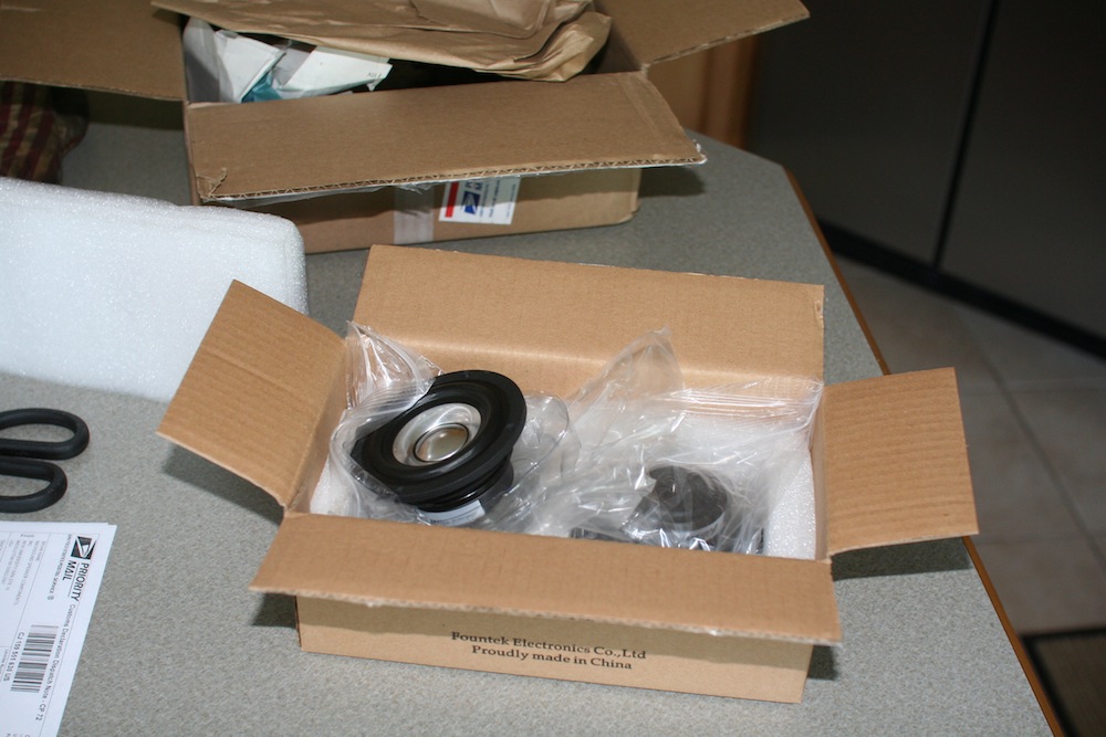

35 - the new drivers arrived in the mail today, which is great timing because I need them to size the holey braces
36 - braces sized and along with the tops, glued into place between the sides. I'm not a neat person when it comes to gluing things - it'll all be hidden in the end.

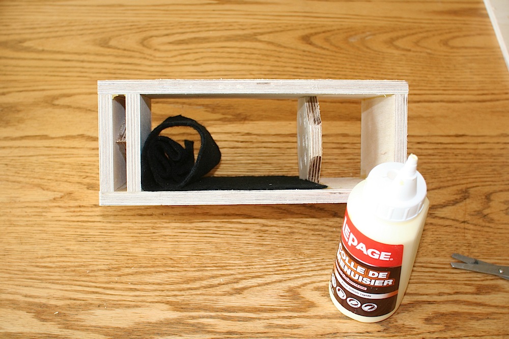

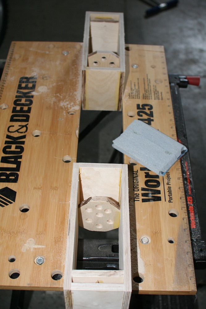

37 - next we sand paper the edges flat, we want to get a good seal between the edges and the front/back panels and it's good to do the sanding now so all the dust can be kept away from the felt lining

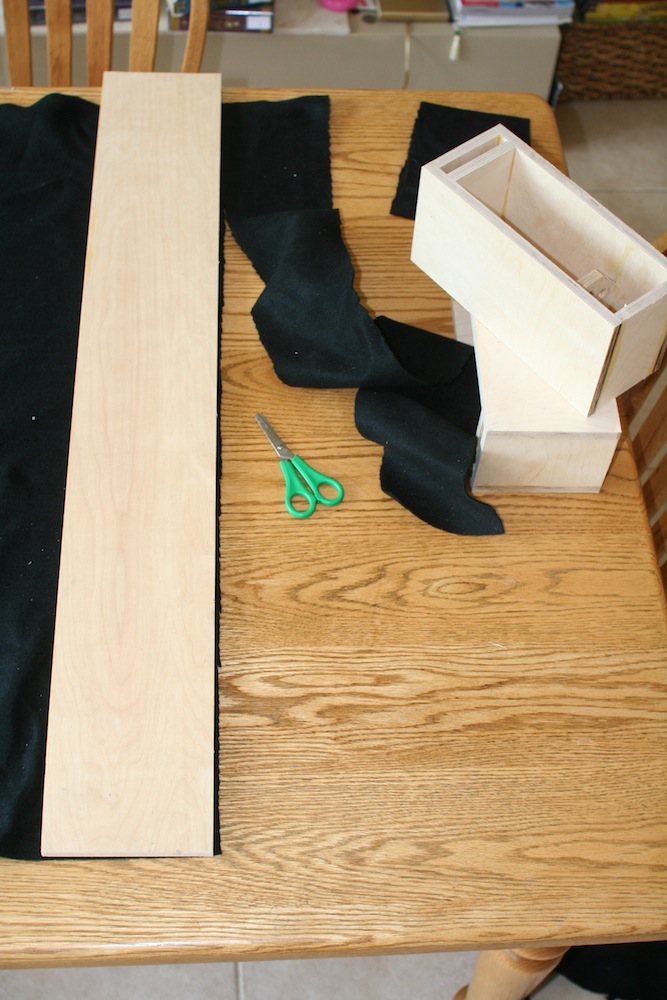

38 - cut the felt into strips with a width equal to the inside depth of the speaker enclosure
39 - install the felt along the inside of the box, I use wood glue to hold it in place

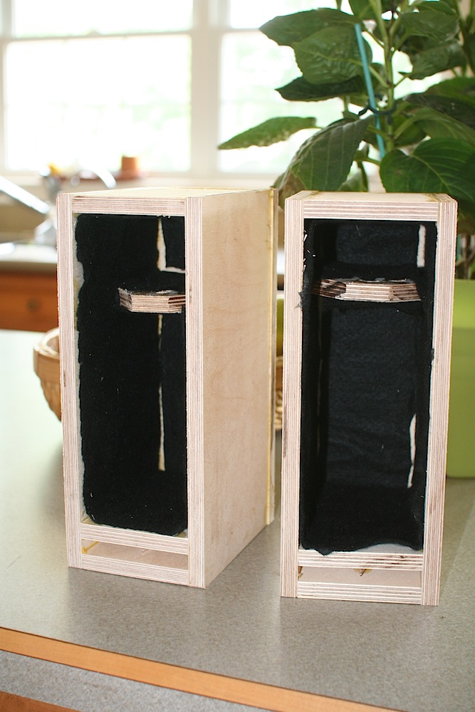

40 - cover the backs with felt but leave a space for the brace and box edges. The felt I have isn't very thick, so I cover all the surfaces and before I close it up I'll throw a few scraps of felt inside for good measure
41 - glue on the backs and clap
42 - end result, just need to add the front baffle

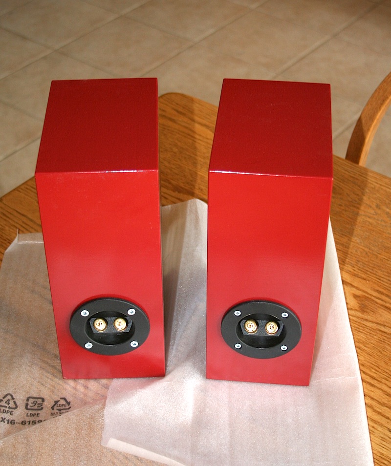

I put some big holes in the back to fit terminal cups instead of the screw terminal feedthrough type I used before. I glued on the front baffles.
And I flush-routed the edges. It's a bit rough and I'll need to do some work before I can apply any finish.

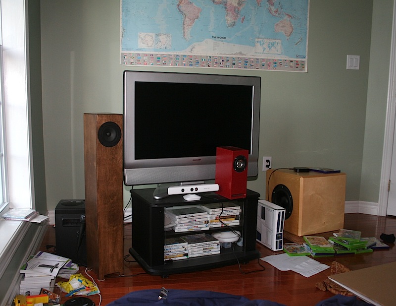

We're in the painting phase now. A coat of primer, a few spots of filler, some sand paper, back to the primer. After 4 or 5 coats of primer I'm ready to go and get a can of top coat.

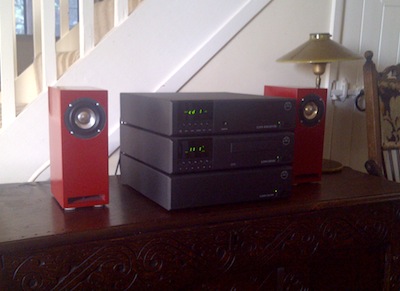

I will get a photo of them with the Big'un. In the meantime, here's a photo of the first MARTELLO (red) with the MARTELLO-2 and on the right there is my ALPAIR sub-woofer (an older thread on here somewhere).

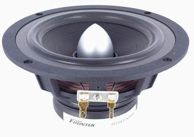

Hello, Yes Fountek has a larger fullrange driver. Its a 5 inch fullrange driver called the Fr135ex. I have never heard it. So if you buy it let me know if it's worth $102.85 each? Jm
It looks a rather nice driver to me but unfortunately I have not had a chance to hear it. With rare earth magnet, good size and construction, the price looks reasonable to me.
The FR plot looks quite reasonable - perhaps a slight concern around 8kHz where there could be a resonance going on. There's a recommended EQ filter to flatten the response here: http://www.madisound.com/pdf/FR135EX-Encl.pdf
I think I'd like to hear one of these in an ML-TL enclosure.

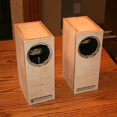

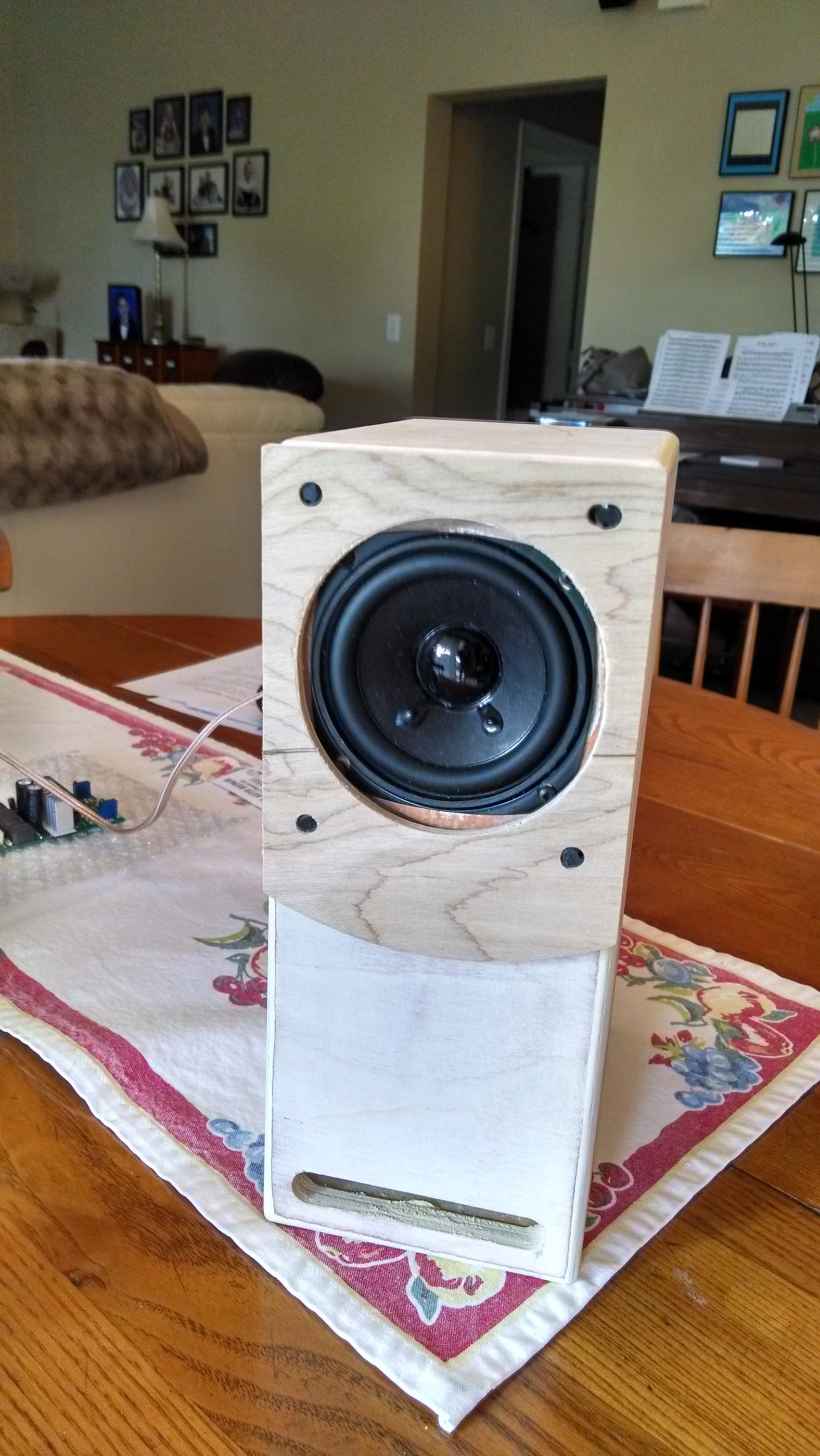

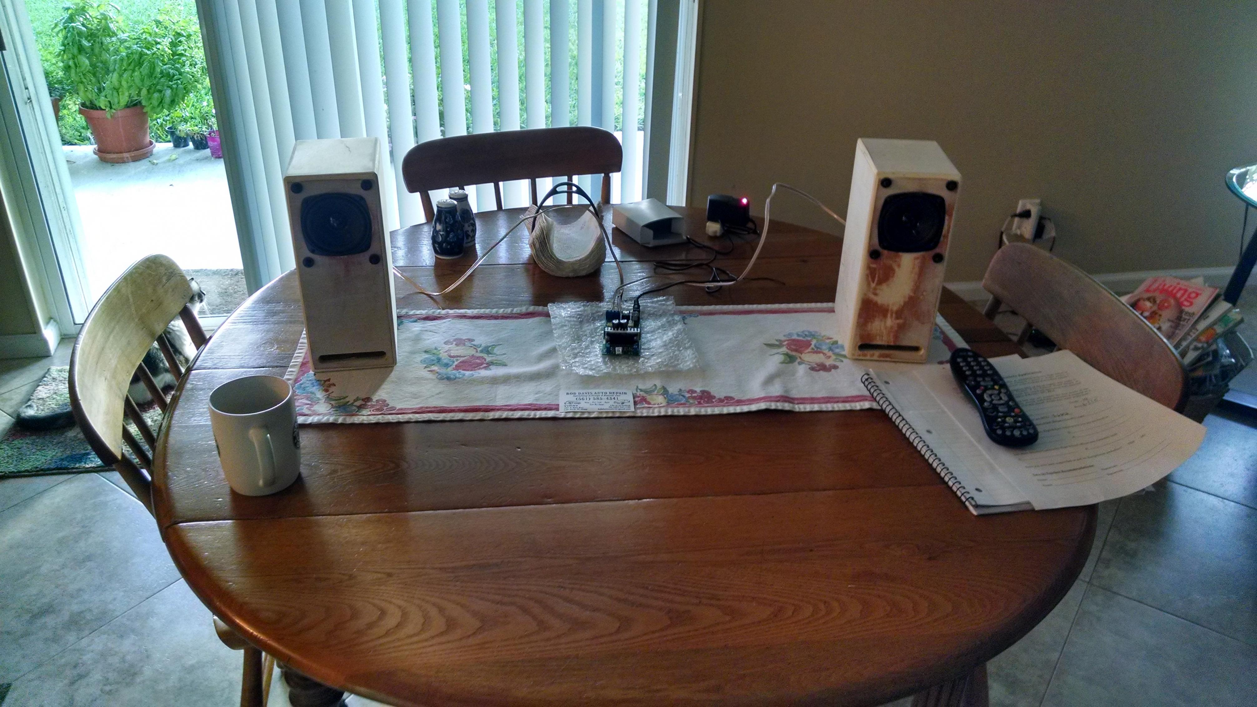

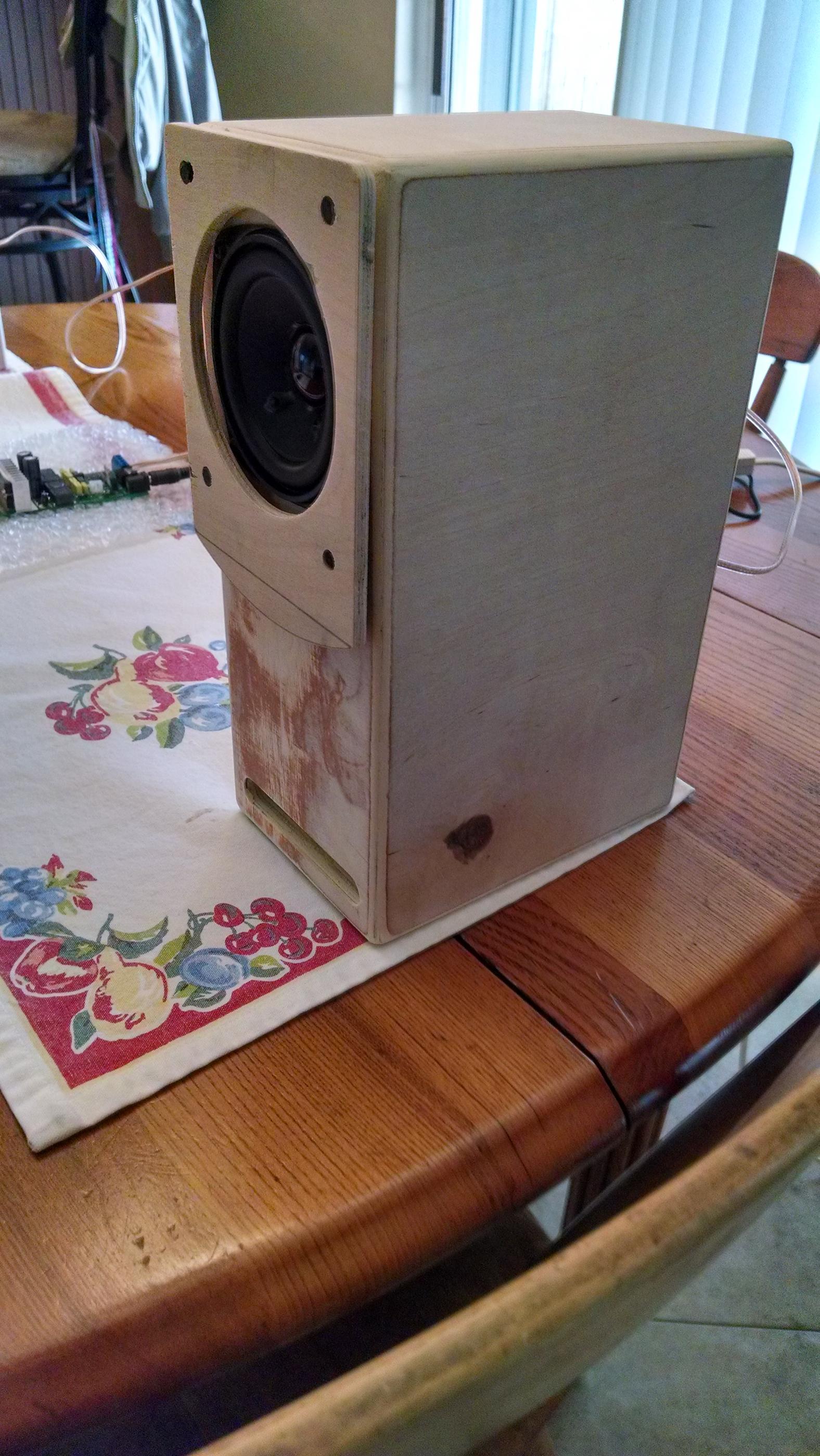

First DIY Speaker build Martello w FSR8s

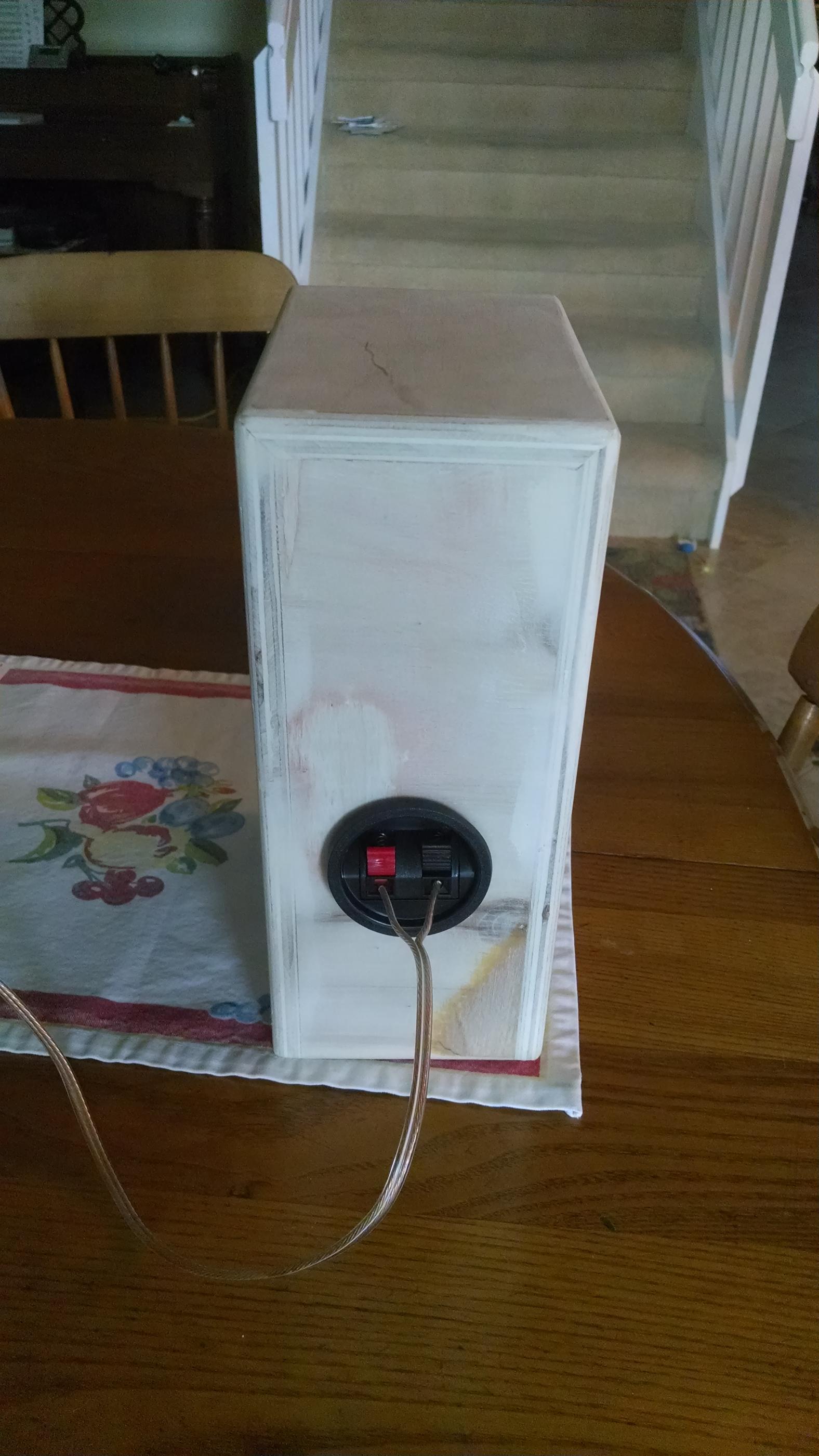

New to the forum, really enjoy reading all the posts. I had some small speakers hanging around and decided to try building the Martello v0.21 for my son who just moved into an apartment and has no stereo - new generation listens to everything from his phone. The amp is a Bluetooth TA2020. Haven't built the box for it yet. So, I didn't have the FR88EX drivers - only 3" were a pair of Visaton FRS-8 and a pair of TB WS-881SIs. Built up the cabinets with a few tweaks - used mitred cuts on the top and front. Still have to sand, paint and cover the speaker grills. They sound really nice to me. I used the FRS first since it seems the TB will need a NF. I also have a pair of Vifa TC7FD00-04 2.5 in drivers any suggestions for a cabinet for these?
Thanks,
Bob
