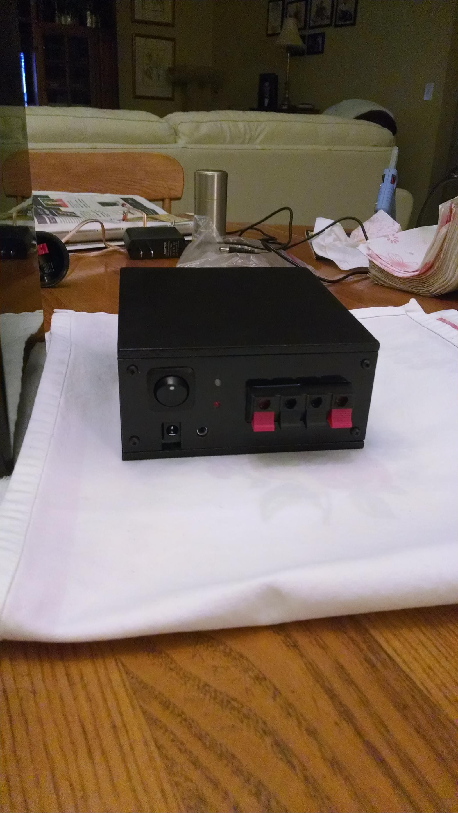

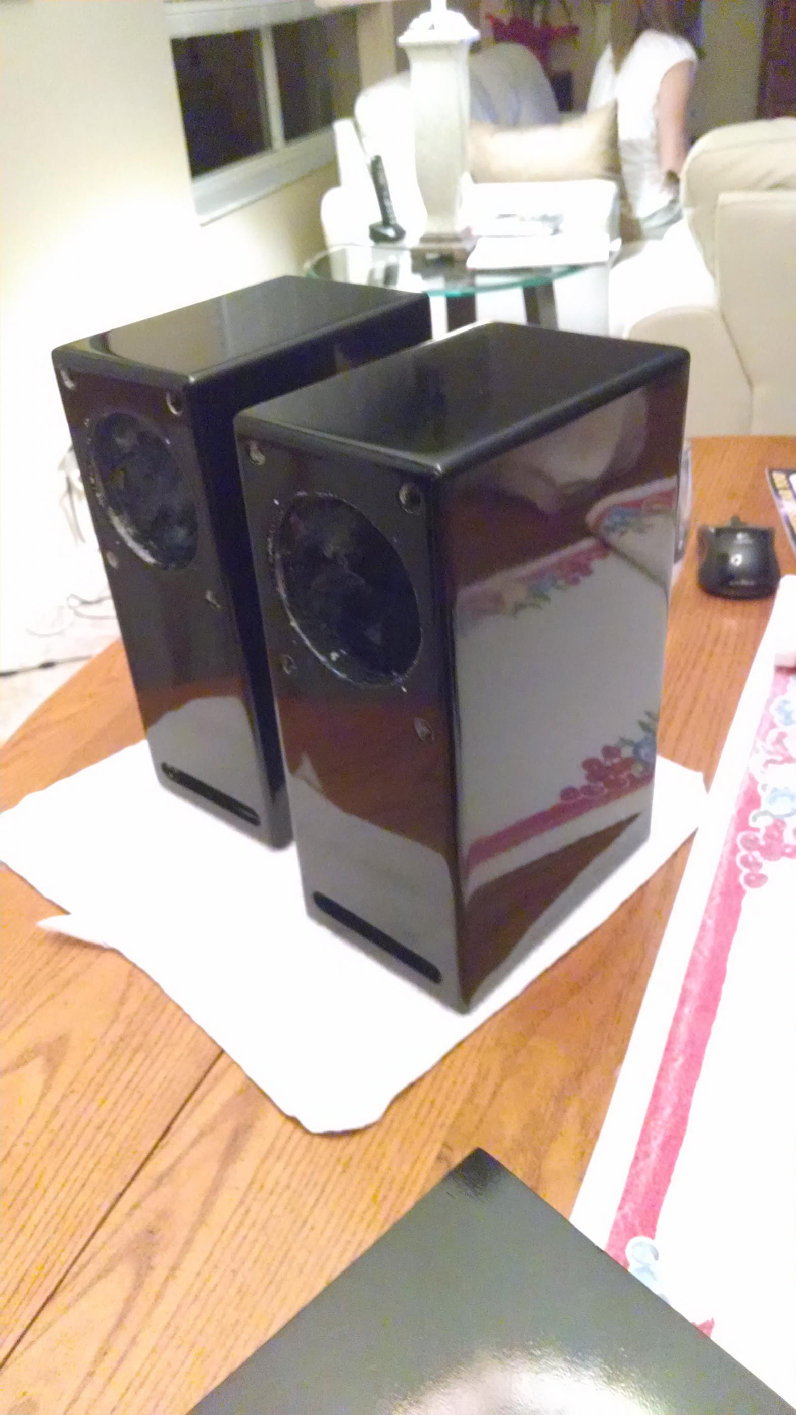

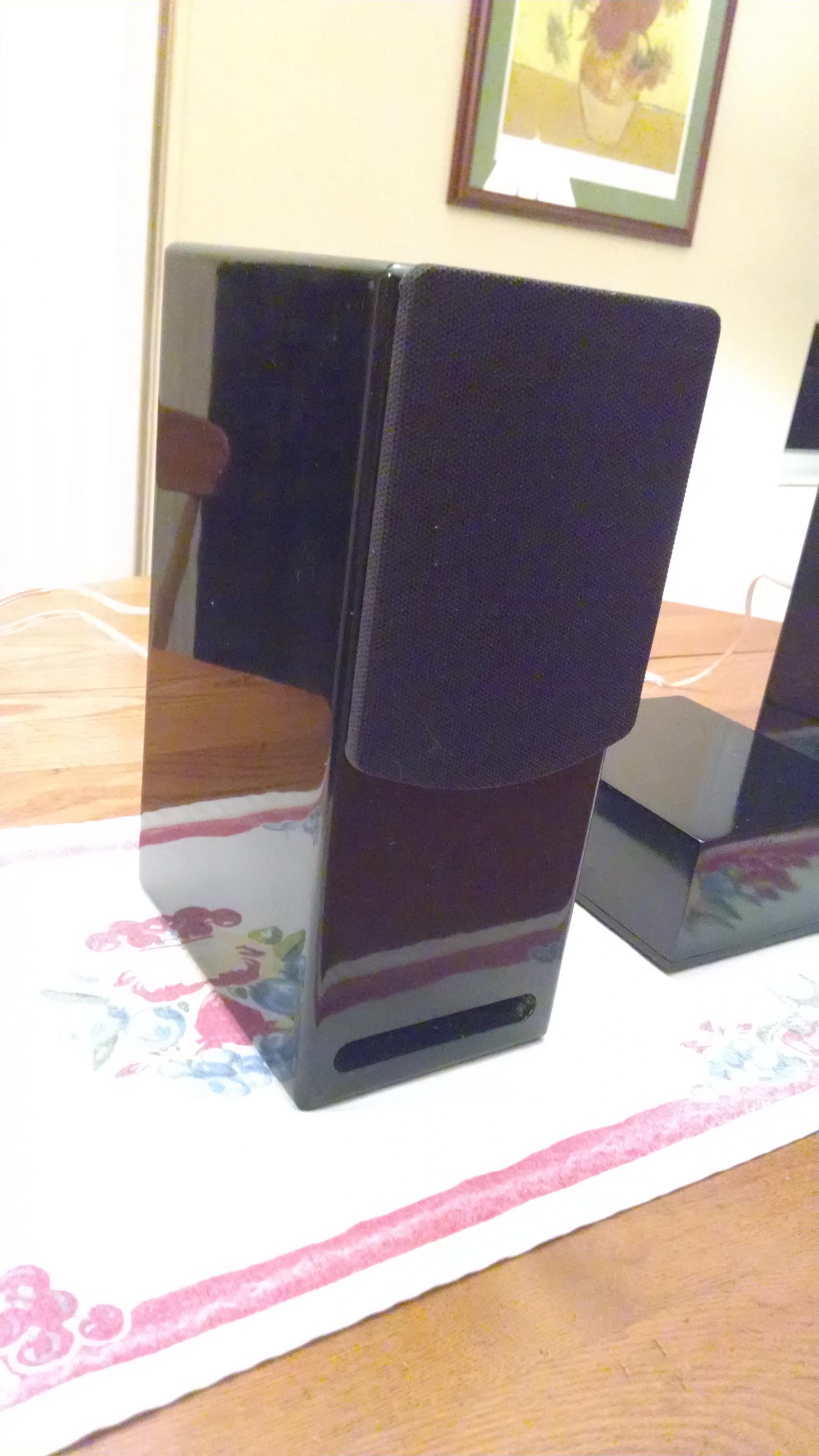

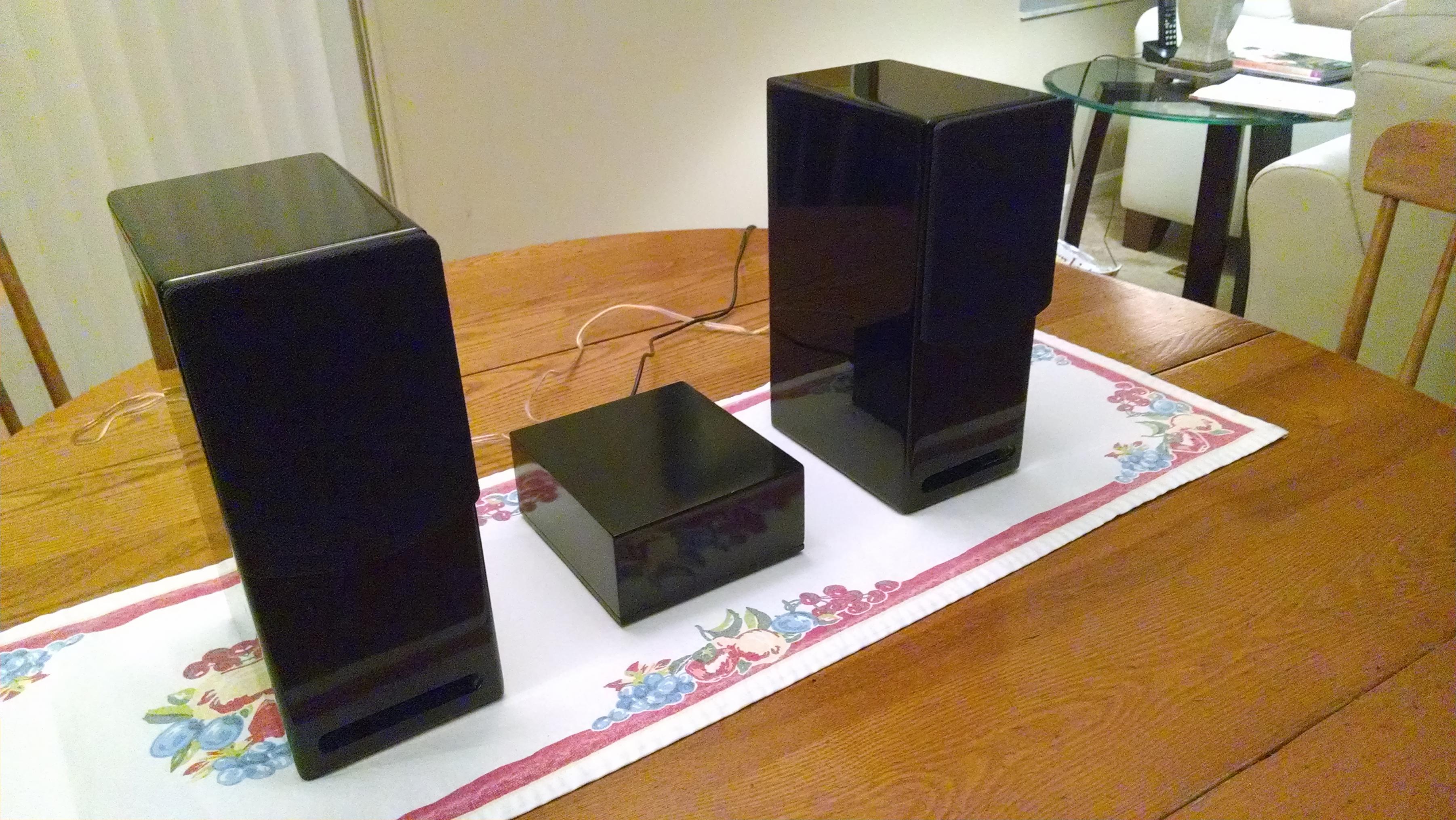

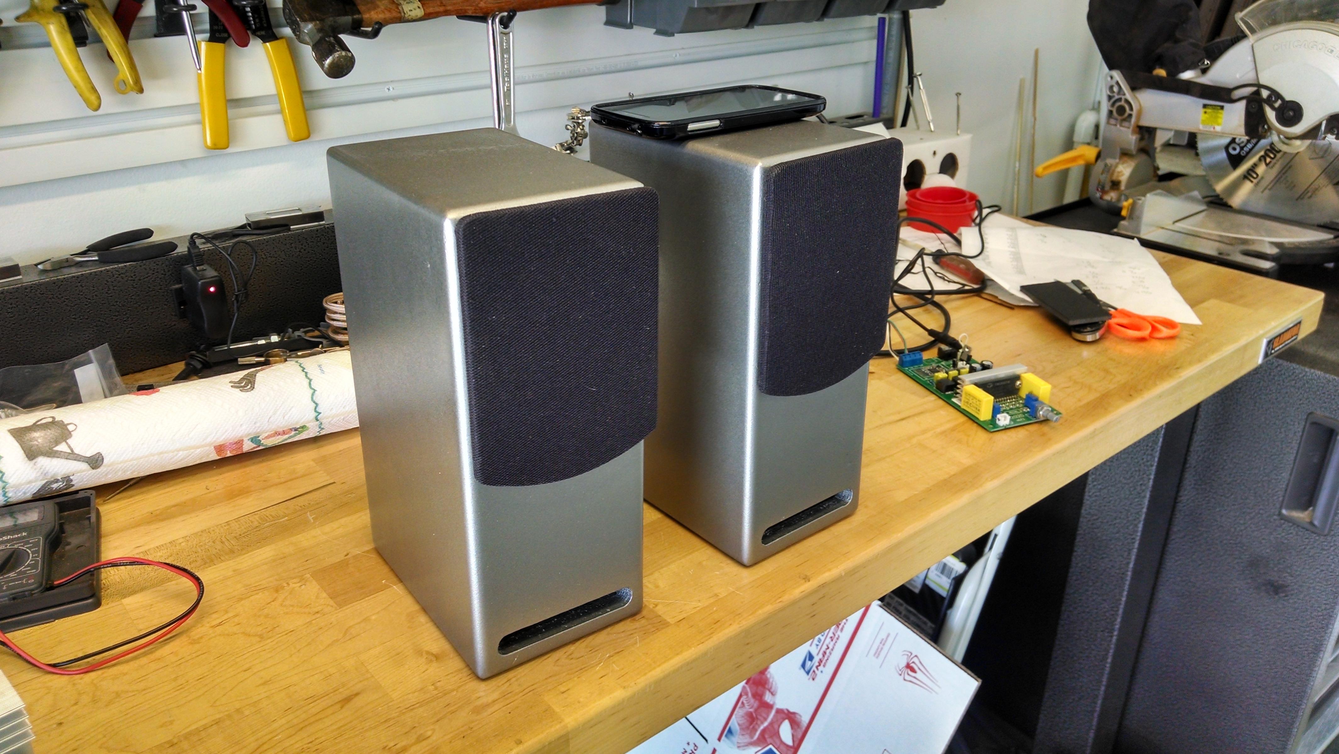

Finally got them finished. They sound pretty good to me. On to my next project.

Thanks. I put several coats of black spray paint then a few of clear gloss then wet sanded with 1200 - 2000 grit then car polish to shine them up. I was really struggling to get a good finish until I ran across the idea to wet sand from a YouTube video on spray painting auto body parts.

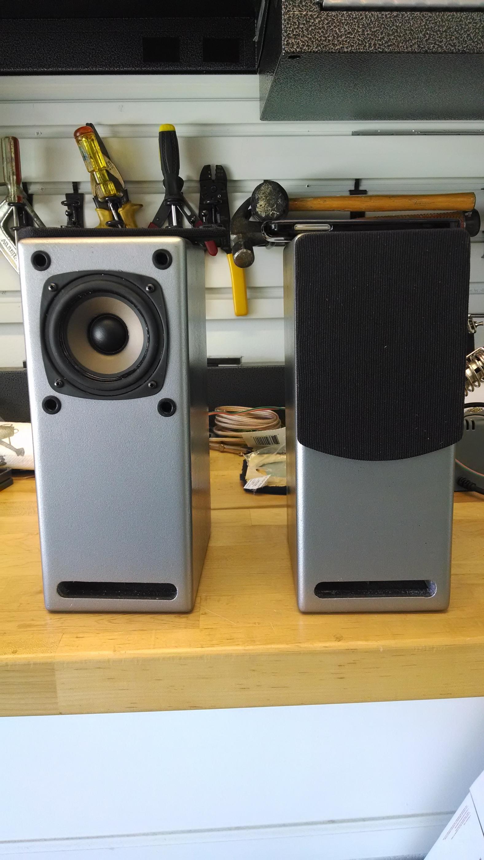

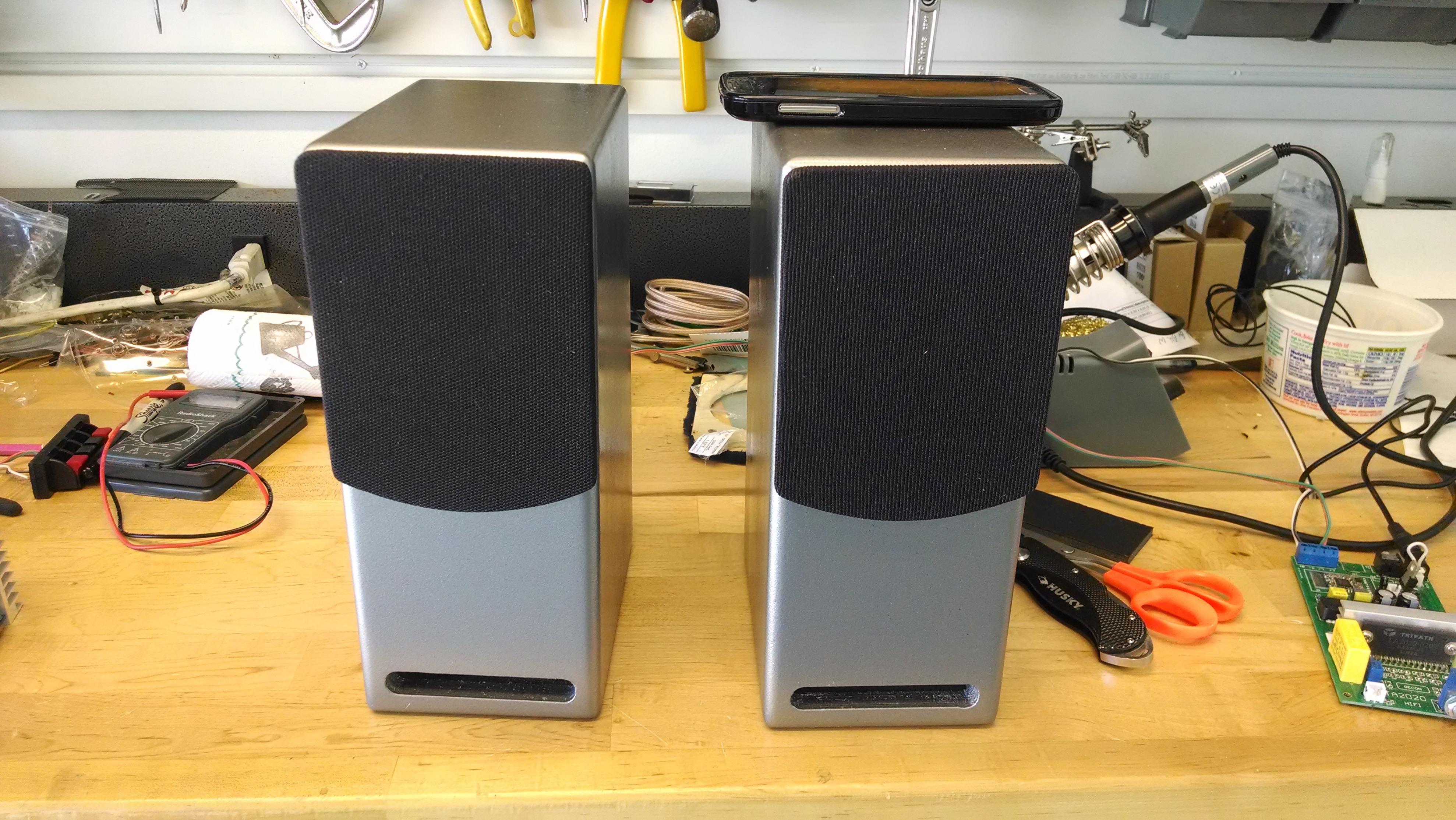

Made a second pair! Sound just as good as the first. I have the wood already cut for a third set from the original 4x8 sheet of plywood - no fourth set as the first attempts at cutting weren't quite right!:eek:. This diy speaker stuff can become a bit addictive!
