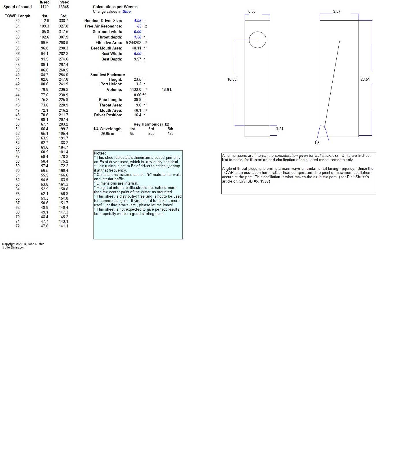

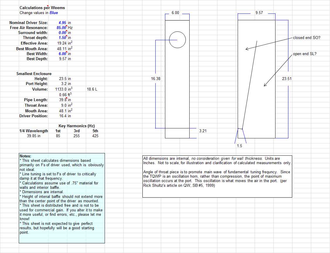

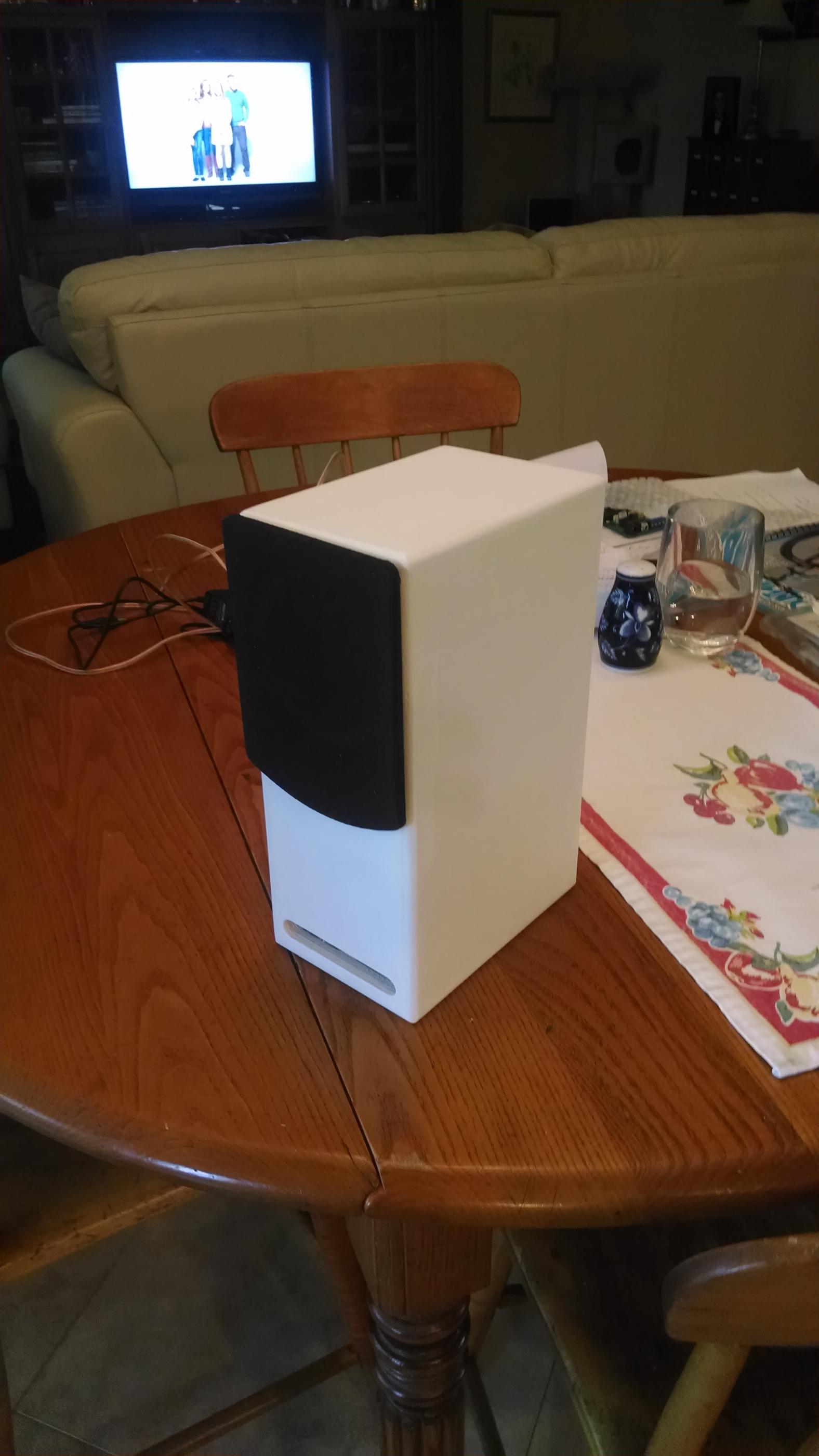

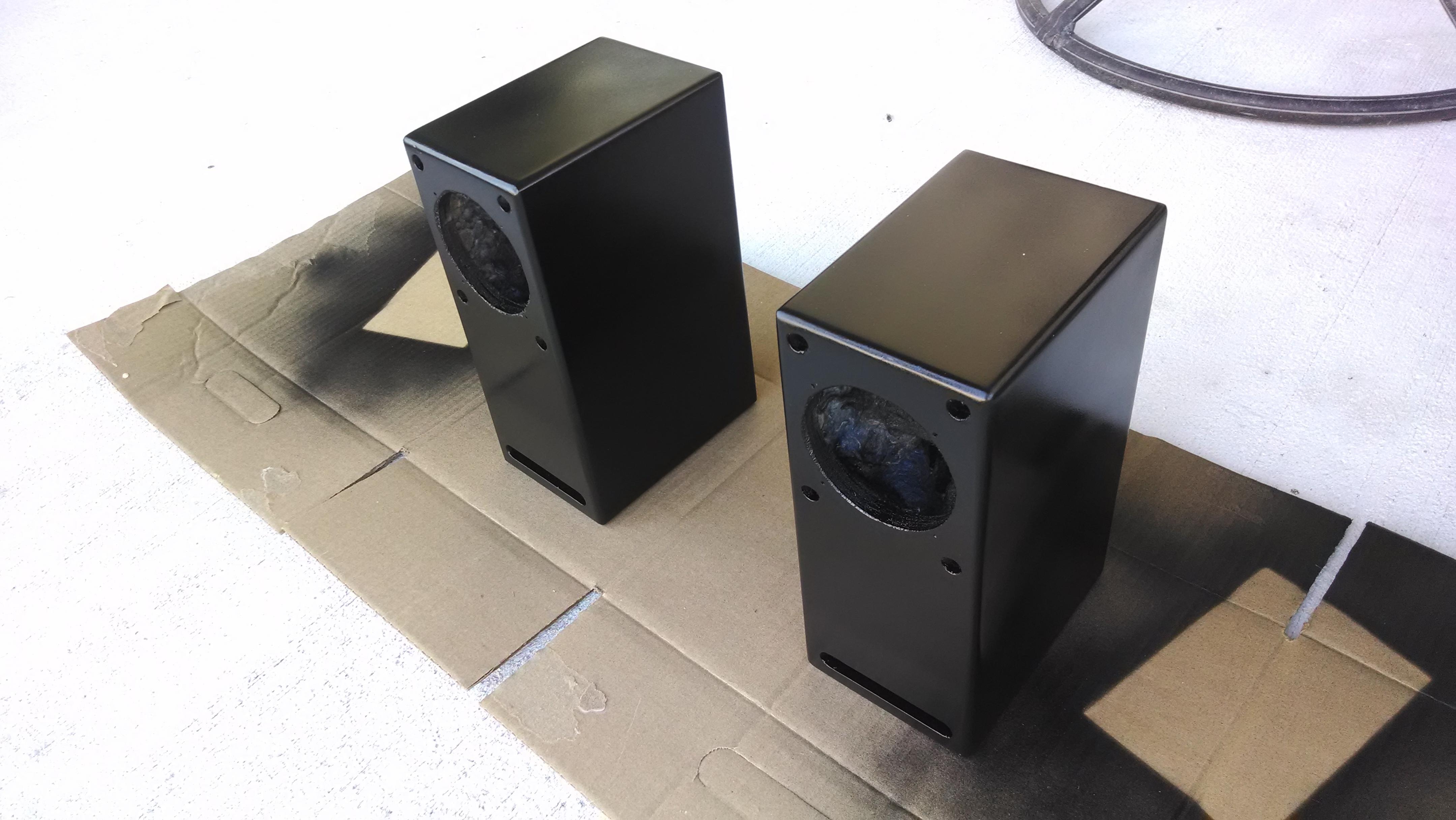

Thanks for the reply. Here are a few more pictures. I have (4) Hiwave 3.5 inch drivers and was planning to put them 2 per speaker in a needle style enclosure based on the 3rd image. The excel sheet only looks at 1 driver so I had to calculate the area of two drivers and covert it to an equivalent area for a single driver. What do you think of this concept?

I love the finishing you've done of the Martello's. I may have to contract my next build to you 😀
I can't comment too much on the two-driver idea as I have little experience - I use only single drivers. But I think your approach of doubling the size for equivalent area sounds good and you will have to treat the 'combined' driver as having double the VAS too.
The white is the primer. I copied malibujeff on the grills. Once I decided to paint them, the whole idea of the mitres seemed a waste. As far as the Vas is concerned, I not sure how the needle design takes that into account, it more or less seems to base things on the lowest frequency you want the enclosure tuned to and sets the dimensions to create a pipe of 1/4 the length of that frequency. It might take it into account somewhere in the calculations based on the area of the driver cone??
If you double up drivers, double the volume of the enclosure (keep length the same) and double the csa of the vents (use two) keep the vent length the same. The frequency response should be the same in the bass but +6dB boost (for parallel wired load at 2.83volts). Mount one front facing and one rear facing for a bipole and you get rid of baffle step losses.

Thanks for your input. I am basing the enclosure sizing on the calculations from the excel sheet here:
Single Driver Website
It asks for the speaker diameter then calculates an area for the speaker and uses this area to determine the box volume as far as I can determine. Then it uses the tuning frequency to set the length of the pipe. The combination of these gives you the overall dimensions of the enclosure. If I were to use these as front speakers in a surround environment and the main speakers for audio listening, would the bipole arrangement be better than having both drivers front facing? What is a baffle stop loss? Sorry for the newb questions. Thanks for your help.

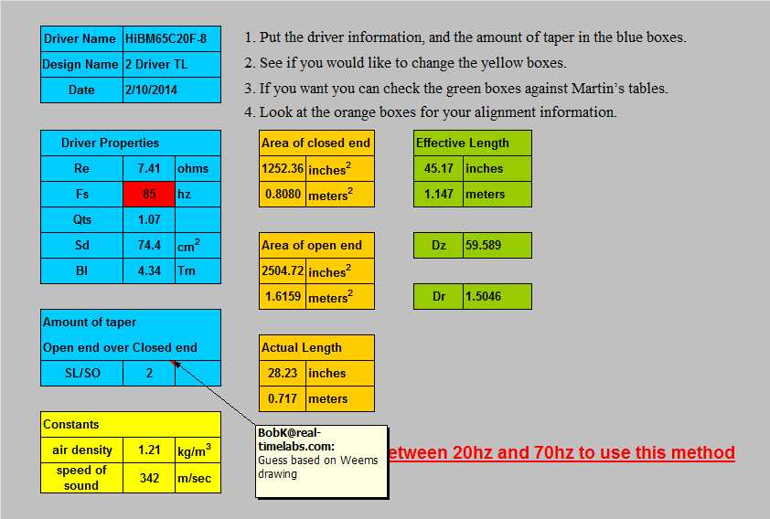

Bob,
That is the classic TL design methodology... next to useless, and completely obselete since Martin King and Gearoge Augspurger developed proper TL models.
Go to Quarter Wavelength Loudspeaker Design and download his tables to get a much better approximation.
dave

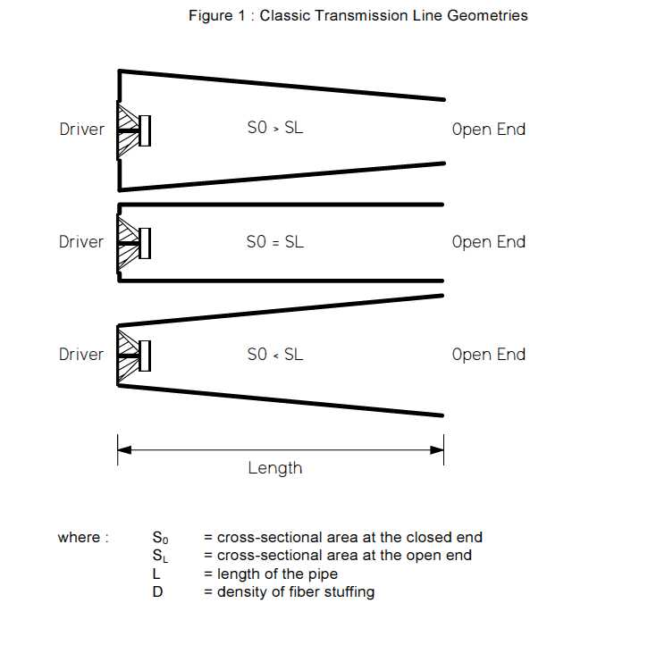

Thanks for the advice. So I tried the tables at 1/4wave. See output and also the weems calcs. I am not sure how to interpret the 1/4wave data as far as calculating enclosure volume/dimensions and comparing to the weems data. I assumed the weems sl/so is ~2:1 based on the picture to use in the 1/4wave table- don't know if this is an accurate assumption.

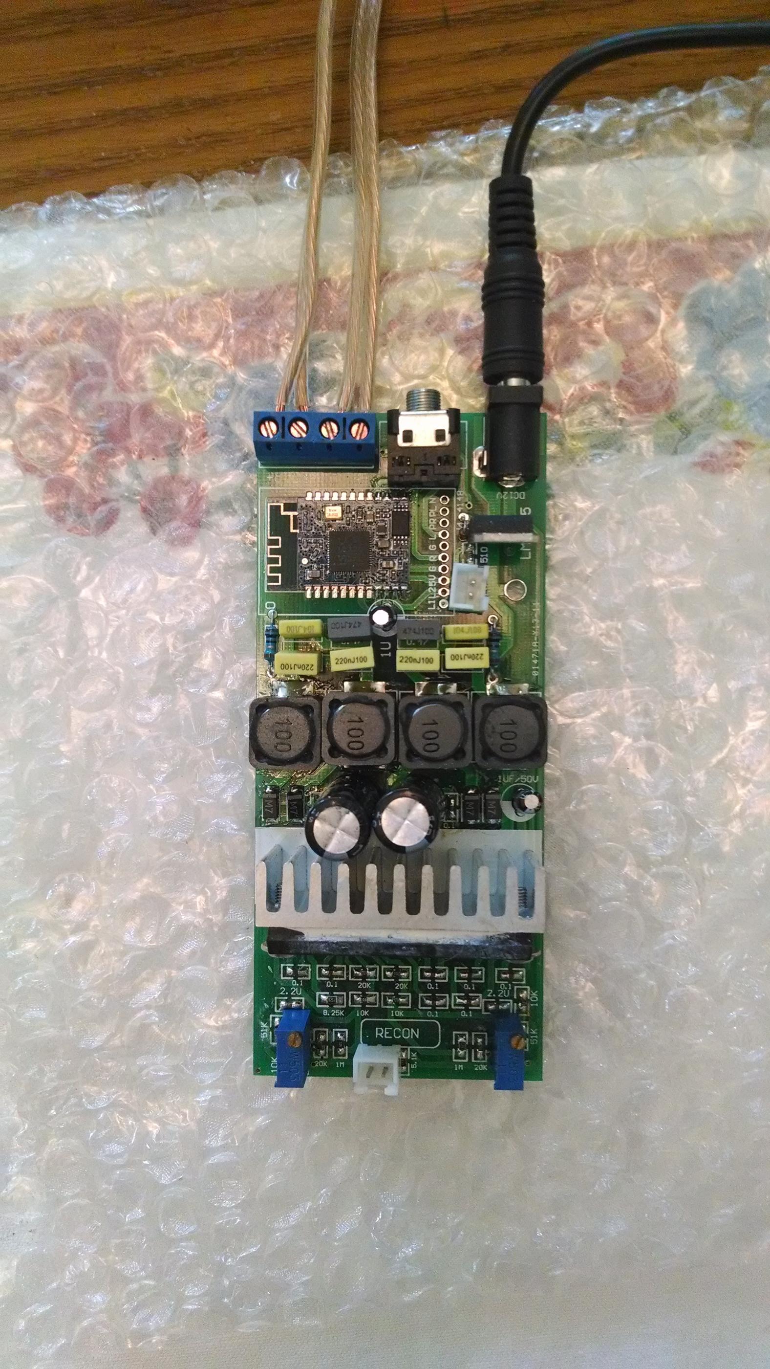

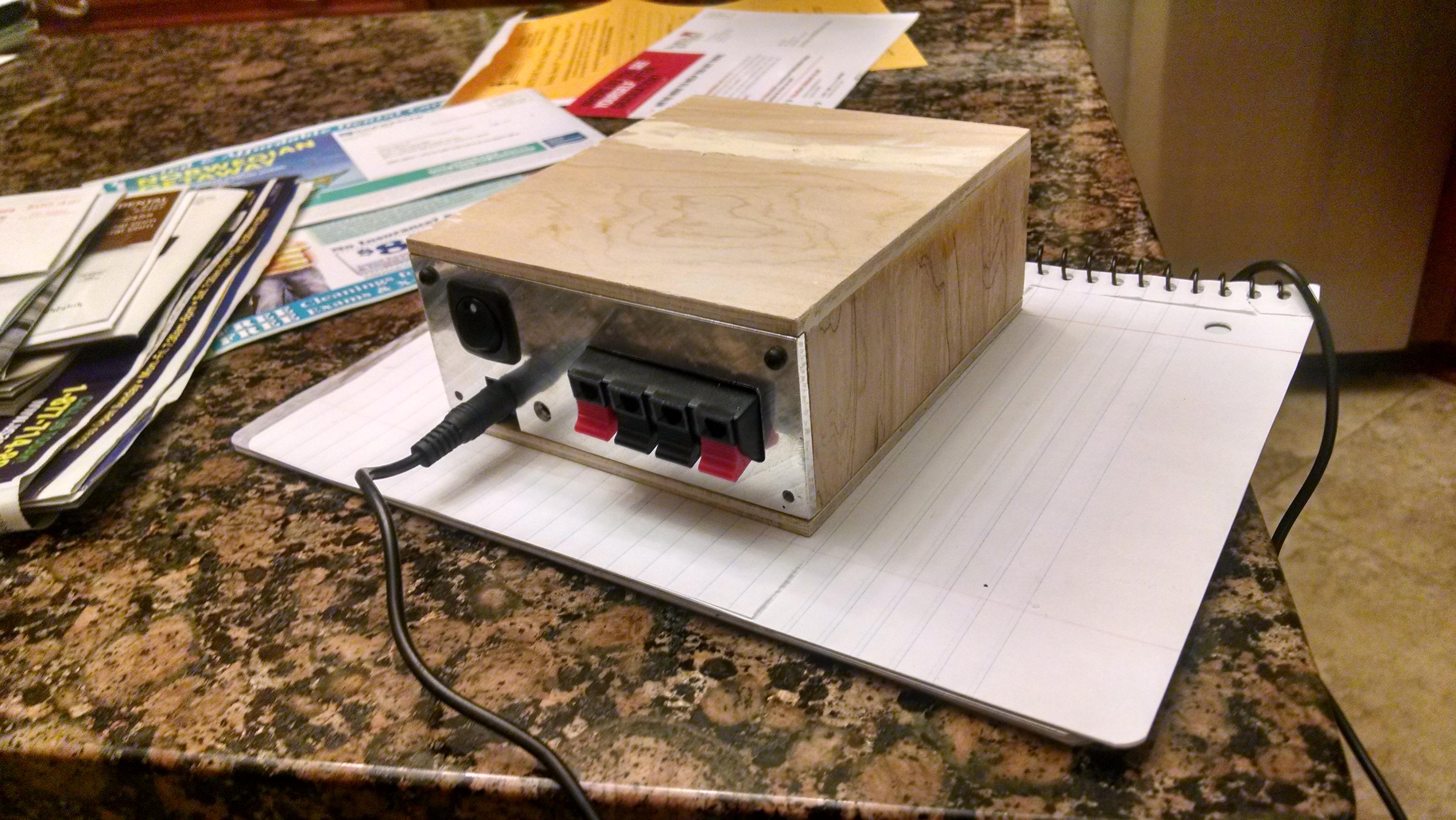

I thought I would try to build a TL type speaker as my second diy attempt. I have several drivers (2) TB881s (3"), (4) HIBM65C20F-8s (3.5"), (2) FRS7 (2.5") and thought I would try to use the 4 larger drivers in a TL to replace my 35 yr old infinity Bookshelf speakers used in my Stereo/HT setup. I had been looking at the polk audio towers such as such as TSx330 or similar when i ran across the diy concept. Since I already have the drivers, I thought I would give it a go. My HT setup has Polk audio center & satellites, Infinity L/R and 2 10" subs. I have started to explore the AMLTL techniques you recommend and have d/l the winisd and a few other programs so will be looking at this over the weekend. the photos are the Bluetooth amp and enclosure which will drive my martellos.

Good luck on your AMLTL build! That amp with integrated BT looks very nice - where do you get those? Do you have a link? I have had to connect separate BT modules and class D amps and they have ground loop noise unless isolated DC to DC converter is used.
I got the amp boards from:
http://www.digitalaudioamp.com/product/bluetoothaudioamplifier.html
They sold them to me as samples. They were pricey ~$75.00 delivered from China for 2. They have 2 models one is a bit bigger and has provision for an on/off switch built into the board and a volume control and one smaller without those features. I got one of each. I have seen where people have used a 7805 voltage regulator and tapped off the 12v supply for the amp to run the separate BT module with no Ground loop issues. I don't know but maybe the 7805 acts as an isolator of sorts??
