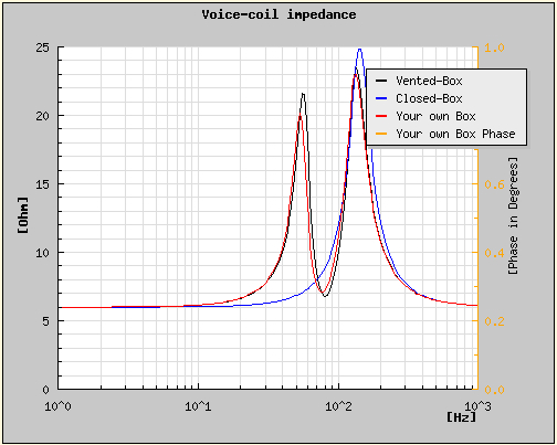

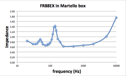

I thought I'd update this thread with some more data.

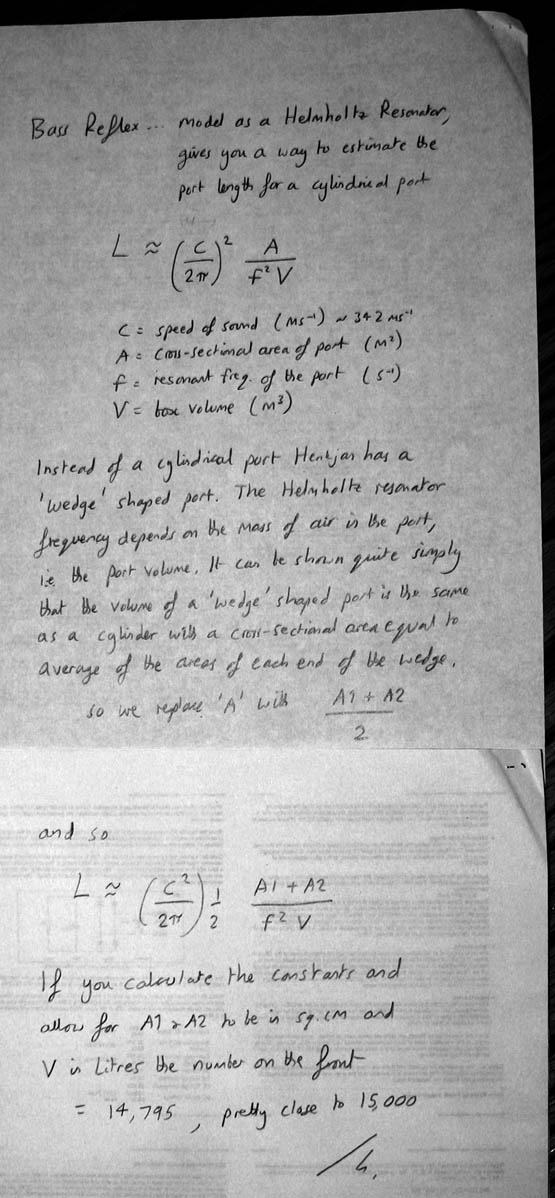

First image are the calculations I used for the horn-shaped slot port.
Second image shows the simulated impedance curves for a straight bass-reflex design. Note the two peaks, typical of a BR design the interaction of the driver and box, they are roughly the same height. The simulated resonance peaks are at 50Hz and 140Hz.
Third image shows the measured impedance curves. I used my DIY TGM3 amplifier (solid state) with a resistor in series with the ground wire and a DMM across it to measure the rms voltage and used this to calcite the current and along with the signal amplitude the impedance of the speaker. I used a sine wave generator signal source. The vertical axis is not calibrated in Ohms but it is linear. The measured resonance peaks are at 50Hz and 140Hz, matching the BR simulation. BUT note that the left hand peak is much smaller - a result of the damping provided by the Onken style ports.

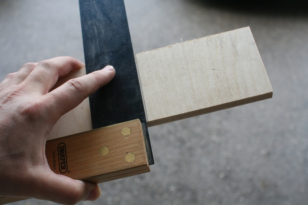

I decided to build another pair of these !
I took more pictures this time.

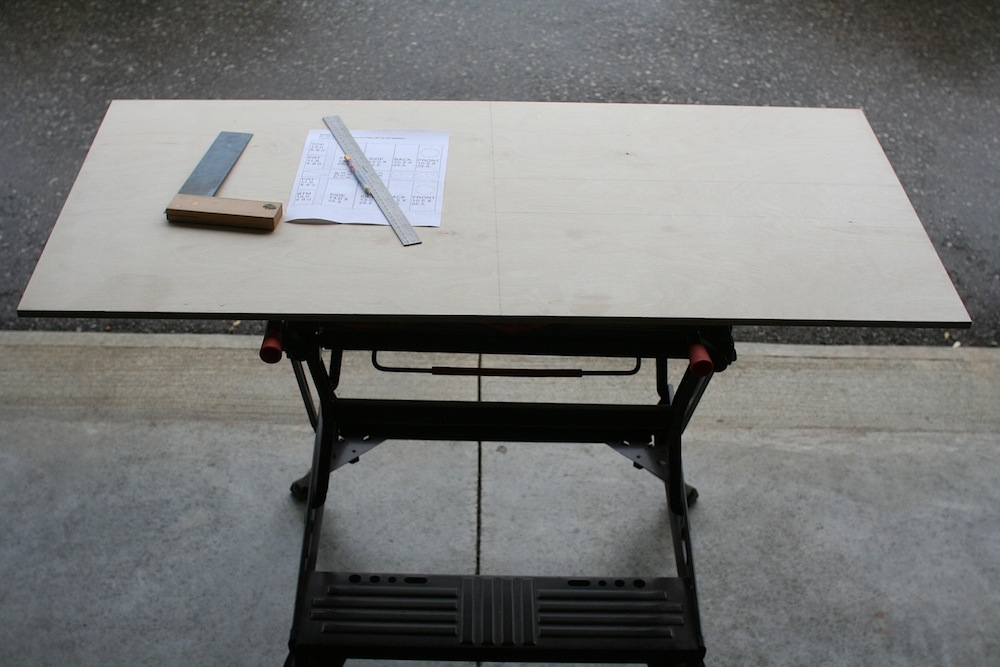

1 - Started off with new piece of 12mm Russian Birch plywood. Workbench at garage entrance (out of the rain)

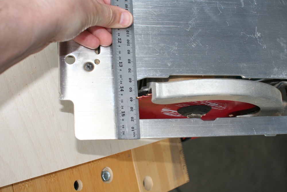

2 - I have no table saw, so the cutting will be with hand-held circular saw with a nice large-tooth high quality blade. First job to measure the blade offset so I know where to place a guide piece when cutting

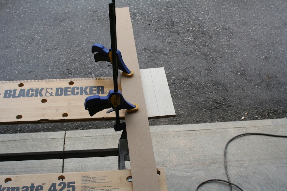

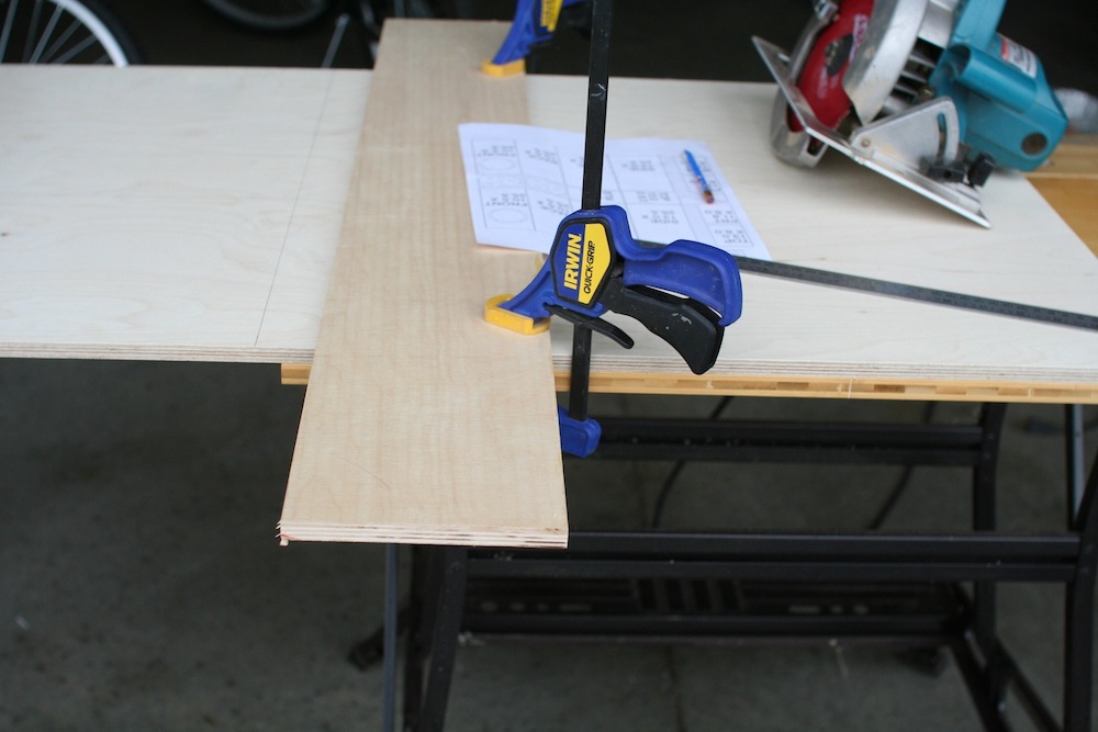

3 - I clamp a guide piece of scrap wood across the work piece to guide the base-plate of the saw. The clamps hold everything to the workbench.

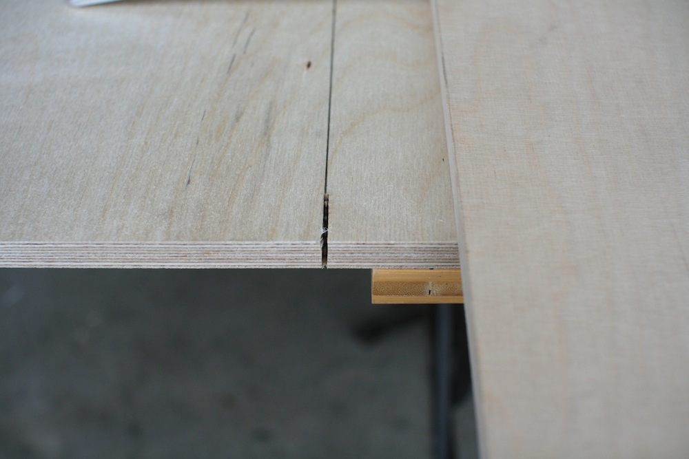

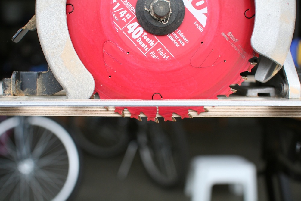

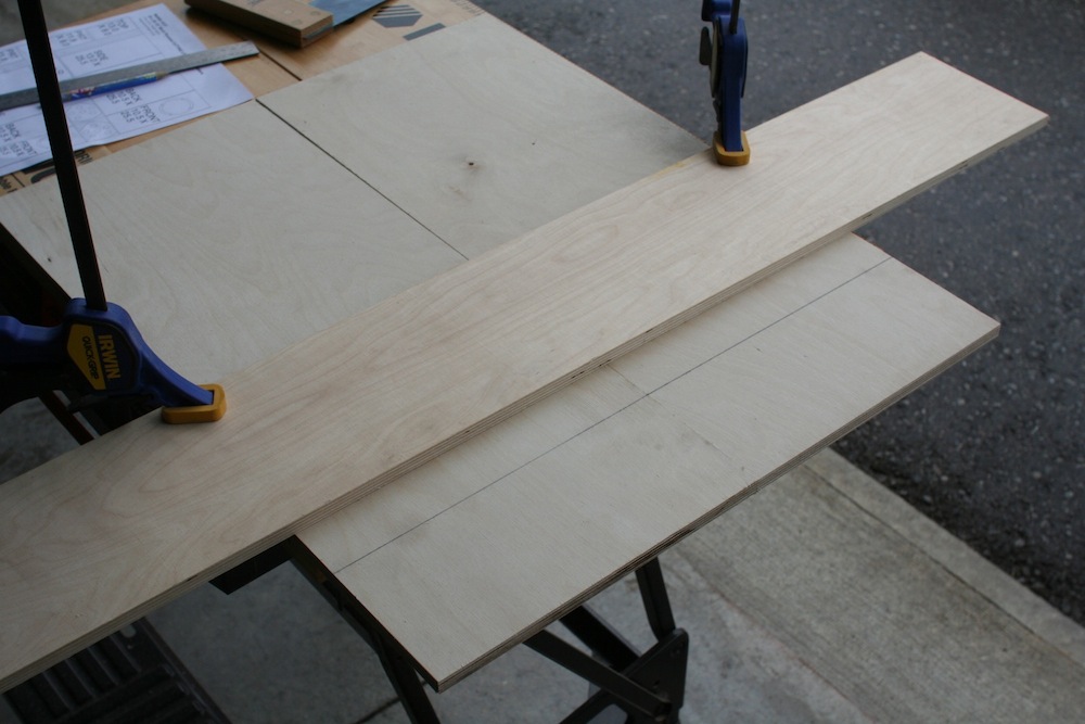

4 - then I set the blade depth so that it cuts nicely through the workpiece but no further.
5 - using the guide piece ensures the cut follows the right line which was measured to reduce the 2ft x 4ft starting sheet to a pair of 2ft x 2ft pieces. I need only one of these for a pair of Martello's

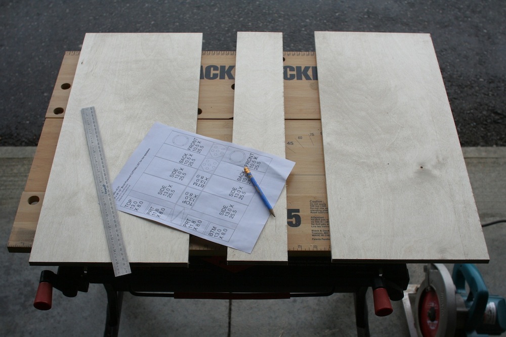

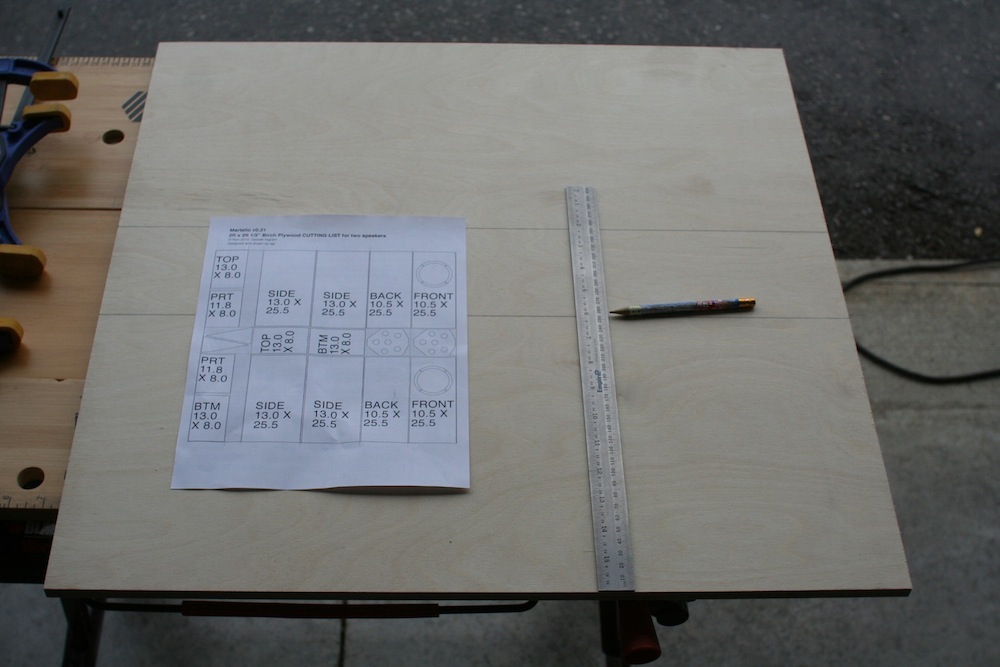

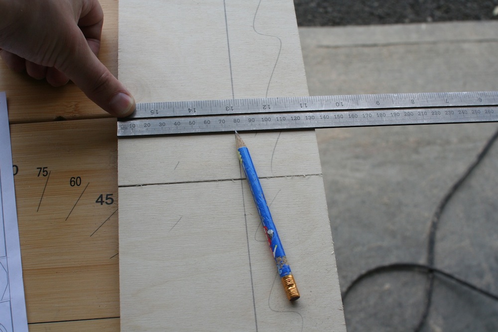

6 - next I mark up the 2ft x 2ft piece into three, following the drawing (posted earlier). the wide pieces are measured to a width of 25.5cm from each edge of the workpiece, leaving a centre strip that will be cut further.

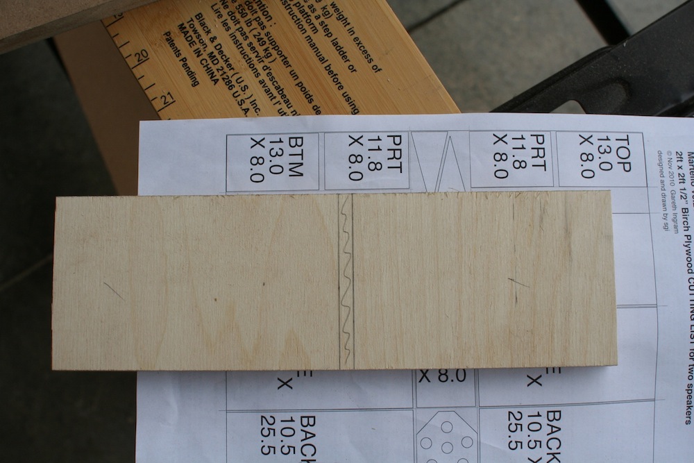

Joined 2009
10 - for the smaller pieces I remove the centre plank of the workbench to make clamping easier
11 - the small pieces get measured up
12 - this piece will provide a bottom piece and port piece, the shaded piece between them will be scrap

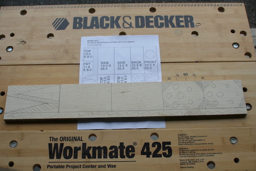

Joined 2009
13 - the small pieces are difficult to clamp with a guide piece, so these will be clamped and cut free-hand
14 - and the scrap piece is of uniform thickness so the free-hand cutting was pretty accurate
15 - next up is the centre piece from the initial 2ft x 2ft work piece. It's marked up for the port triangles, another top and bottom piece, and the braces

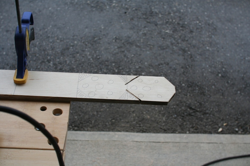

Joined 2009
16 - and the cutting begins

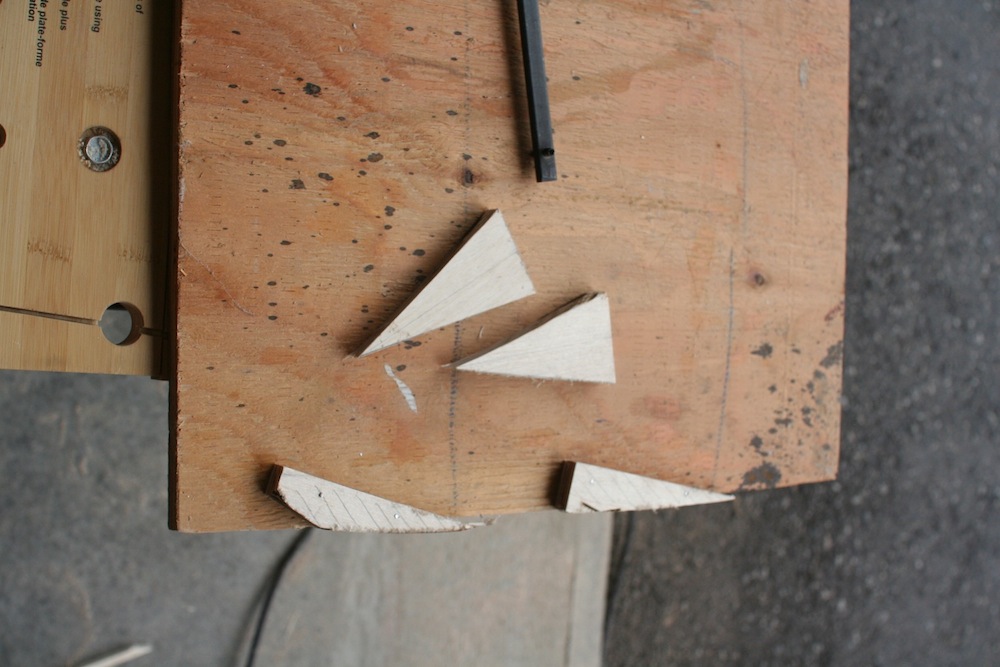

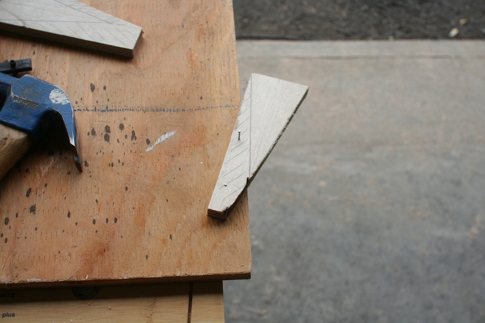

17 - the 'wasted' triangles from cutting the braces should be kept, they will make good reinforcement pieces that can be glued into inside corners of the boxes before they are closed
18 - the port triangles are hard to clamp for cutting when using a circular saw because the offset of the blade from the edge of the base of the saw is too large to allow room for the clamp. I nailed them to a piece of scrap wood instead.

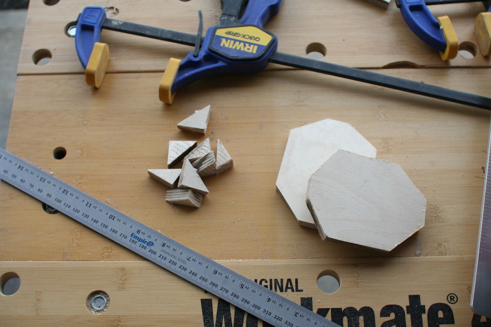

Joined 2009

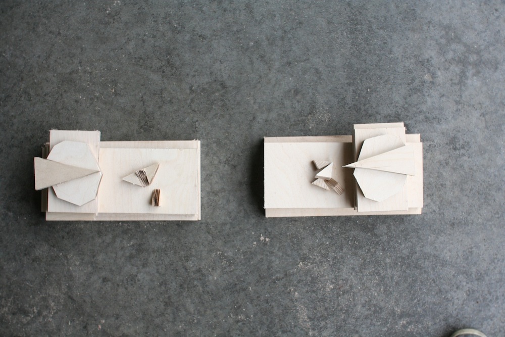

19 - the port triangles are now cut
20 - which completes the cutting ! phew !

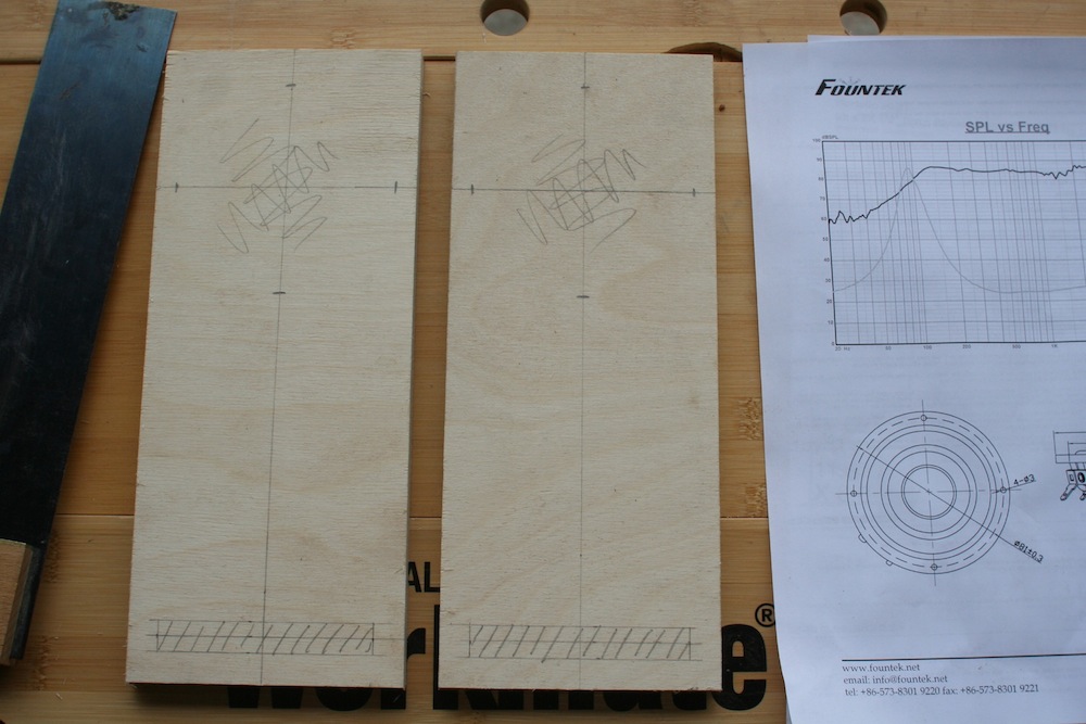

21 - next step is to mark up the front pieces for routing of the port slot and the driver opening

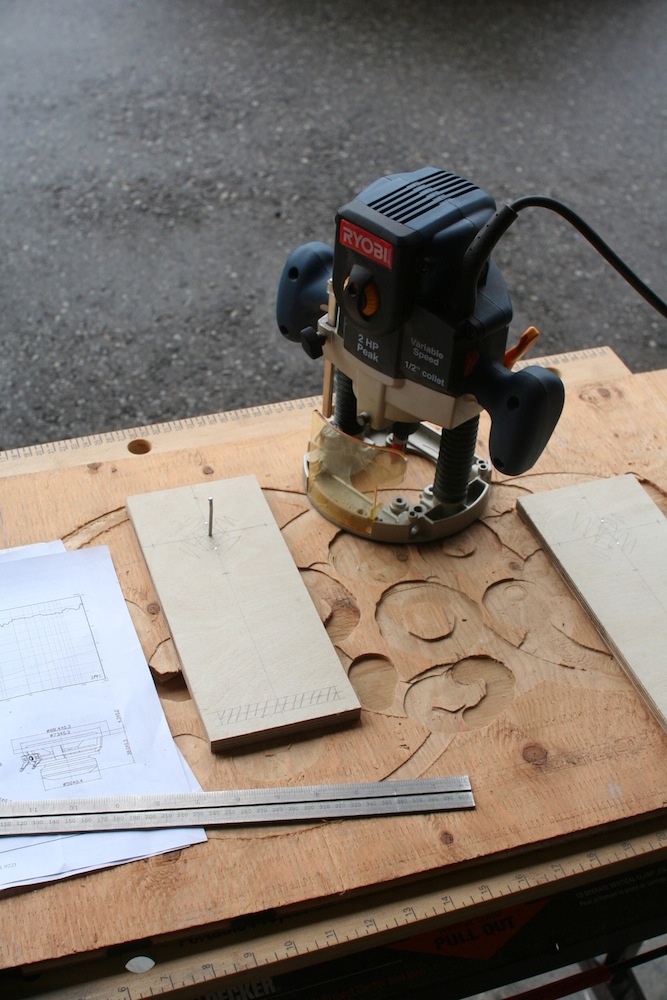

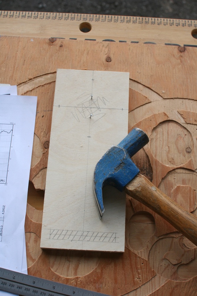

22 - again clamping is not possible as the router needs lots of free space to swing around. So I nailed the front piece to some scrap wood, nailing through where the driver opening will be as this will be material later removed.
23 - a large nail is placed at the centre of the speaker opening to act as a pivot point for the router

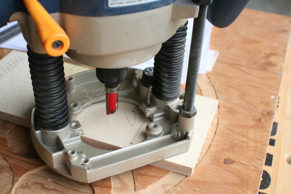

24 - conveniently my router has a hole in the base for the nail that positions the cutting piece just the right radius for the driver opening. Otherwise I would have screwed a think piece of material to the base of the router with a hole for the nail at the appropriate distance from the cutting piece. This is a high quality cutting piece.
