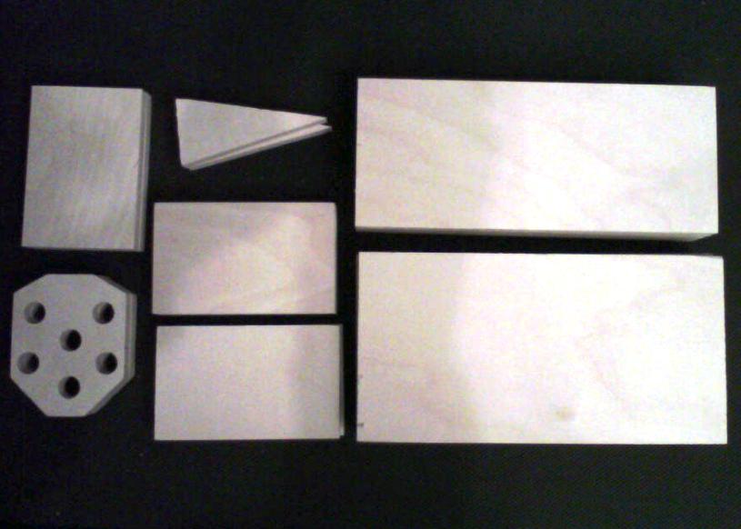

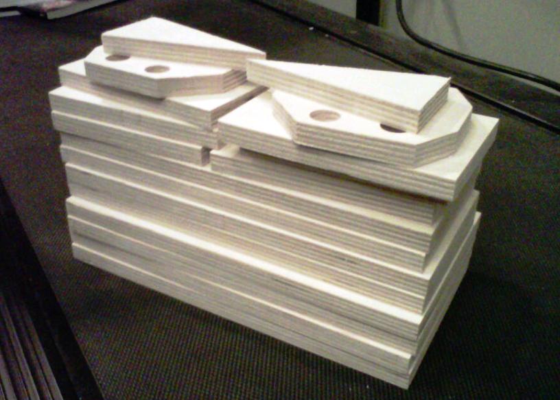

I have the drivers and I just got the wood from my local CNC shop.
Everything looks great. Now I just need to start spreading the glue.
Here are some pictures:

Looks good!
I suggest you dry fit all the parts to ensure they're all sized properly. The holey brace is one to be careful with - the chances that it's just the right size to butt up against the back of the drivers when they are screwed in (and using a gasket) is low - you will likely want to ajust it. I preferred to undersize the brace a little so there was a gap between it and the driver magnet and then use some padding to fill the gap and provide a tight fit up to the back of the driver.
Also be careful with cut outs for the driver, you need to shape it to allow the driver to fit through with the connecting lugs - which stick out a fair bit. But don't oversize the opening or you won't get an air-tight seal once the driver is installed. Dry fit the drivers and shape things by hand is how I would do it as I'm likely to mess it up easily !
