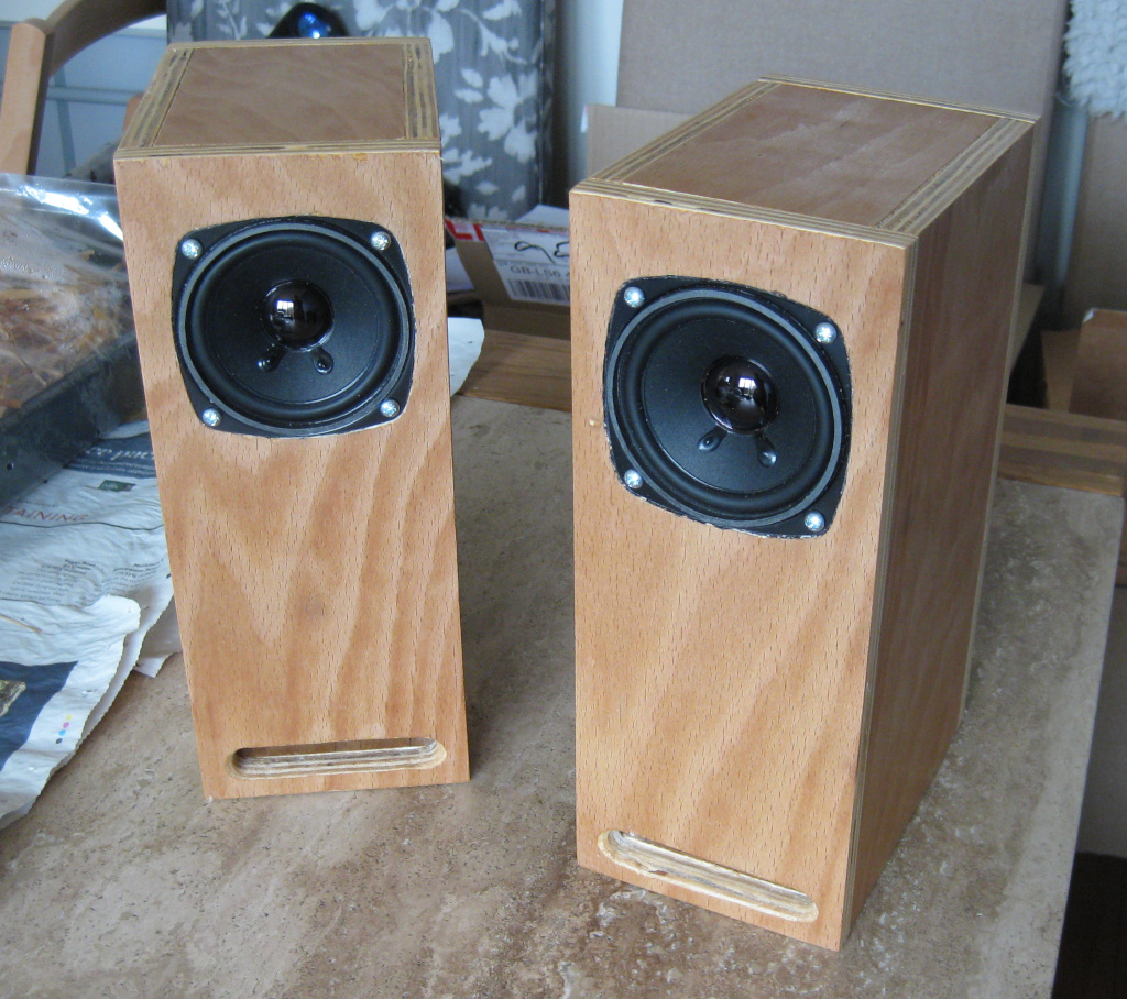

Nobody built any Martellos for a year then? 😛 I just built a pair with some Visaton FRS-8M's in them, because that is what I could get hold of (that were not silly money). These are very near-field on my desk (I can reach out and touch them), so I was not too bothered about the chances of exceeding xmax etc. - they are never going to be turned up that loud.
So far they are working for me - they are an upgrade on my desk from some very old Yamaha YST-M7's. First I need to let my ears adjust to the change, but initial impressions are the midrange is good, and soundstage and detail is very nice. Obviously bass is not their strong point, but there is enough for casual listening at my desk. Top end might be a bit 'splashy', but then my old ears probably don't hear that high any more either...
Mounting the FRS8-M's was a pain in the fingers - the edges of the mount are so thin (so little overhang) that it is pretty hard to ensure there is an airtight seal. I mounted them from the front. Next time I might have tried mounting from the back. Either way I think it's going to be tricky.
Kudos for the plans. This is my first speaker build for, cough, ooh, 35 years or so...
Obligatory picture then. Not the best plywood - I found a nasty void just where I was mounting one of the drivers that I had to then fill. But, it's what I had to hand. Simple finish with Danish oil followed by wax.
