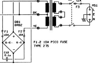

i think i got it. the two funky fuse holders are there as a substitute for F1 and F2 which should be 10A pico fuses. if your soldering skills are up to it i would remove those.
leave the transistors out of the amp we'll revisit that, as you've got a working DBT we can now do a no load tests of the transformer to see if it's functional.
Got it. And yes, I can unsolder those. I think I arrived at that conclusion before when I started this thread. Once I see the solder joints I'll know if I did it and forgot that I did it.

I do have the pico fuses and the rectron BR106 now and the actual power switch is installed.

ok there's three leads to the transformer secondary two are yellow the third is black with a yellow stripe (flag or make a note of their locations on the PCB and remove them)
with no power applied and your ohm meter set for low ohm scale take a reading across the two yellows the exact value isn't important at this point it's whether or not there's continuity in the secondary winding. as a second test check each of the yellows with respect to the black stripped lead your ohms reading on each should be half the value in ohms compared to the full winding i,e, across the two yellows. this form of test can also be used to see if the primary winding is ok (it will read higher and don't forget the power switch state.)

ok..the transformer results. Black wire-black lead on tester, red lead on yellow wire #1, ohm meter set to 200=1.1 it then drops and stabilizes at .9. Same thing happens when I hook the red lead from tester to yellow wire #2. When I put the leads on both yellow wires only= 1.1 after about 10 seconds it dropped to 1.0 and stayed there. Judging from your instructions, this isn't good, right?
Opps, I over looked something. You mention the power switch state. It is installed, but not wired in and I disconnected the brown and blue wires that I had wire nutted together as to ready them for connection to the switch, so I'll just do another reading with those connected as the on position reading. BRB Wait. let me clarify something. Now what difference will it make in regards to the power switch if it is not plugged into the wall? on or off position with no power would have the same results, wouldn't it? So am I supposed to plug it into the wall and then take a reading?
