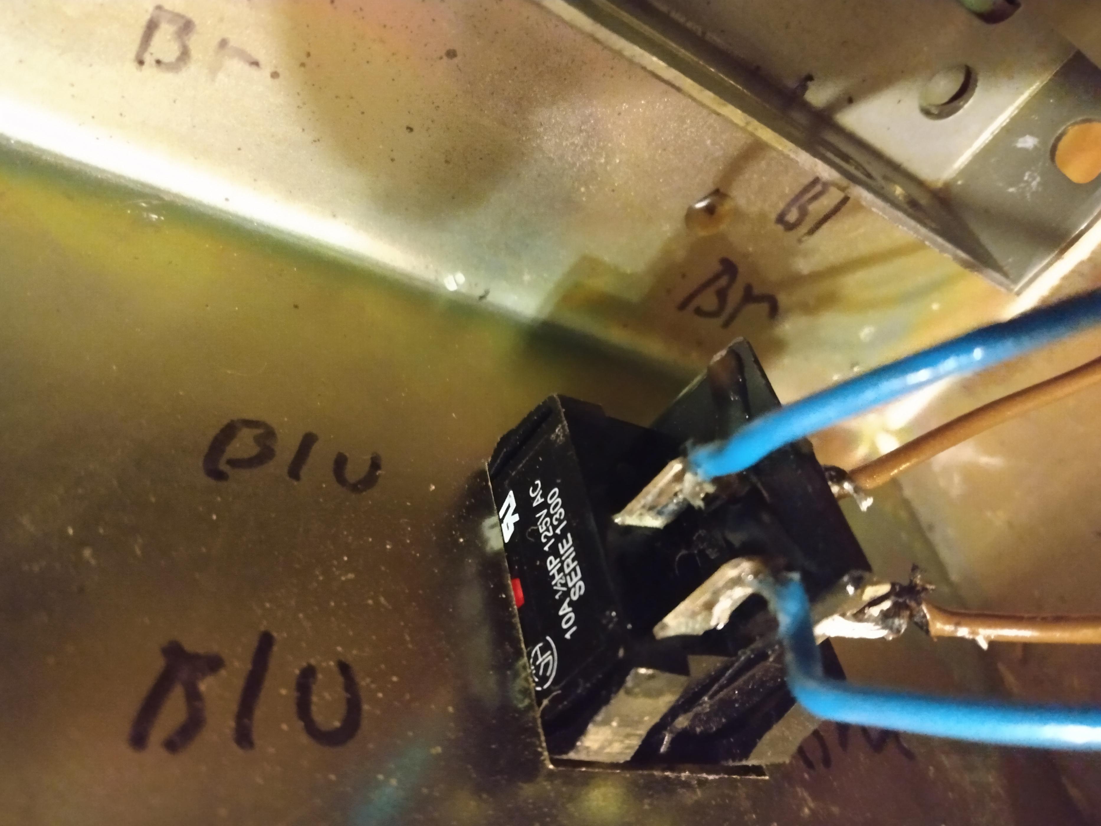

i think i figured it out. I connected the leads from the meter to the input wires (blue, brown) and got a 2.0 reading, double the value of the secondary output wires. Is that what we were looking for? And I did do a reading on the secondary right before I did the primary and they both settled at 1.0.

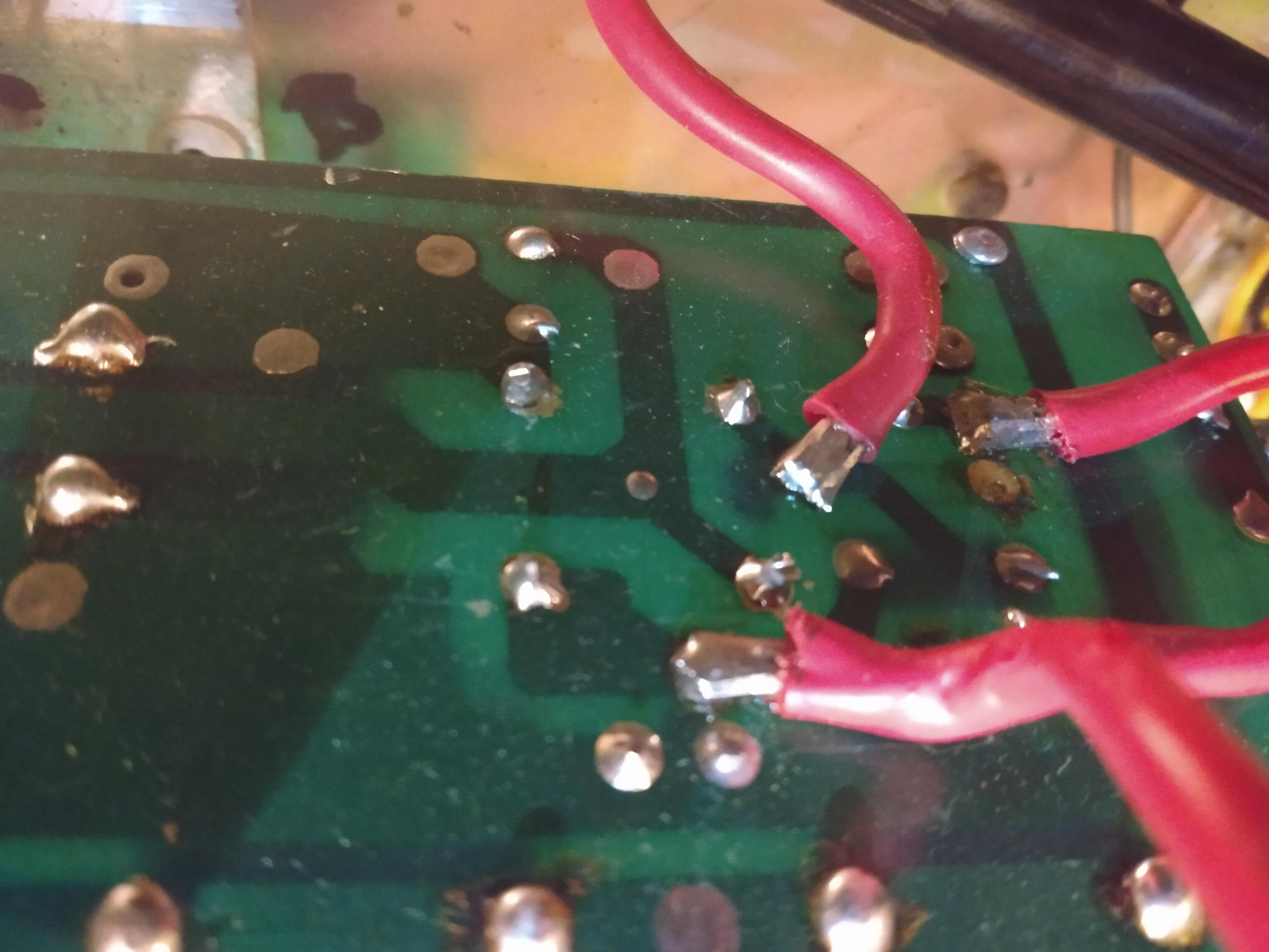

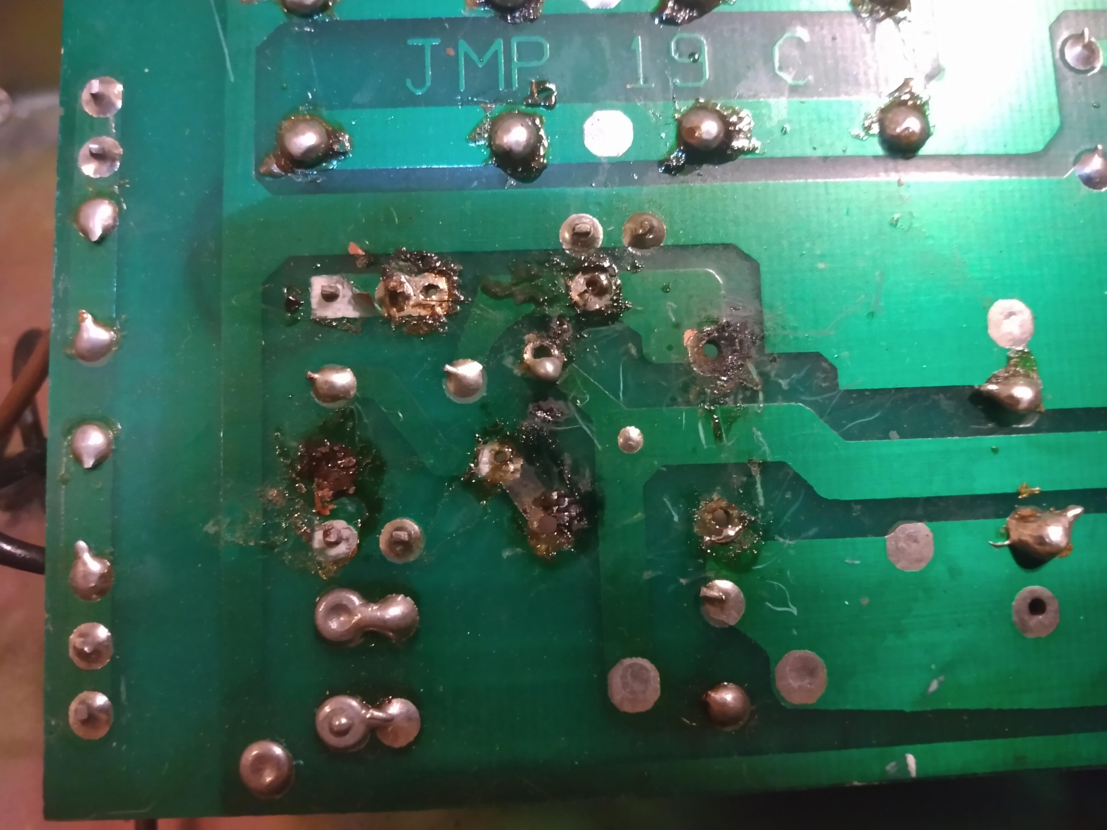

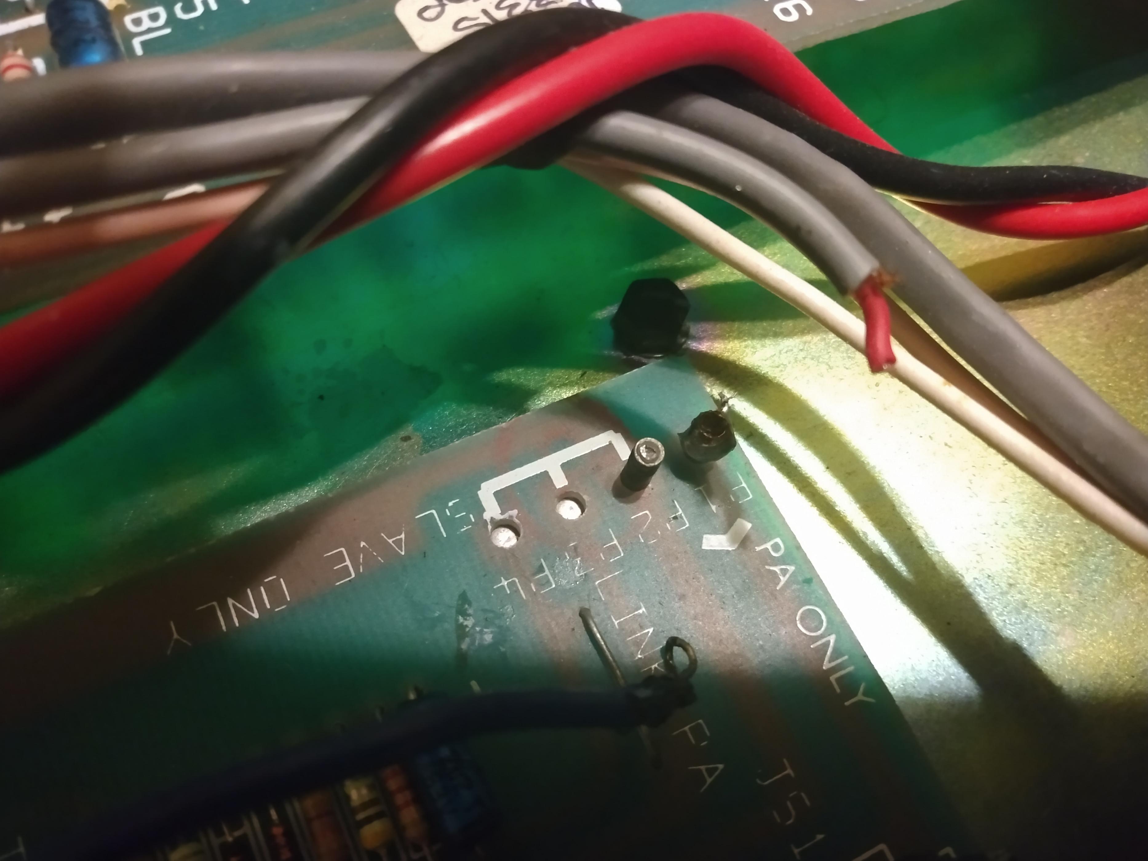

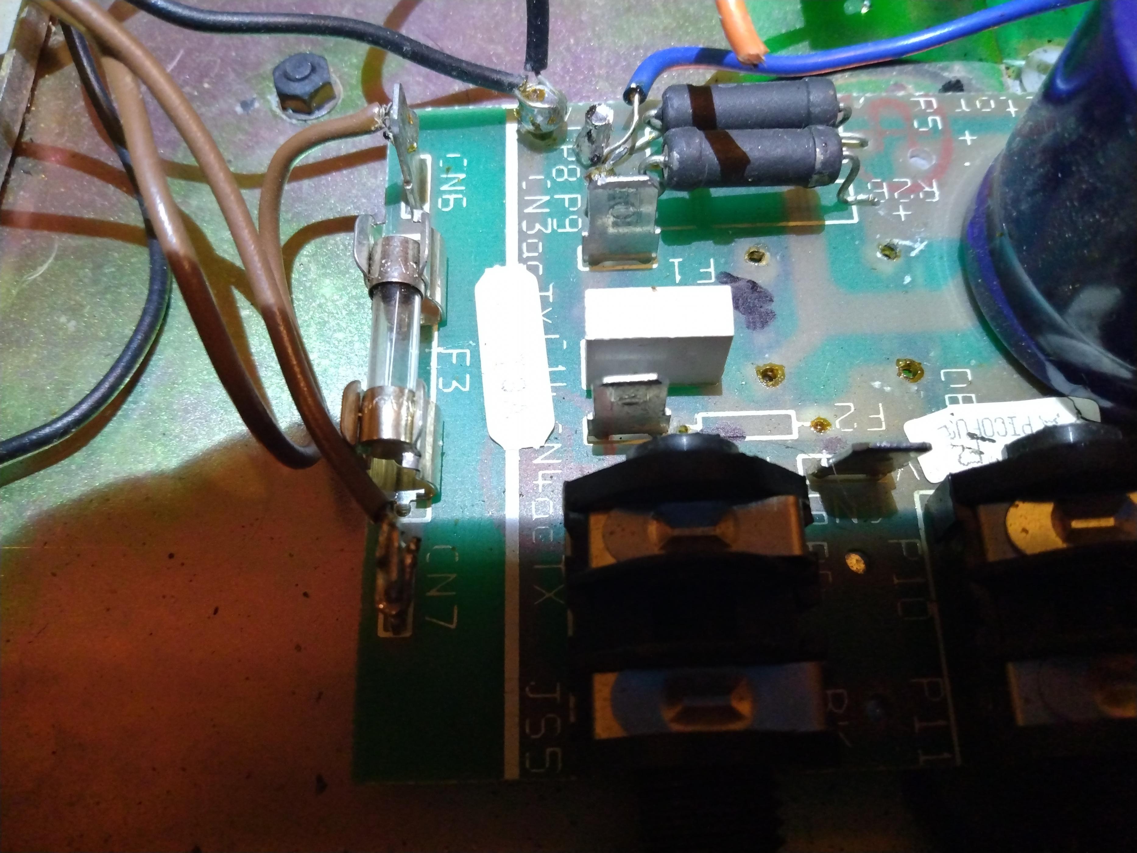

hERE ARE SOME UPDATED PICTURES OF WHAT i'VE BEEN DOING. These funky fuse holders were wired in there pretty good and took a while to free them up and off as did the old rectifier pins. Unfortunately a wire that had little play came undone at the corner of the board, that is a red wire with gray insulation you will see in one of the pics. Also, I hope I didn't fry the board to badly. You tell me. Then you will see the upside of the board with the holes for the bridge rectifier cleared out and ready for the new one. in the last picture you will see a sticker that says 7 amp pico fuses f1 and f2. I got a new phone with a better camera. I have to look for the clips.I .can get some at the electronics store if I have to.
yes, I have a solder sucker. I was wondering if I should have broken that out. I think my mistake was using the soldering gun instead of a pencil type. The guns tend to get hot and have a large heat radius instead of directing it to one place. Soldering is not my forte' for sure. That is actually one of my better attempts at it. What is next?

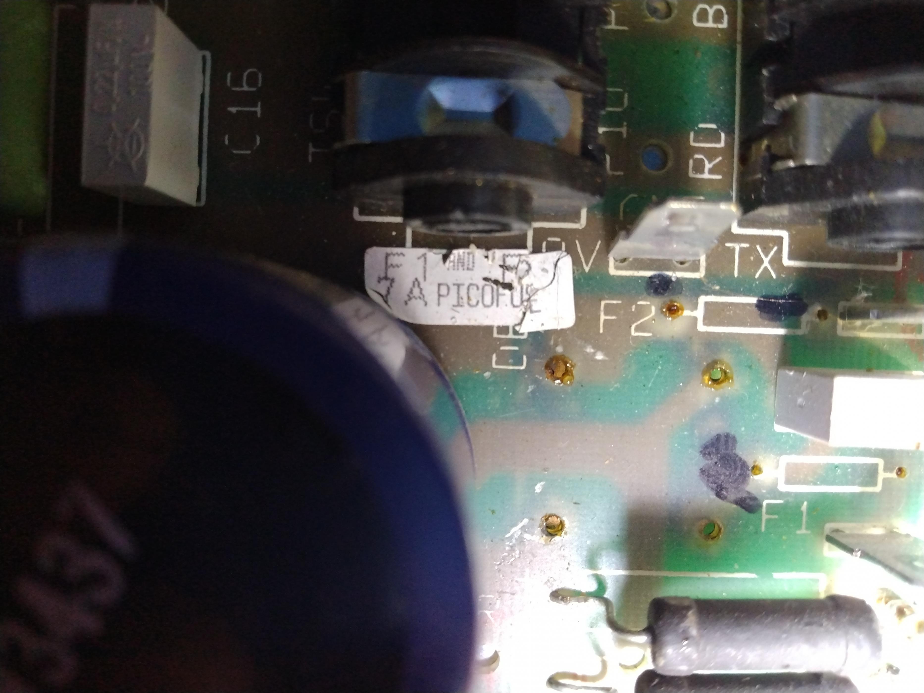

I figure I'll wait till I get the fuses and rectifier put in before I reattach the red wire. some of the black on the board is my notation that no one else can read. So the sticker says 7 amp pico's and I got 10 amp pico's, will that pose a problem? and whoever put those fusible links in was using 6 amp slow blows. Aren't the pico's fast blow? What could that have screwed up?
when it comes to the fuse rating and the difference between fast and slow blow fuses an understanding of peak and RMS conditions is necessary so a little homework Peak vs. Average vs. RMS Voltage
whomever was in there last was trying to find the mean fuse value that would offer protection despite a potential fault condition but that's a speculation we'll leave aside for the moment.

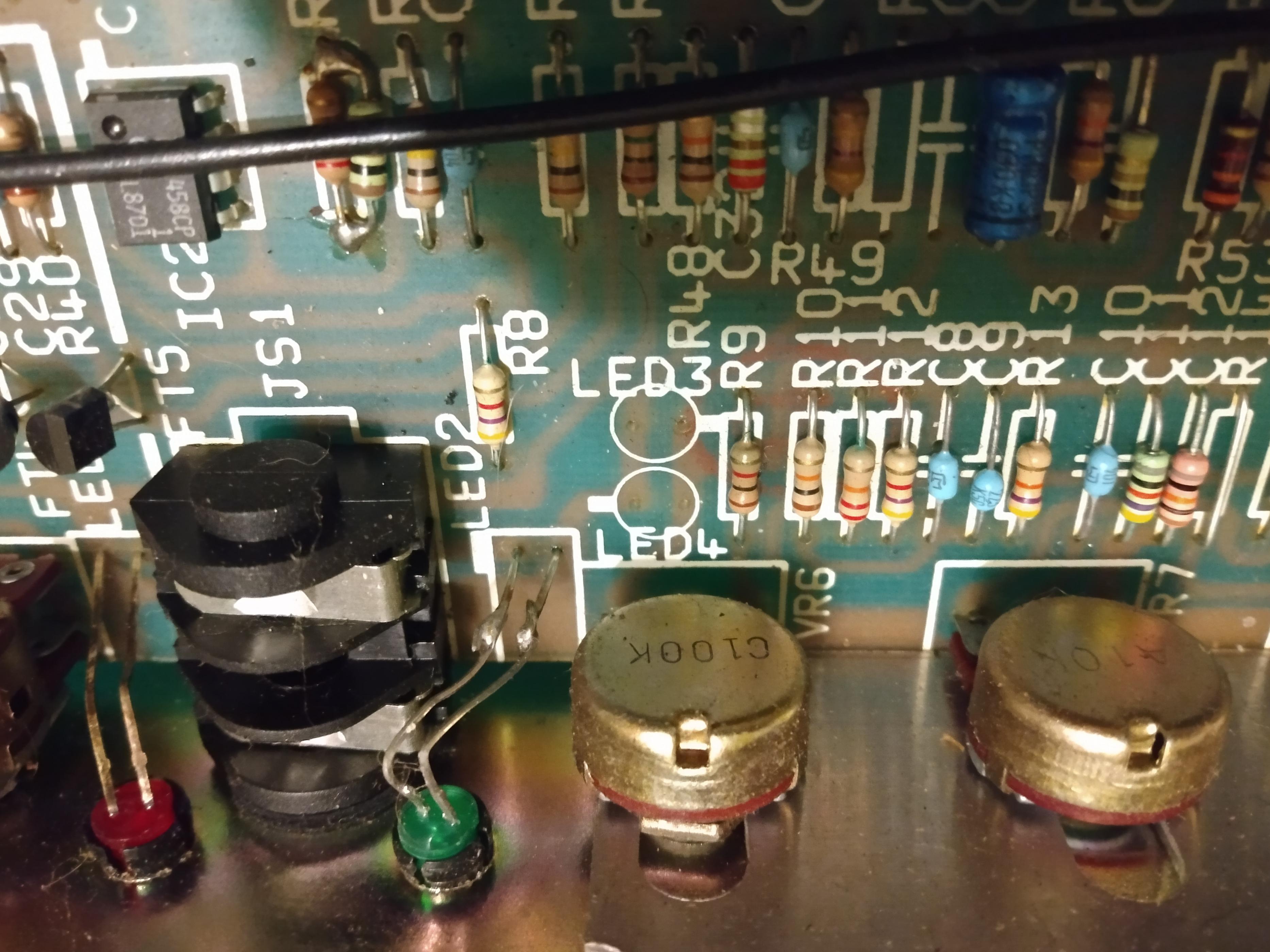

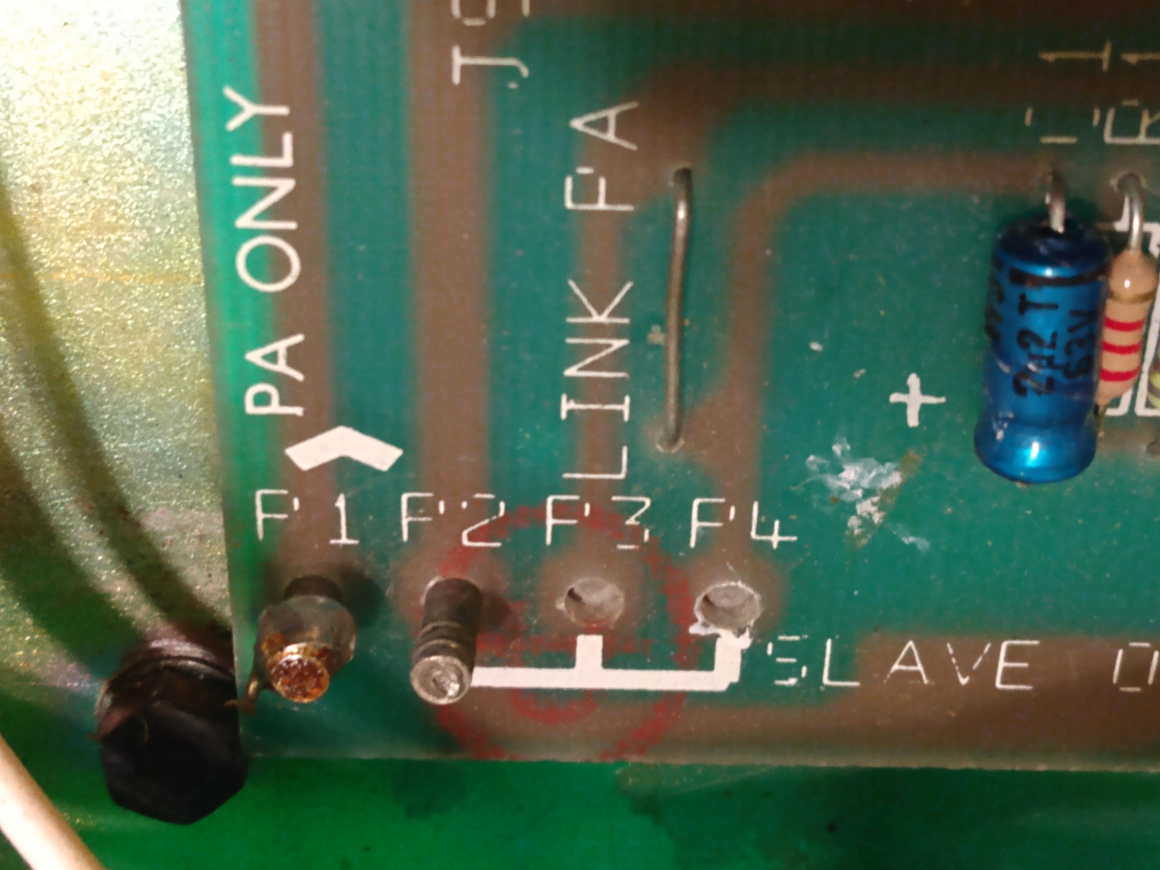

1 are those the right kind? 2 I soldered the switch in. 3 I noticed LED 3 AND 4 are missing, is this ok? 4 some other missing or empty holes

1 are what the right kind? those scope probes? no sorry
2 O.K. not the prettiest work and without the mechanical support of having the wire through the hole of the switch tab let's hope there's no cold solder joints....
3 what does the board look like on the foil side?does it look like it's been worked on? this pcb could be used for several preamp versions and for this model they are not used/needed. i did a quick look at the schematic and am not seeing them, i'll look further later.
4 same as 3

Should I solder in the fuses and bridge rectifier or hold off on that nor?
