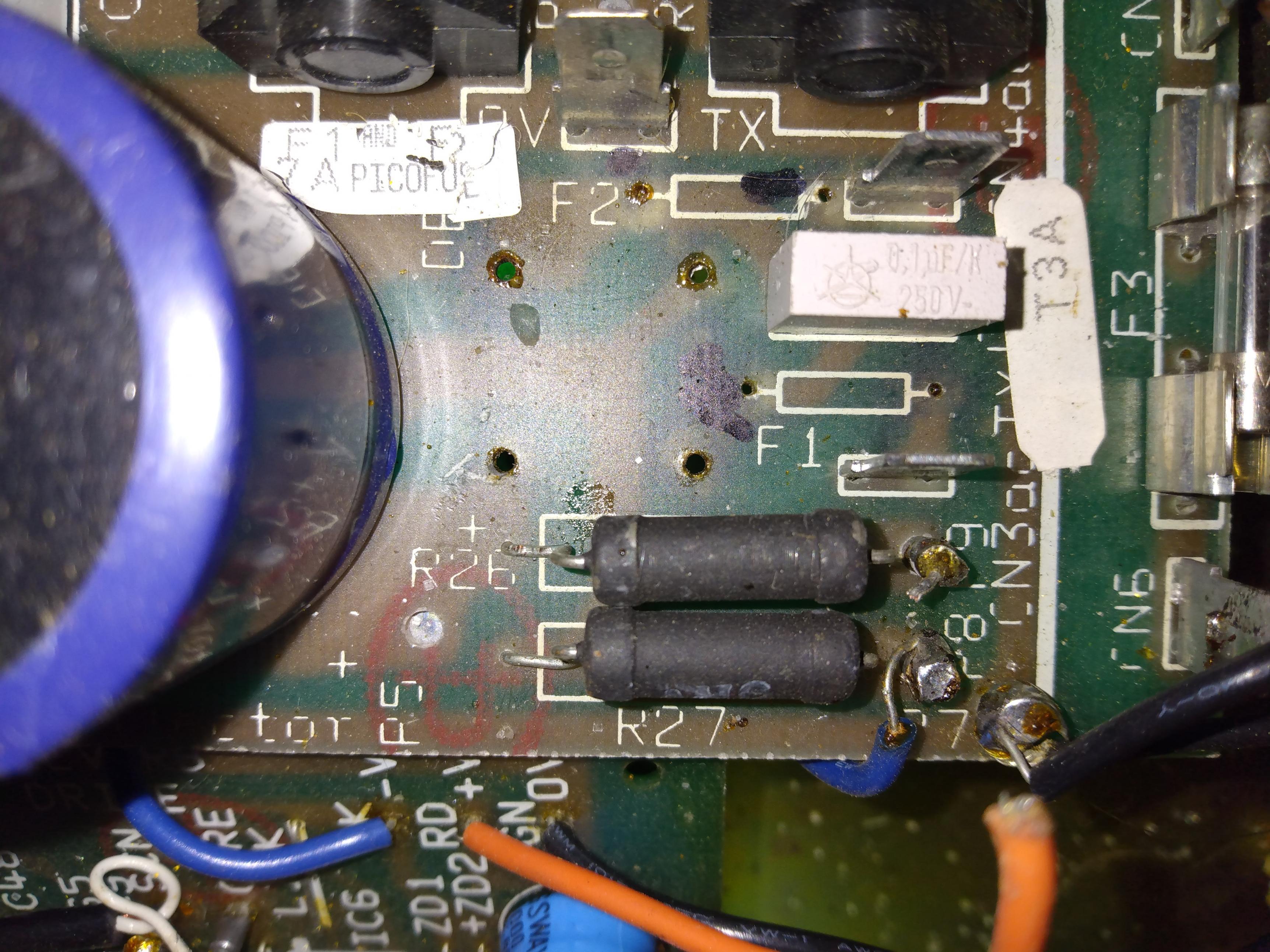

I'll take some closer pictures of the boil on the board so you can make an assessment on the condition of it see if it's going to be usable I'll post those in a minute

any chance of a better pic of the board? the foil is damaged but i don't think the PCB is chard which would matter more if tubes and higher voltage where at play, the foil damage can be circumvented with appropriate wire jumpers.
it is a high res picture, it just wont upload with that clarity. If I could email it direct you would see clearly. Unless you want a picture showing more of the board. I couldn't help burning the board when I removed those fuses the previous owner gad installed. It was like 10 gauge wire so it took a lot of heat.
wire is like a wick for heat so when removing things/desoldering it's sometimes best to cut things away then clean up the small bits....
well that depends on what you feel you can reasonably accomplish next, installing the new fuses and bridge rectifier is what i would do. and as the foil damage is going to complicate the matter a careful approach and some creative lead bending should make for a successful repair.
when i say creative lead bending i mean creating a bump in the leads so that the bridge doesn't rest against the PCB and leaving enough length so that on the bottom side there's enough to bend over creating a retainer so that it's physically held in place and allow for wire jumpers to connect to the rest of the circuit. i'll try to work up a drawn example of what i mean.
