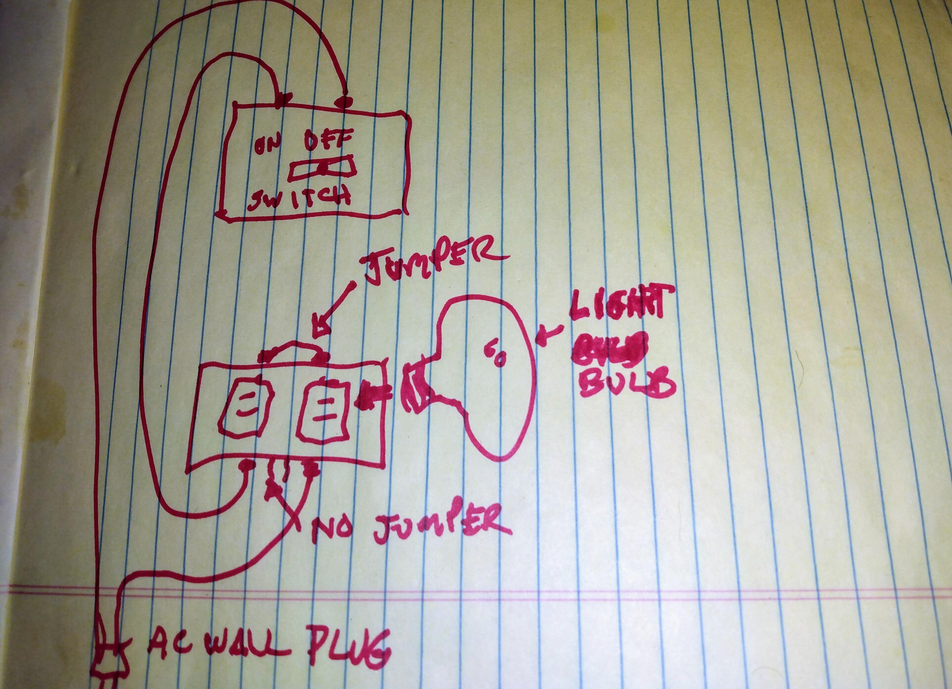

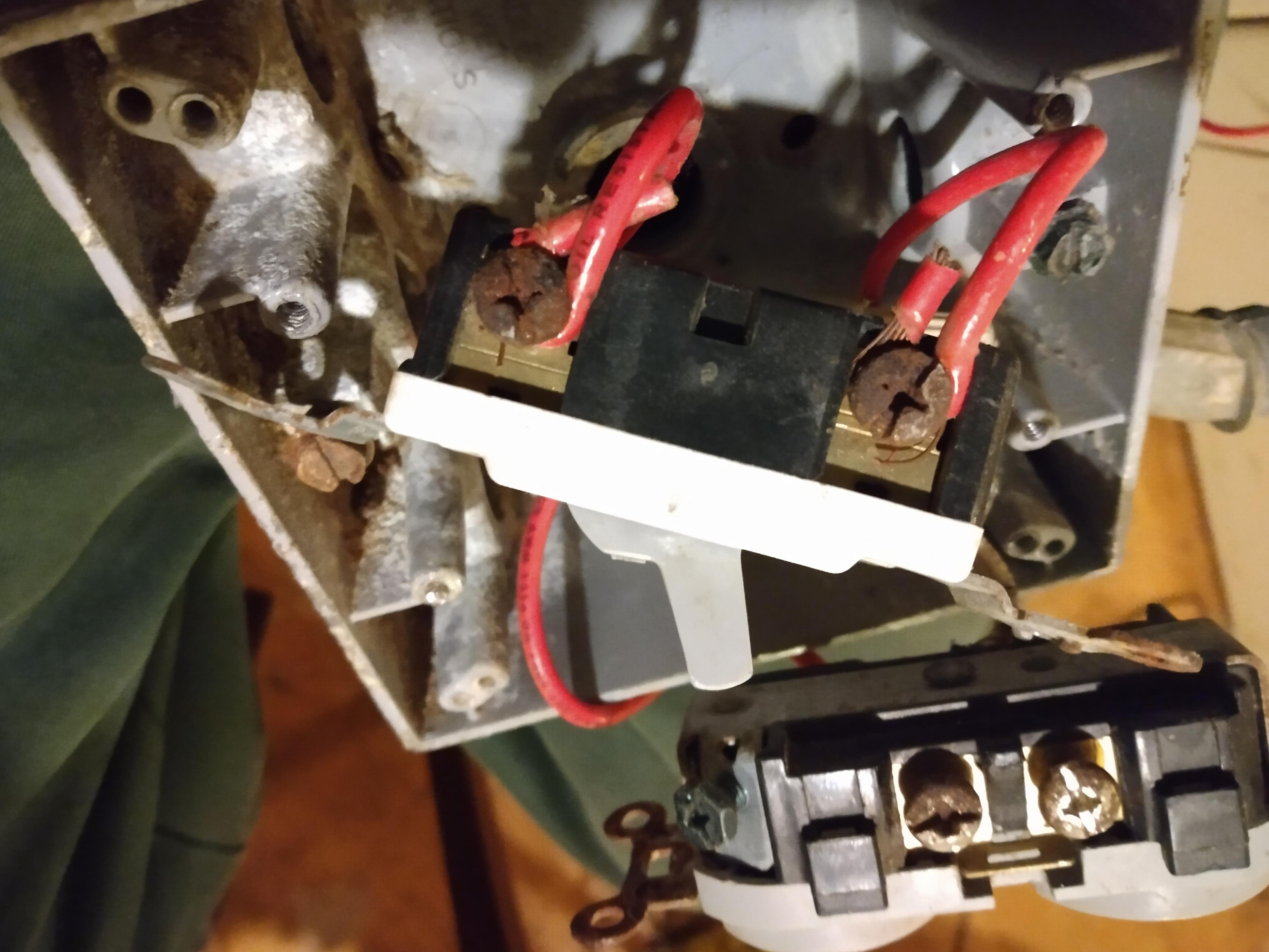

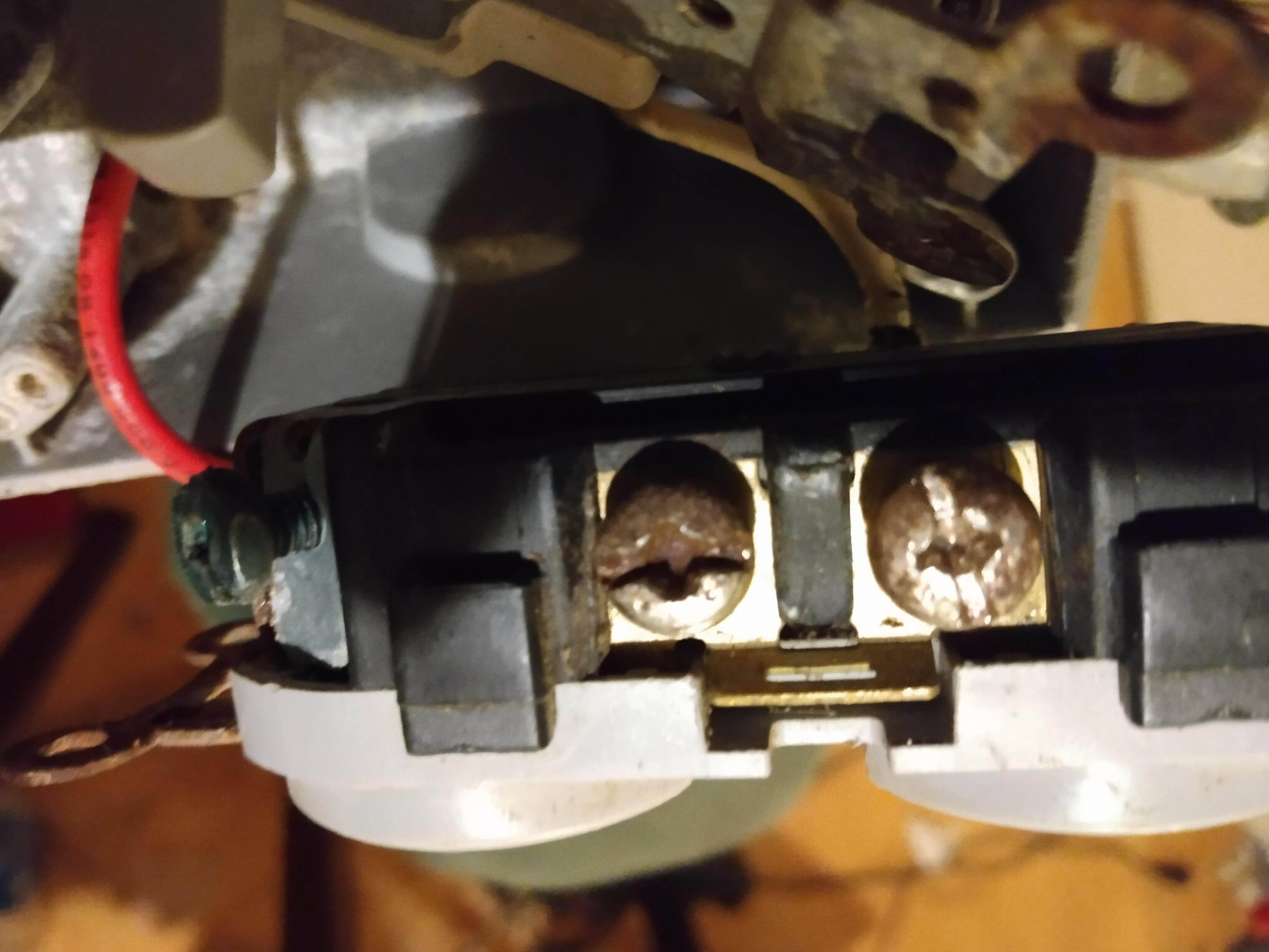

you don't ever have to apologize to me for anything. I have detailed picturesf of the dbt. my art work is that of a 4 year old with a crayon. So, once agaln, White wire comes from AC plug and goes to pic 1 double AC socket with broken jumper contact 1. Red wire goes from contact 2 to the switch, contact 1 in pic 3 then red wire at contact 2 goes back out to AC wall plug. Pic 2 is the other side of dual AC plugs with jumper in tact. Light bulb plugs into either socket.

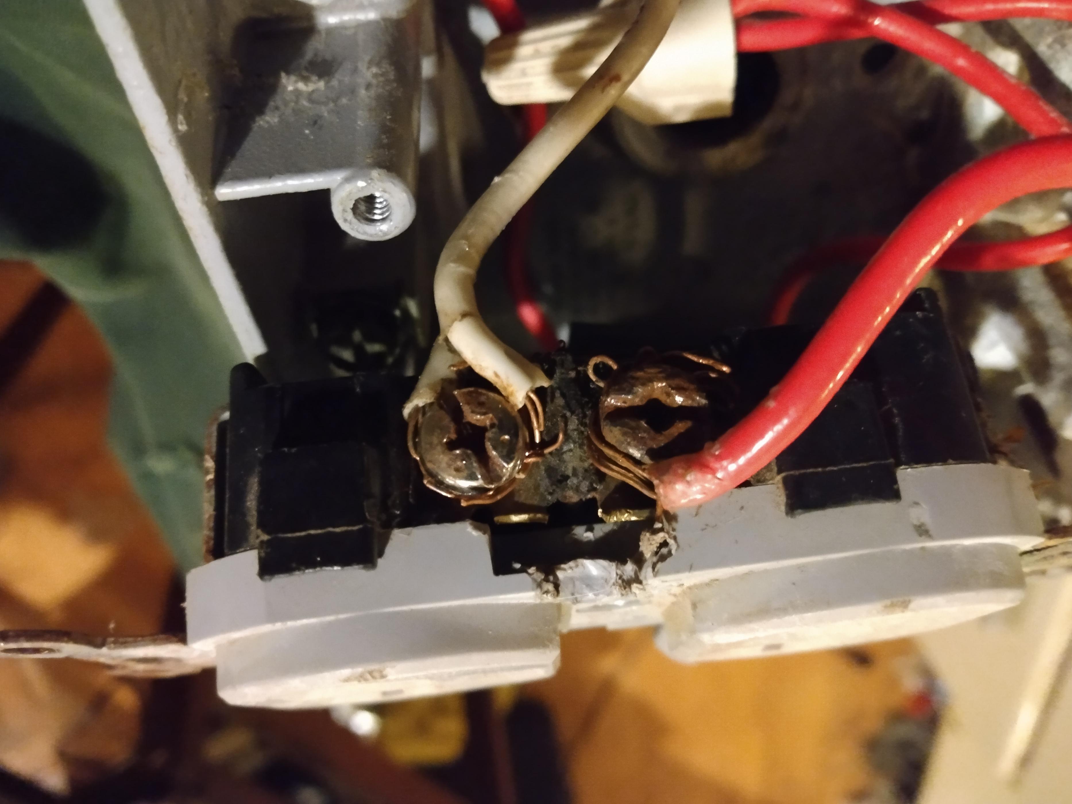

Well, after 2 days of trying to figure out why I can't get a steady voltage reading to the DBT, i'm about ready for a rubber room. Let me back track a little. Ok, I could not get a steady reading on any setting and was starting to think the transformer was bad, so I decided to do some damage control and check to make I was getting proper voltage to the DBT. I was using a bad ac outlet, so I found a stable one, but when I plug the DBT in, I don't get more than 10 volt reading that fluctuates down to miliivolts, why? I went as far as to replace the used ac plug sockets and the switch, but nothing was better. The plug and appilance cord that I have wired to the romex tested at 119 volts. That is wire nutted to the 12 gauge #1 house wire that goes to the plug outlet of the DBT. That is where the problem is. How do I fix this?
wish i where there to help you sort this,it only takes one bad connection to mess up the works, with a lamp/bulb connected you should be measuring full line voltage at the outlet of the DBT.
is perhaps your lamp socket faulty?
