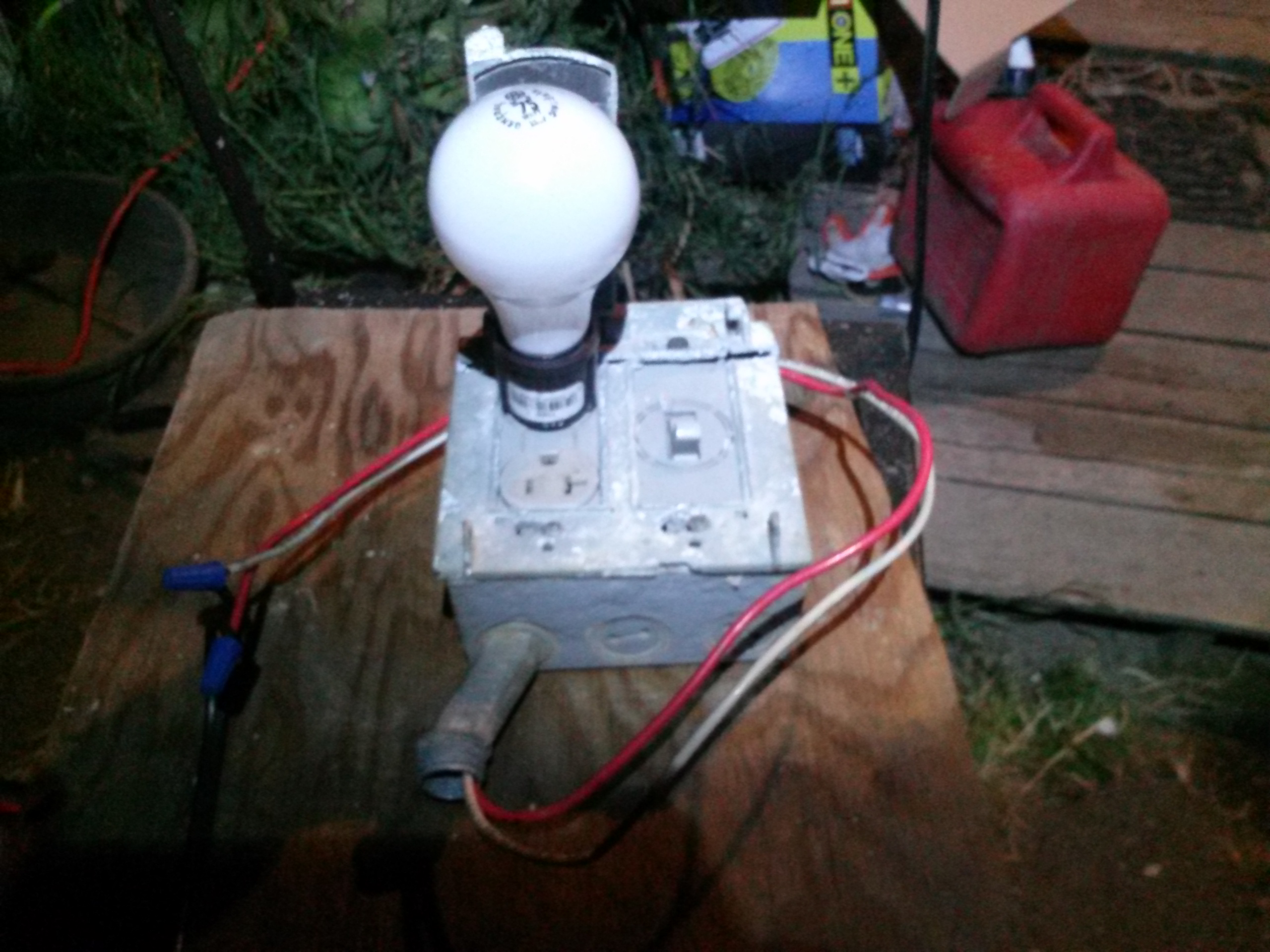

ok...here are the readings for the OT made in Mexico(the one with the visible writing on it)When I had the black wire on the body and the red lead to pole 1 to the left,347. Black to body, red to right pole #2 I got 465. With the other OT when I had the red lead to the body and the black lead to pole #1 on the left, I got 360 and when I moved the black lead to ploe 2 on the right 472. Does that tell you anything? And here is my DBT

your DBT looks good and so long as it's wired correctly as per instructions should work just fine.what wattage lamp are you currently using?

your DBT looks good and so long as it's wired correctly as per instructions.
When you say correctly, what exactly do you mean? I noticed a couple of different ways of do itThe way I did it involed cutting one of the jumper wires
with respect to the DBT so long as the limit lamp portion of the duplex plug has the joining tab removed on the hot side and the two sections are wired so as to form a series circuit all is good.
i'd collect a few wattages starting at 40 then a 60 and a 100 watts.
