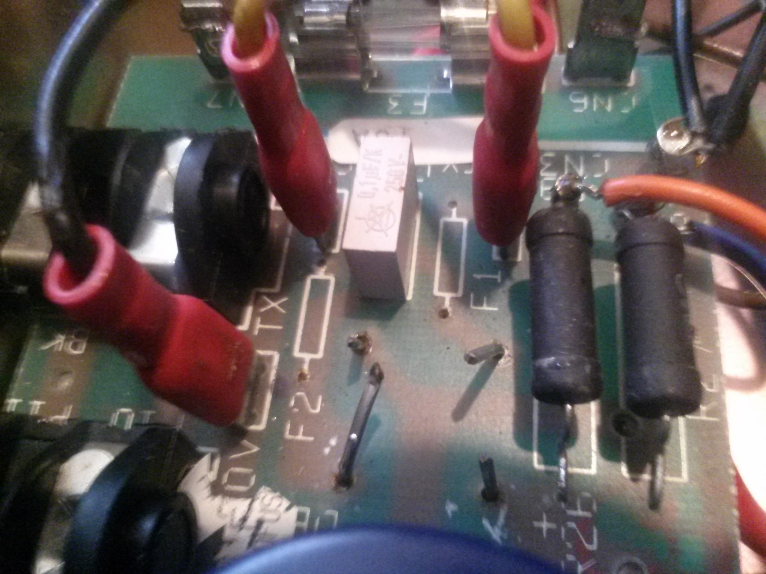

well soldering to the tabs on this side of the PCB means that the solder on the foil side of the board well get to the melting point and if anything gets physically disturbed you are likely to wind up with a bad solder on the foilside....='s not good...which is why, you need to free up the PC board to get to the underside. if that's too daunting seek help!!

Oh, you want me to remove the PCB? I still have to order the parts. I haven't found a site that has the fuyses in small quantities.The ACG type is the solder in through hole type as well, right? And should I get a few extra in case they blow for some reason?
Search results | San Mateo Electronics, Inc.We have one electronics store here, they have pico fuses but I'm not sure if they are the right ones. Can you check this link and see if any of these would work? There are only 12 results.
is this what your talking about?https://www.mouser.com/ProductDetail/Littelfuse/SPXI002T?qs=DPoM0jnrROVDOFOFpVxRtg==

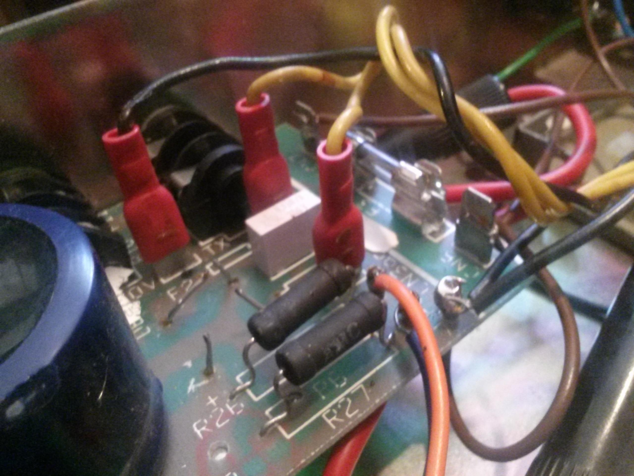

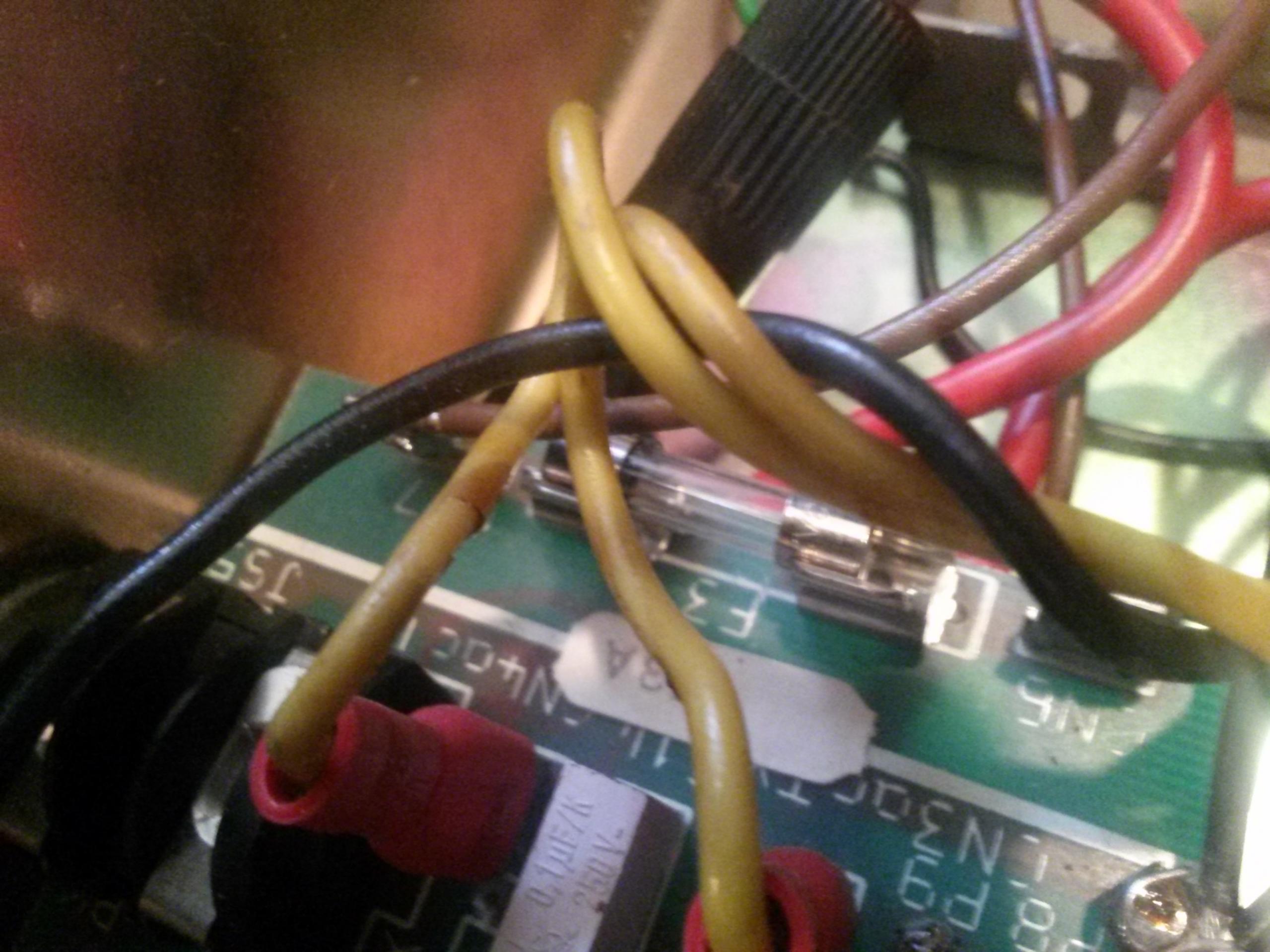

I think you have the fuse numbers mixed up. f1 and f1 are missing f3 is there and good ( it is the glass kind or old automotive type) The power switch has no signal on or off. Here's another angle of the fuses.

I'm just not sure which way the signal is flowing and really don't want to put it in backwards. I was always told the only dumb questions are the ones you don't ask. I can free up the board; remove the jack nuts and just get it loose enough to access the underside. I can leave the wires intact, right?
providing you have enough slack yes the wires intact should should be ok.

I may have to unsolder something because there is next to no slack at one corner and I will probably damage something trying to flip it. I kinda understand the diode theory in that current only flows in one direction and prevents it from going in the opposite, provided it is aligned correctly. I checked the power switch out again and I did get some signal, not where I expected though. 1st of all it's not a Marshall switch, it's orange and just happen to fit the hole. It's got 6 contacts on the back, not 5 or 4, like most. so, there are 3 on one side and 3 on the other with a divider in between, so left to right there are 3 pairs. I get signal from 1 to 3 and then from 2 to 4 vertical. Is it supposed to go that way? I think I hooked it up 1 to 2 and 3 to 4 a long time ago. Would that have done some damage, like say to the transformer? In it's current state can I test the transformer to see if it works, because if that's the case, I might as well stop now.
And to tell you the truth, I don't think this model had a lighted power switch, I think they were black. It was a blank hole when I got it, so I assumed it had a red light up. I found the orange one and it happened to fit I'm now thinking I should get red one, would a 4 pole contact work for this being there are only 4 wires?
the silk screen markings and locations are confusing but it is F1 and F2 that are missing
I knew that, you had mentioned F3 as F1 where the glass fuse is as missing, but you see it now right? I made an error on the post and F1 twice when it should have said F1 and F2.
And it is supposed to have a red light up type, the 4 pole will work.
Now what about testing the transformer? Could I have damaged it by reversing the switch the way I did?

and yes those Pico fuses will work.
before getting in too deep into this repair testing the output devices would be in order.
