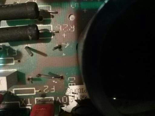

Ok, I made a DBT, got the pico fuses. Waiting on the bridge rectifier. I was looking closely at the amp and it looks like a couple other things might be toasty as well. Take a look at those 2 blackened resistors in the upper left corner marked R26. Are they supposed to look that way? If so, what is my next step Turk?
R26 you say, first they are not blackened that's their native color as to the suspicion of heating we'll discover that later (it's possible that supply regulation for the pre-amp stage may be faulty)
while waiting for the bridge to arrive pull the output devices out of circuit and test them, next would be driver transistors but one thing at a time...

On the R26 issue, I was just watching a repair video and a pair of charred resisters that were being replaced looked very much like those, that is why I asked.

what we are looking for now is a fault/problem elsewhere that would have the potential to have damaged the original bridge rectifier.
we'll also need to evaluate the main filter caps.

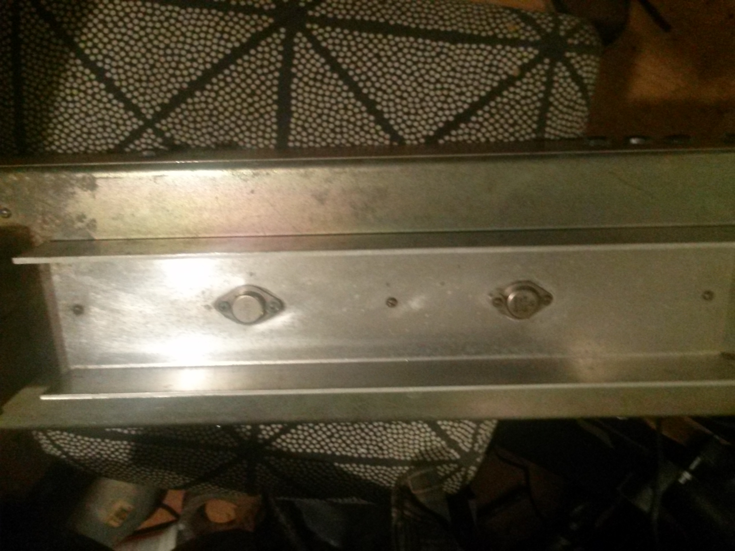

output transistors? Would they be marked with a T? Thank god for the little map on the board of what goes where, otherwise I would be more lost. They all look the same to me. So, signal flows from the pre-amp stage first, then the power section. Current goes to the power switch then the transformer, fuses, Bridge rectifier? Those transistors must be somewhere in between all that, right?
Yeah, when we get to the caps, maybe you could tell me how to properly discharge them, or should I just google it? I was surprised to see what people are charging for DBT's.
Those are the 2 out of 10 that aren't visible. Are they on the opposite side where they are marked?
sorry it been a while since i've been inside one the outputs are mounted on the chassis aren't they?

okay, I got them out, on ohm setting I get 502 on left, 492 on the right, one post to the other, is that right?
all depends on what setting your meter is on, but as an initial it's already a cause for concern....
here's a little homework Meter Check of a Transistor (BJT) | Bipolar Junction Transistors | Electronics Textbook to get you started.
