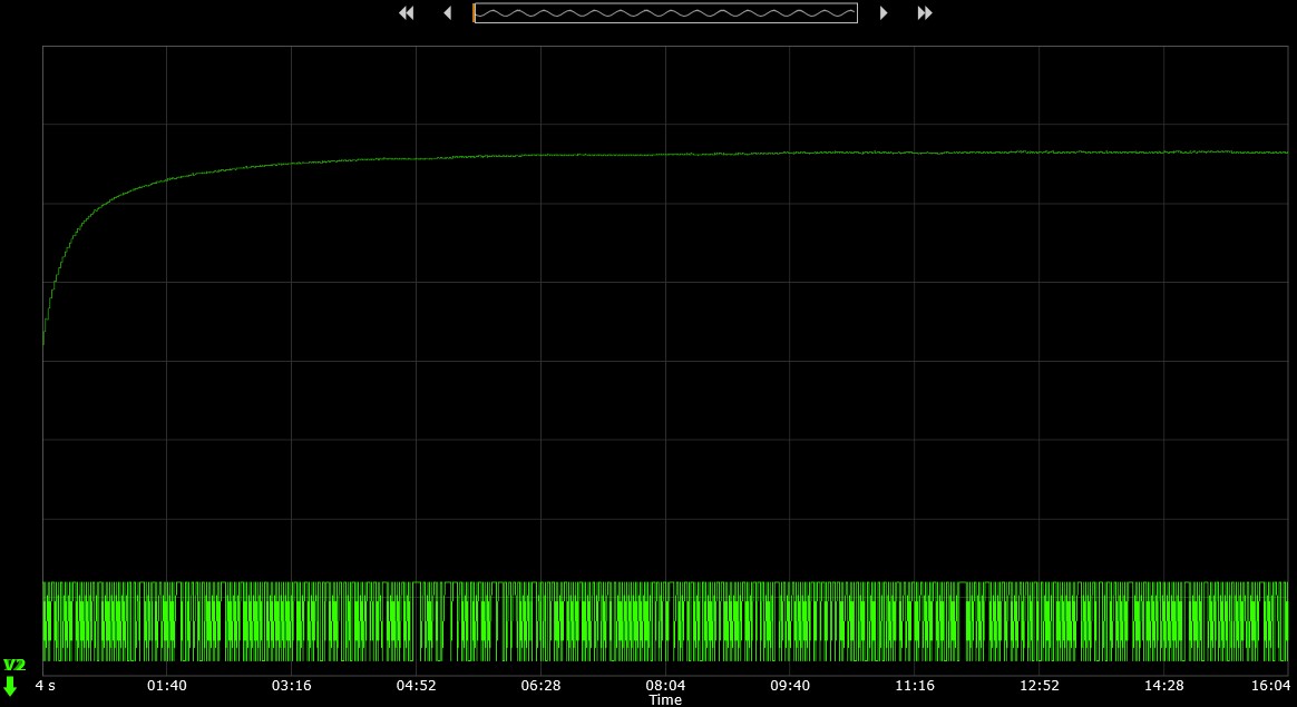

Hello Richard and All,
I have my lab notebook open here with thoughts in it.
Thermally conductive epoxy, you know glue the N and P FET’s together for common heat tracking.
Soldering vs push in solder-less Radio Shack style breadboard for heat stability
Tracking DC offset for an N and P pair vs time and temp. (So no I have not tested DC delta yet.)
There are other things on the list to test. Down the line the idea is compare cold pulse matched parts to parts matched over time in an operating temperature enclosure.
One thing that I have noticed:
Some FET’s with constant voltage applied drift up in Id current over time and increasing temperature. Example 2SK170.
Some FET’s with constant voltage applied drift down in Id current over time and increasing temperature. Example 2N5457.
Leads me to think that if an N and P pair are matched cold they my drift in opposite directions as they warm to operating temperature. (This is on my list to test)
See 2SK170 plot and data attached.
Thanks DT

DT -- I can send you some "cold matched" 2N5460/2N5457 to put in the wigidizer.
Hello, jackinnj,
I’ll take you up on that.
It will make for a good test. You will know where we started with the “cold” numbers. There is a note on the ON Semiconductor 2N5457 Datasheet that addresses self-heating. Maybe it will make a difference matching N and P pairs or not. There is a similar note on the 2N5460 Datasheet, it does not say if IDSS goes up or down.
Note: Graphical data is presented for dc conditions. Tabular data is given for pulsed conditions (Pulse Width = 630 ms, Duty Cycle = 10%). Under dc conditions, self heating in higher IDSS units reduces IDSS.
Thanks DT

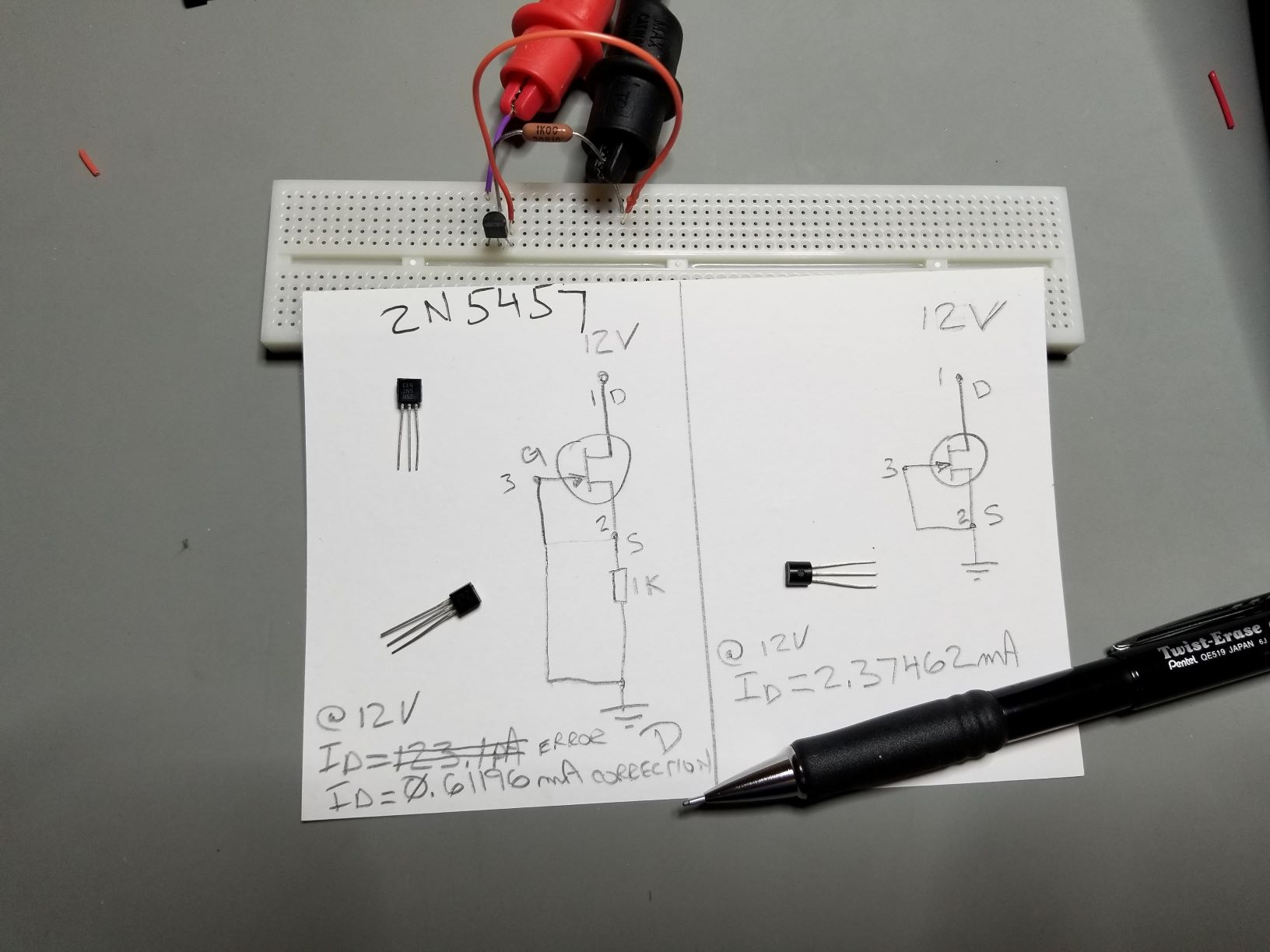

Hello All,
Here at the bench there is a bag of 500 Central 2N5457 JFETS. Looking at the Datasheet the min IDSS is listed at 1mA, the Max IDSS is listed at 5mA, and the typical IDSS is listed at 3mA.
I took a random 2N5457 JFET out of the bag and measured the IDSS at 2.37462mA. I checked a dozen or so additional JFETSs out of the bag and they seemed to group around 2.4 or 2.5mA Drain current. The test voltage was 12VDC on the freshly calibrated Keysight B2912A SMU. Both the source and gate were tied to ground or 0VDC. You know the typical way of testing Steady State Drain Current.
Wanting to stay close to the device matching methods outlined in the Linear Audio article I placed my randomly selected JFET in a test jig that looks like Figure 10 in the article. There is a 1K source resistor. As the current increased through the source resistor the gate to source voltage quickly became increasingly negative, exceeding -1.2VDC, the Vgs (off) voltage. I measured 123.100pA Drain current with the source resistor in place.
I did not find any JFET’s with lower Drain current (without the 1K resistor) to see if there is a sweet spot at -0.8Volts.
I know that I am in the weeds exploring part matching. This amplifier is exceptionally stable with very low distortion and very stable or completely missing DC drift without coupling capacitors.
Thank you Dr. Marsh.
Thanks DT
Hello,
Apologies
I posted results in error.
I pushed the wires into the incorrect location on the breadboard. Corrections are made.
Using Figure 10 in the Linear Audio article the Drain current measures 0.61196mA much closer to the 0.8 mA Drain current discussed by Dr. Marsh in his article.
Including the 1K resistor in the test jig reduces the Drain current (IDSS) from 2.37462mA to a Drain current of 0.61196mA. See the attached photo of the test schematics and breadboard.
Thanks DT
