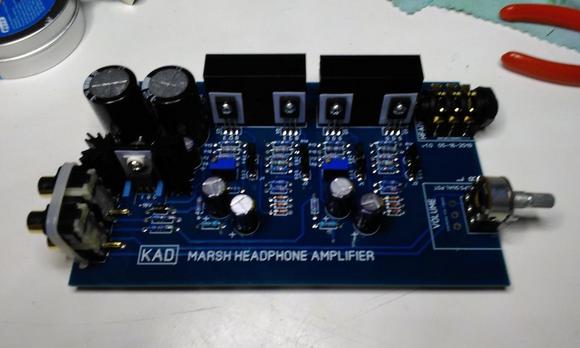

I just built the pcb provided by Jack, its a nice board thanks to Jack. It came as a kit with all the parts. Sounds great!
You may contact Jack.I see that Mouser has all the semi's in thru hole.

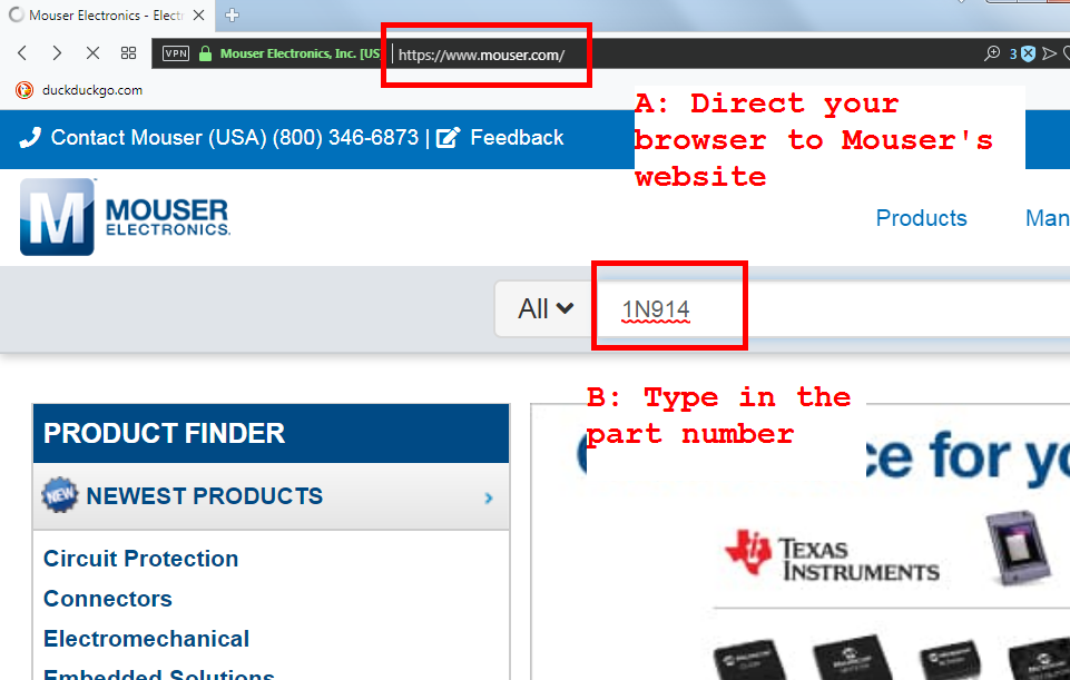

Well, I'm ordering parts from Mouser and I'm sort of lost.
I don't have any background in electronics and would love to have some help to select the right part @Mouser.

BTW, is it OK to ask these questions here ?1. 100nF ceramic cap:
Is it regular ceramic vs MLCC ?
Is it a "feed through capacitor" ?
Whats the material of Dielectric ? X7R ?
Voltage rating ?
Radial type, right ?
2. 220uF Electrolytic:
Voltage rating ?
Low ESR, Audio grade ?
Which brand, Panasonic or Nichicon or UCC ?
3. 1N914:
Just a plain jane version or a more exotic one 😉 ?
Is it a "rectifier" or a "switching" type ?
4. Header 1x2:
I'm lost here as there are tonnes of options in Mouser.
Is it a power connector ? What exactly it do ?
5. Header 1x3
Similar questions !
6. Bourns POT 1 (102R):
Not available in Mouser.
7. Bourns POT 1 (201R):
Please let me know I have a lot more to ask 😛

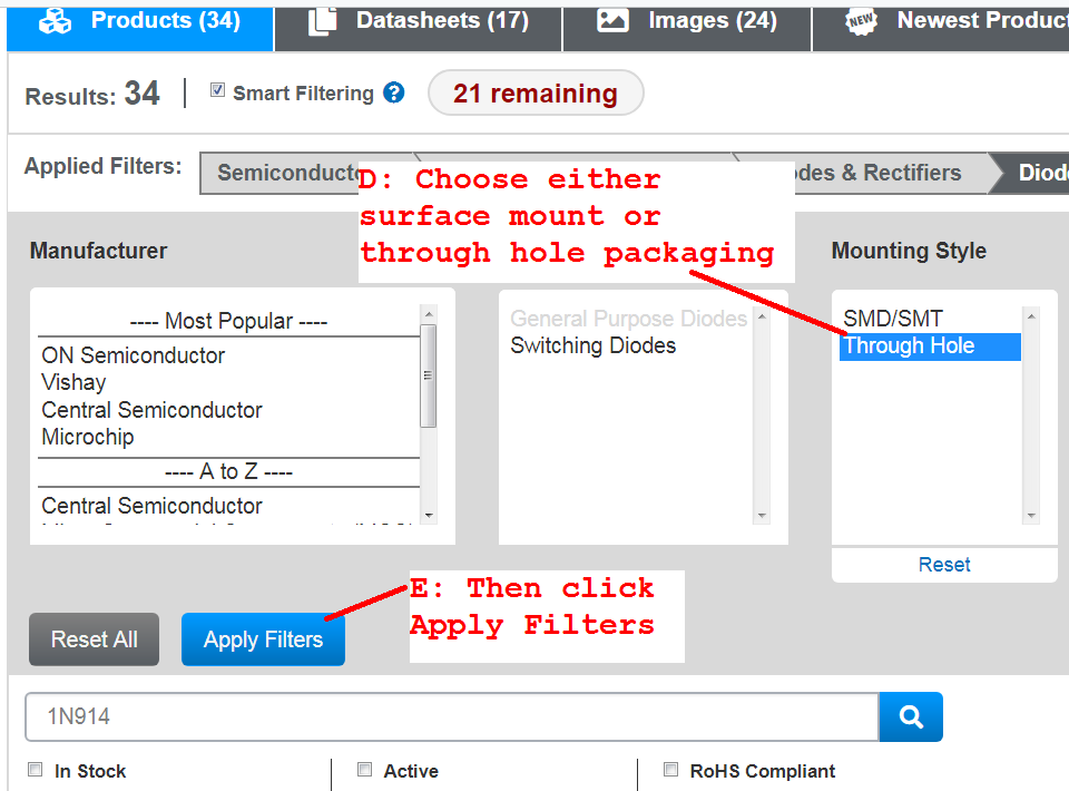

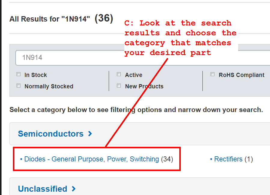

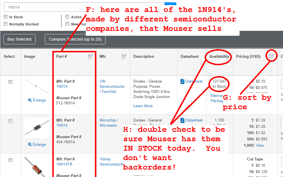

Don't be intimidated, ordering parts from Mouser is not unbearably difficult. Here is the procedure that I myself would use, to order item #3 from your list. Perform the steps in alphabetical order: A, B, C, D, E, F, G, H.

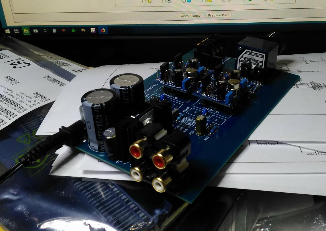

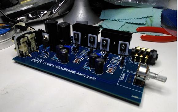

Richard,
I am only just now completing my build. This is powered by a wallwart and slips into a stock Hammond extruded enclosure.
It is still undergoing tests on my bench but I expect to be listening to it very soon!

Thanks but I have done nothing special. That's a stock Alps 10K log pot. I like your idea tho.
Once I have convinced myself that I have a worthy implementation of Richard's invention I will most likely swap that pot for an RK27

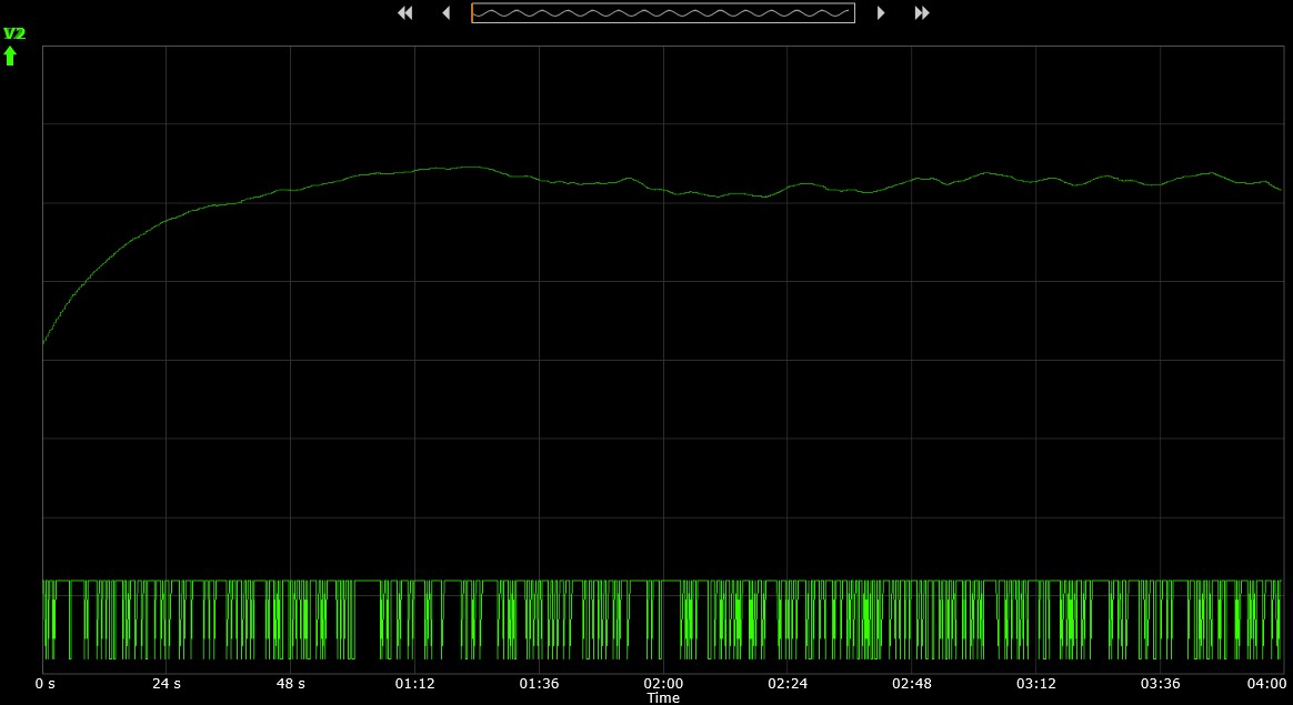

I did purchase a shoe box full of transistors and JFET’s to test and match. First I am looking at 2N5457’s and 2N5460’s. If you look at the datasheets notes the tabular data for Idss is measured with a low percentage Pulse and the graphs are plotted with DC. Seems to me the lab test conditions do not have much to with DC operation in an operating circuit. I am learning that these JFET’s take minutes to warmup and settle into stabilized operation. With that being said, just the HVAC blowing cool air over the test causes the source current to fluctuate, just the same as fanning the test jig with a paper plate. Just touching the JFET with a fingertip causes the current to go into the deep.
I am thinking that testing for complementary matched pairs could be better done with individual device testing and placing potential pairs in a real world test circuit
This testing and matching is deeper than I thought. It very well could be done with a $25.00 tester, I do not know. I went all in with a Keysight B2912A Source Measurement Unit and EasyEXPERT software. The software and instrument aren’t on the best of speaking terms just yet. This is a precision calibrated instrument that will measure down to femto-amps, not that it makes any difference.
I data logged Idss over minutes for both a 2N5457 (first plot) and 2N5460 (second plot). You can see the current wandering over time. It is like watching slow motion noise. The Idss was least stable over the first short seconds. I am not sure what good for a real world circuit taking a pulse Idss measurement at 0.1 seconds after the pulse is triggered would do. This would not be a very representative measurement, at least in my mind.
See the plots. The currents measured are in the 3mA range, the fluctuation is in the 2nd, 3rd , 4th and 5th digits to the right of the decimal point. Touching or blowing on the JFET caused 0.1’s of mA fluctuation.
In controlled conditions precise measurements are possible.
I don't see that on the plots??? In fact I don't see either digits or decimal points?
Would you please encircle these 3rd , 4th , and 5th digits to the right of the decimal point, in some impossible-to-miss bright color on the plots? Probably I have done something very dumb, like fail to expand the image to full size or such like

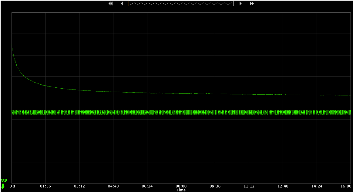

I did place a 2N5457 JFET inside a 8” X 8” X 4” NEMA 1 box on the floor here in my study, The air is calm at 74 degrees, the HVAC has not yet kicked on (not on the Nor Cal Coast today). The Id current vs time plot is much smoother and flatter measured inside the NEMA 1 box with only Natural Convection Cooling inside, much like operating conditions will be.
See the attached plot; at time zero the Id current was 2.10136 mA and at minute 16 the Id settled in at a steady 2.07928 mA.
Voltage is the bottom plot; fluctuating at 20.99999 Volts to 21.0 Volts

It's regrettable that the two columns of data are not on the same page. Perhaps "Landscape Mode" could fix that?
Here's my two cent analysis of the .pdf data, I hope I have not misinterpreted it
Is that the proper conclusion to draw? Let it stabilize for 15 minutes before trusting the measured number?
